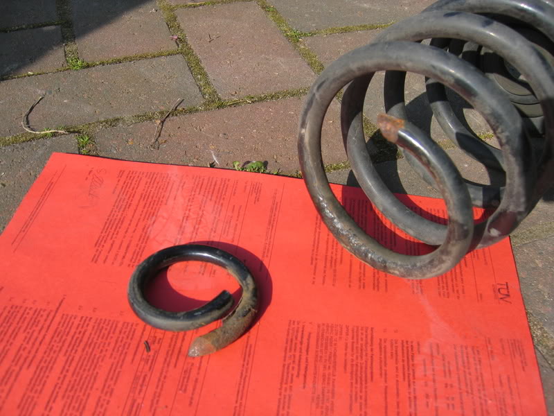

Right, my car. The right hand side rear sits lower than the left hand rear, it never used to do this. Can someone tell me what exactly is the most likely part which is buggered and will cost me £££ to fix? (spring? shock? etc). :(
I haven't had time to have a good look at it yet and some ideas of what to check for would be appreciated.
snapped spring probably
easy to change though mate.
Undo the two hub to strut bolts, then get a 22m? spanner and hold the top mount and use an allen key to unscrew.
Buy some spring compressers or take to a garage to do it, charge you a fiver or so.
