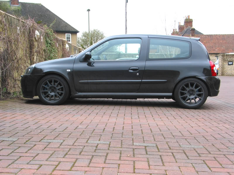

I have two questions. Firstly, what height are ppl running fr and rear on their coilies at the moment and what would be 'recommended'?? Having spoken to a few decent rally prep companies back in my Pug days I was told to run the car pretty level and the only reason for having a raised rear ride height as stock was to account for rear passengers. On the flip-side, I was also told that having the rear slightly higher than the front aids handling (something to do with weight transfer) and improves steering feel. Is this true? I'm currently running the rears 300mm from the centre of the wheel to the arch and 318mm at the front. Even though the rear arch is closer the car still sits nose down! Here's a pic:

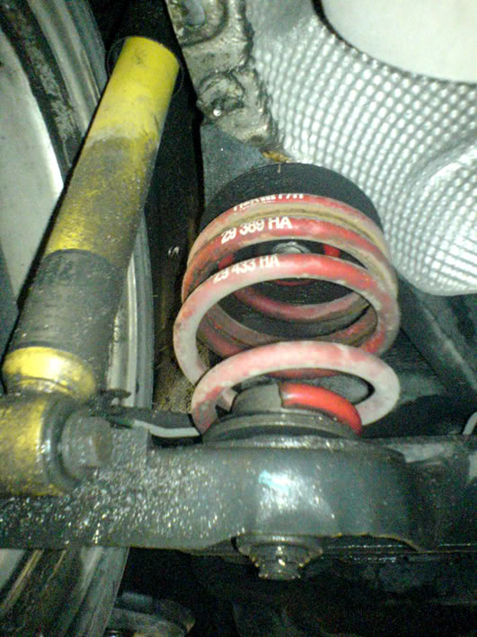

Secondly, in the PFC article they sited the rear springs as being a problem. This was due to them becoming coil-bound over bumps. I understand the downsides to this and having looked at my springs, some of the coils are touching when just the cars' load is on them! There is space between a number of the coils but not all of them. Is this the norm on a lowering spring (I remember the apexs that came on the car looking the same) or is it a problem? Any advice would be wicked;)

these are the rears off H&R's (borrowed pic)
as you can see even these are coilbound at the top, but are better than the gaz units i've seen.....

I have FK's on my 172 with Koni adjustable socks. From what I could tell at the rear, the spring has to be this short to get the range of adjustment that coilovers offer, otherwise theres no point to them. They are only adjustable in height. The fronts compress the spring when lowering. Most coilovers will go low enough to rub the arches so you need to be careful how low. Some will tell you to rip your liners out. Mine is set pretty level around 600mm from ground to arch, maybe front looks a liitle lower as the sill points down at the front, only just tho. May still lower the front upto another 10mm. Have my Koni shocks set on softest. The ride is still more than firm enough and is a little unsettled on bumpy roads. I would only consider paying for setup if trackin it, which I won't be.

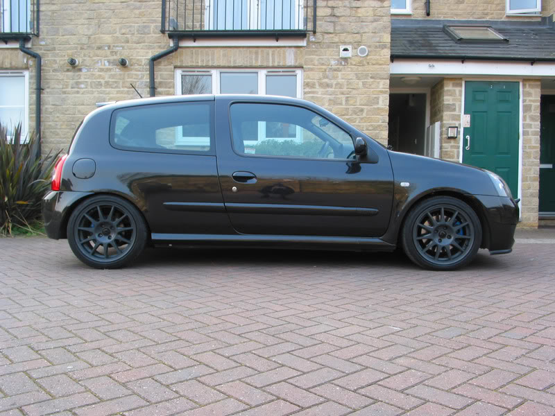

mine sits like this, (old pic mind) I tried to keep the natural rake towards the front

Wired stuff! Skipp Brown (pug rally guys) told me to set my 106 and 306 Rallyes so the sills were level with the floor too Fred (using their Billie dampers and custom springs!). I've been playing with the set-up on my coillies all day today aswell. I've ended up raising the front height about 25mm (so the car sits much more level) and the difference has been very very interesting. The car no longer feels compromised by the lumpy stuff and handles my local 'test tracks' much more like my old 182 cup but without the roll that used to occur. It really is a lot better (than the previous set-up on my 172). The car sits pretty level now with the front arch noticably higher bit the lower sill still slightly lower at the front. I was really suprised that it made any difference. I wonder why the Trophy is so high at the back? It defo handles well as stock! What would a 'level' Trophy handle like though I wonder???????

They seem like a really genuine bunch of guys and are certainly well reguarded! They subscribe to the 'level with the floor' theory like Fred. I've made mine much more level now and the car is way better. I don't know if it's purely down to the increase in front ride height allowing the car to cope with the rough stuff or the 'level/balance' of the of the car that's done it. Either way I'm a lot happier. I think the car was just too low before. I guess that even though the spring length/stroke doesn't alter, there's now more damper stroke for the given spring stroke. This is maybe controlling things more too.
Here she is now:
I think she could still come up on the front a bit but I'm a little wary about loosing some steering feel. I think I'll come up another 10-20mm and see what it's like;)
