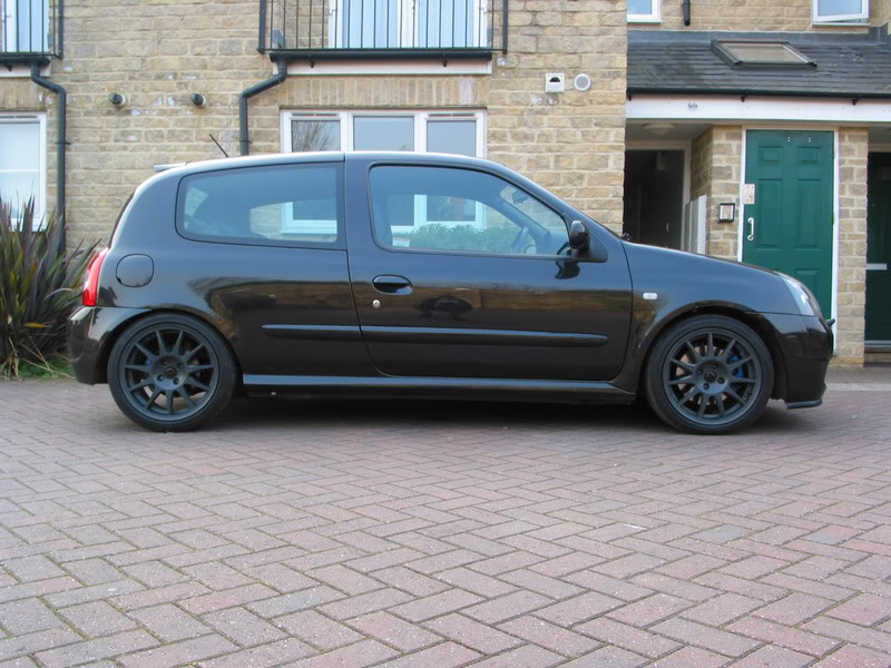

They seem like a really genuine bunch of guys and are certainly well reguarded! They subscribe to the 'level with the floor' theory like Fred. I've made mine much more level now and the car is way better. I don't know if it's purely down to the increase in front ride height allowing the car to cope with the rough stuff or the 'level/balance' of the of the car that's done it. Either way I'm a lot happier. I think the car was just too low before. I guess that even though the spring length/stroke doesn't alter, there's now more damper stroke for the given spring stroke. This is maybe controlling things more too.
Here she is now:
I think she could still come up on the front a bit but I'm a little wary about loosing some steering feel. I think I'll come up another 10-20mm and see what it's like;)
perfect ride height, same as mine
be aware that raising the front opens the track, so new alignment is due

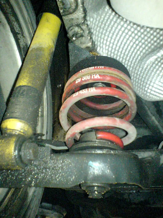

this is how i got the H&R's lower at the back. both adjuster nuts underneath the spring platform.
p.s. Mark, that looks really good. I want mine even lower at the back.
chris
looks like you have 10mm of room left for lowering
just take the nuts out completely and let the spring sit on spring suport and ruber
don't forget to shorten oe bumpstops
cheers
big noooooo H&R spring must NOT sit on the o.e spring support and rubber. (on the rear beam) The bottom of the spring must sit on its platform, as the spring differs at the bottom than o.e. Dangerous, i've seen some gaz set up like this........ major chance of it popping out on the rough stuff.
