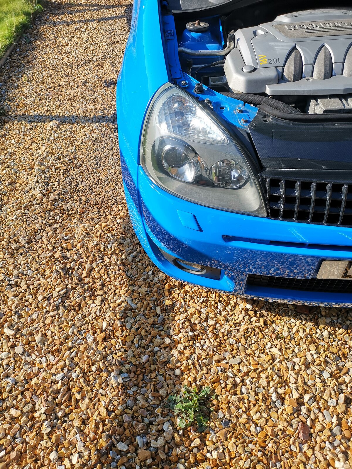

Gave it a good clean off to find no more damage than I already knew existed on it, she's impressively clean for the age, in deep clean terms all I did was use some Maguires headlight restoration on it and they came out great!

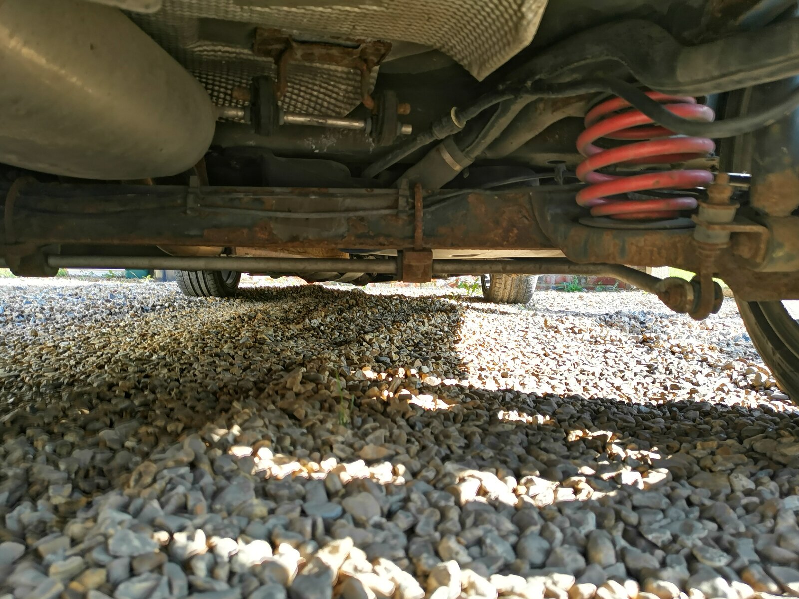

Some how I missed & didn't realise this when I inspected it to buy, it looks like it's got and adjustable anti roll bar on it, only two adjustment settings, which is good as that was going to be one of my first purchases, I may still go and get an new whiteline one anyway as the one on the car is definitely old and part worn.

yep that's got a whiteline on already. just take it off and clean it up imo

I'll take off in the next few days and see how it cleans up also whilst it's off put it on the other setting see how much it changes it.

It's on the hardest setting at the minute, to be fair its not worth buying a new one as they turn pretty quickly like that anyway!
If you remove it and paint it, keep it topped up with plenty of ACF50 to stop corrosion. Look forward to following your build mate.

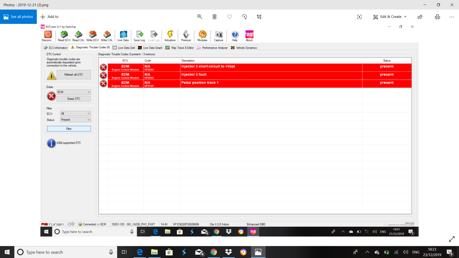

So I've been abroad for a few weeks and two days before I left the car started misfiring, I thought an injector gave up but after investigation I realised there's a moisture problem with the electrics under the glove box, I cleaned it up as best as I could with my limited resources WD40ed it and it resolved the issue.....for about 20miles and then returned to running like a bag of sh@&.

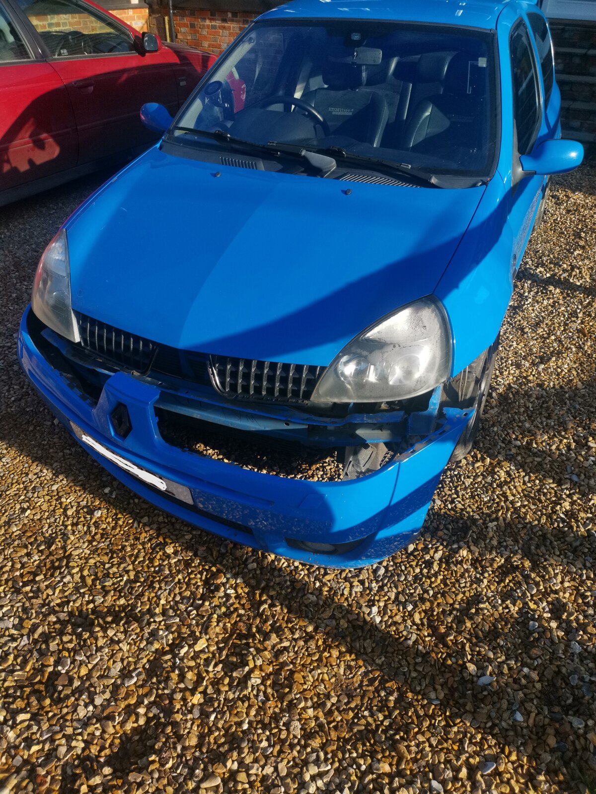

when I returned home just to rub more salt in the wound I ripped the front bumper off, I knew this buying a Clio would offer up problem solving but I soon have realised I need to invest in much more resources than I currently have at home, luckily for me I work for MBRG so have access to all the tools in the world but that’s borrowed and not to hand at home so will scale up my own tool kit.
Haven't had much time for her the last few weeks and finally cleaned up all of the fuses, relays and connectors which has resolved most of the missfire issues but now forsure I'm a injector down.
in Jan I'm going to get a K-Tec metal fuel rail and K-Tec performance injectors, I've a set of standar injectors landing tomorrow to just get her usable for now.
also in Jan a shifter and steering wheel but not 100% what wheel yet but fairly sure it'll be a PMS shifter.
I fitted a new injector went for a drive all was good for 10 minutes so gave it some stick and then blew another injector lol.
good job had a spare! so rather than wait till Jan i'm going to order the upgraded injectors KTec supply and the metal fuel rail today, only reason I will get the KTec fuel rail is when changing the injectors the standard one feels so weak i'm sure it would easily break and the metal one surely will be easier to tug on when replacing the inevitable failure of the injectors.

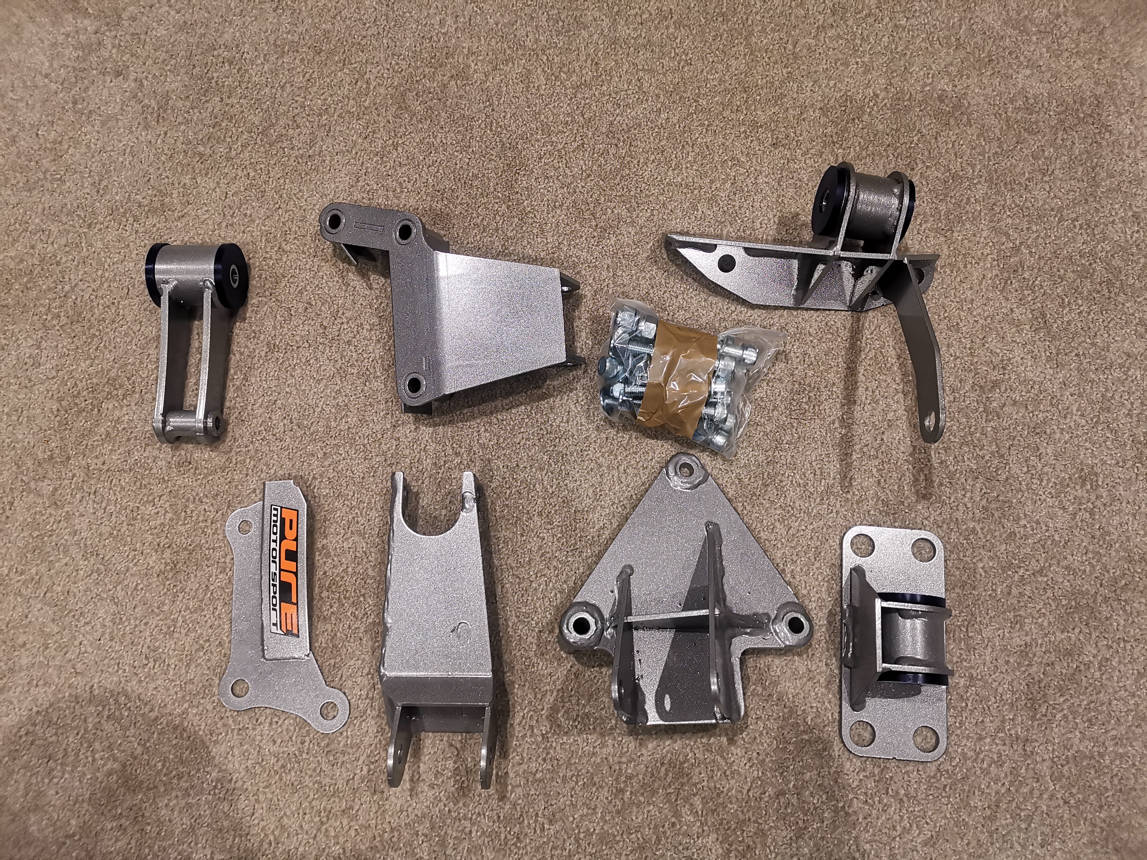

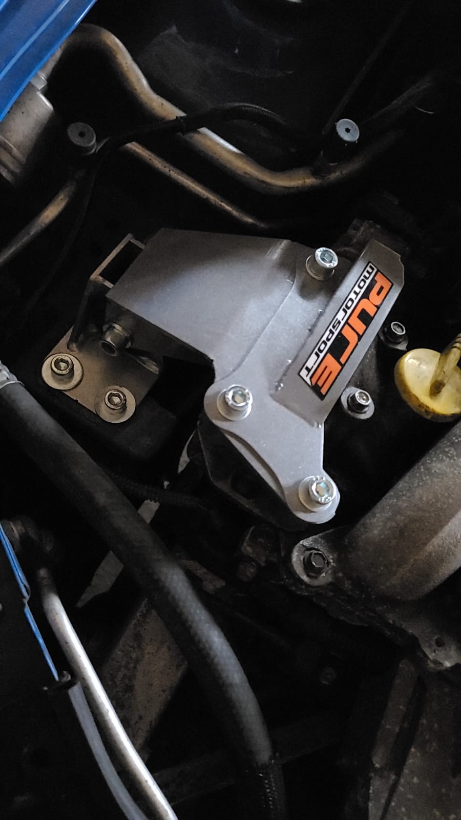

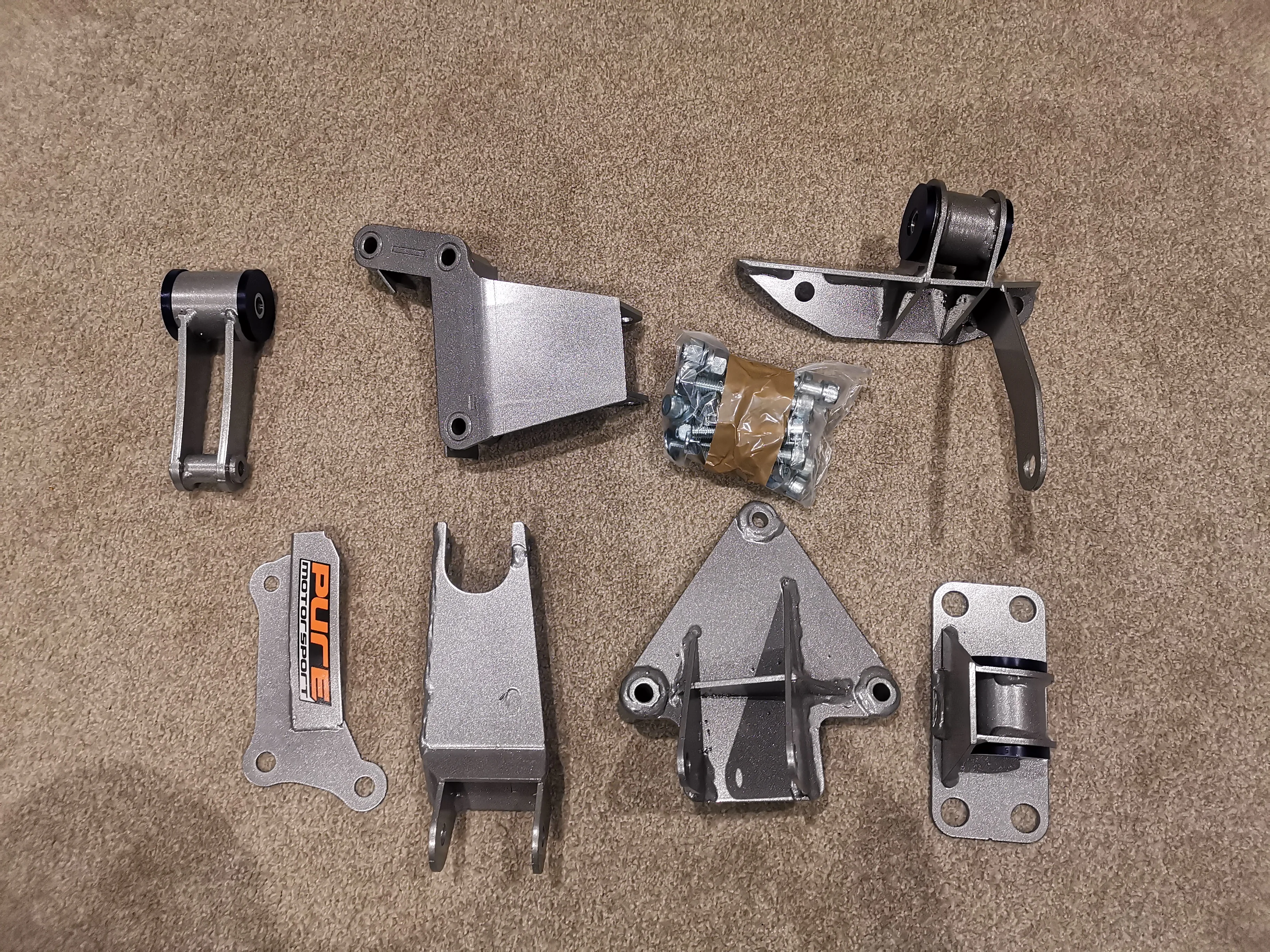

My PMS engine and gearbox mounts arrived, I'm after used front and rear strut brace, steering wheel & boss, Pms shifter and potentially a seat with mount.

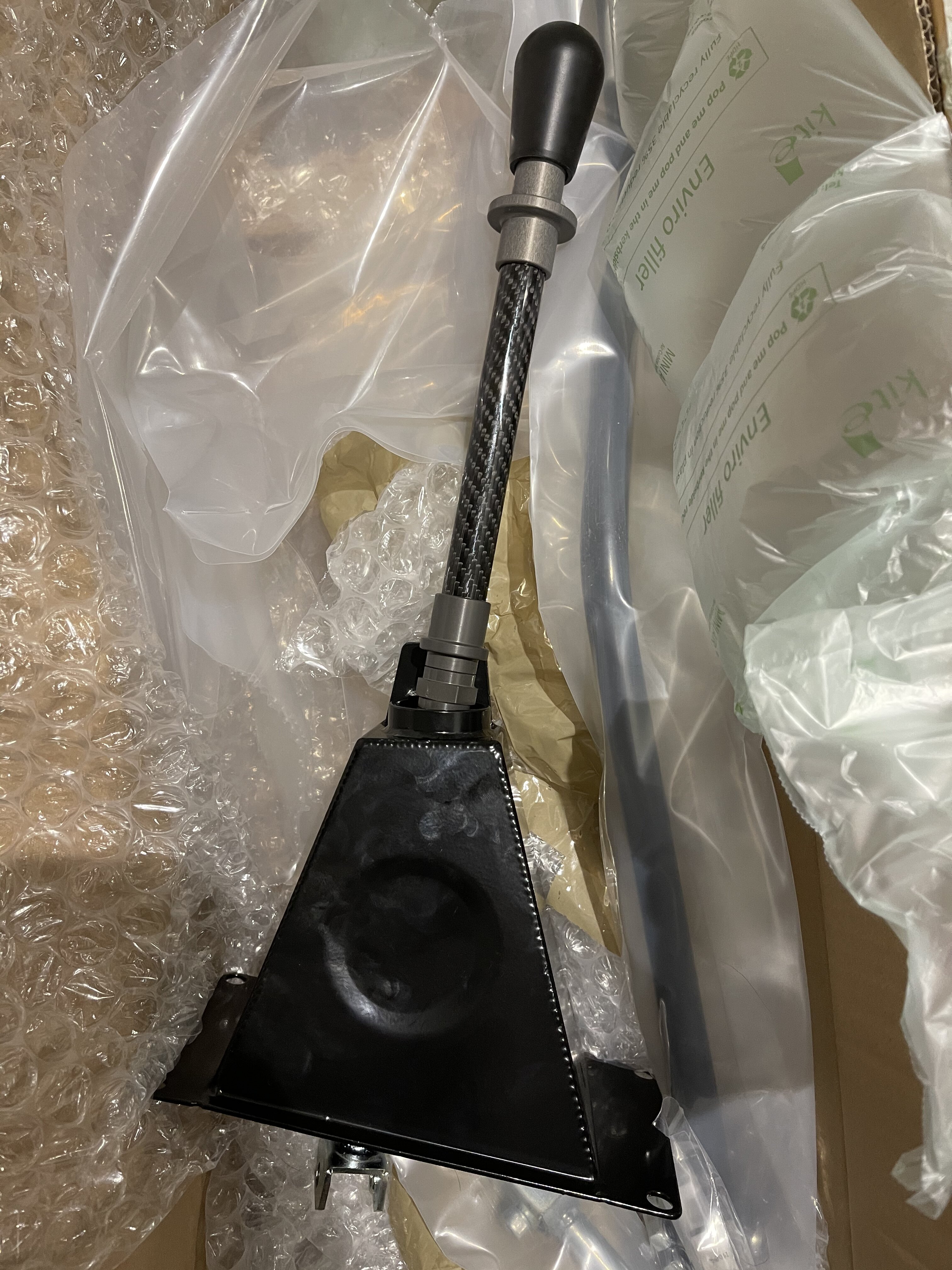

Waiting on the PMS Shifter to come, I had to order it via KTR as PMS’s website had a notice up saying they won’t be taking any orders at present due to unprecedented levels of business.
The next items I’m after are a deep dish steering wheel & boss kit, front and rear strut brace & Brembo front conversion.
Finally arrived, I’ll get it fitted and serviced at the same time.
