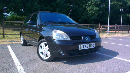

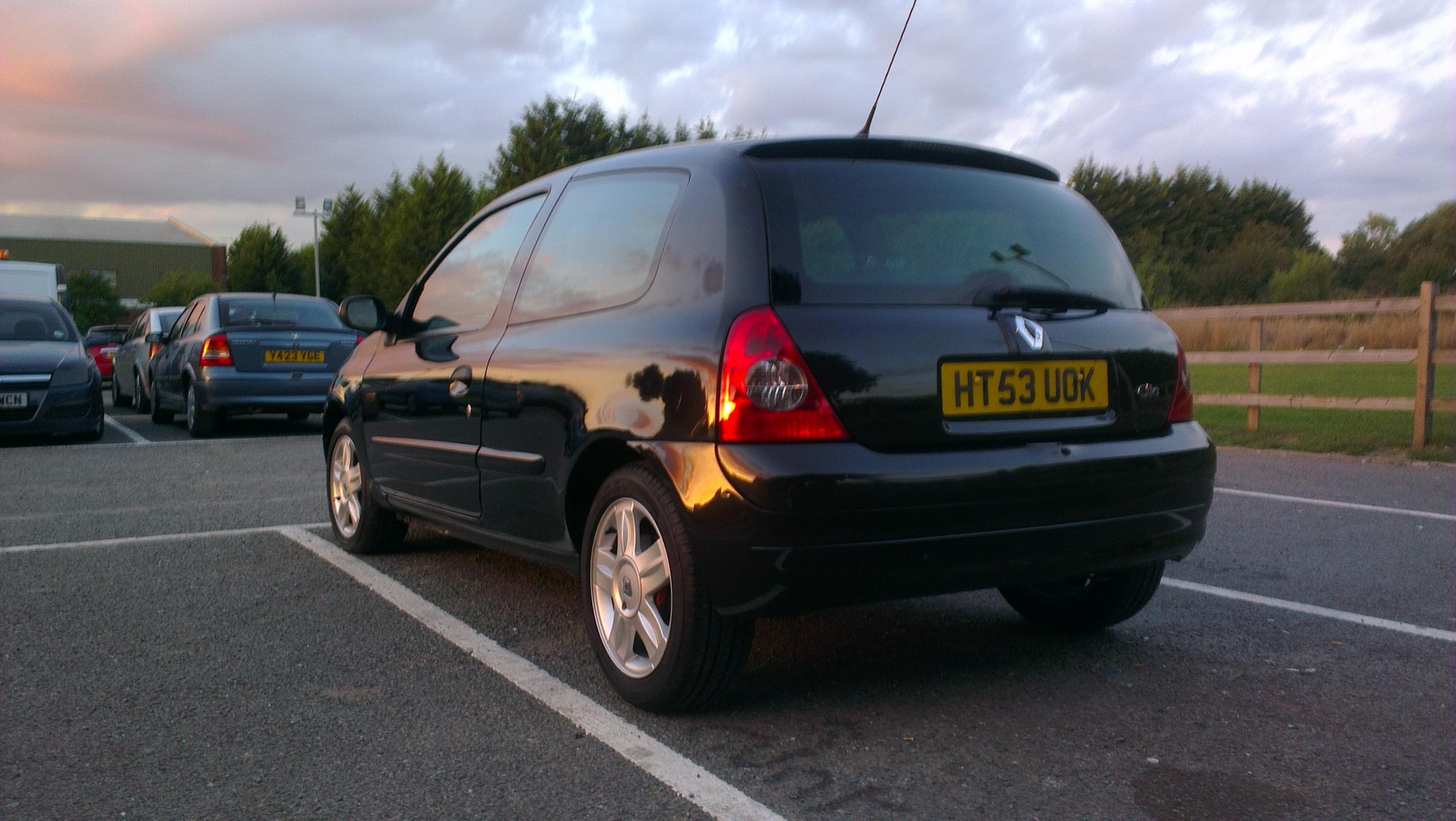

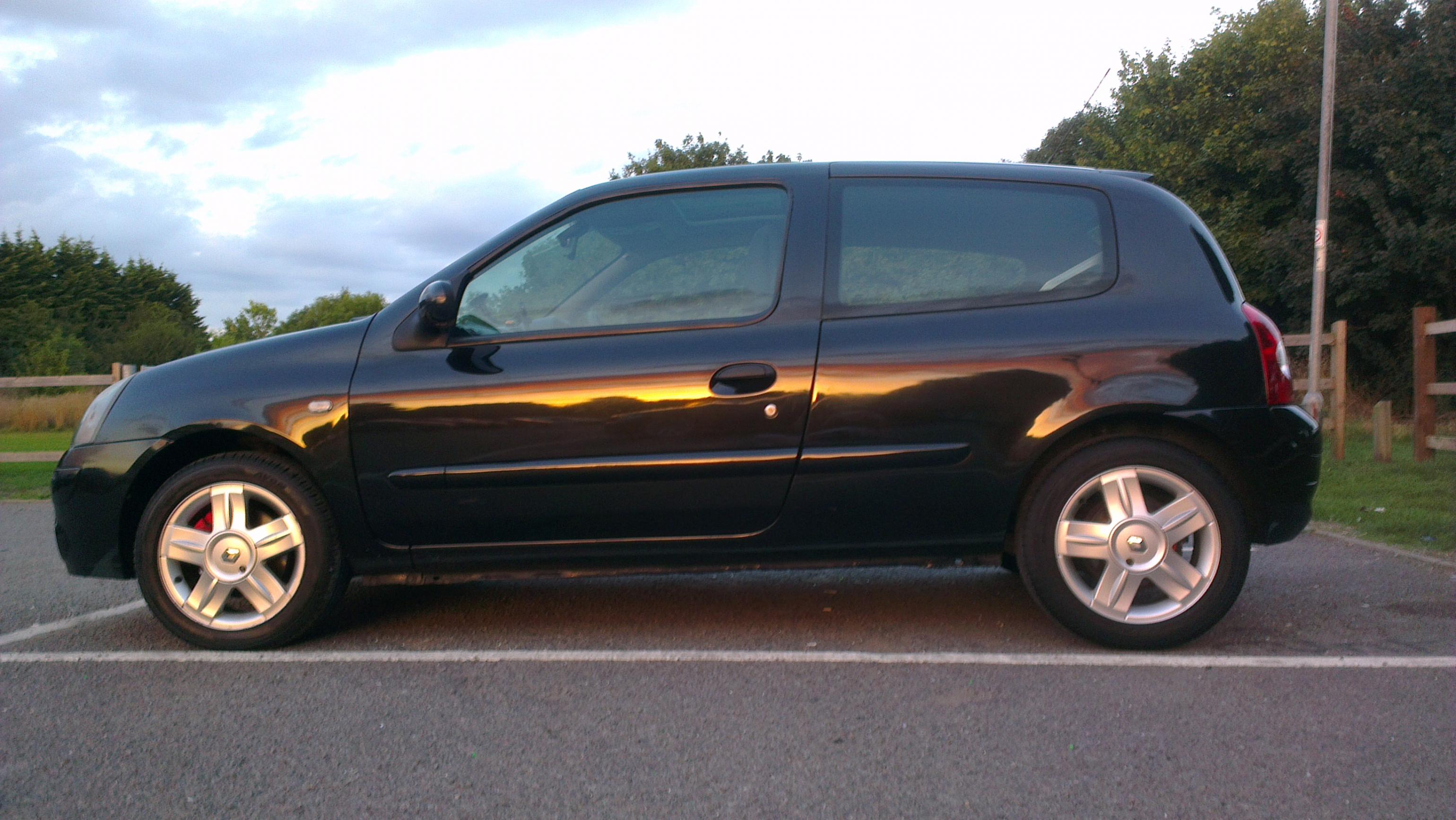

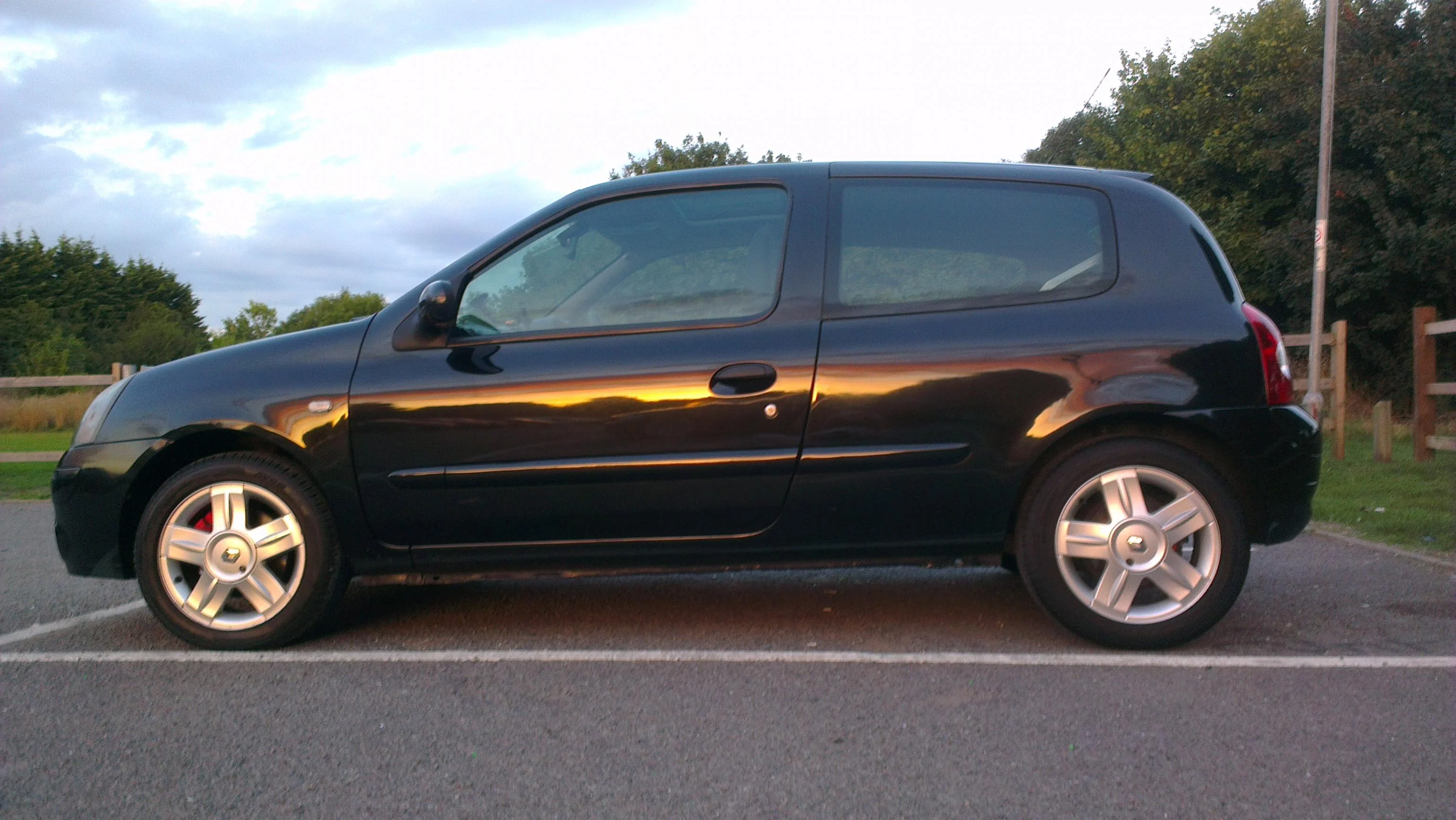

Some of you may know that I've been on the look out for a good, high spec DCi clio due to a long distance relationship, since my 1.4 16v ph1 wasn't really cutting the mustard. Yesterday, my luck paid out, and this is what I have landed myself with!
My 1.5 DCi 100 Dynamique, A few quick pictures after getting it home:

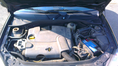

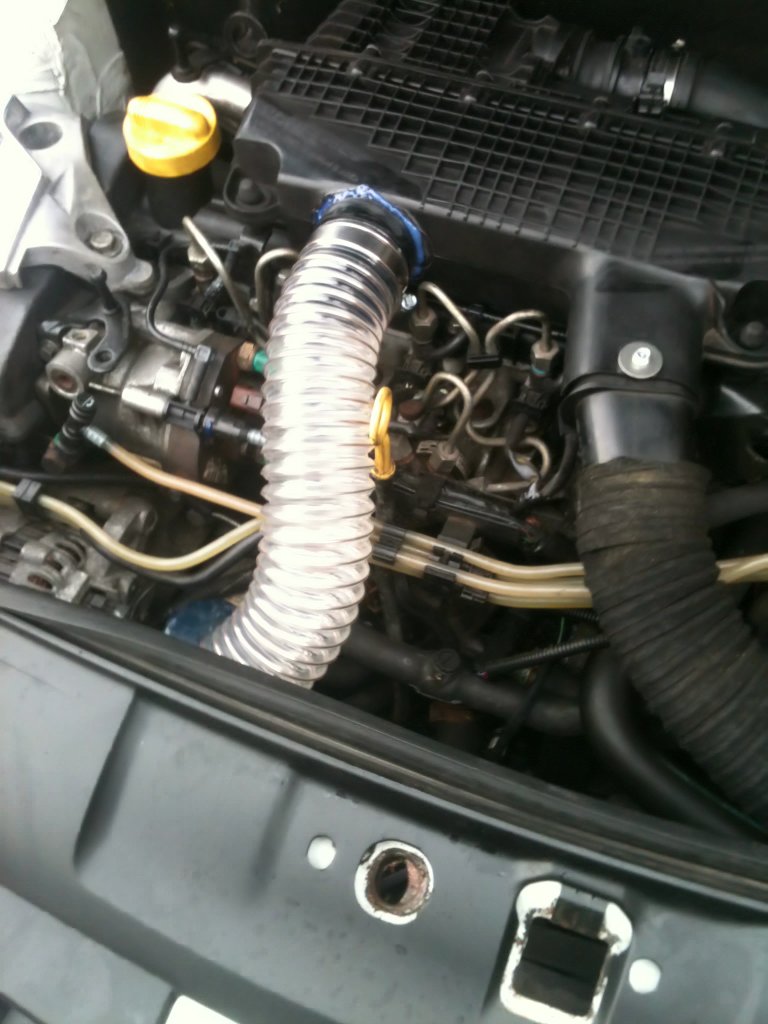

^ Notice the addition of a cone filter on the bay, and the awful attempt at cutting the engine cover for it.
Spec:
  • 1.5 Dci 100, Dynamique spec, with Electric sunroof and Climate control as optional extras
  • 74,000 Miles
  • 4 new Avon tyres all round,
  • 4 new brake pads all round,
  • 2 new front discs,
  • New battery,
  • Decent service history, is coming up to its next one.

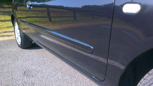

  • Colour coded back, front, and side bumpstrips

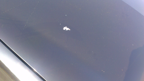

Slight paintwork correction needed, big gash on the bonnet:

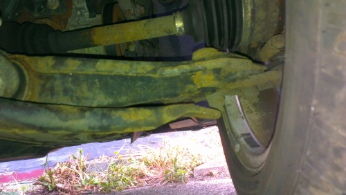

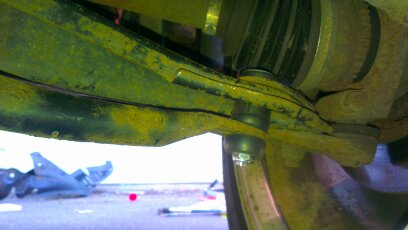

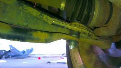

Link has gone on the Anti-roll bar, that'll be a job for the weekend (a common problem with a cheap fix as I understand):

f**k that cone filter off! Heat stroke will decrease HP
Certainly will be doing that soon enough. Will look at options for cold air feeds and the like - never had a diesel so I have some reseach to do. Will probably be doing a weekend of engine bay work, as it's possible my dad will be helping me do the Belts myself (only a possibility, lots to look in to first).

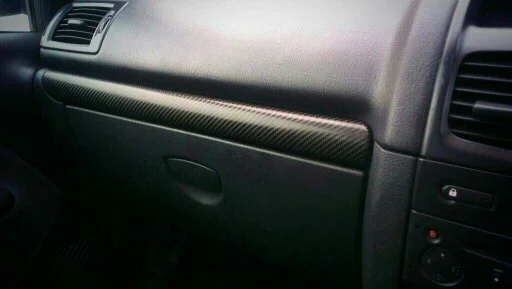

Okay, first update of some variety, despite there not being a lot to update (especially seeing as I do not have the car at the moment).
Had some carbon wrap to play around with, did the usual, will get around to front and rear diamonds with it too.

Set up a day with my dad to get some work done in terms of mechanical stuff, got the anti-roll bar pins replaced on both sides, need a little tightening, but it's improved the handling a lot.

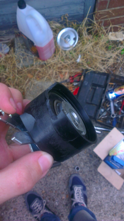

And the cambelt change is where s**t hit the fan. We managed to change the Aux belt, after giving up trying to un-do the bolt on the crankshaft pulley which was Impossible.
I gave the car to a family friend who everyone trusts with their car, went to work after seeing him make some outstanding progress in just 2 hours, come back, and he shows me this:
Not the best thing I wanted to see, so off it was to renault after Adam @ Wolverhampton had been the greatest help with advice etc, I can only wish there were more people like him in the world, top class bloke.
Obviously where the tensioner had been taken off and put back on, there was no way to determine if it was badly fitted or a faulty product (according to my mechanic friend, he says its down to there being no belt to tension it against). By this time I'd already blown over £200 on towing and the inspection fees and was losing my rag over not having the car. Gave up with renault, bit the bullet and got it down to somewhere local for a head refurbishment and everything needed just to get it back into good condition, at £950 for the whole job, I just put it down to bad luck and something to learn from (Which I really, really will.) Obviously this isnt an ideal situation, and I'm not 100% knowledgeable on the job itself, so I've just taken it as an experience to learn from.
Then, I got a call from this place with more bad news. Obviously my mechanic friend had lied to me about it idling when the belt threw, as the piston had knock the valve with enough force to crack the camshaft caps clean in two. Up goes the bill to £1650. Then my sister admits she heard him revving the nuts off it straight after fitting it. Not exactly a good Omen this car so far, but s**t happens, and you've got to move through it. Currently waiting on a head to be delivered to them tomorrow, then it will be re-skimmed and refurbished before being thrown on the car. Not the kind of bill I want to see at 19 for a car, but my family have been incredibly supportive and I can't thank them enough.
Obviously a bill that big is putting a slow on my plans! But hopefully this weekend I should have my first set of detailing gear (and the car back) so I can give it a good clean.

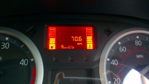

best part of the car by far. Had over 75mpg on a careful run, looking for higher once the engine refurb is done, plus maybe a remap in future, hopefully looking about 80mpg on long runs? and nice and quiet on the motorways, no drone like my 1.4.
Thats just a money saver. Its insane how high mpg you can reach on these. Small car, easy on fuel, cheap tax and insurance!

Elm light will be injectors if they didn't put them back in the same order they came out of.
s**t news about the cambelt, the tensioner looks to be smashed off as I'm guessing it was stuck on the block.
Revving the nads off it didn't do much help either with the belt probs being too loose.
Guessing the valve buckets got totalled aswell?
Hopefully they figure that out, or I might just let them know, theyre saying no fault codes are coming up though.
Tell me about it! Live and learn really. Whole new head refurb with new camshaft, valves and refurbed guides is what ive been told is being done!

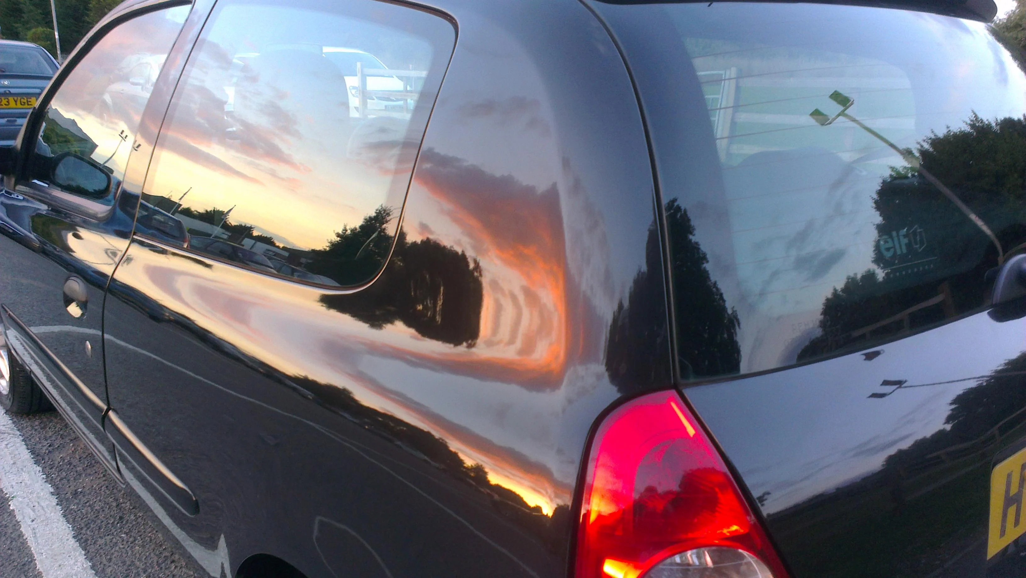

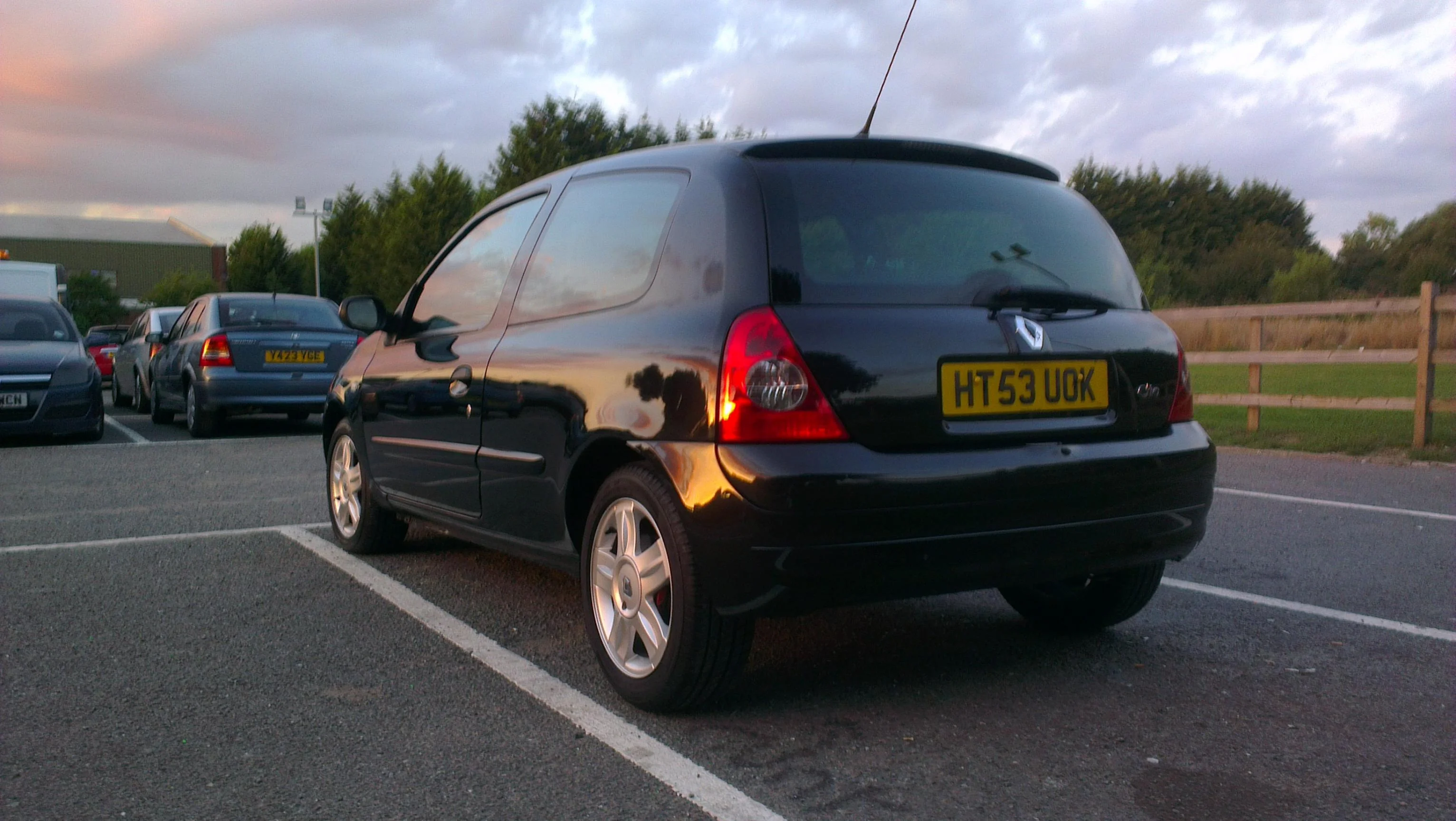

Spent this evening giving it a quick detail, Never done it before So I'm quite happy with the result!

More progress soon I hope! and a few more pictures from the detail:
Do these have rear drums or calipers? The detail looks class, black is an unreal colour but so hard to keep clean.
Calipers on the 100, anything lower is drums. (need to get around to painting the calipers, previous owner had them red.)

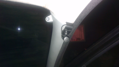

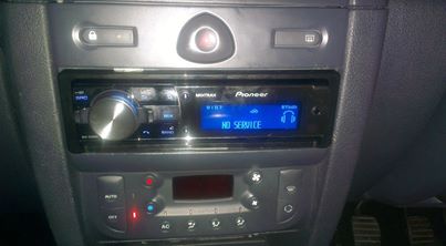

So! Headunit is in! Not a fan of electrics, lots of blood sweat and not being able to feed cables through.
Headunit in, paired with phone, cables all plugged in and away. Have a USB cable running through to the glovebox for the missus iPod and for charging my phone if need be.
Then, cable run under the steering column, up the pillar, and to the microphone.
Headunit itself is ace one you're used to it and its set up. Streams from my phone easily, really good output and adjustable EQ settings.
One good part is the backlight for the buttons/ dial and screen are lit seperately. You can pick from a Ton of colours for each, have it scroll through them all, or set them both to the same (like I have with blue). Really handy if you havent quite decided your interior colour scheme yet :)

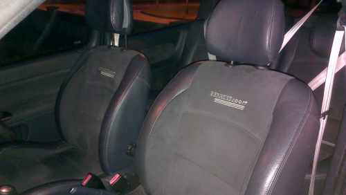

Update! Thanks to Billy and his mate, we (they) managed to fit all of this today!
So both interiors out, both back in to the opposing car. Just gotta clean mine up, some love to the leather, give it a hoover, and sort out the airbag connection for the passenger seat at work this week. Tidy! C&C welcome as always.

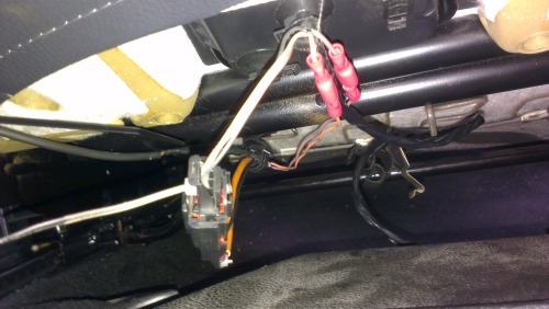

Just wired the orange-orange and brown-brown cables since they had none of the plastic connectors, still got an airbag light. Anyone got any bright ideas on how to solve?
Cheers for the heads up rob, will take a look!
Rob
Is it both seats you're struggling with? iirc there's quite a few more wires under the seats than just that. It's not too hard to find diagrams (they've been posted on here) that should allow you to connect everything up with bullet/spade connectors or even connector blocks and hope the problem goes away.
This is how me and a friend in 2nd year of our apprenticeship attempted it:
Not the best picture, but just basic connectors. I have a feeling it will be the resistance that is the problem, Iirc anything over 4Ohms is recorded as the airbag having gone off.

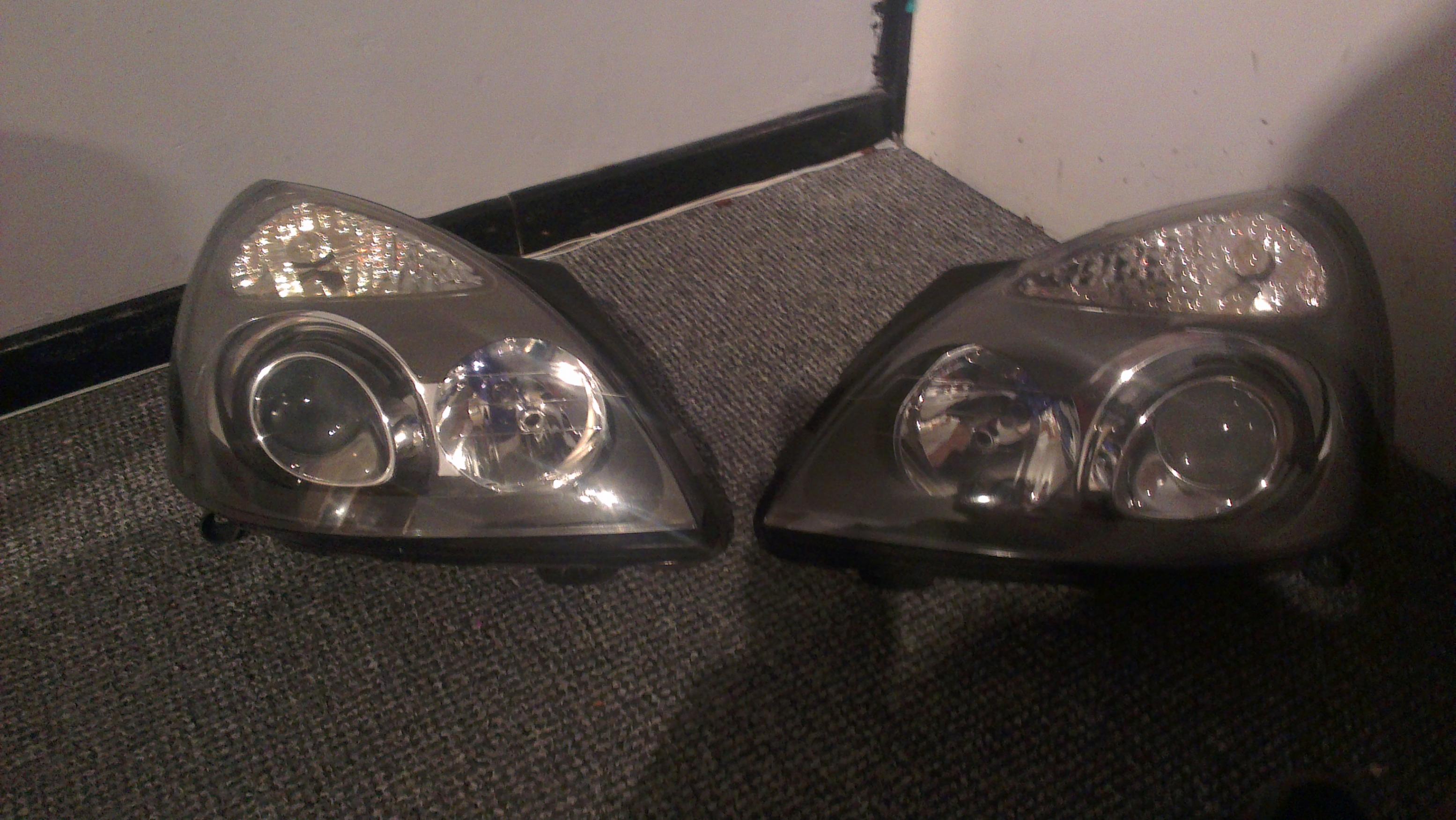

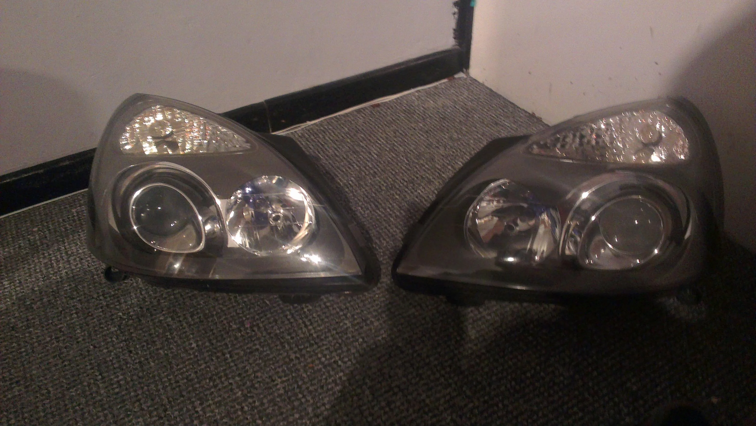

Well, I just happened to have picked up these!
Quickly threw some C2v3 on them as some basic protection, will get them on when I can get some ramp time at work :)
