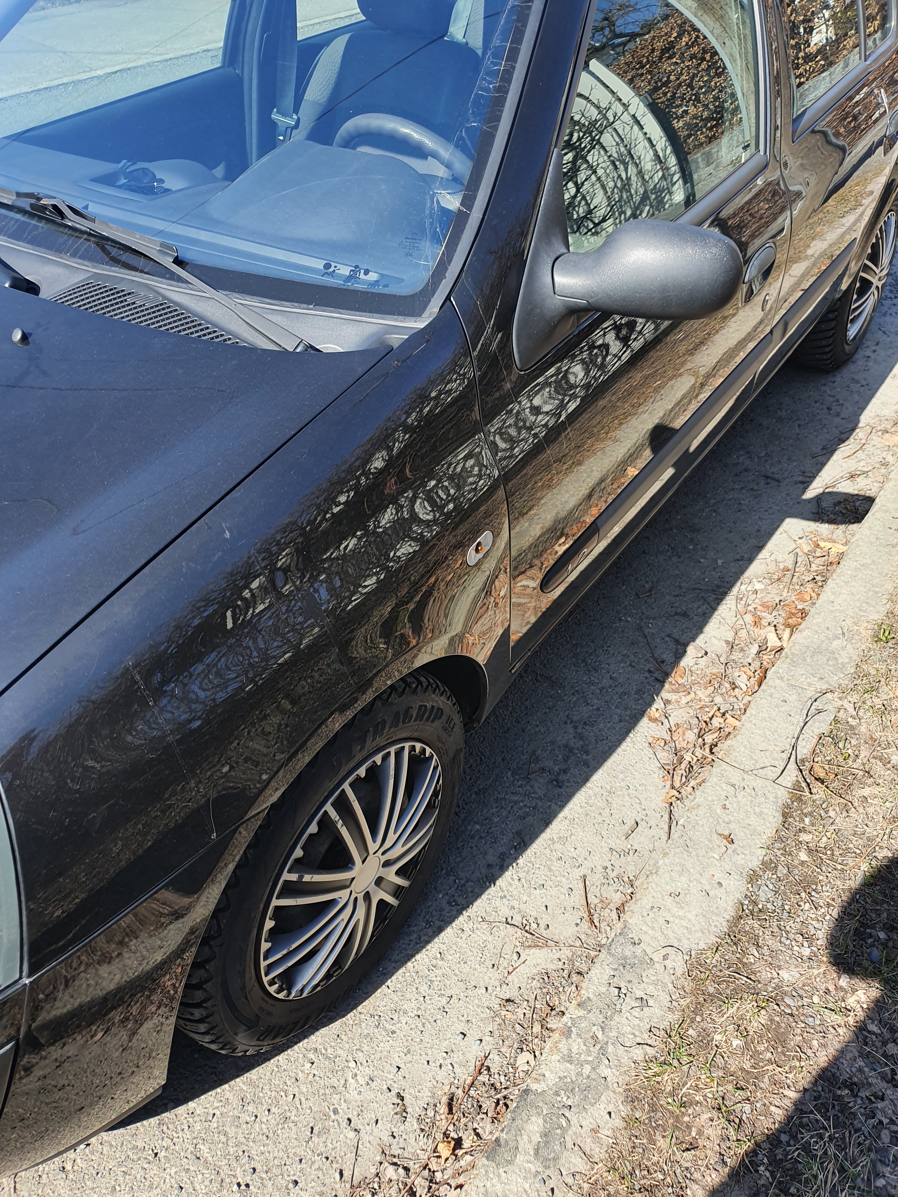

I have ordered new turn signal lights for the sidepanels, since i've lost the clearglass on one side.
But what is the best way to change those? Go from the inside the wheelweel or pop them straight out?

I'm assuming you mean the indicators on the wings? Get a flat bladed screwdriver and pop them out. Put a bit of tape over the paint so you don't damage it.
When popping them out just make sure you dont put the screwdriver between the housing and the plastic see through bit as its just glued on and will separate pretty easily.

Included a picture of the broken one.
