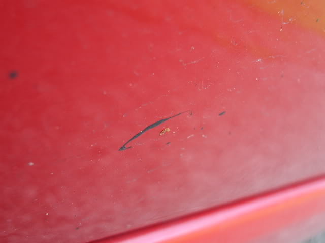

Looks like this BTW (excuse the rest of the dirt on there :eek:)

black clumps of black s**t.
Can use clay to reove it or you could use a tar remover. Halfords do Autoglym tar remover but there are better available like Tardis which can be found at polished bliss.
it's just the bitumen/tar from recently resurfaced roads - gets thrown along the bottom of the sides of the car. you can wipe it off with petrol if you don't fancy spending £5 on 325ml of Autoglym's tar remover
