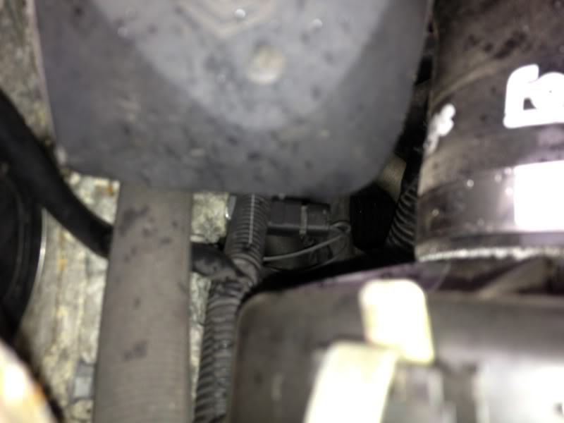

Ahh rich you say.. Mine doesnt seem to have as good mpg at the mo so could make sense. Thanks gents. Where is the coolent temp sensor? Also, where's best to get one? GSF?

Thanks again. So it this the CTS?

The right part for what? We're talking about the coolant temp sensor. Your problem may be the thermostat.
Ah wrong part then guessing I need the coolant temp sensor as the gauge is reading 1 block lower than the middle
