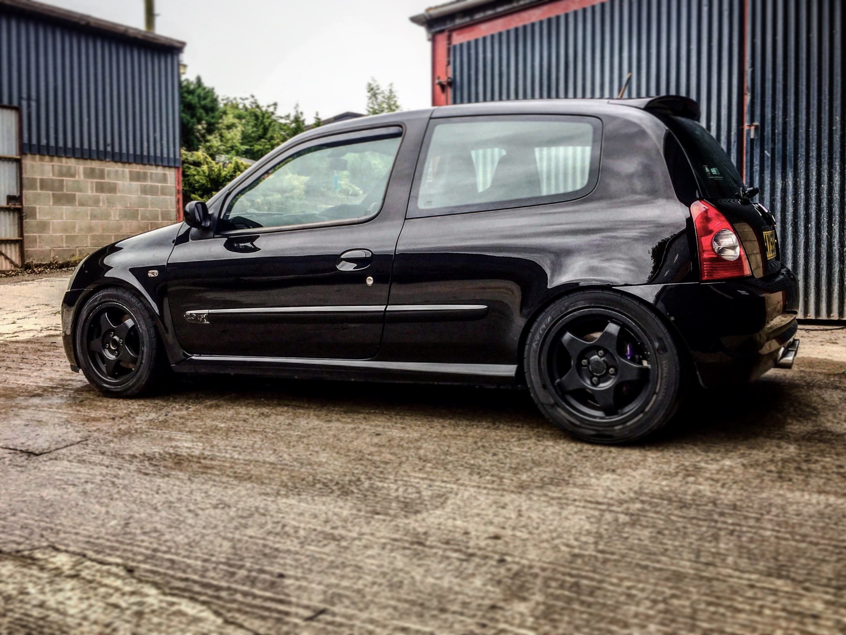

That 182 looks stunning - what wheels and tyres were you running in that photo?
EDIT - Tyres look like AD08R's - awesome, I have them on mine :)
