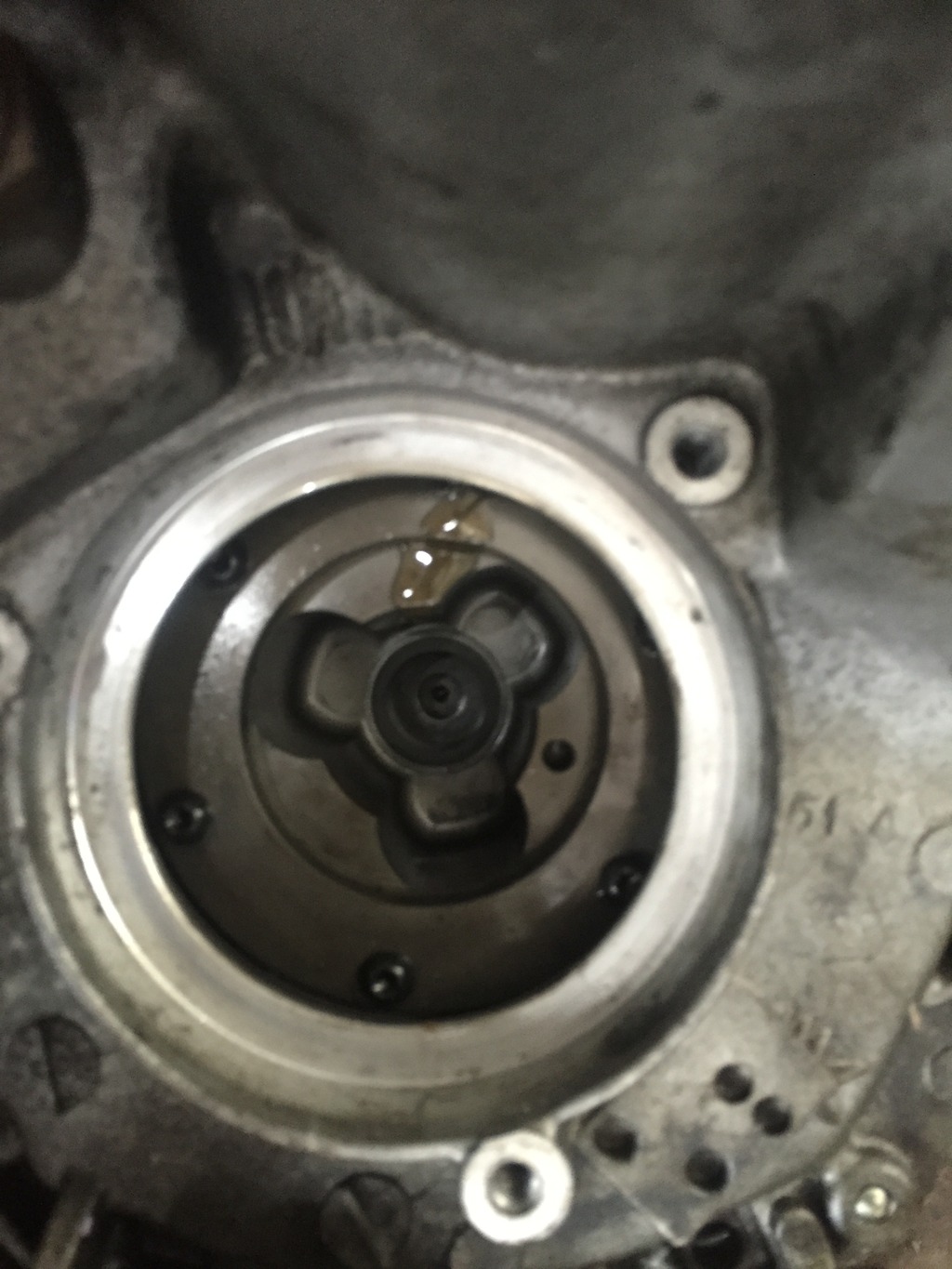

Pop the drive shaft out. If it looks like this:
You have a quaife
  Clio 172, Escort RST
I was under the impression that a Quaife ATB could not be tested via conventional ways making a visual inspection the only true way to see what it is.
