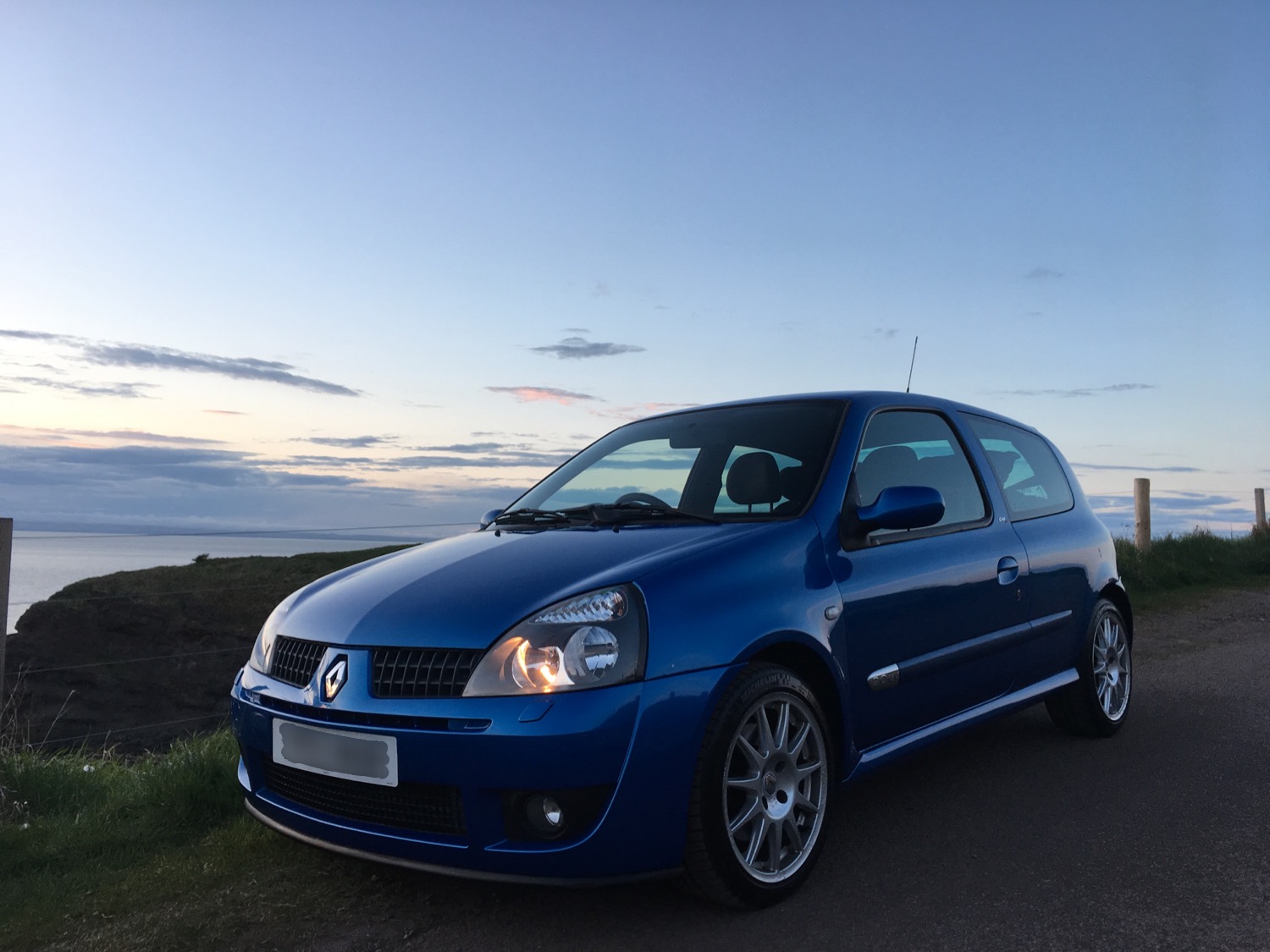

Following Ben Lowden's Clio Trophy and 172 Cup articles on Pistonheads I couldn't resist this car which appeared on Cliosport locally around the time. I had a bit of a dash to get there before 2 or 3 other viewers but made it and bagged a bargain for my runabout. The previous owner had it for 7 years and was only getting rid as his misses had forced him following the purchase of an E92 M3.
I had previously been an Impreza fanboy, eventually owning a P1 for a few years before marriage, kids and mortgages took priority. My brother had an R26 so I got an eye for what a comparitive bargain Renaults are in the performance world.
This car was on 114k and needed belts hence the price but the engine, brakes and handling were fantastic.
I've had it almost 3 years now and it's sitting on 126k. I had hoped to upgrade to a Megane 275 this year but another house move put pay to that and I've decided to maximise and enjoy what I've got.
Steering was feeling a little dead and it was understeering and bouncing a little at the rear when pushed. Last week I booked it in for a suspension and steering refresh, Cup dampers, lower arms, ball joints, bushes, track rod end kit. Wow, what a difference. Back to the pointy, direct and responsive car I loved. Not bad for £400 in parts. I didn't fancy having those sensations diluted by a steering wheel which was melting away in my hands so got Jack at Royal Wheels to do a nice retrim for me.
Loving the car and I would highly recommend it to anyone who is considering one. These cars are definitely a little bit special. Here's my spec:

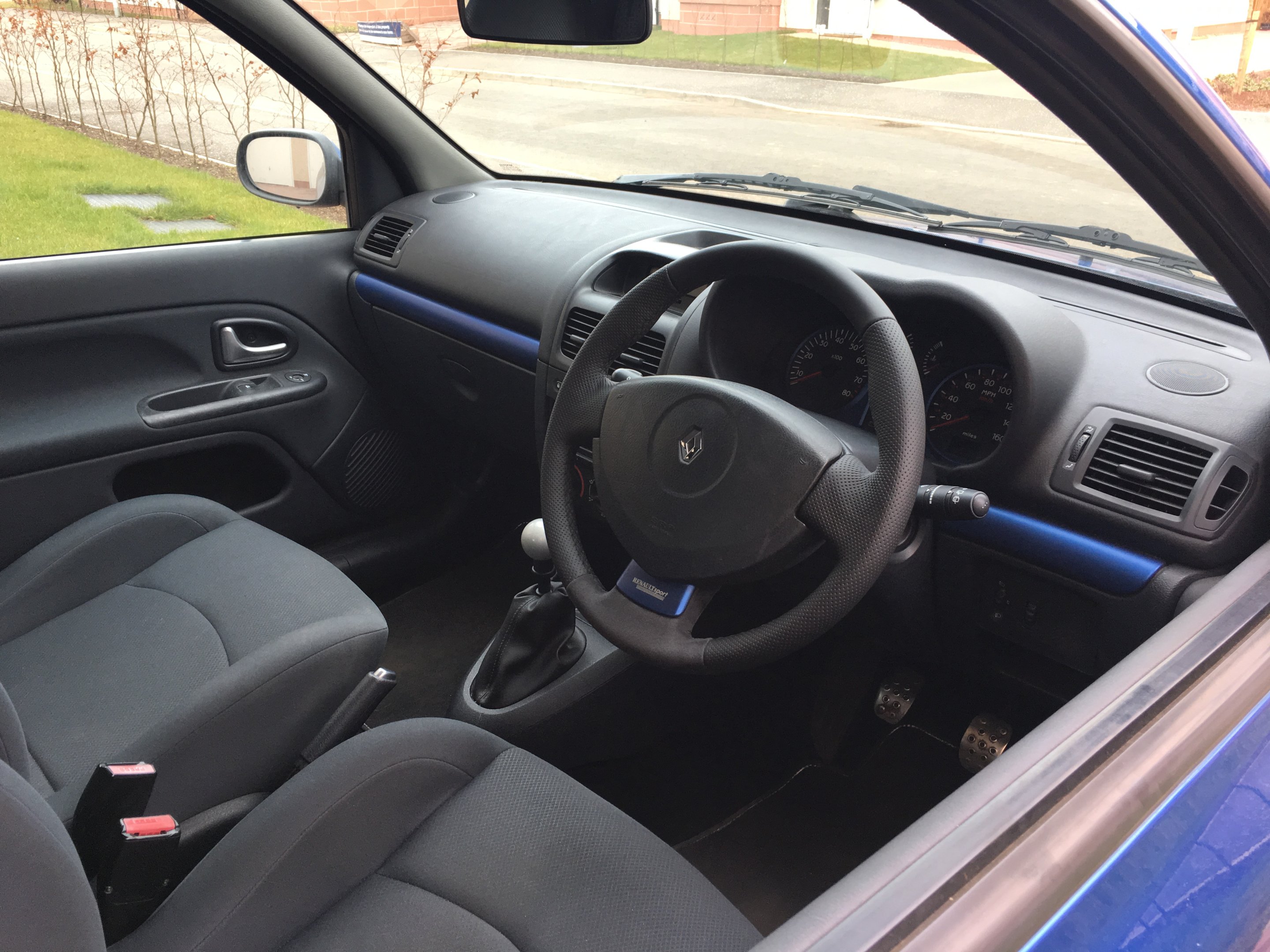

Looks in such good condition! Lovely steering wheel really finishs the interior off!
Kosy
  172 Cup
Thanks mate! Yeah I've been grinning like a Cheshire Cat with it today. Just put it on at midday. What a difference to the interior!

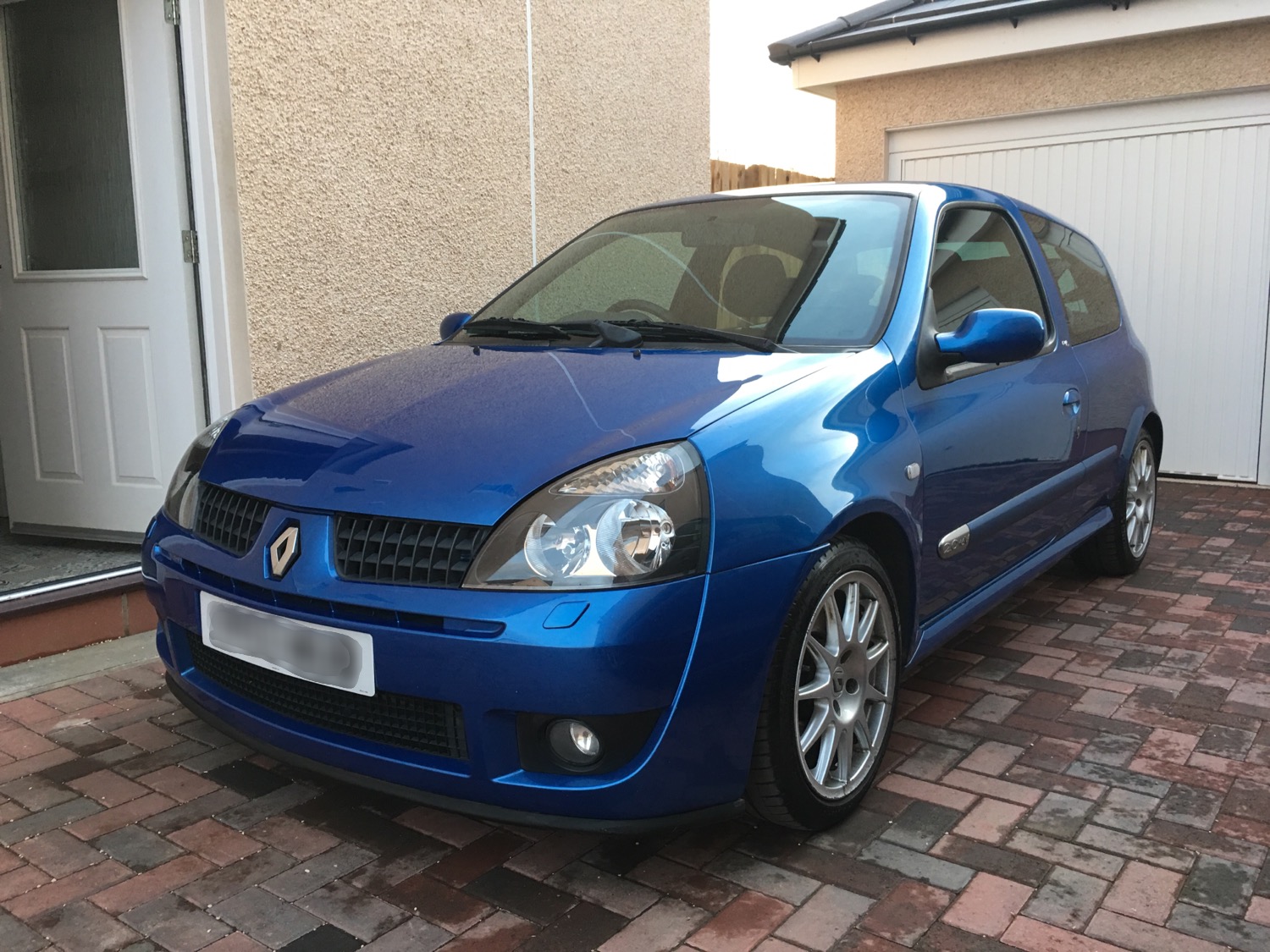

We are £1000 cup buddies. I had my wheels done at pentland powdercoating they did a cracking job mine were crusty as f**k. Very similar spec to mine as well. I'm tempted to go for b14s or similar to get it a bit lower, mines on eibachs sportlines, but it handles so well I don't want to ruin it. Steering wheel, rear arb, more extreme tyres are on my list. They are great little cars always puts a smile on my face driving it. Watching your thread with interest.
Kosy
  172 Cup
Haha! I saw the pics of your car and thought yours was more in the £3k+ bracket lol! It looks a beaut.
I've had my other car done at Pentland, like you say, great job. Definitely next on my list. Once I've done that we should get them out for a few pics.
I'll be very interested to see what yours is like if you go with the Whiteline and / or B14s. Money no object I would be on them now but now the work is done it's perfect for what I want so I won't be changing (till I try it on track probably!).

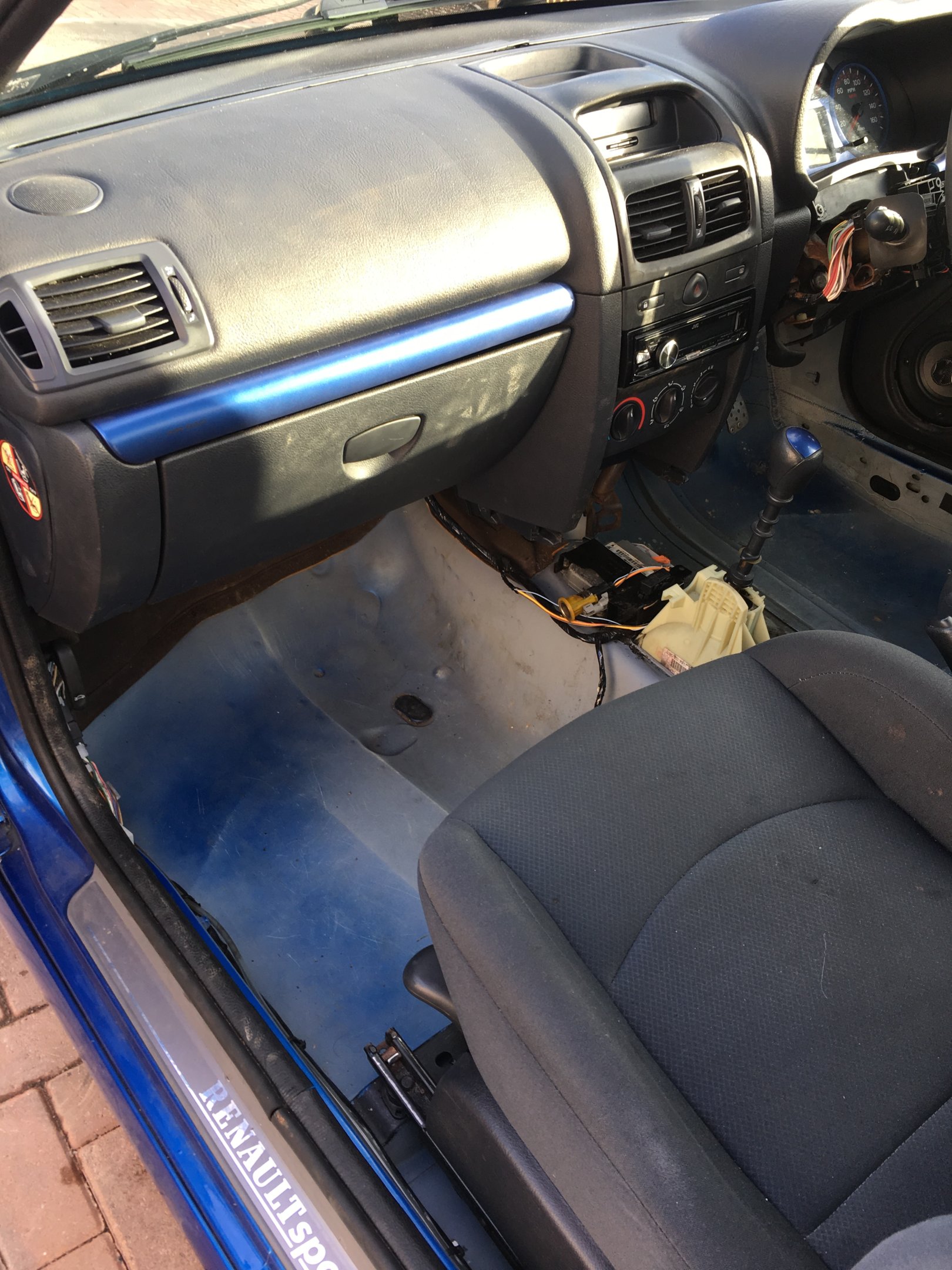

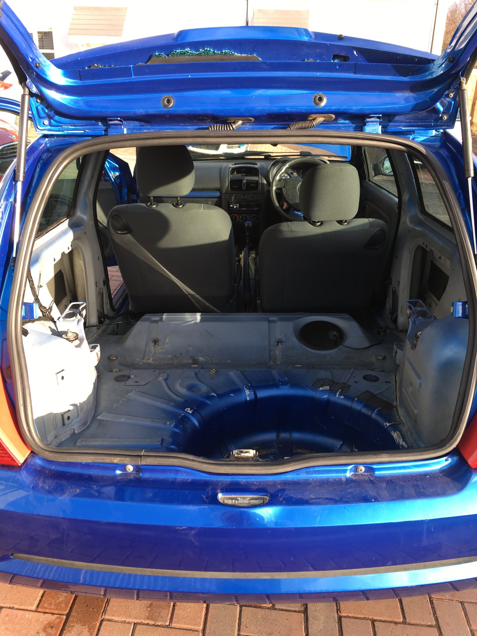

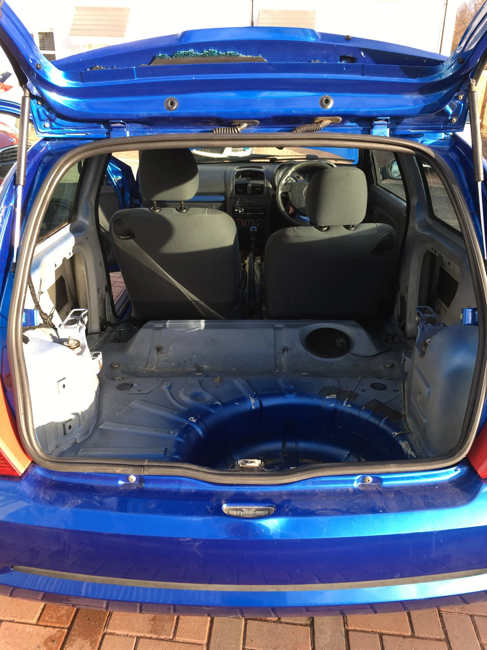

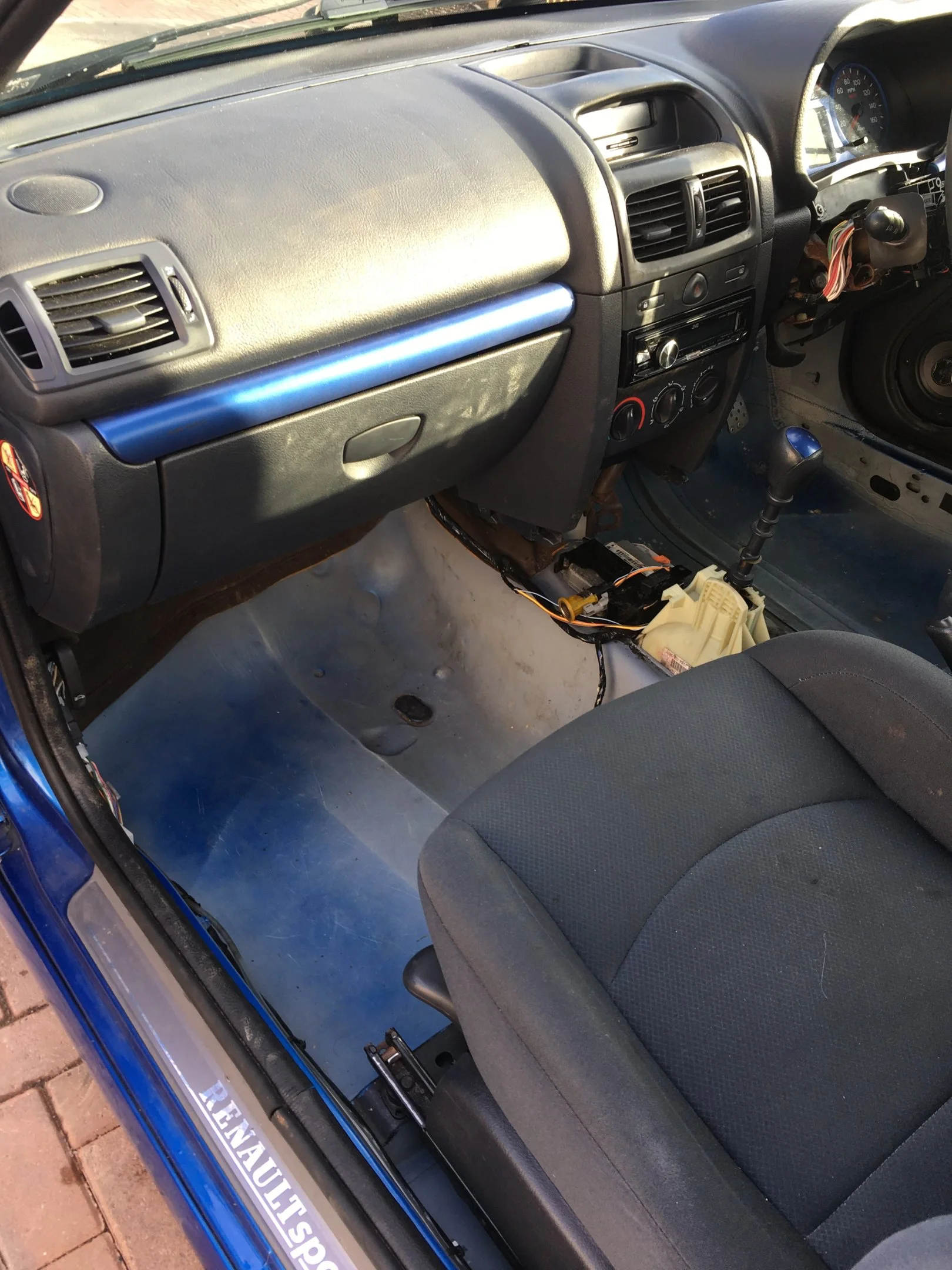

Ill join the convoy to Knockhill in my stripped 172 cup
SiMunn
  n/a
9EAB05C8-4126-43F7-8839-153401B2F7AA.jpeg 57F87713-FE52-44F4-A6AE-D0DA6DCD2990.jpeg
No Glasgow.
I’m in the process of stripping everything out before it goes to Rentec to have everything checked over and upgraded ready for the Nurburgring next year!!

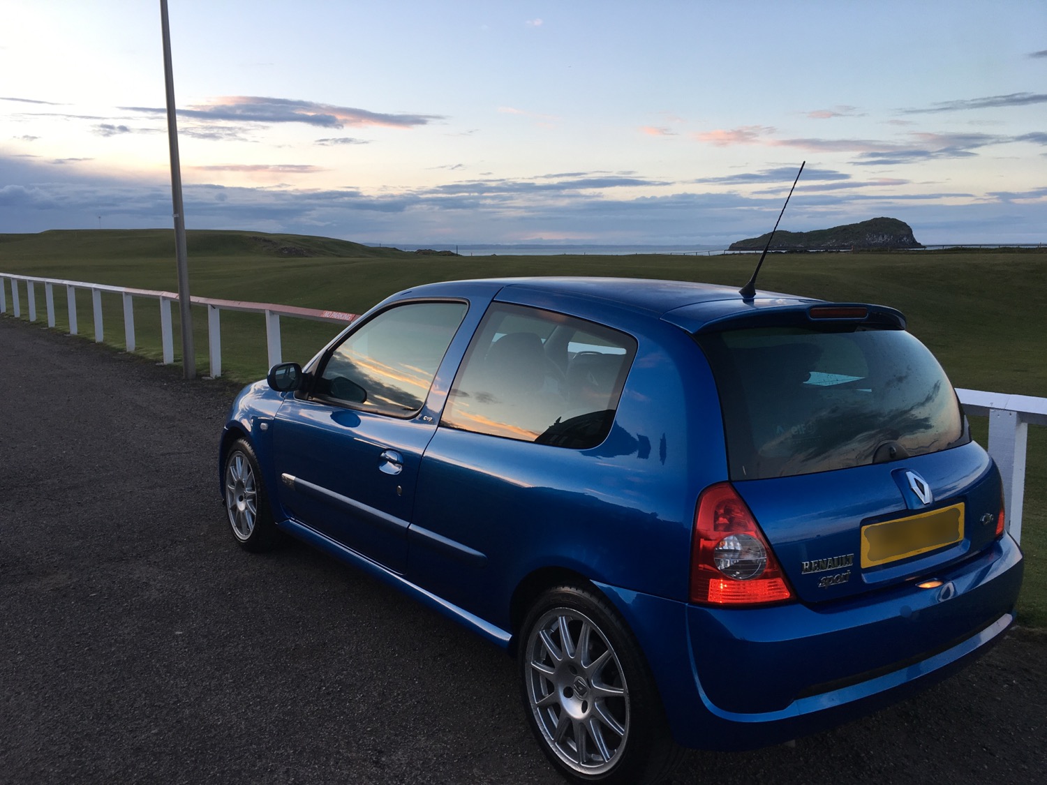

Fairly busy month for the car. Had a slight issue with the new f/n/s ball joint which was knocking and was replaced FOC without question by Rentec and done as a matter of urgency. Top blokes.
I also learnt an embarrassing lesson by suffering a misfire for a couple of days following rinsing the bay off. Blew the water out the plug wells and all perfect again.
Car was back in for service and MOT which it flew through after fitting another set of Brembo HC discs and Mintex 1144 pads up front. Car is feeling spot on.

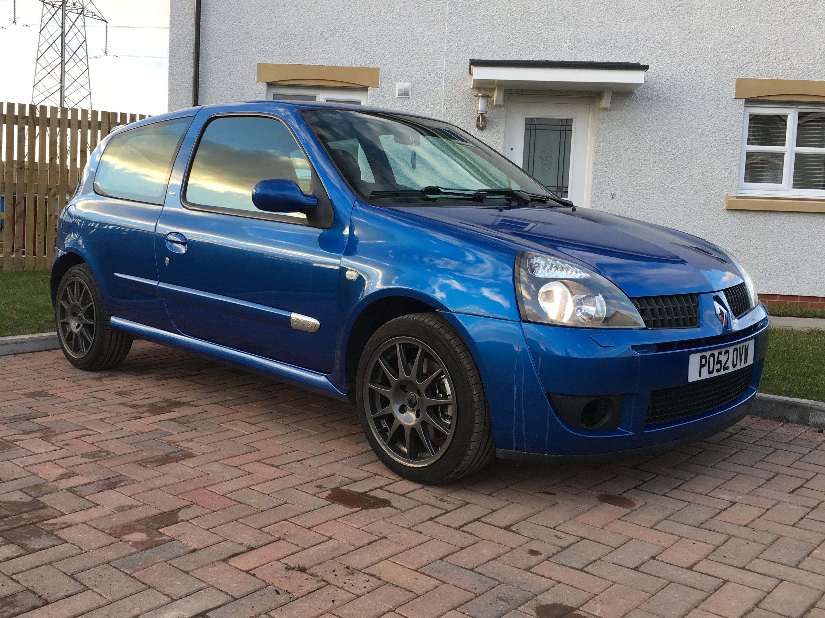

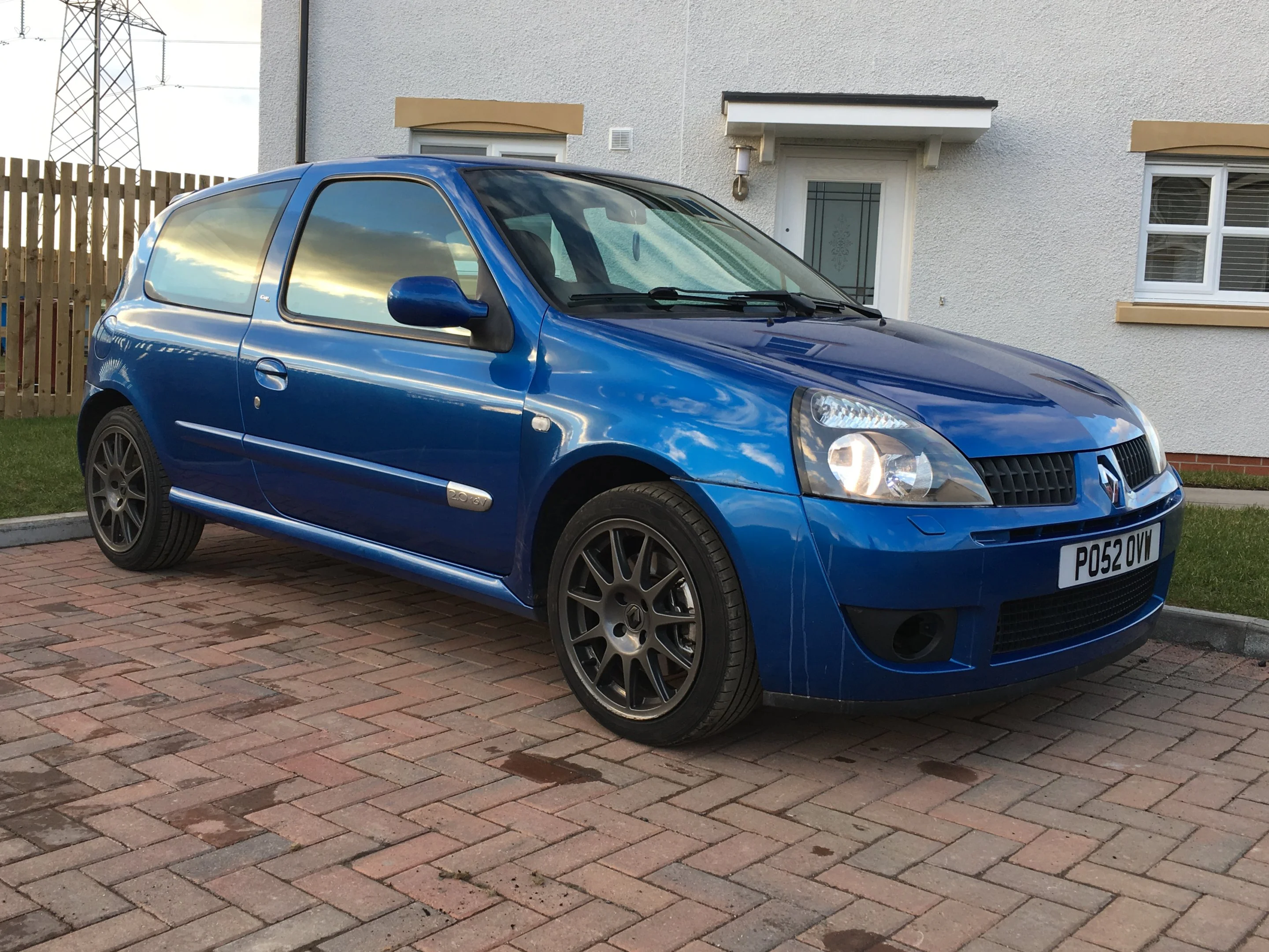

Nice weather gave me an excuse to give it a proper polish for the first time this year. Obligatory pic of course.
yeecup
  mk8Fiesta ST,172 cup
Mate that looks amazing. Great pics. I'm planning on going to tartan Tarmac breakfast meet at knockhill this Sunday give me a shout if u want to tag along.
