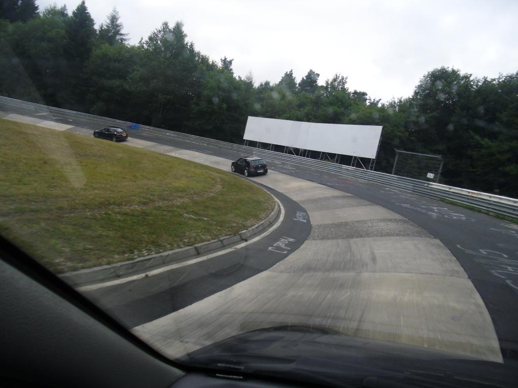

After picking up the car last Friday it got put to work on a trip to the Ring, most enjoyable road trip i've taken if you ignore France and can hopefully make it an annual trip. Didn't take a huge amount of photos but managed to find a few from the Ring photographers:

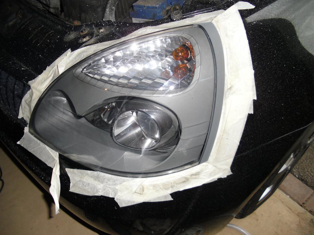

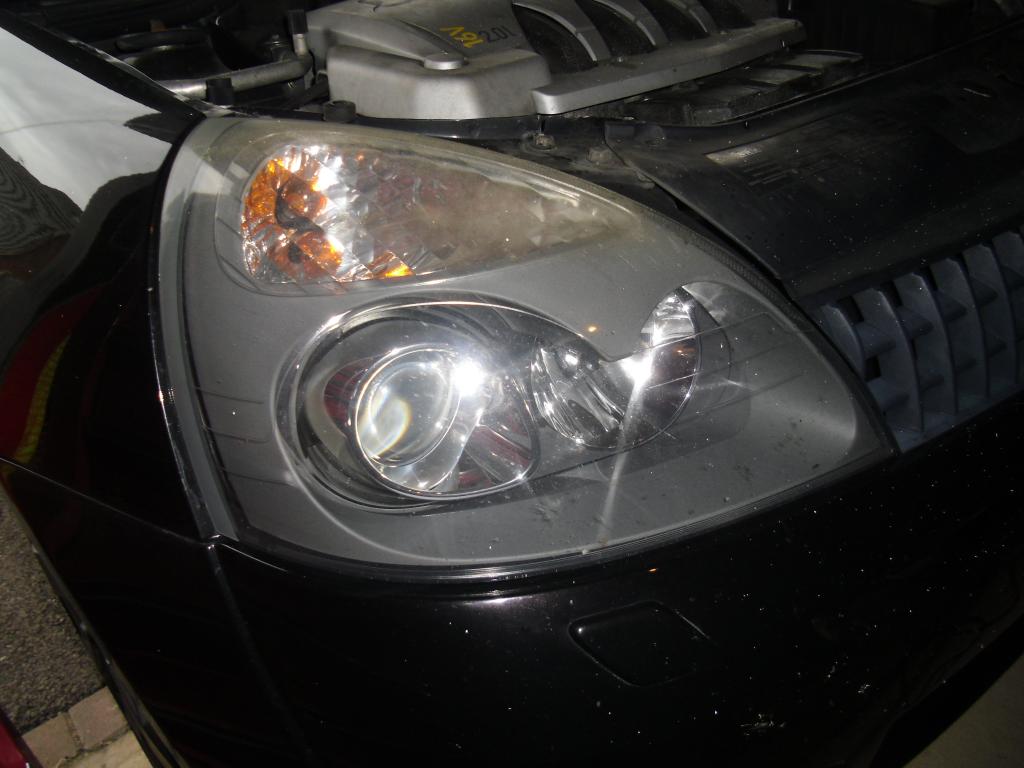

Had a bit of free time today to sort out the headlights as they are the only part letting the exterior down, still a little work to do on the right headlight but may need a harsher compound as it seems more affected than the left. I used Meguiar's paint cleaner and clay to prepare the headlights and a range of Meguiar's cutting compunds and polish applied with a rotary polisher to get some life back into the headlights. Still need to seal the headlights with some UV protection but that can be done next week:
Before
After

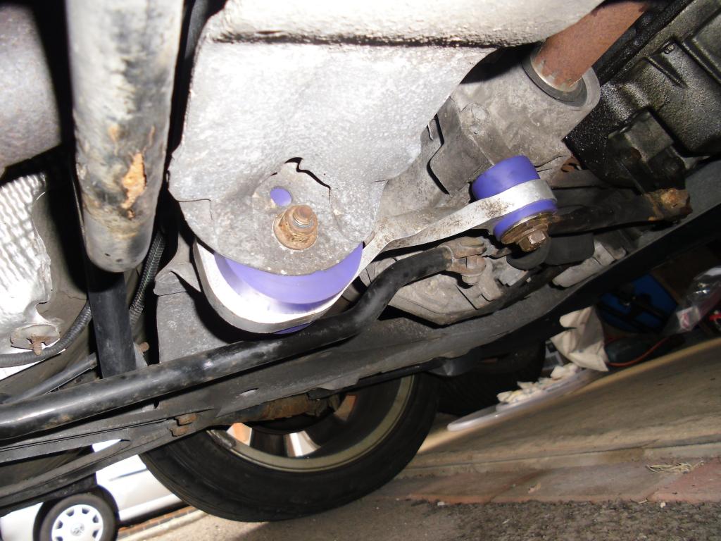

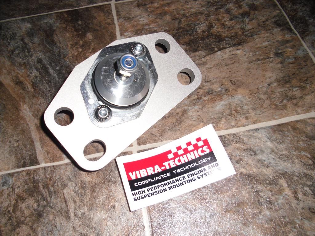

Only 2 problems im currently noticing with the car is the brake fade and weak engine mounts, have ordered some bits to resolve both issues and this is the first to arrive:
  182

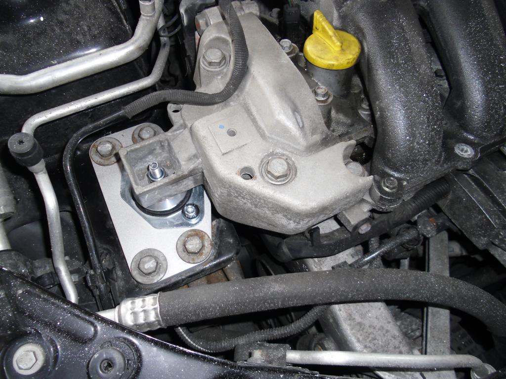

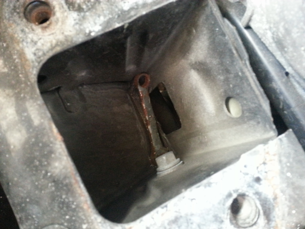

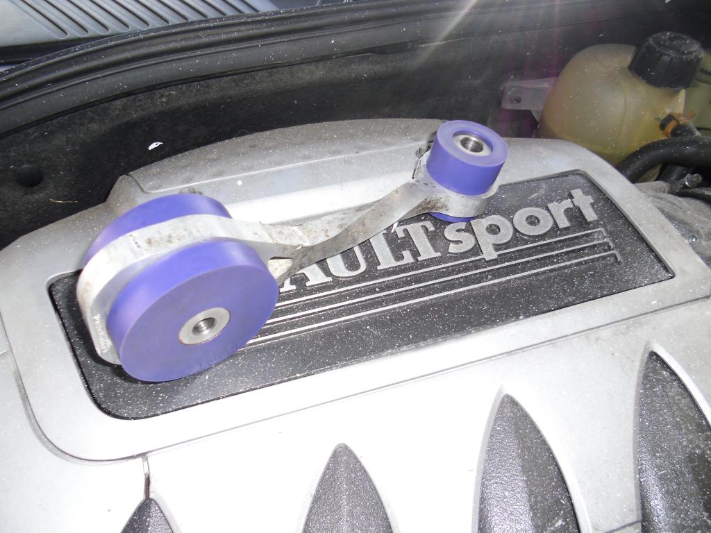

Couple more bits arrived in the post today so spent a couple of hours this afternoon fitting the new top engine mount and dog bone bush kit from Powerflex. Still need to order the gearbox engine mount but that can wait till next month, I just hope the stiffness of the new mounts doesn't kill it off before that:
Found a spanner when removing the old top engine mount, no idea how it got in there but on the plus side there's now 1 less rattle :)
