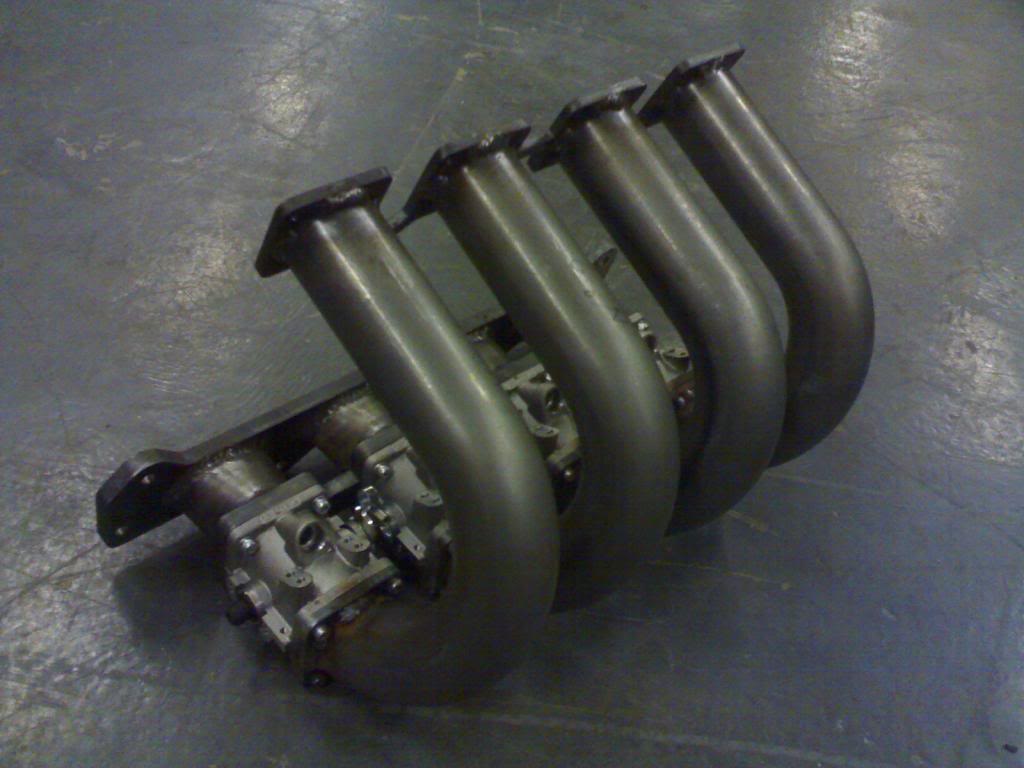

Yes indeed. Not going to be quite the same, but a similar setup. All about length, short runners kill torque

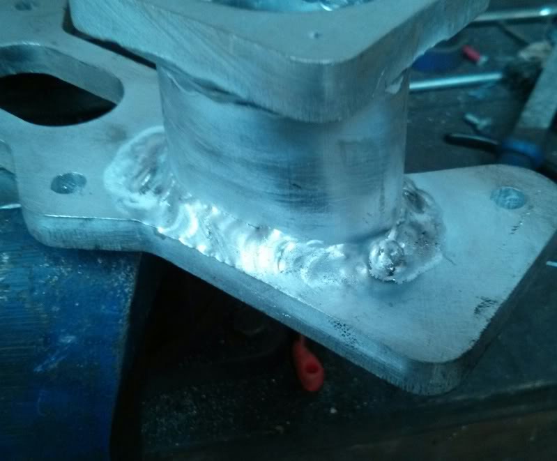

Had a bit of time this afternoon. I've never really done much TIG or Aluminium welding, so taught myself with a cheap chinese machine, and a load of scrap ofcuts. This is the first thing I've made and I'm quite pleased really. Not about to win any prizes but it's strong and fairly tidy.

That looks very tidy for a first time, very smooth but a bit wide.
Ally welds are wide though?
Looks good that Dan for a first attempt, hardly any undercut which is hard to achieve. Your ripples could be more uniformed but I would be happy. Was that tig you used or oxy acetylene?

TIG. Its thick to thin which is harder so I just chucked lots of filler rod at it which made welds a bit big but I've paid for worse lol

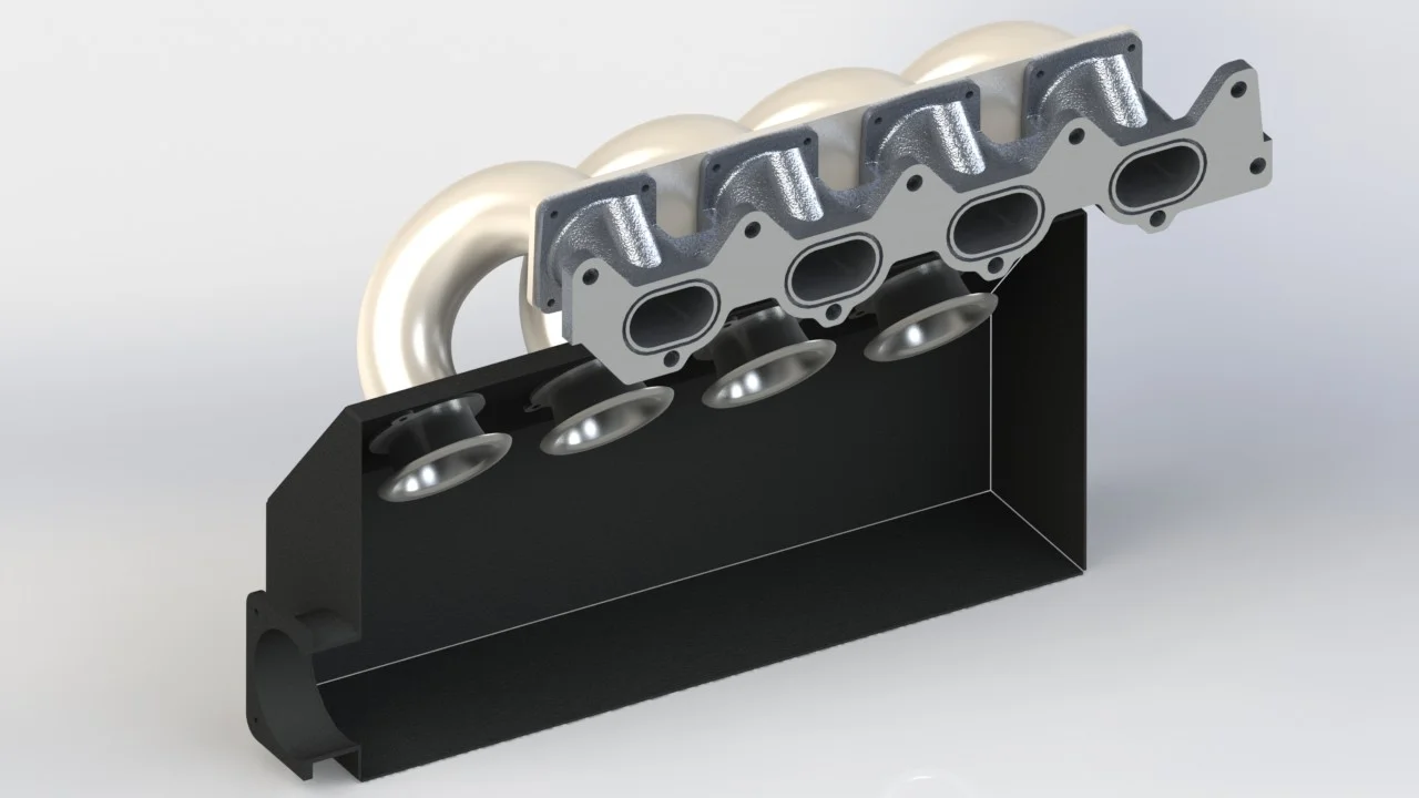

Got a fair way to go, ECU work hasn't even been started yet, but got some pretty cool tricks to incorporate

haha, I wish I could do CAD mate, have to rely on some very skilled friends for that, and design things in my head if I'm making things myself

Hope you finally get this into a production kit that goes on sale, ITBs really bring the mk3 alive on track!
I'll be keeping an eye on the thread, I'm sure it'll be a great project.
Dan, how did you get the to go from round to oval? I need to do this so any tips appreciated.

Machine something to go in one end of the pipe or a good fitting socket etc and then bend the other in a vice I'm guessing?!?

​Sounds a bit cave man style, but would work I guess.

pretty much exactly as you said, just crush it a bit at a time in the vice until you get the desired shape. I tacked it together then adjusted a few areas with a hammer and drift
