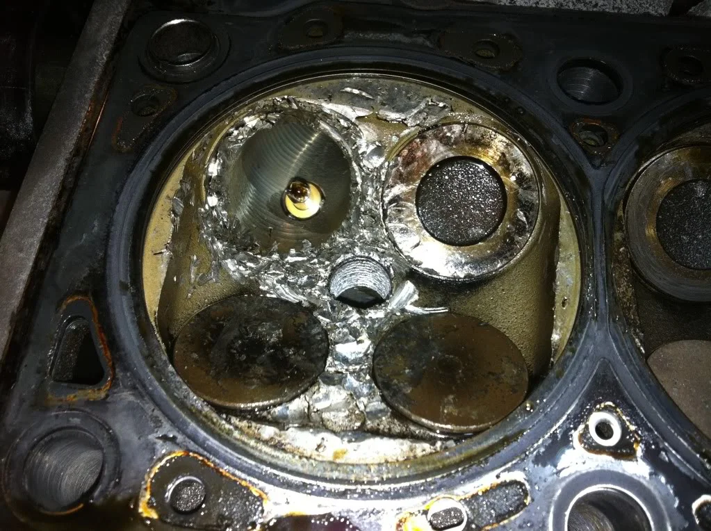

Owned the car for 3 Months, All belts, pulleys, VVT Pulley was changed 8000 miles ago , engine was on 46,000 miles.

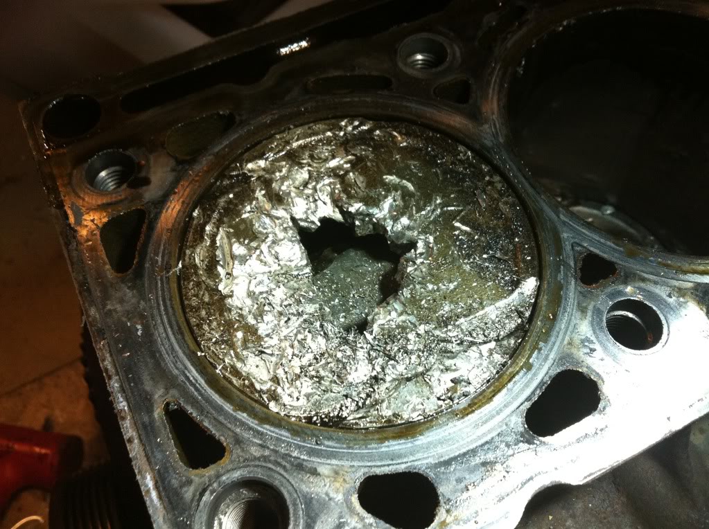

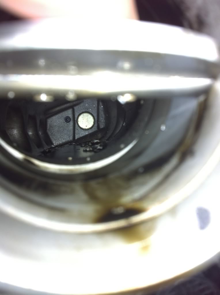

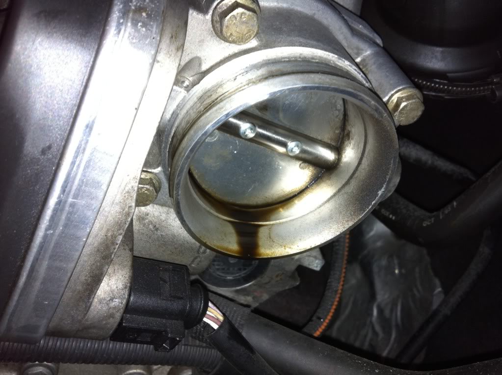

Driving home a few weeks ago on the M5 with cruise control on at 70 then lost all power, couldn't work out what the hell had happened until I noticed my air filter was leaking oil.
So here's what happened:

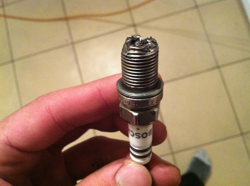

I am aware that the above plug is a BOSCH Super 4 and that it should have NGK's.
Christ!:eek: Thats pretty unlucky!
Could have been the plug tip coming off and jamming the valve?:S

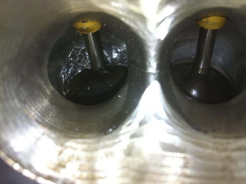

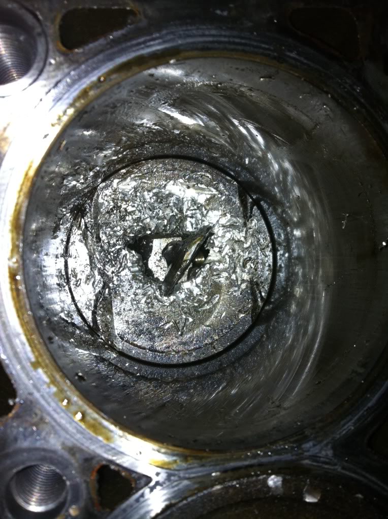

I didn't try a warranty claim because if the timing was out it would have bent the rest of the valves, the valves are friction welded together and as its a weak spot it just gave in.
hi, i have similer metal shavings in my inlet manifold so assume my engine ia deqd as well, just wondered how much it cost for the engine and labour etc? thanks
That's an impressive hole in the piston. Seen a 520 bmw do that, though the kid wondered what the misfire was so kept revving it till it stopped......

Did you see the Belts done, or was it a previous owner? Did the belt snap/jump or was it something else that caused the destruction in there?
I dismantled the totalled engine yesterday and the belts were fine no rips/snaps etc, the de-phaser was new 8000 miles ago as well. I have all the receipts/ invoices for the belts being done adding up to about £800 by the previous owner , I even rang the garage up to double check.
Ahhh right - well, if the belts and alike were all intact and as they should be - an internal problem maybe regarding the oil has arisen. Bad news fella.

I was mate the 2nd time it happened 4 hours after fitting the new engine and the worste thing no one could tell me why it happened both times on cylinder 1, I was aswell I never drove it properly again mate.

Me neither I never gave myne stick just the odd bit of pasty, 1st time I was doing around 50mph in 5th gearthe 2nd time around 20mph in 2nd gear myne was well serviced and on 29k belts werent due either its a mystery tbh when I get I sec I might start thread to see how common it is and wht it happens
maybe time to think about uprated valves £££ though :dapprove:
Thought this, but then while the heads apart you think well I'm here might as well throw some decent cams in, decent springs then your adding up the £'s. Some 1*2 owners give their's hell all day long and have no issues. Must just be an unlucky bunch of us out there with 2 piece valves soldered together.

is there anyway, you could just swap around the bottom end of the engine rather than just fitting a whole new one?
If you've not snapped a valve like this chap has, or your head is undamaged, then yes a different bottom end will fit.
although you would still have to remove and refit the engine, its not like you can leave the head in the car while you swap the bottom end over, lol
