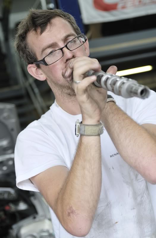

i discovered an issue yesterday which mean't me staying at work to fix it (i was in the workshop til 3am on sunday night)
see if someone clever can spot the problem in the picture below

Is that you Fred LOL?
On a side note, thats a pretty good picture :eek:

i'm offended! That's the west country bumpkin owner of this vehicle

Lol! I've never met Neil in person. I'm still intregued as to what was up with the car :eek:

camshaft supposed to be in silver car in background
or
theres an issue with camshaft itself.

its out of focus, but im guessing its totally hollow.

cam end seals?

correct, there were no core plugs in the end of the cams, thats the 2nd set of catcams i've seen with them missing now!
