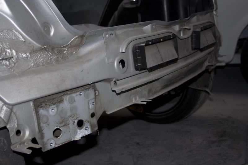

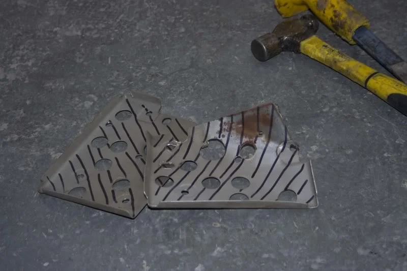

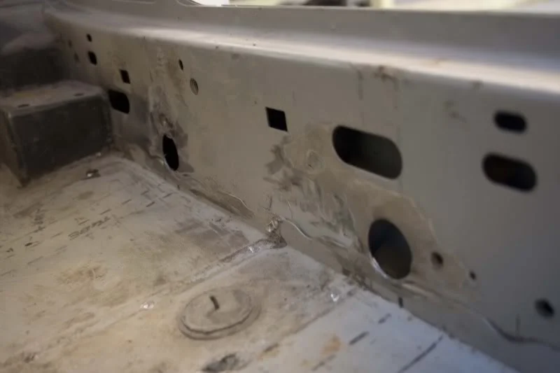

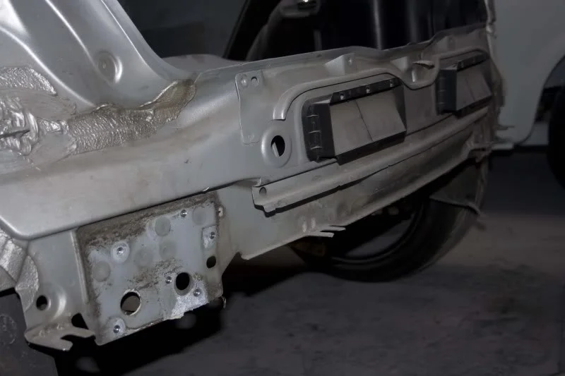

it's like you read my mind, ha, i was literally only coming on here now to pm you asking how you did the front crossmember.
I was looking at the swagers and thinking "there is no way he slotted one part inside the crossmember".... but you did,
so how did you hold the bolt /nut that was inside the crossmember? or is your bolt welded on at that end of the swager?
I am going down to the car today (although not to hole/swage) so will be trialing fitment etc then.
There was only just enough room to get the female part of the swager I made down the gap and then get the nut on, the ones near the ends i managed to reach in with my fingers, the ones in the middle, i passed the nut through the hole I had just made to the left or right and by finger tips got the nut onto the back of the swager then wound the bolt through, as I said, footery as fook!
The other thing to bear in mind, if the female part of your swager is a tight fit down the gap in the crossmember you need a bit of enough space to get it out once you've swaged the hole, ie you could end up getting it trapped in there!

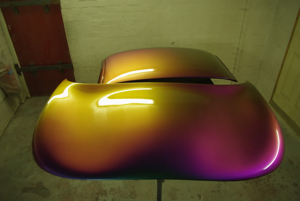

Ok look at Luxor Blue (VX colour), sorry been busy as hell at work and forgot I had said I'd look.
Try also Norse Grey (old Renault Colour)
this was posted in my other thread...
maybe this pic can help.
moonrack grey, but unfortunately I dont know color code :(
thank you for that, that has helped, i am still massively a fan of the darker greys / silvers, i may use that as a base colour...
i visited the clio today and had a good chat about colours with my mate, i am now wide-open on choice again, but thoughts are spinning...
I am now not so much thinking about colours but more styles, looking for inspiraction, 80's racecars, cafe racer motorbikes etc etc.
I will have to see what happens when i get there, hopefully i can work around it somehow, discovered my bodyshop / painter mate has 1 aswell (looks thinner though), so may be an option,
if i can't do the crossmember perhaps i'll need to make more holes elsewhere...lol

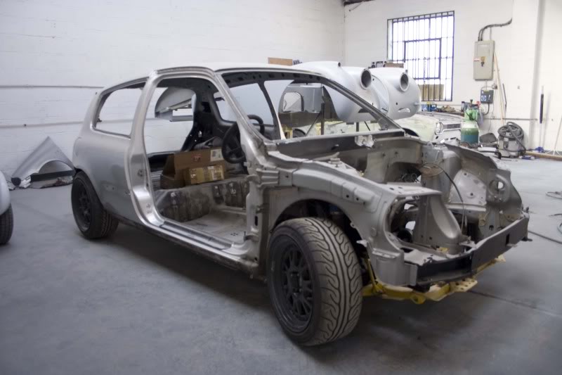

so, an update, not massive but a good step ahead again...

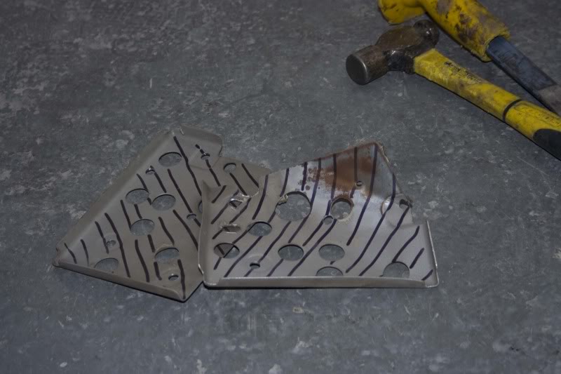

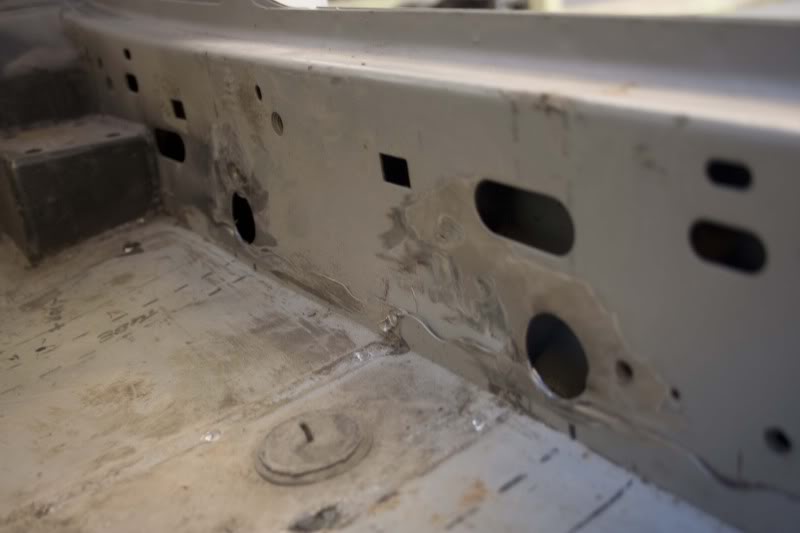

as i now had my hole saws/arbors (thanks bomber) and swagers (thanks frenchthing) i could now set to work on the body, however the holesaw needed to be put to good use elsewhere first, i think a few posts back i had measured out my seating location and where the welded in rails would go... today they needed fitting. prior to this however i thought i may aswell remove the doors and bootlid (to make it easier to get in and out),
although i have slimmed the doors and tailgate down alot can still / will come out of them, i will also be hole sawing and swagering as much as poss on them....

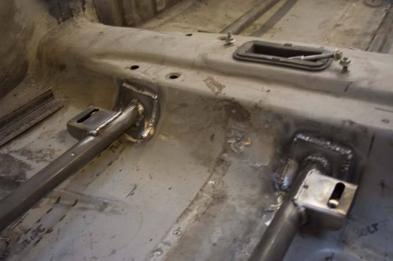

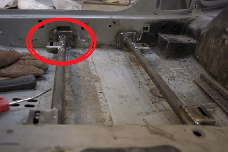

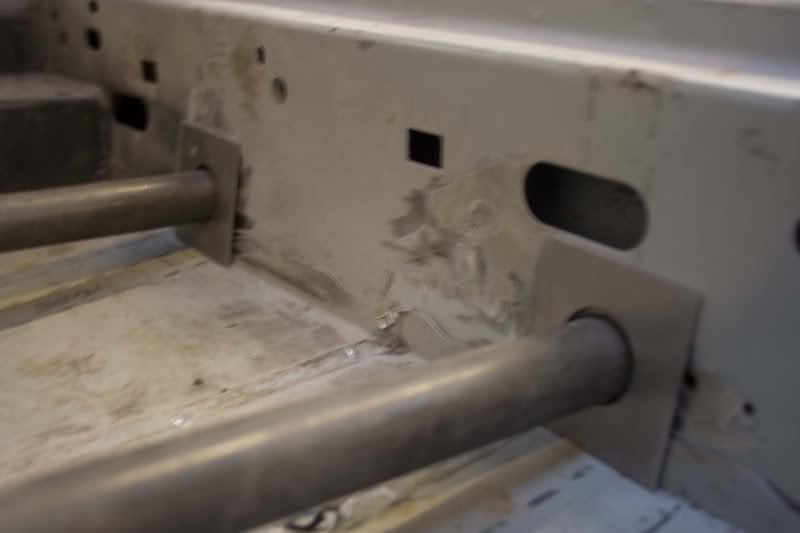

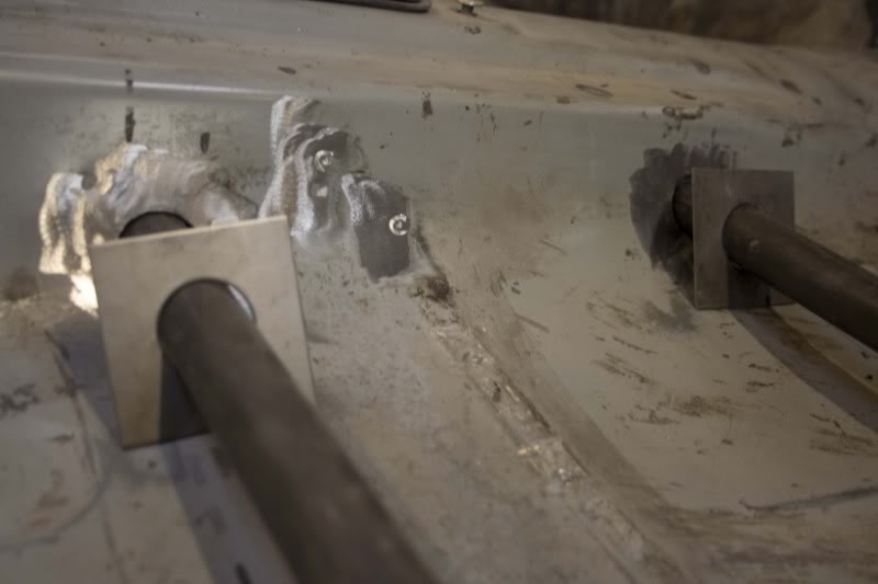

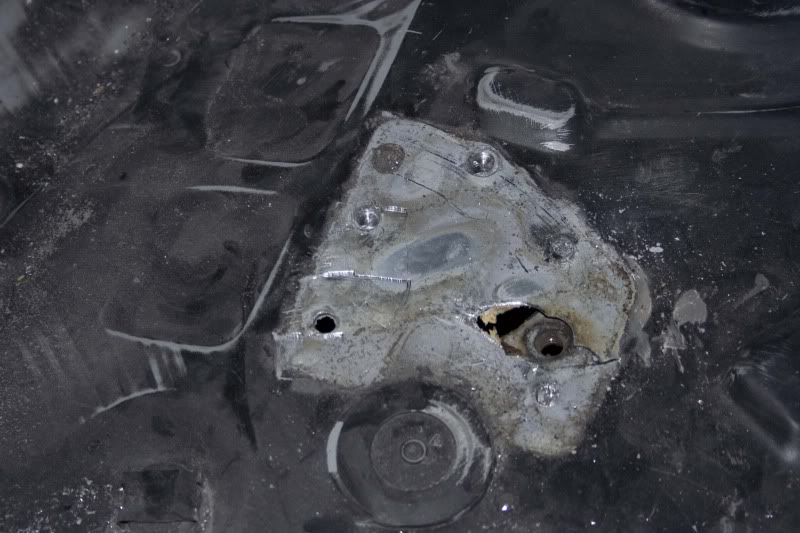

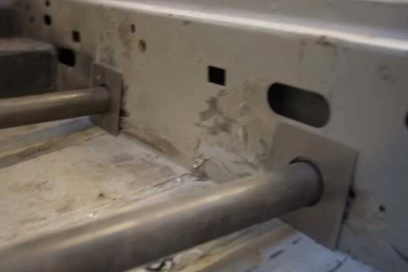

so with those bits out of the way i trial fitted the seat (in new location) with the cage to make sure there would be no issues..... all good, so the holes where drilled.
sill side
exhaust tunnel side
seat rails and strengthening plates placed in.

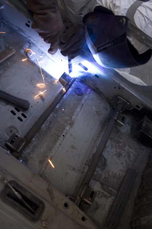

with these all sorted and in place they where welded in, and then the mount brackets where attached.
very happy with how they have come out, and my seating position, although i have noticed how far back i am compared to some pictures of other builds....
more fabrication will be going on in the next few weeks with holes etc being filled but its coming along...
i had also started to mark out the cross-member and some parts of the engine bay for hole-sawing / swagering but that will be for another day....

so indecisive! You not thought about getting a small amount and testing on a panel or two? I did this with loads of shades mate, it's the only way imo or you'll just be like you are now, choosing forever.

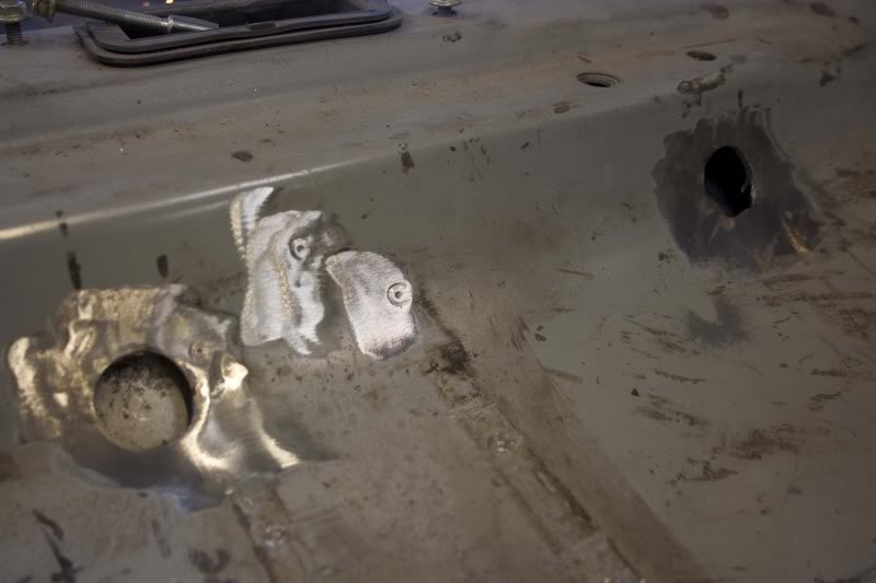

nice welding
erm.... i disagree....
please dont think i`m just slating for the hell of it, i do like the project, but.. i`m sorry.. thats NOT good welding!!
i`d seriously get that ground back and re-done as there doesn`t look like theres much penetration onto the actual seat rail.. just a couple of blobs.. its a seat rail! it has to be right...
  M3, Cup racer'd 182
I agree with frenchthing, I'm not a pro welder but to me it looks like a case of not enough heat so not penatrating the metal enough and just blobbing up.
Nafoff
the other tubes look ok in fairness...
appreciate your input guys,
Luke (my painter sprayer) is a very good mate so hopefully if he is happy with it, it is all good, I would like to think he wouldn't do a bad (non adequate) job and possibly put me in danger, however it is something i will look over when at the car next-time

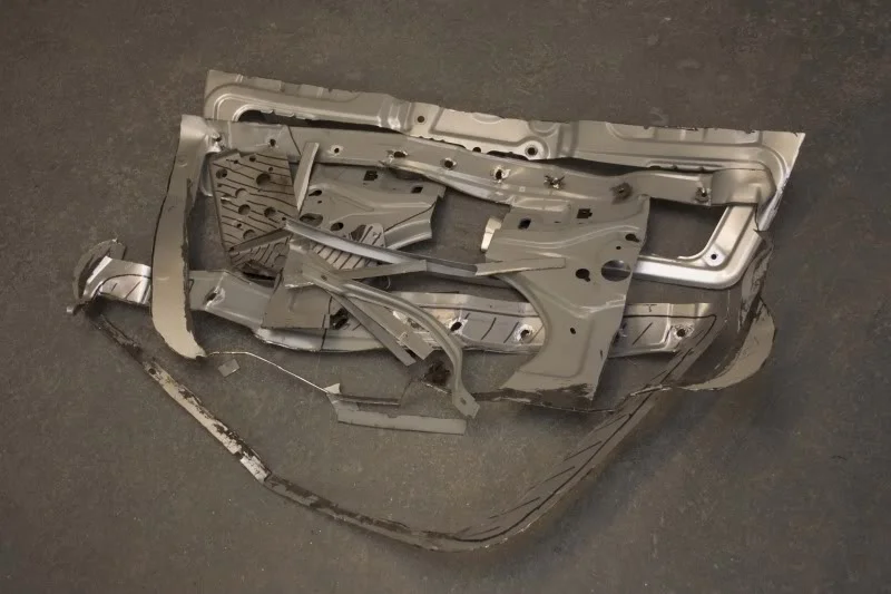

well for one reason or another i managed to get down to the car nice and early today... like really early, was quite nice working on it so early, my main task today was to just CUT SH*T UP and MAKE SH*T LIGHTER, i managed to get a fair way through, but was the doors were putting up a good fight...

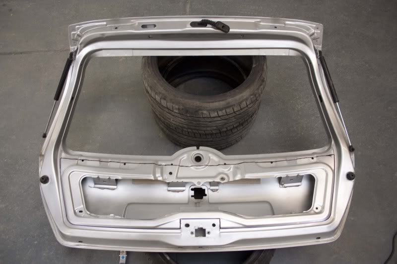

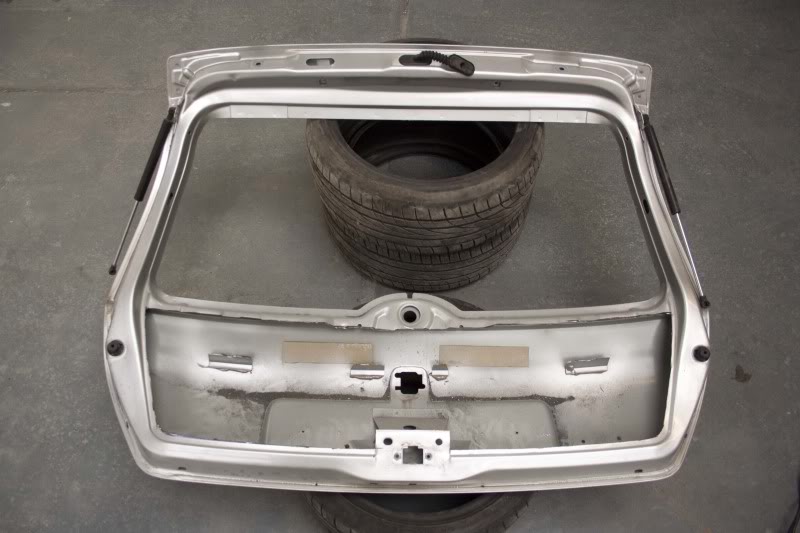

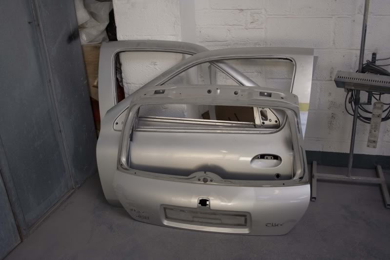

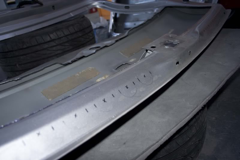

I started on the tailgate first, i had to check through my carbon fibre panel stocks and worked out i had a nice piece that can panel the tailgate so i marked up the (already lightened) tailgate and got to cutting....
before
after
also going to loose 1 of the struts from the tailgate, light enough to only need 1 now,

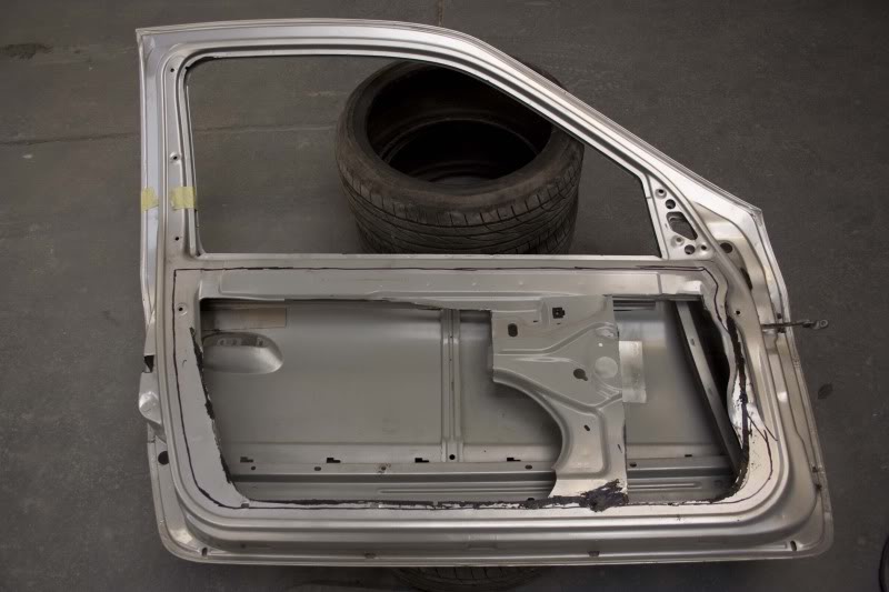

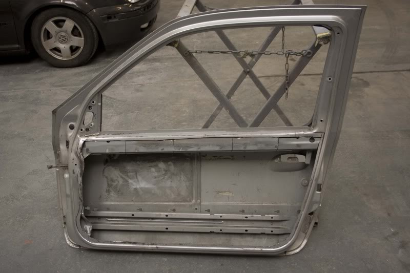

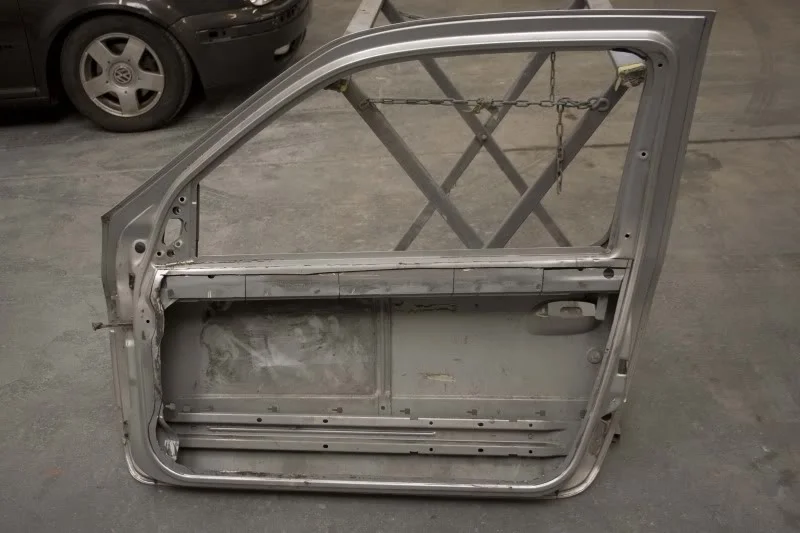

so onto the doors, again these had already been lightened a bit but i could loose alot more, i again marked out where my carbon panels would fit and then got cutting / trimming
before
after
as you can see along the upper part of the main door i have made some cuts, i plan to take a fair bit more out here, but its about 2-3 skins thick in places and it was a bit of a ballache with the grinders/cutting discs i had, could really do with an air-saw, but i will get these bits done on my next visit..

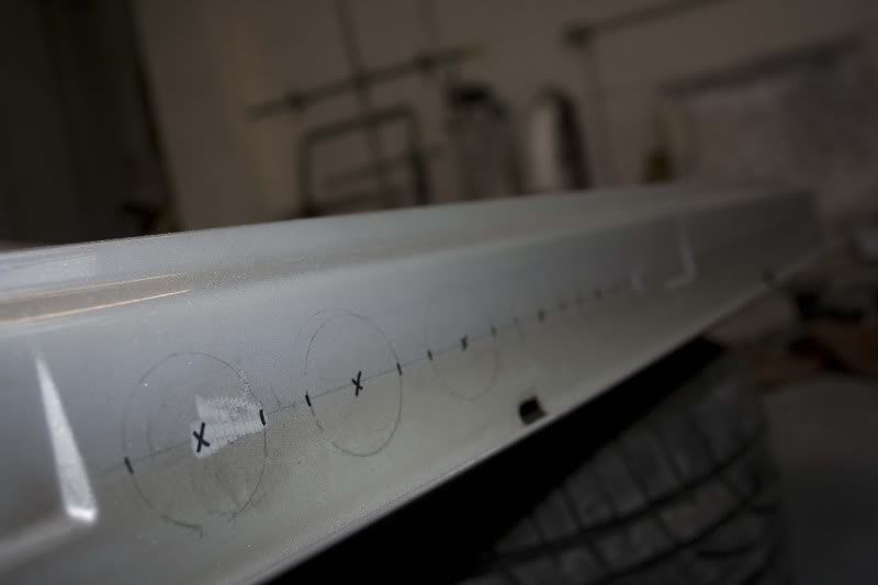

and then the holes were measured and marked in the base of both the doors ready for hole-saw / swagering

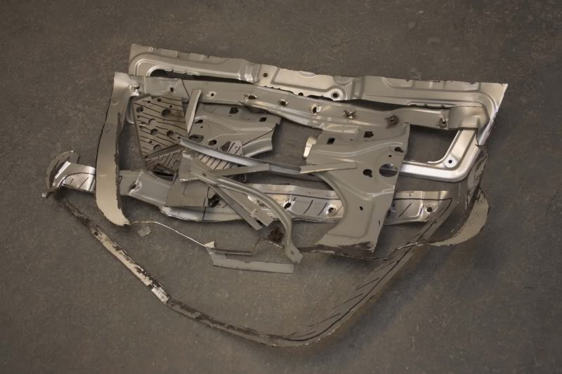

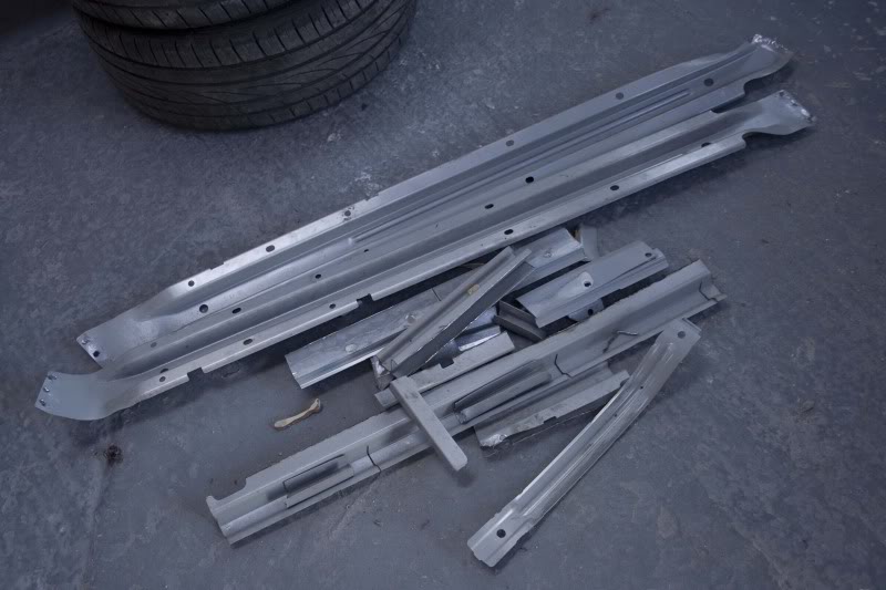

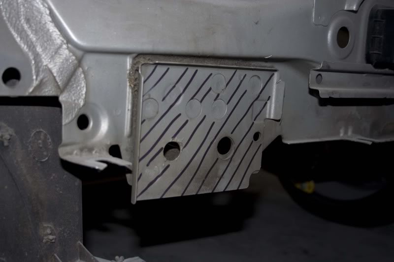

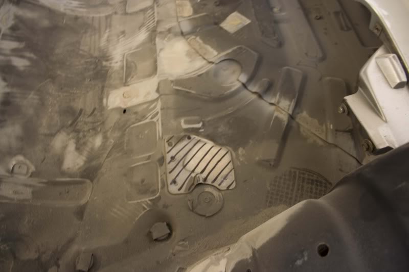

i then moved onto the body (as i had the spot weld drill bit out), a small panel inside was marked for removal, as were a couple of excess renault metal on the rear......
all in all it felt like a relatively productive day, quite happy with the progress and quite happy with how much got removed....

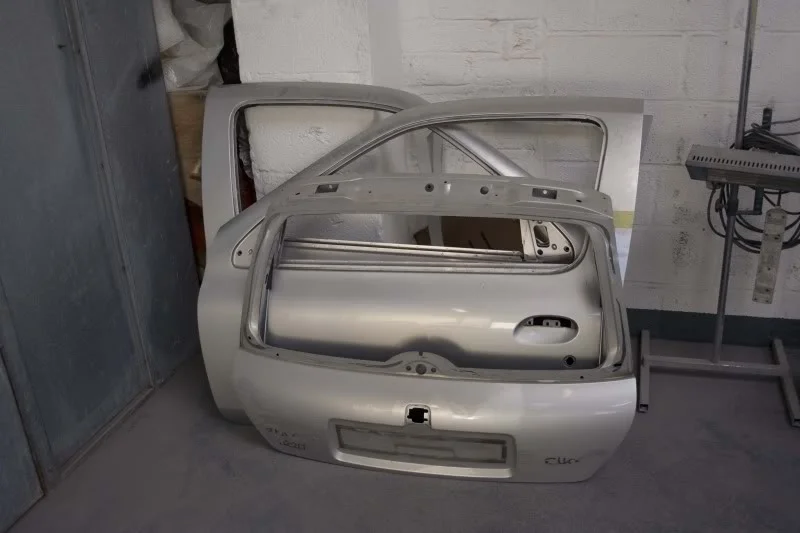

so spent another day (not full day) on the car again yesterday,
my plan was to finish off the doors and tailgate,

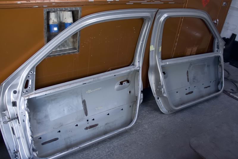

i had a new tool to play with instead of just the grinder/cutting disc, today i had an airsaw.... so much easier, i cut the remainder out of the top of the doors, some of this is triple even quadruple layered so weights a fair bit, this was done on both doors. I then attacked the brace bar that runs the full length of each door.
One door was spot on and relatively easy, the spot welds were drilled out, the adhesive heated and then the panel simply came out with a bit of leaverage, the other door (not so much), one of the spot welds was sat directly behind a hinge so there was no way i was getting to it with the drill bit... proper pain, but as said the doors need a bit of work anyways...
how they currently sit.
and even more removed. fairly happy with it.

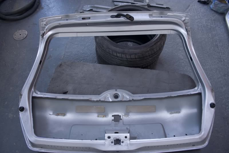

next up was a few little bits on the tailgate, all gone now.
and then ready for next time the tailgate all marked up for hole-saw/swaggering,
so that is my plan of attack for next time, i have everything marked up now including the doors, front crossmember and some of the engine bay so will be bringing out the hole saw and swaggers..

Yip, the tops of the doors are mega thick!
I nearly killed my airsaw doing them, they're not designed for 3-4mm steel. I found a 32tpi hacksaw blade was better for the thicker stuff, but obviosuly cant make sharp turns with them.
Regards the tailgate, by all means drill out the holes you've got marked there but I wouldnt swage them, they're right on an existing swage/crease as such it will distort the edge of the boot if you try to swage them.
