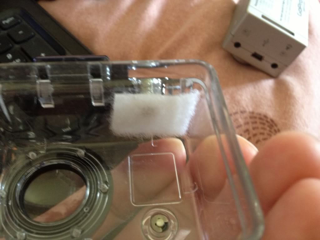

I want my videos to be like Sharky's but I get a really loud rattling noise that ruins the video. Ive already sent one Gopro back and got a new one but its just as bad! Any advice folks?
Original HD hero. I know the big knocks are the mount on the bumper which I understand. Im starting to wonder now if its the start/stop button on the top thats vibrating as ive seen a few videos online! Its very frustrating and a very irritating noise!
Its the top button! Cheers guys! Hopefully be able to fix it now!

Jiggle your camera about out of the cage, then do the same when it's locked in the cage. See if you can hear anything ?
I'm with you on the 'it's a GoPro feature' sort of noise...
:dapprove:
I noticed this noise on my Hero 2 and what I did was cut a piece of cardboard and placed it in the sliding / squeezing Clip bit and it's wedged in now , but it's as quiet as a mouse - none of that clicking noise over the recording.

Well I think ive fixed it or at least improved it! I just added a bit of velcro on the inside of the case and it has made a big difference! Only been of a short drive around the block so will see if I still think its better after I have been on a longer drive!
Sorry its a bit blurry but you get the idea!
