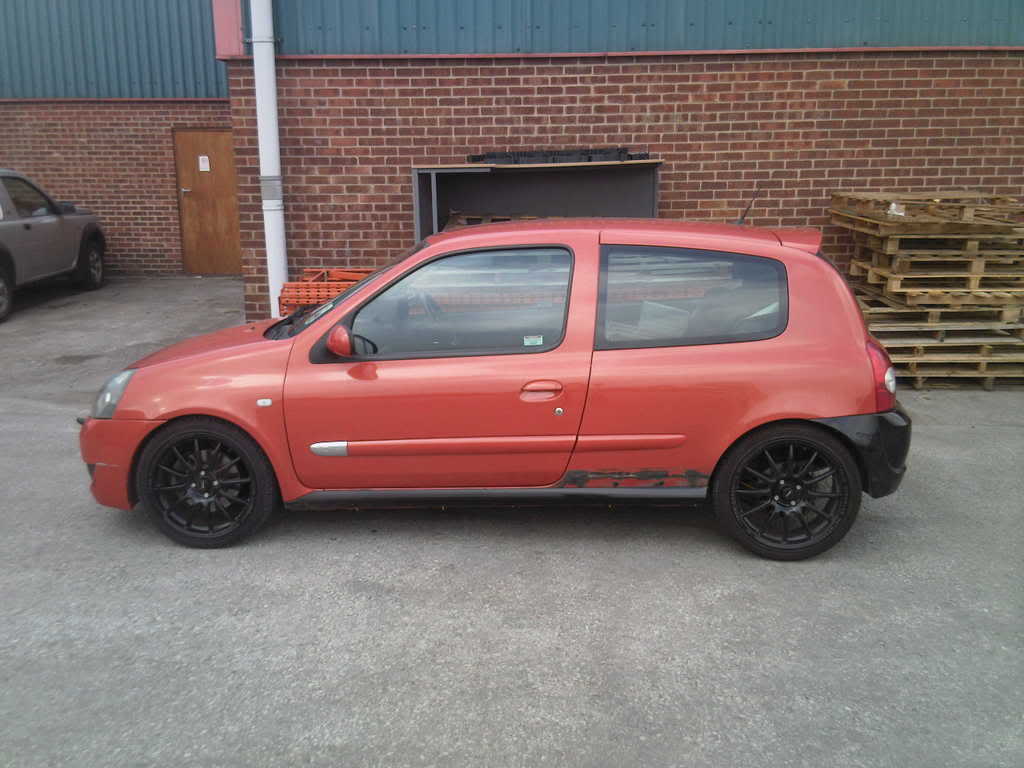

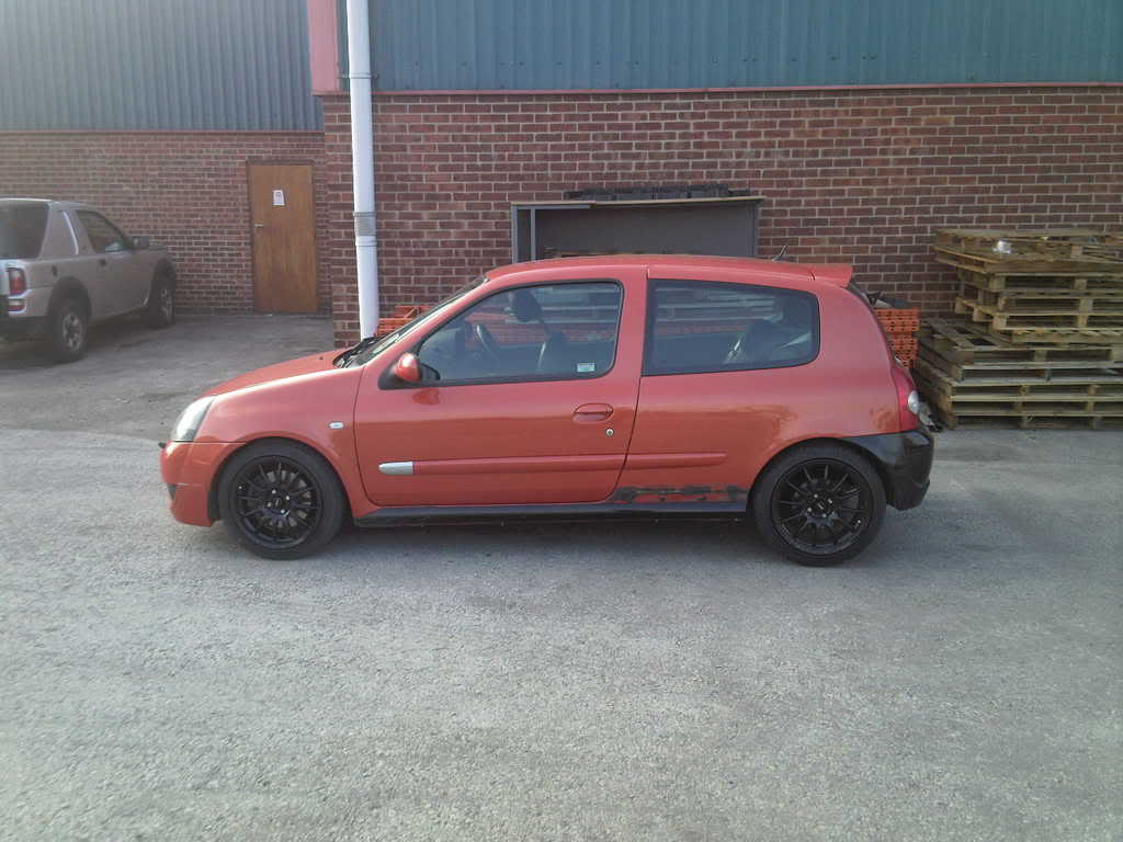

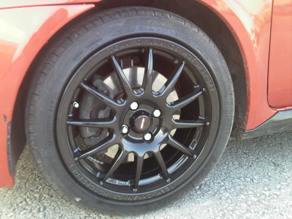

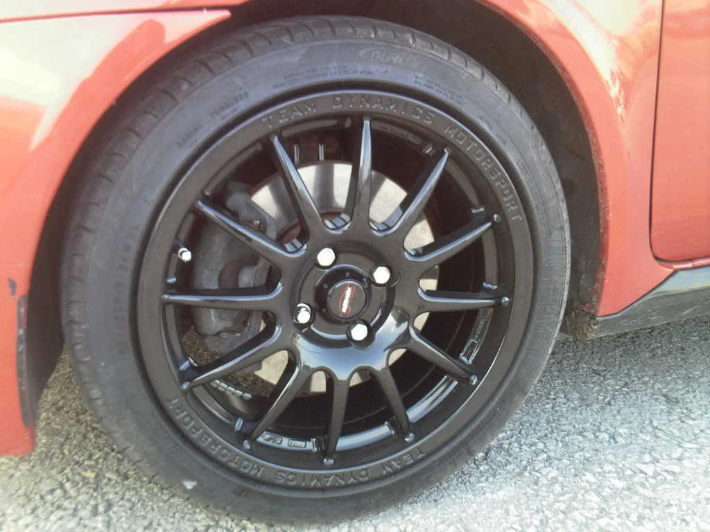

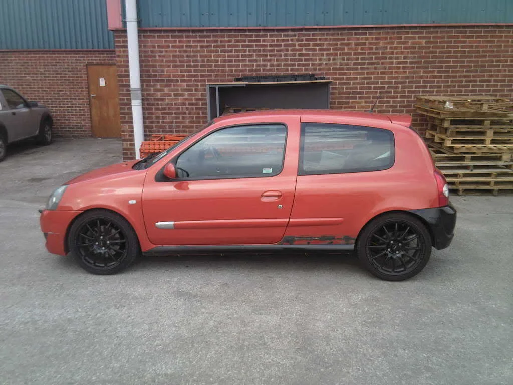

Right, just a quick update, went down to west bromwich on friday afternoon and got brand new alloys:approve:
Before:
After:
Really pleased with them, no rubbing now whatsoever, first time its ever been really chucked into a corner, and I have to say, I am impressed with the handling

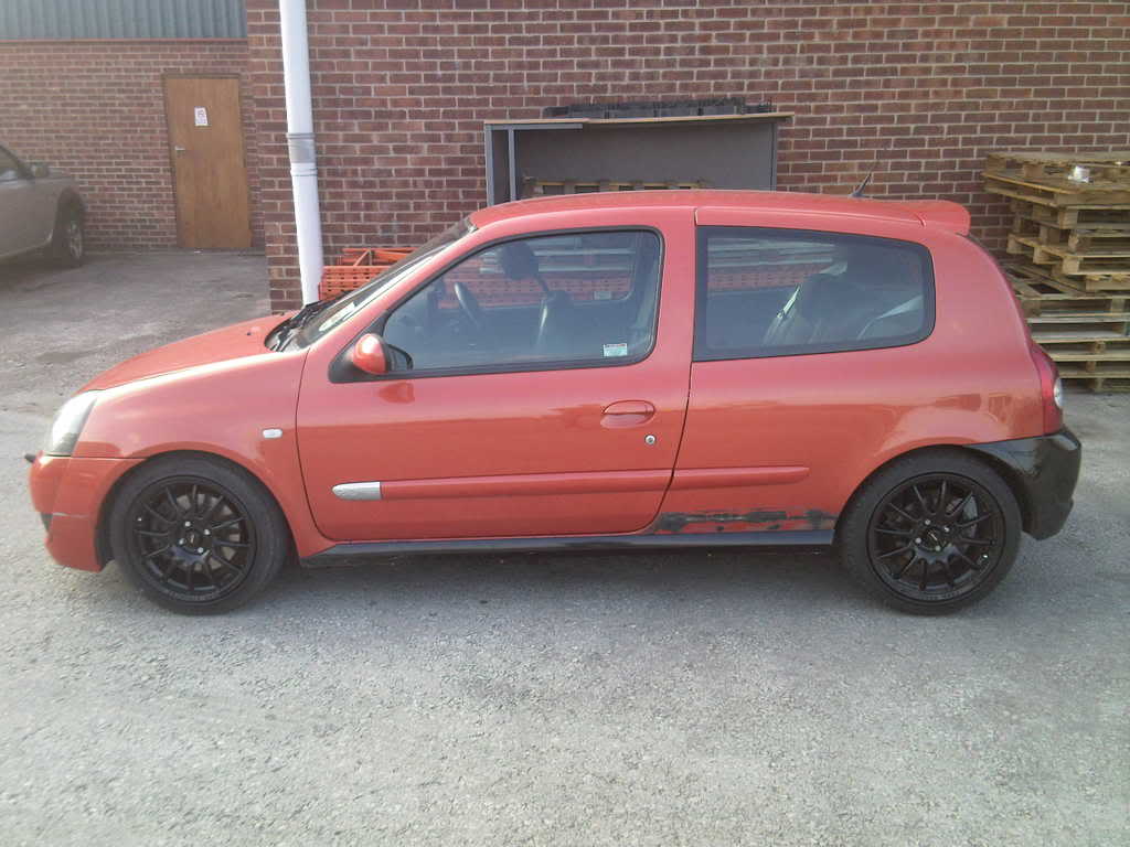

One more just cus it was a nice day

there not white! girl... :rasp:
does look good though mate! when are you getting the bodywork sorted?
Haha, I wimped out, and I knew black suited it anyway, so stayed safe:approve:

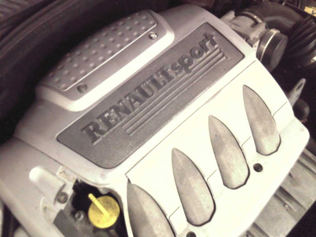

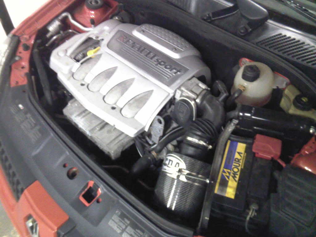

Had a go at polishing the renaultsport logo

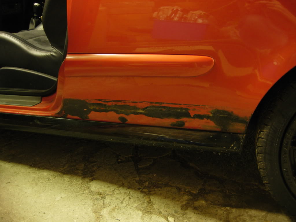

Had another bash at removing the black tiger seal from the rear quarter panels, and I'm after some advice on tyres now.

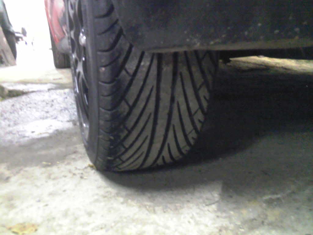

The new wheels and tyres came with this (cheap unknown crappy?) brand called Durun, which apparently have a very soft compound. I'm thinking, replace them once they've worn through with either yoko paradas or R888s.
Current tyre and tread:
any ideas on whether they're decent or not would be appreciated. Size: 195/45/16

Found this on google from the GTi6 forum:
Get rid
You should always put the best tyres on your car as they are the only thing between you, your car and the road! (- Same goes for the brakes.)
Either choose:
Bridgestone Potenza S0-2 pp
Bridgestone Potenza RE720
Eagle F1's
Agreed! When I had 17"s I made the mistake of getting some "Durun sport" tyres fitted(i was skint and my other ones where 3 pointers)
They where awfull! Ruined the handling and all I got was understeer

Payed 330 quid in the end for brand new wheels and tyres. That was with part ex'ing my old 17"s in. They came from Rimstock in west brom, but they don't sell to the public. I was cheeky enough to ask, and they offered me the part ex.:approve:

hmmmm what you are saying is true. When chucking it through corners, it did seem like if the tyres were going to give, it would be understeer. Might just keep them on for the winter, and replace in the summer with yoko paradas

Rossmac: Best way of removing tiger seal we found was, get a sharp stanley blade to cut of the excess, kind of like in a razor fashion, chances are you will probably end up cutting into the plastic though I'm afraid. Get hold of some seriously strong paint thinner and paper/rag, then start rubbing. It'll take you forever.
Alternatively sand paper, but that's going to damage whatever is underneath

Still got to get all the black stuff off of the quarter panels yet adam... nudge nudge wink wink
hmm i might be tempted to come for a blast to matlock when i get my new car :)
i'll see if i can get hold of a heatgun, might help?
heat gun may well be the best way of doing it. worth a bash. Definatly come for a run when you get the new motor. I'll show you the route I always took to mansfield, fun twisty back roads :approve:

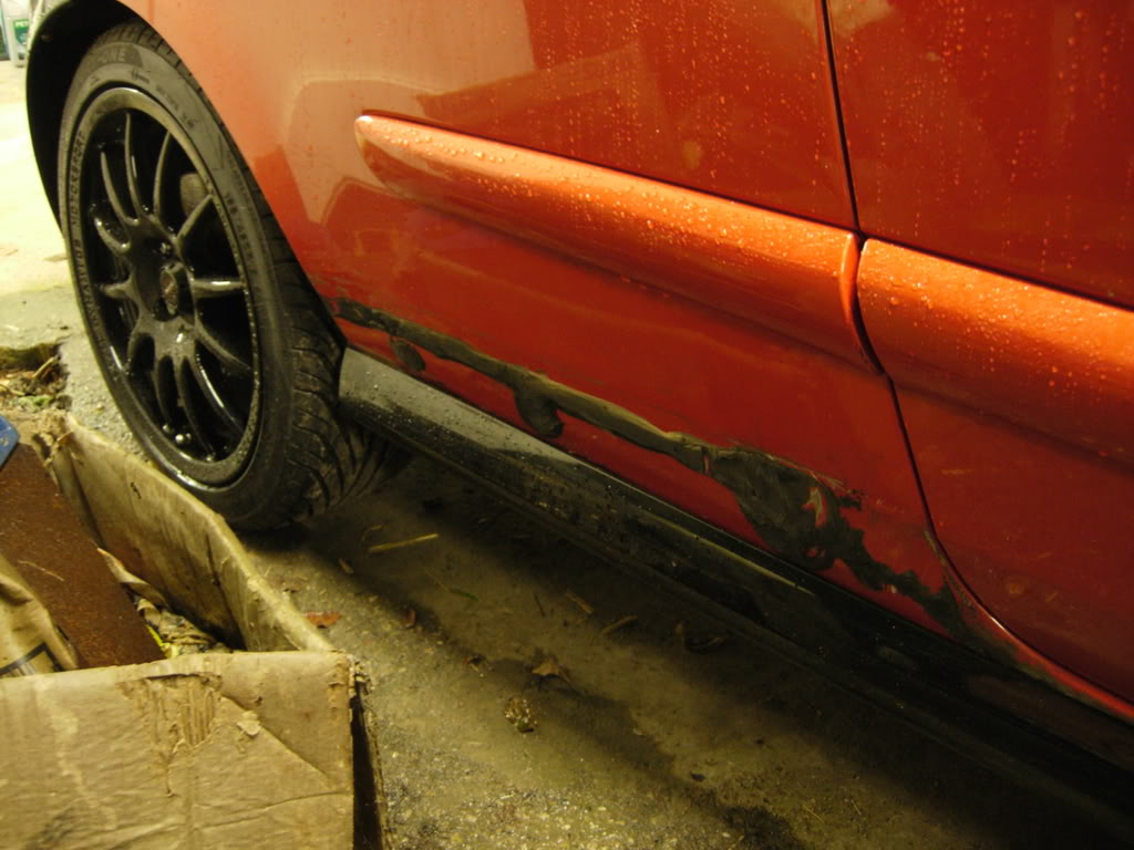

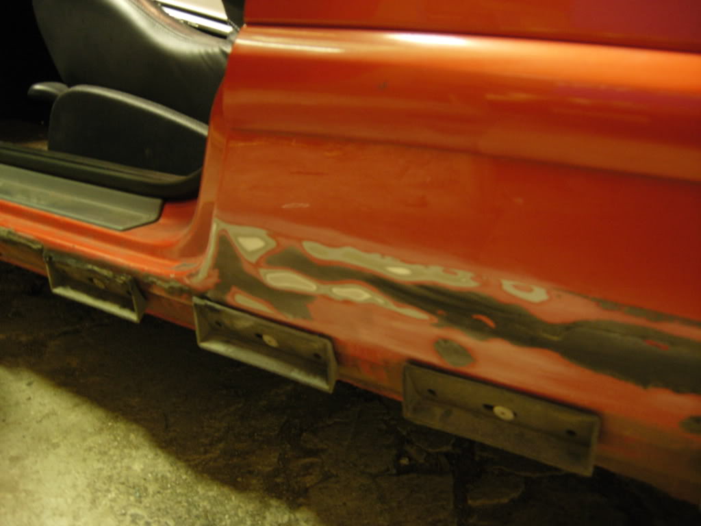

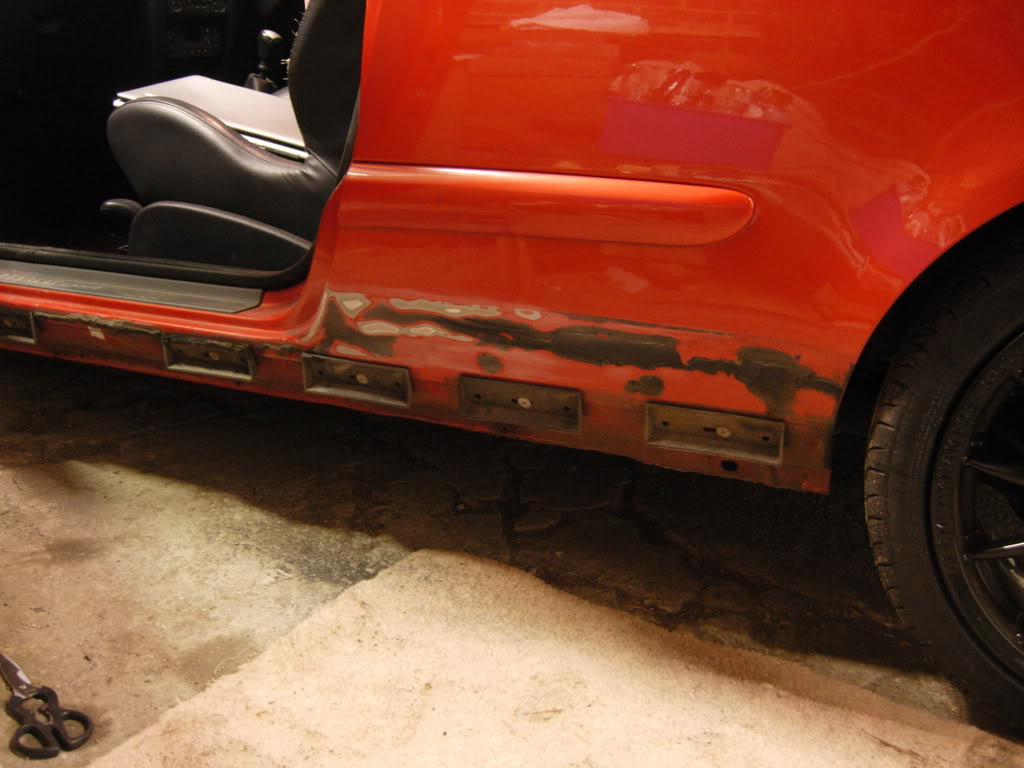

Been out again tonight... but got pissed off with the tiger seal, so out came the sand paper.
I've taken quite a lot of it off, but unfortunately its gone down to the metal in places.
Got to be resprayed anyway, so nay bother.
Before:
After:
Gave up after 2 and a half hours, cus my fingers were red raw:(
Still got the other side to go at:dapprove:

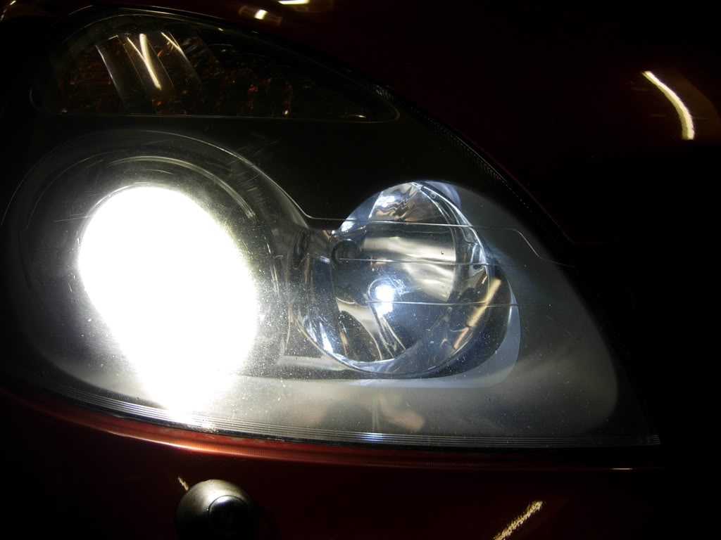

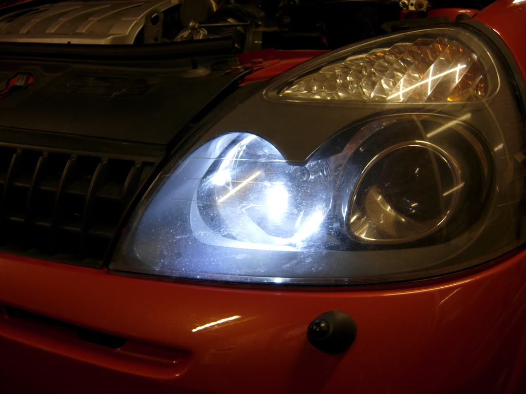

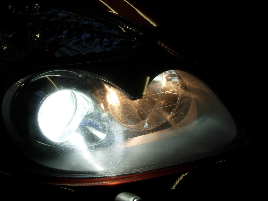

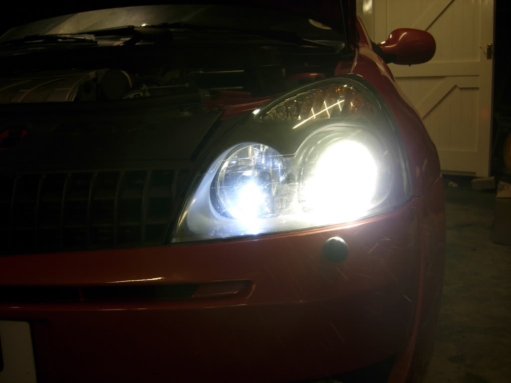

Also while I was out, I bought some lovely LED sidelights, cus I wasn't to keen on the orange glow from the standard ones, next to the xenons.
Before:
After:
Much better:approve:

Going to have to duct tape up the bare metal till i can afford a respray, just so it doesn't rust. It's had a run out tonight, been along some nice twisty back roads.:)
Spray it with a fine layer of primer just to protect it?
