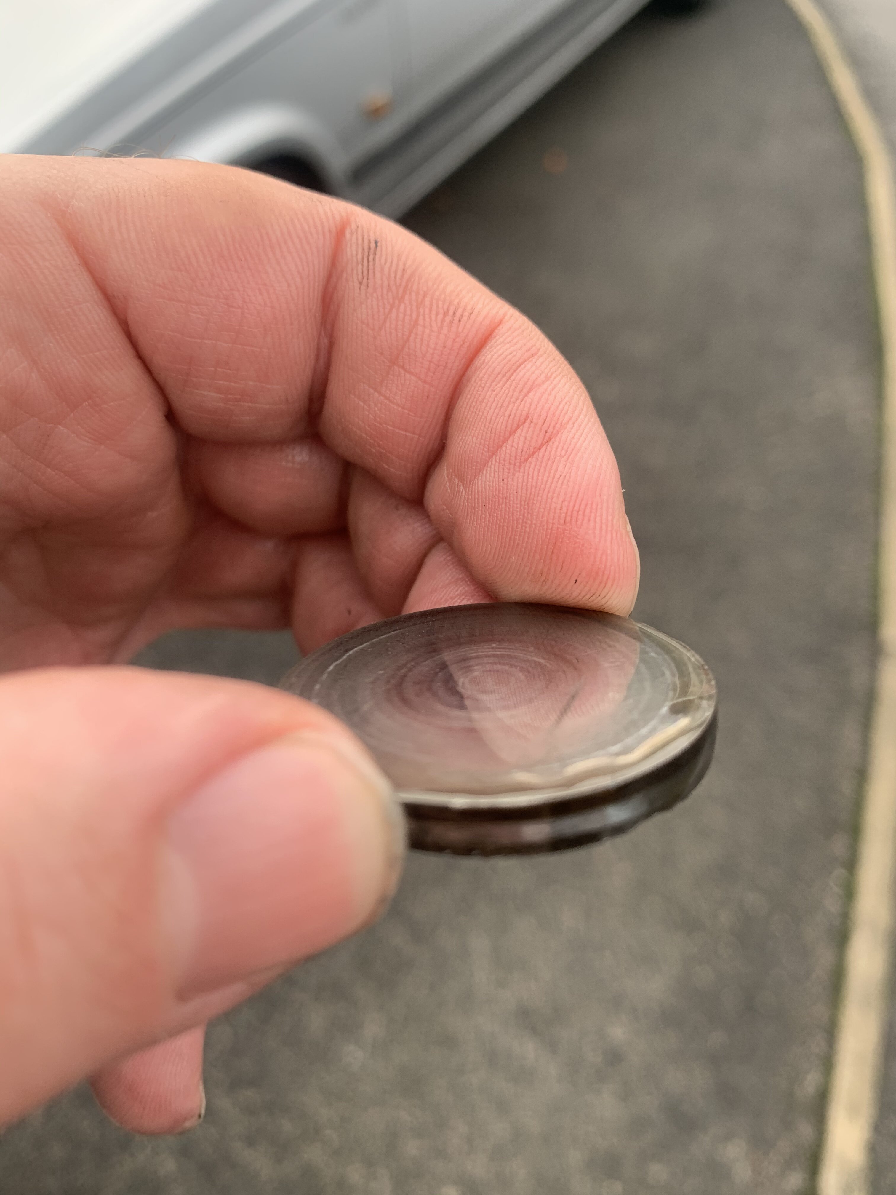

Drive ornament is back.
BashRacing

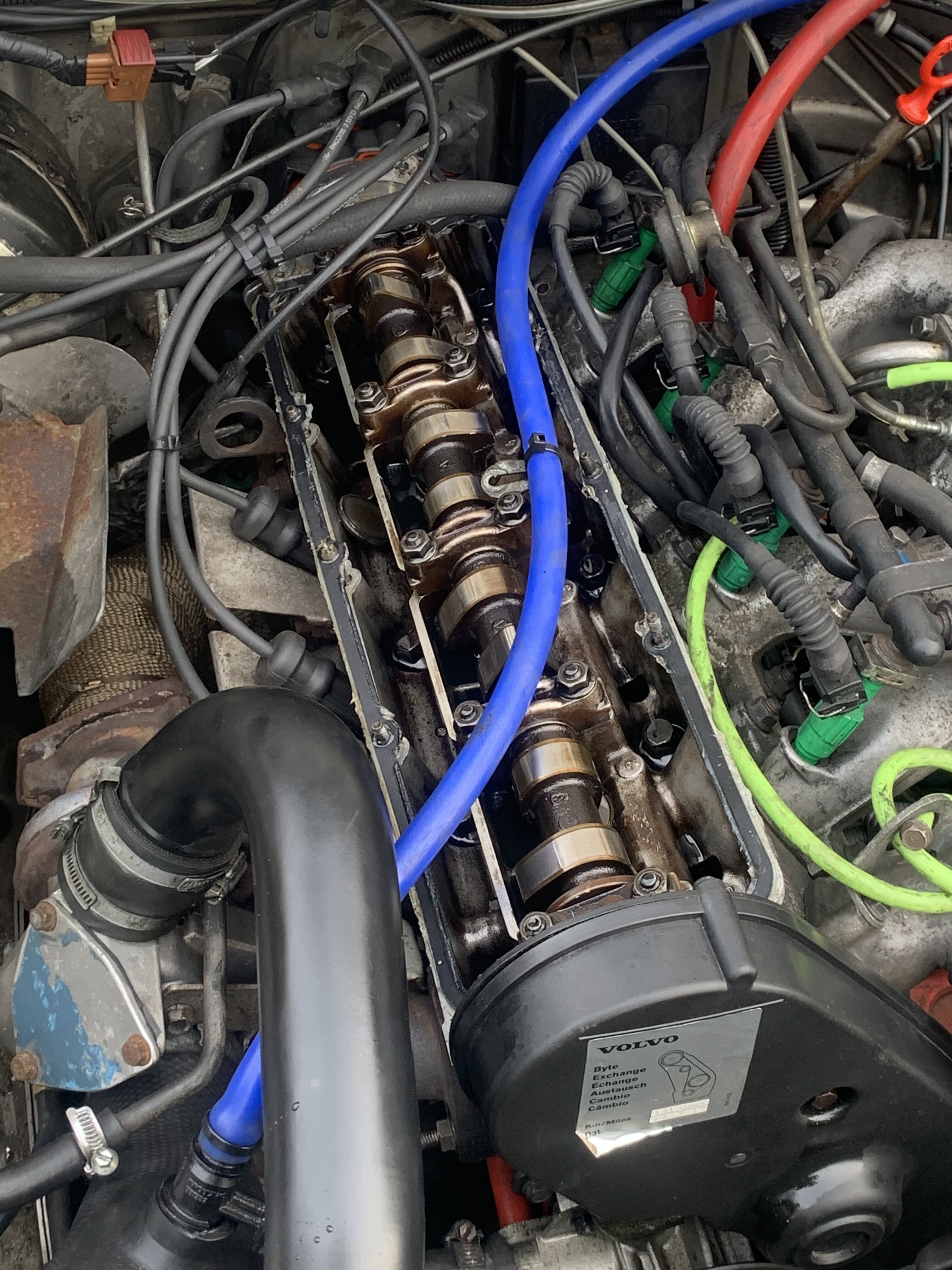

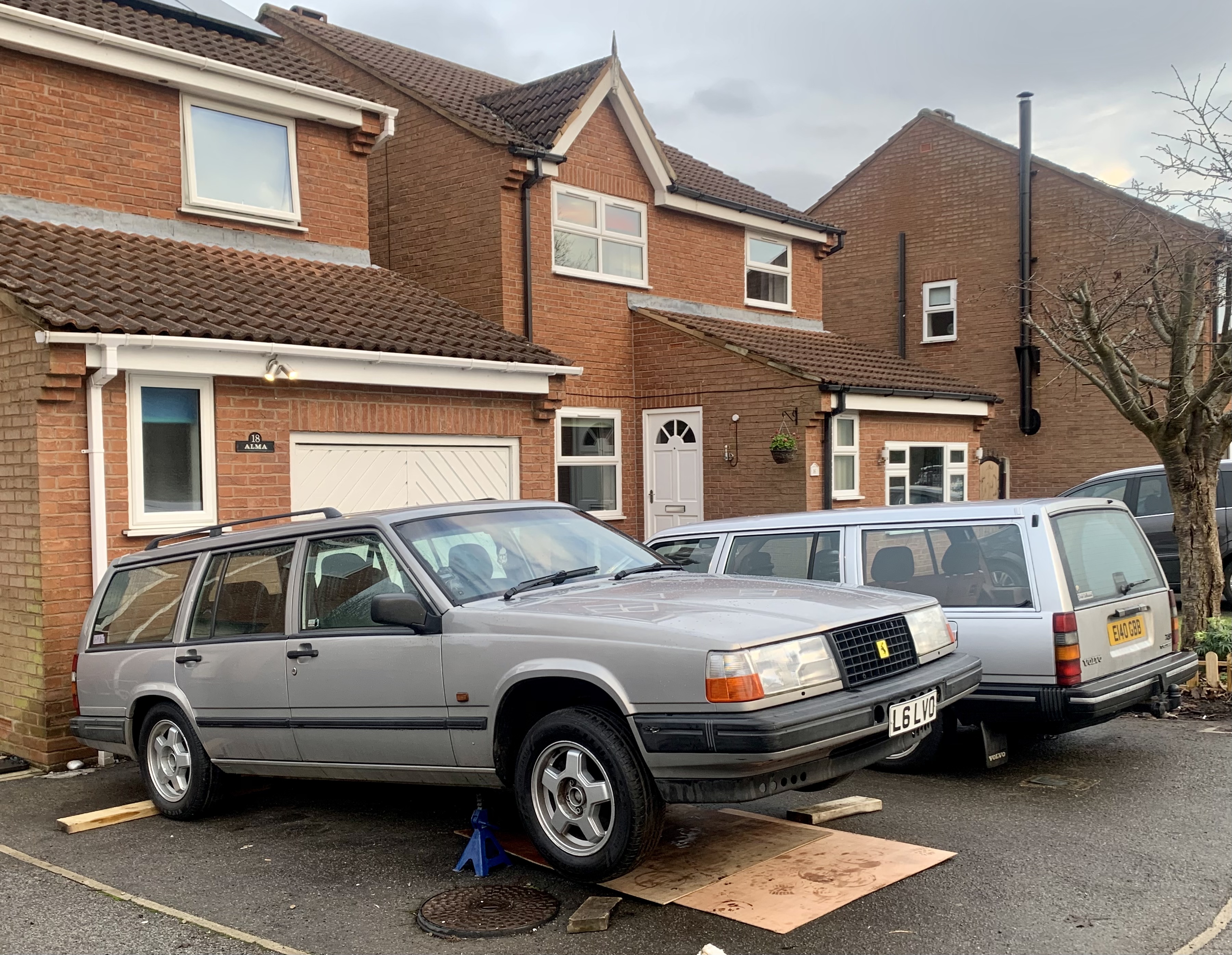

Are you over revving it jim?
If so close up the clearances to 0.25mm with thicker shims,
or just tack weld them to the bucket if you want to go full pikey.
Krarl
Shim over. I thought it was the bucket at first when he sent it 😅
Least it ain't terminal. I thought it was some mega rod knock when you sent that breakdown video.
At least its not broken😂
Slap it back in and set the valves again, should be rate Jim😂 @bashracing if you want mega pikey he could use mastic, JB weld or loctite to stick the tappets and buckets together😂😂
leeds_182
North Yorkshire & Humber

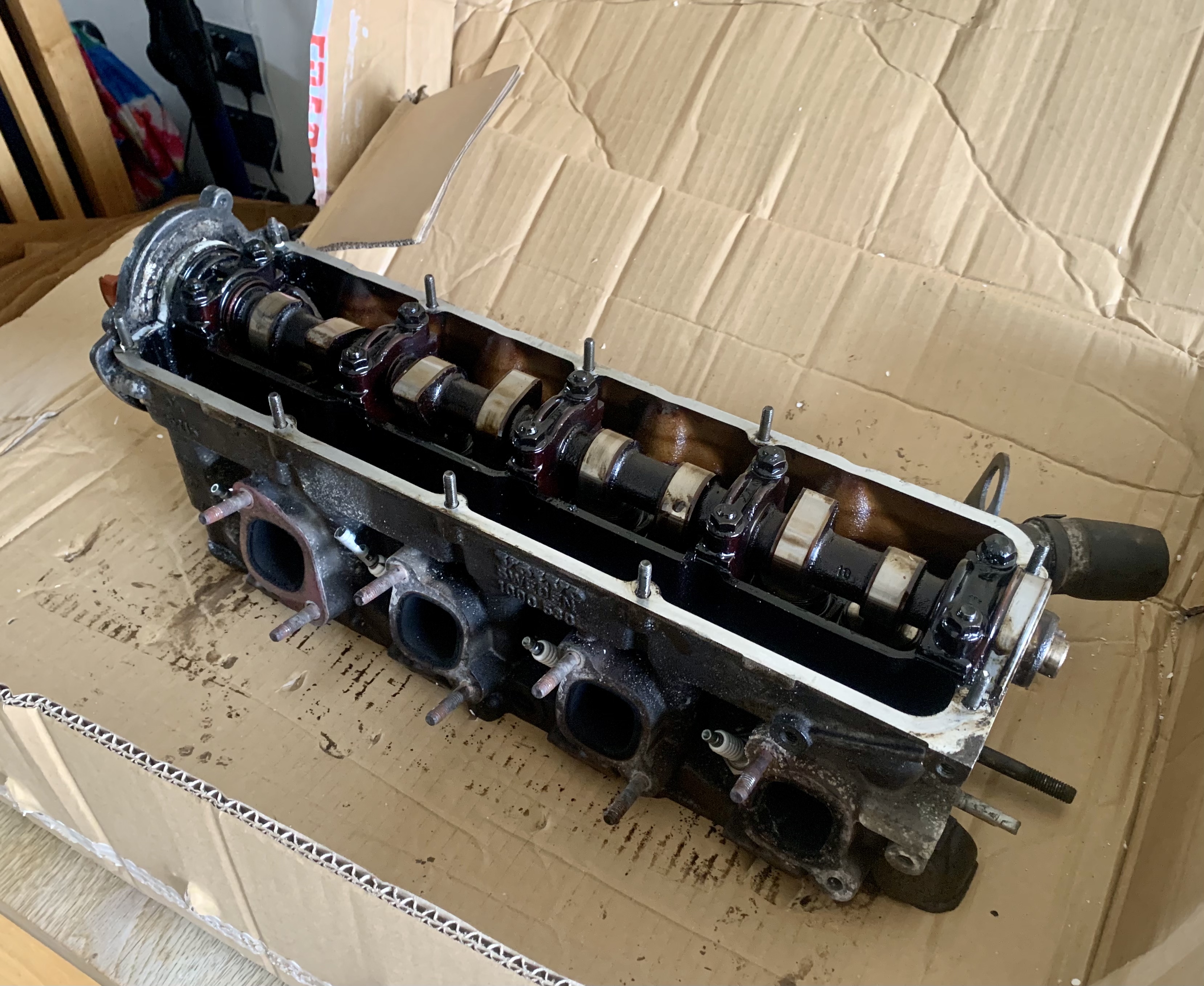

Looks like the volvo ‘bent a valve’ so will be a head off job.
I’m trying to punt it for £1250 as is but it’s proving a challenge!
leeds_182
So, after getting the odd £500 offer I’ve decided to try and fix the car. I’ve ordered a head off eBay and will then be getting it skimmed and all that shizzle and hopefully get the thing back on the road in the next couple of months.
