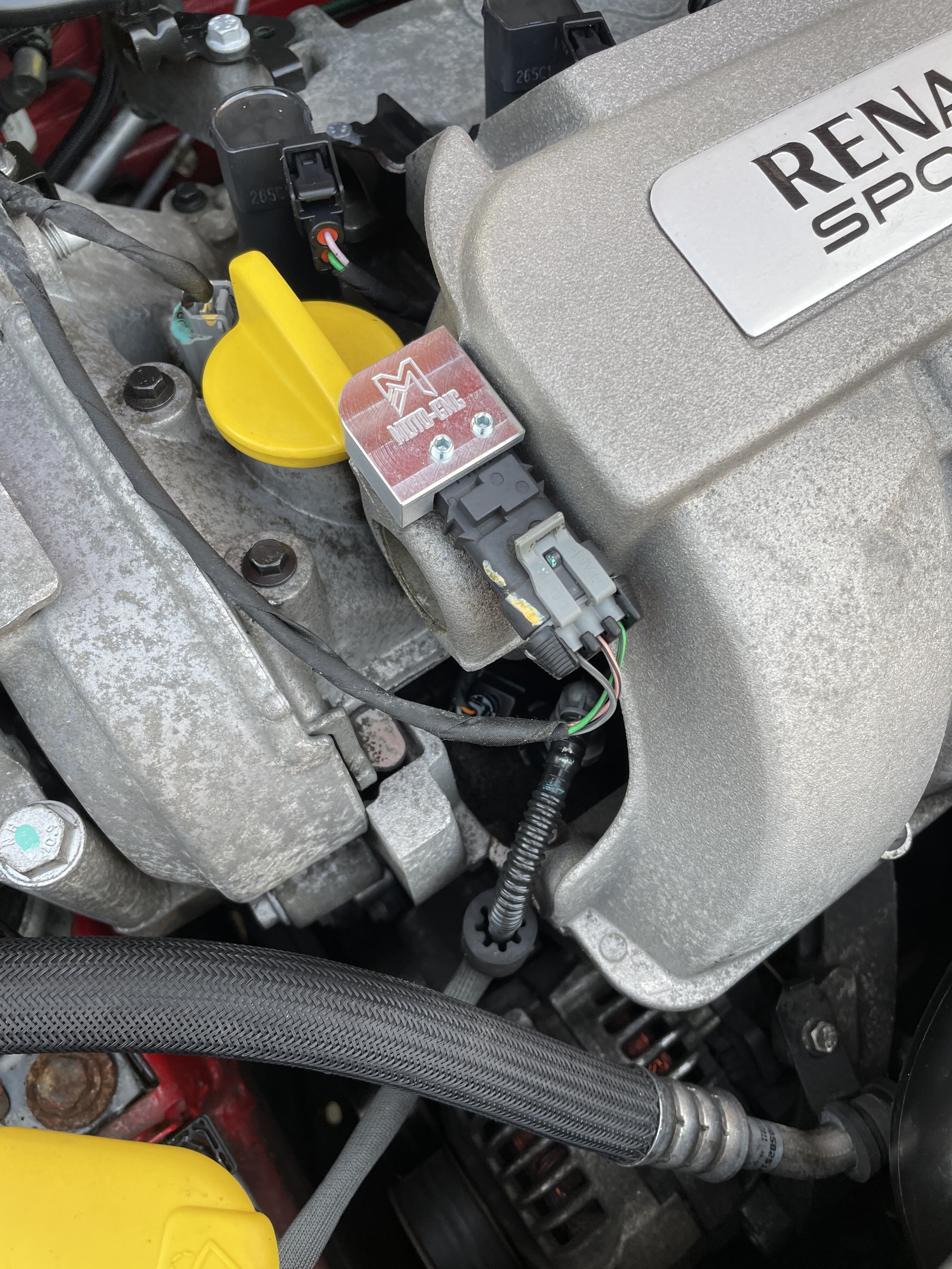

Couple of weeks in - what the actual f**k is with the lethargic throttle response?! Any remedies?🤯

I’d like to try the sprint booster

Aye i didn’t seem to have this issue with any of the other clio’s! I’ve seen these sprint boosters, £200 to improve the throttle is a sore one right enough. Probably be better mapping it!

Let us know how the sprint booster goes, I personally think it’s better to just get used to it as a weird dongle thing is a bit of a clunky solution.

You can't expect a remap to do much on a n/a engine other than to smooth out the power delivery, which as you say James might ironically make the car feel like it goes even slower. I think the sprint booster basically tells the car to condense the full travel of the accelerator into the initial part of the pedal travel so it doesn't actually do anything but change the feel of the pedal, which will feel great initially but I reckon you will get used to it and then come back to the conclusion that the acceleration is pap in a few months.

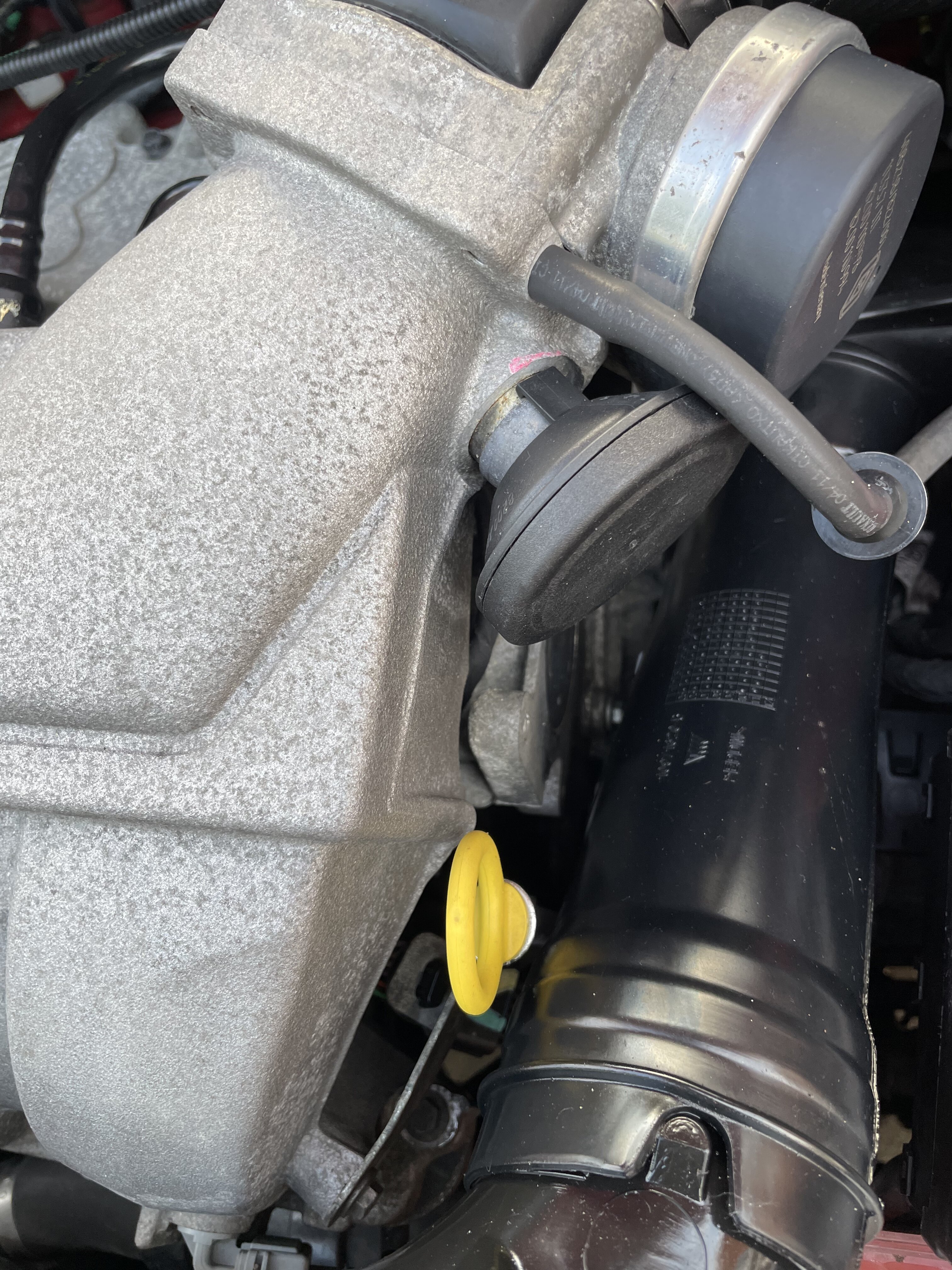

That's what the PCV looks like: https://renaultpartsdirect.co.uk/parts/engine-parts/renault-clio-197-200-pcv-valve/ you need to carefully separate it and clean it out the best guide is on clio197.net but YouTube has a couple of instructional videos if your not overly confident.

I’d prob like the sprint booster, I’m not concerned about any performance gain but just want the pedal to fee the same as my 172.

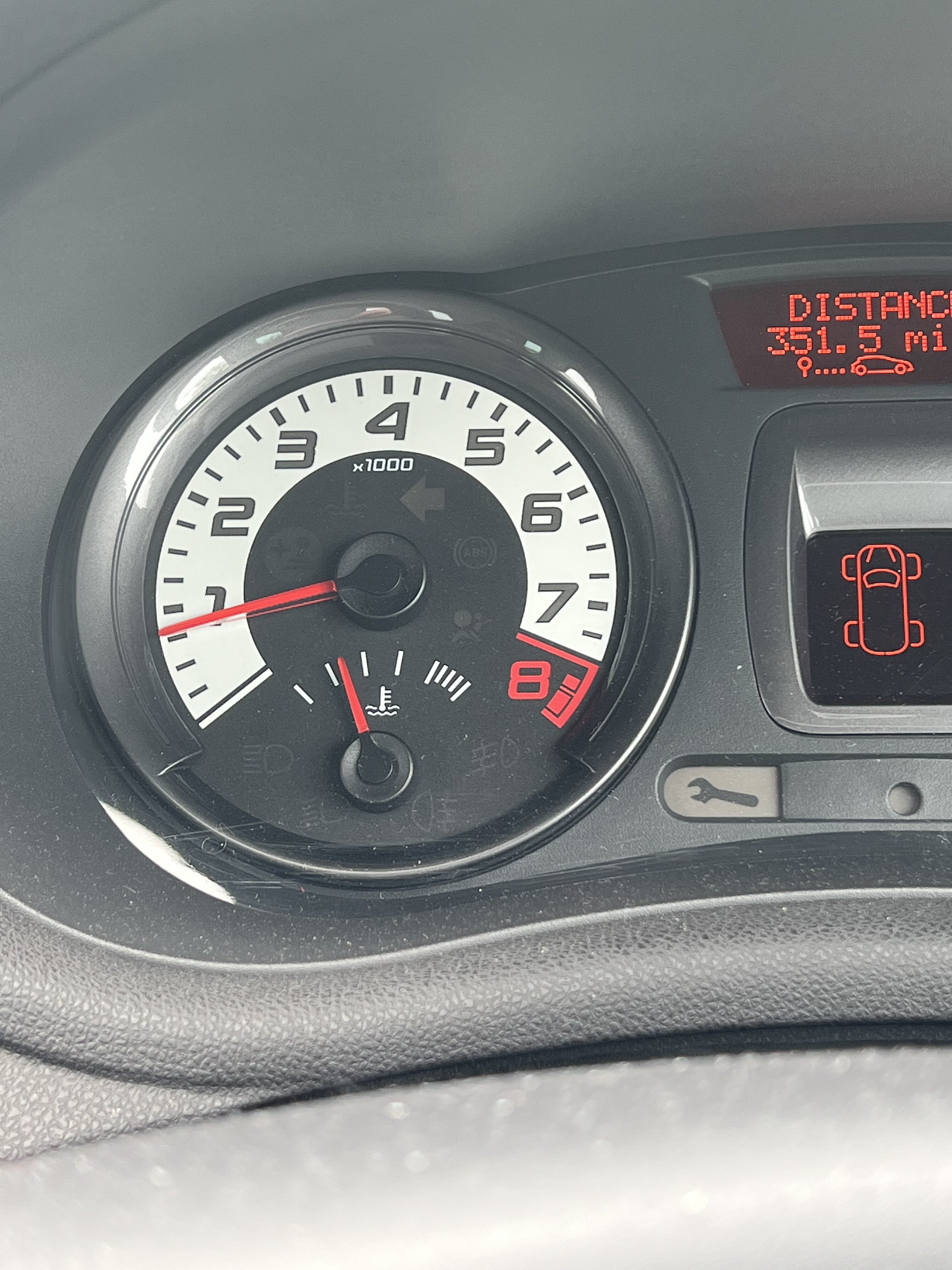

This is the car up to temp - i gather this is probably over cooling going by where the needle is sitting?

This is the car up to temp - i gather this is probably over cooling going by where the needle is sitting? View attachment 1593880
Mine was the same, I fitted a new stat (which is a doddle btw) and it sits just below the next notch now, so not a big movement. I did this at the same time as a big service, I noticed a massive improvement in running but it could have been a few things due to doing it all at once. Regardless it needed doing.

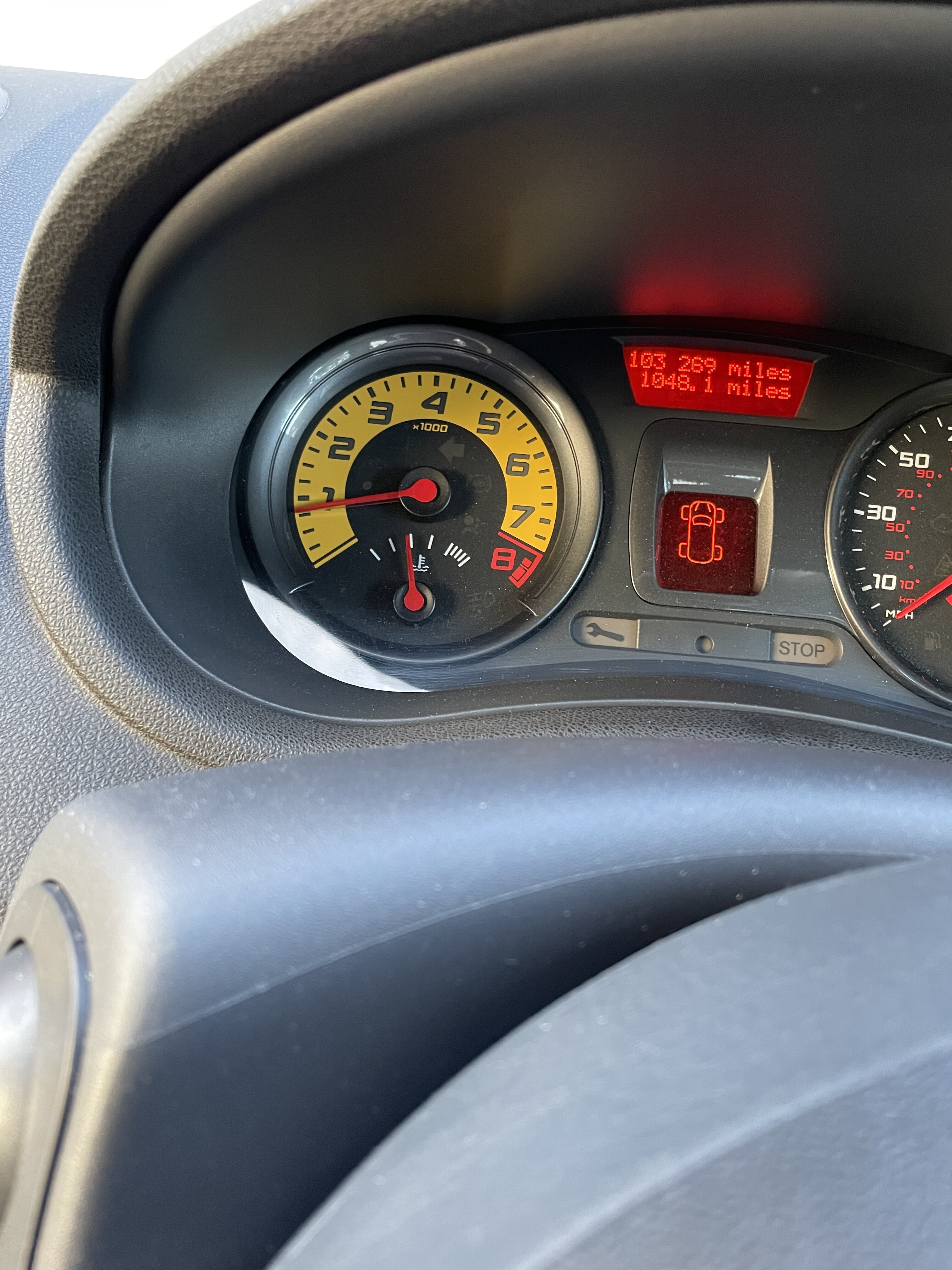

It sits at the 3rd notch normally. This is after changing my thermostat last month so I know it’s sitting right, be careful sourcing the thermostat as you want the original Renault one and not a 3rd party one as they operate at a different temperature to a normal Clio. I agree it’s a piece of cake to fit and no need to disconnect the battery and remove it like most guides tell you, instead just take out the plastic ducting. I just added a couple of pictures from my engine bay to show you the pcv location which is next to the dipstick, and I also bought a mag sensor clamp of eBay which is like a fancy zip tie and eliminates any movement and I just think for £15 why not it looks good too.
Aye stick a thermostat on that! - I put a gates one on mine as i could get one that day and its spot on (y)

Also, the PCV, whats my best options regarding clea

Is it a map sensor? Whoops my autocorrect called it a mag sensor in the other post, I must admit I don’t really know the difference between a map or maf
Just different ways of measuring how much air is going into the engine.
MAF measures air flow before the throttle body.
MAP measures absolute pressure inside the intake manifold, in this case it's vacuum in an NA engine.

I’ll get the PCV whipped off and cleaned and see what sort of position the sensors sitting at. I actually enjoy these small jobs!
