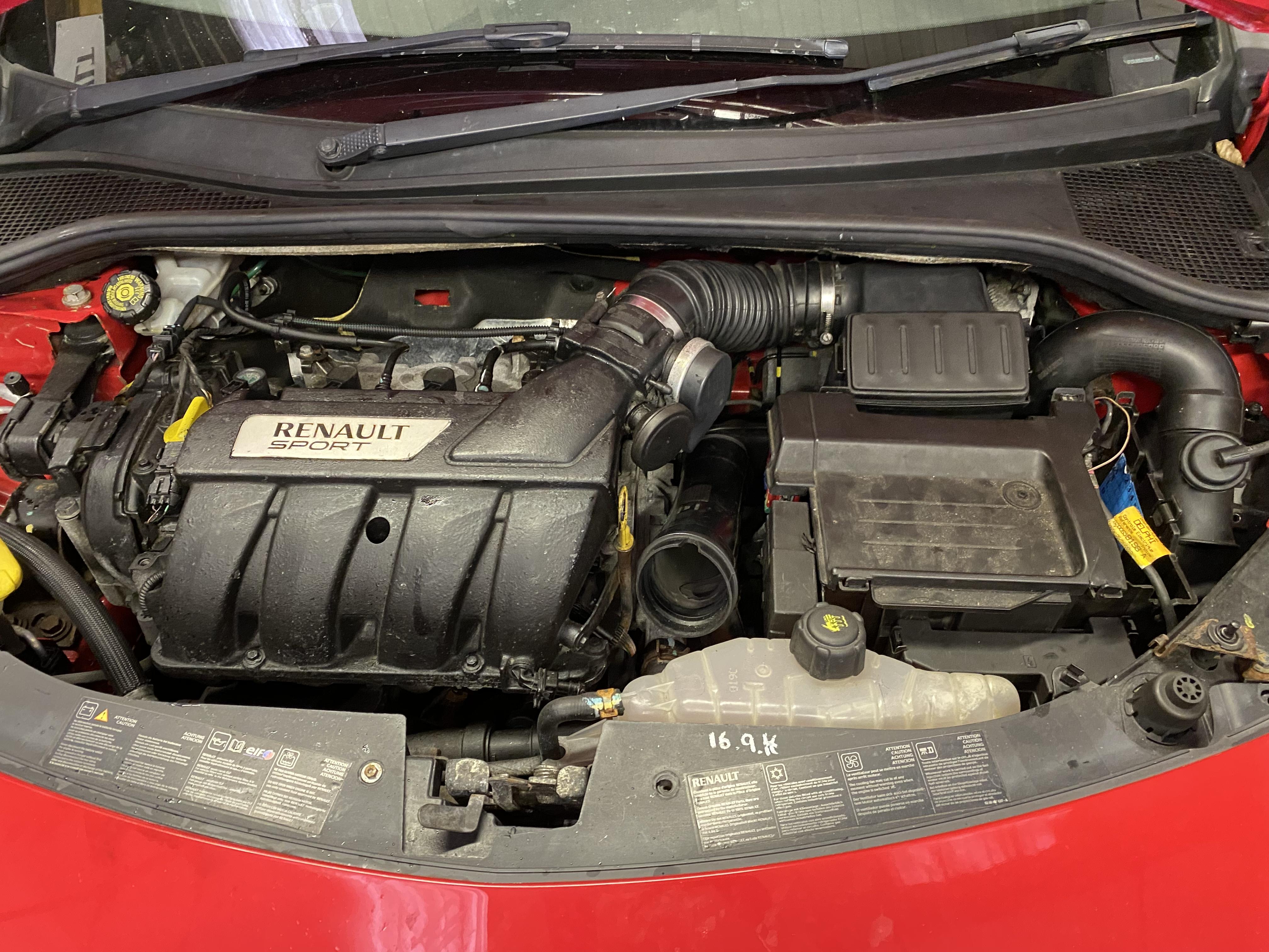

I refitted a standard air box today and it def feels a bit better cold / at parts throttle.
I also cleaned out the PCV and took the VVT solenoid out. Both were pretty clean. Just a little emulsification in the PCV.
I think the rest of the hesitation / flat spot I have is from the exhaust. It’s a non standard manifold and the joint to the mid section has a slight blow.
Excuse the badly painted inlet.

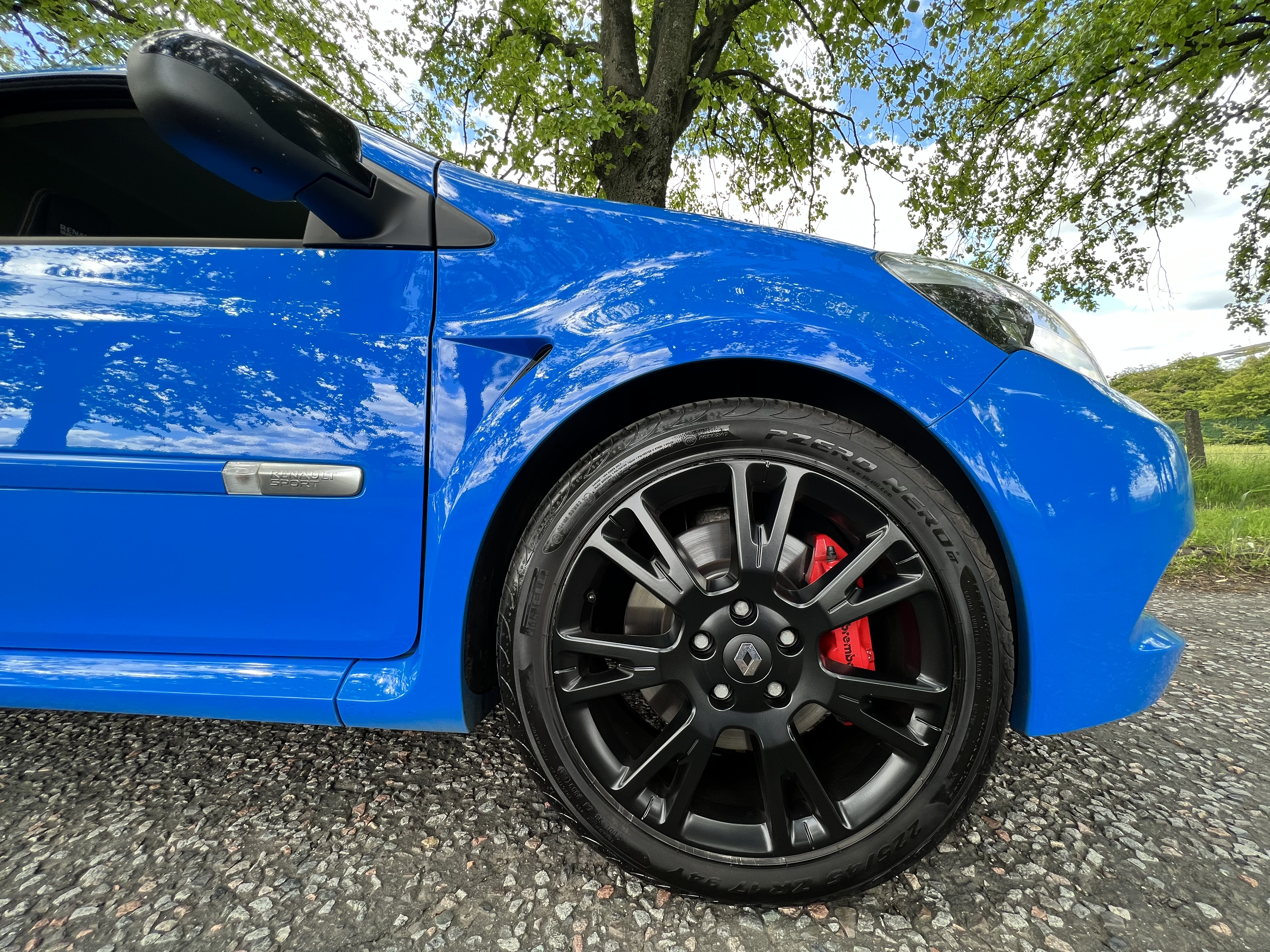

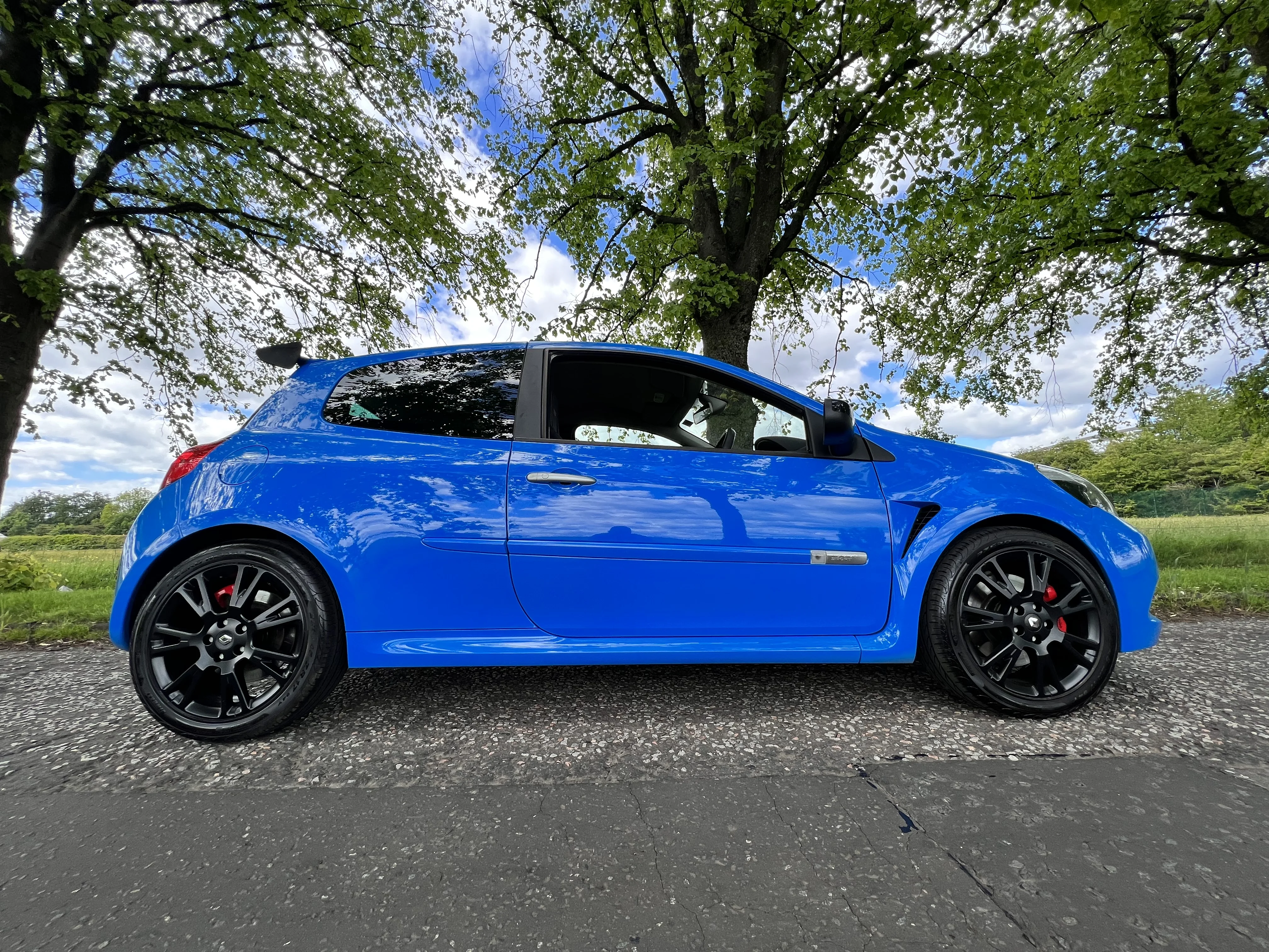

So the wheels were the only part of the car letting it down cosmetically, i got them done by a friend who has a lot of experience in wheel painting (Archlight Restorations), will let the pictures do the talking!
Back to satin black - centre caps matched also!

Looks flawless now.

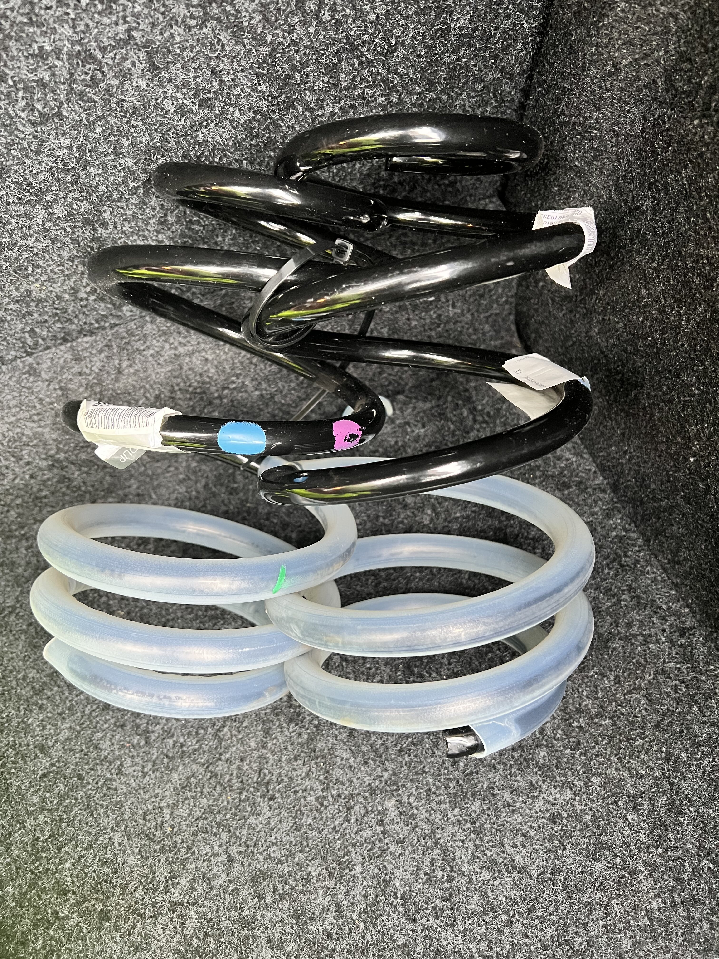

So turns out the grumbling on the o/s of the Clio turned out to be a wheel bearing and not a swivel hub as i initially thought, when the lad that works on my motor inspected it he found that the front of the motor was wearing two different f**king springs altogether
I just don’t understand how the f**k that happens, furthermore, two genuine cup springs and two genuine wheel bearings later (the n/s was starting to hum the tune of its people so f**k it, replace that b*****d as well.
The tracking’s going to need doing after this as well i suspect.
