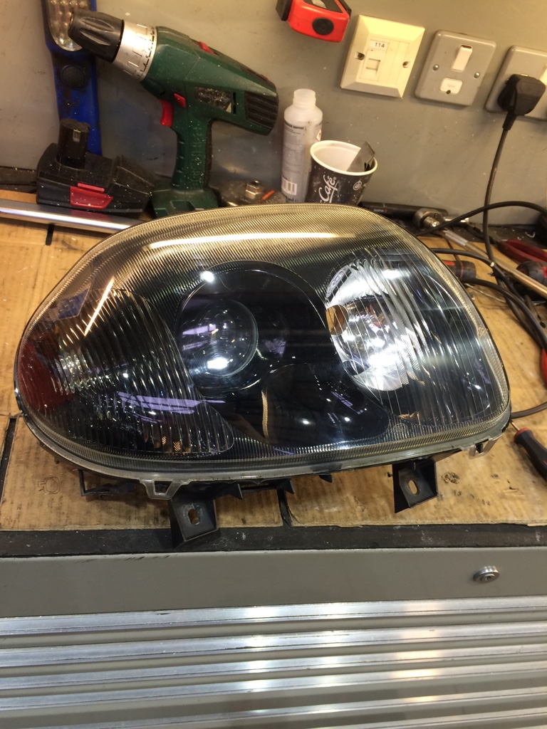

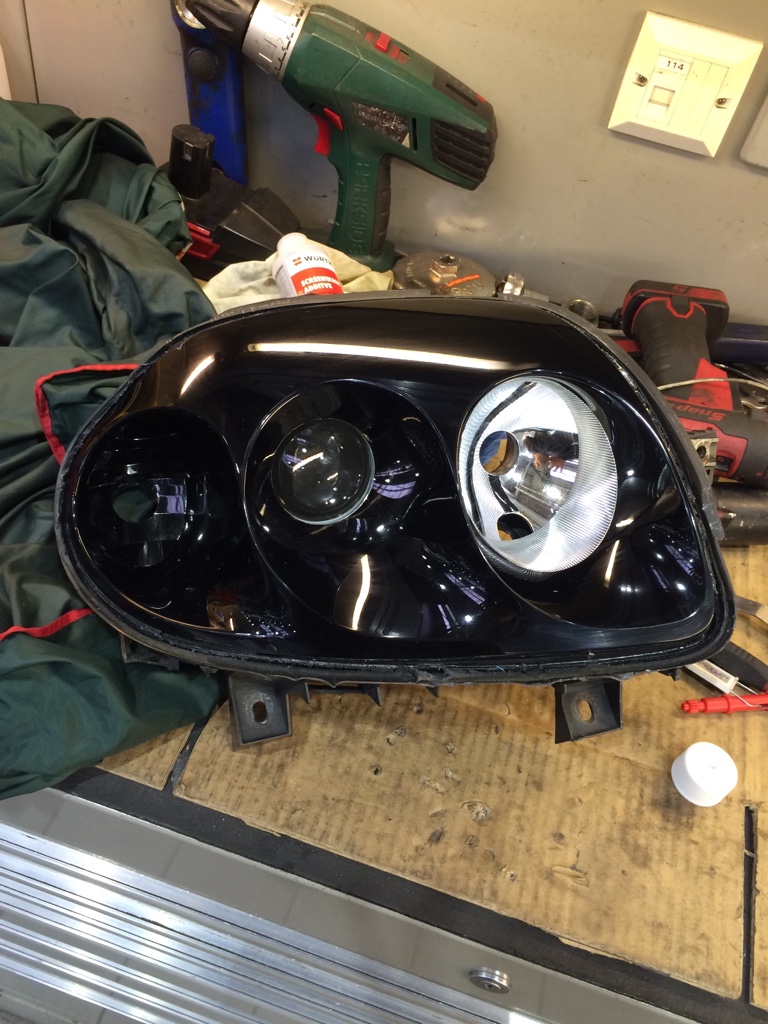

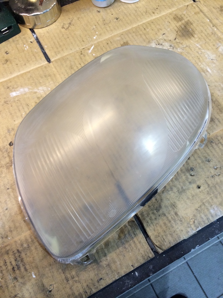

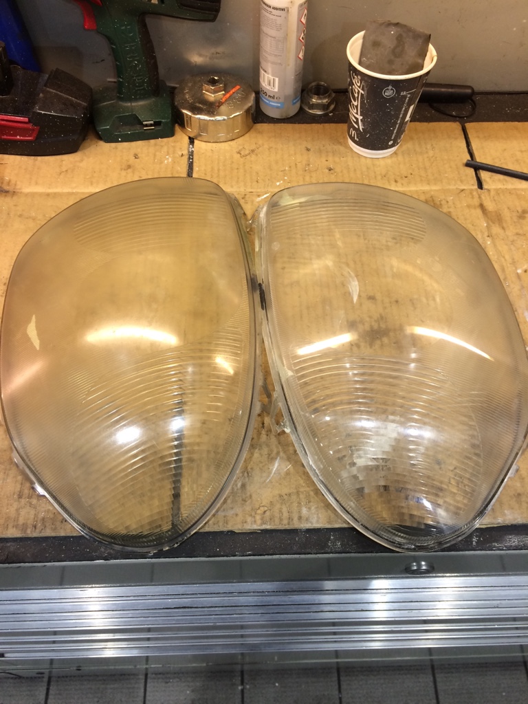

If you remove your headlights, you can heat up the edges of the lens with a heat gun untill the glue goes soft. Once it's soft, you can unclip the lens cover. Get some antibacterial wipes and rub off the chrome around the bulbs. This will give you the black headlamp look. Once finished, clip the lens cover back on and refit.

I would say not , as you have to heat the glue holding the lens on .
I also thought I was going to paint inside black .
Happy days in scraping off the chrome .
I have a few spare lamps so I'll be experimenting soon then .

You have to remove the bumper to access to full headlamp. I'd also remove it off the car then heat it up rather than in position.
It doesn't need scraping off, mine literally just wiped off using Tesco anti-bacterial wipes. With lemon fragrance!

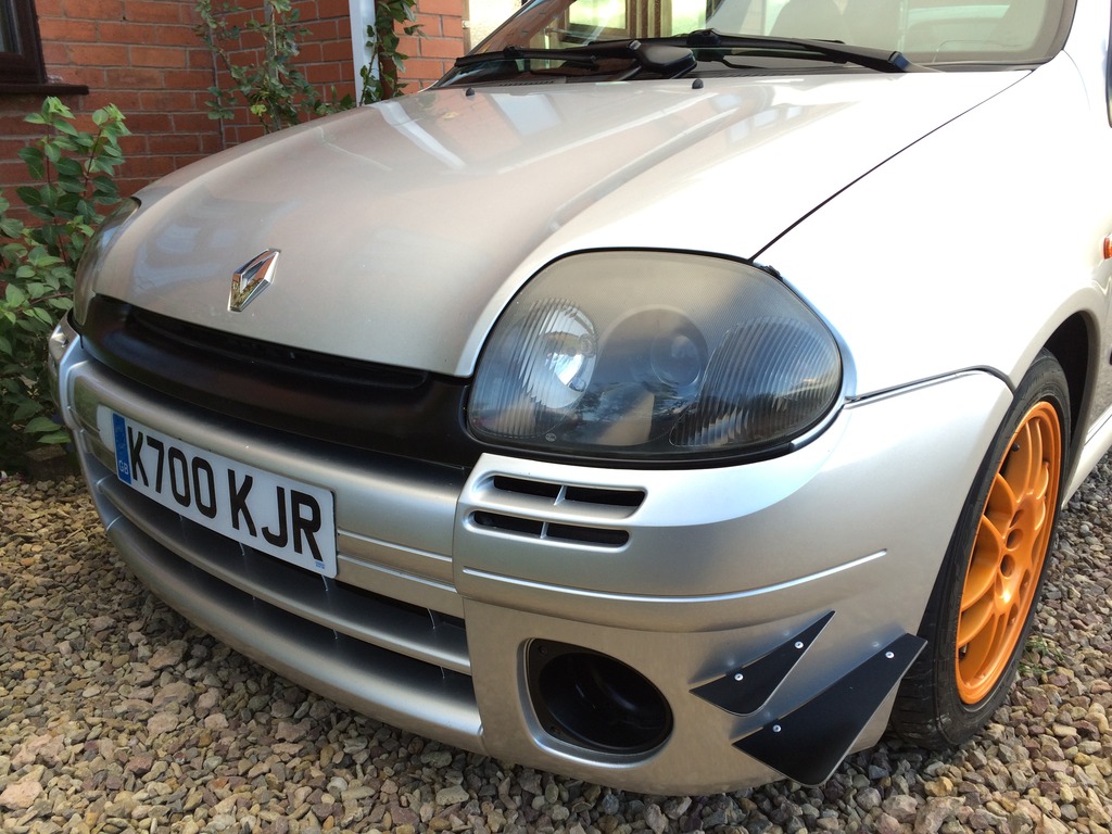

Step one complete.
I used damp cloth .
Jekyll
Yeah the glue only needs to be warned up so it becomes weak. It'll just pull off after that.
I made the mistake of getting the glue on mine, hence how I know it removes the chrome. I wanted to remove the cover but keep it chrome.

@KitsonRis No need. The gum stays on the outside of the headlights so it just bonds back on as its still sticky. The clips hold it tight too. Mine was fine.

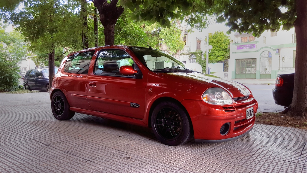

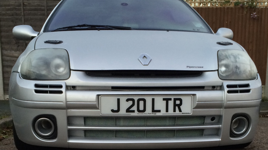

That picture has convinced me to do mine!! Another job for the winter then. The amount of times the front bumper is off I may have to fit a quick release for it!!

That looks awesome, you left some chrome around that bulb, I imagine it would be on purpose because it acts as a reflector ? and the projector side doesn't need the chrome anyway right ?

The chrome around the bulb is different plastic/coating IIRC.

That's correct . The chrome for the main beam bulb is positioned around the bulb and is separate from the now black plastic piece that was chrome.
With regards to removal of the bumper , once all the bolts are out and the arch liners are either removed or taken off with the bumper it's relatively easy .
The hardest part is removing the grille on a Ph1 , where it clips into the headlamps in each corner . Can be bloody awkward to prise apart .

As said its really simple, and to add to @barnesautos comment about the grill, do not let it swing/drop one side while being conencted as it will brake the tab holding it in....I found out the hard way. It is like you need to remove the lamp unit before you can remove the grill, but the grill needs to come out to remove the lamp, its a pain.
Love the front - looks great with the headlamps now
Yes, yes it does!! Let me get my brakes done and my seats back in (door cards and flocking the dash can wait pending funds) then I will do the lights! They look mean as
