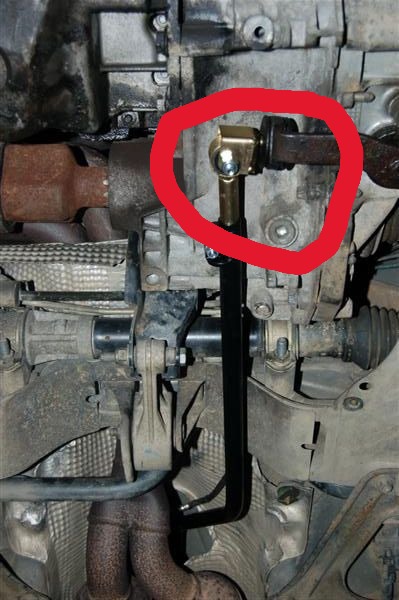

Hi lads PMS Shifter owner here too , i got his for 6 months now and let s just say i fix it and for now i don t have any rattle in my car no matter the rev range . The picture that i ve attached shows the small metal link that connect the gearbox to the selctor rod , that small link has a round ball that goes where that rubber gasket is and it sits in cone shape , i ve put some electrical tape on that ball and the put the small link back and connect everything , i know it temporary job but im looking for something permanent , the original link that ball was made out something softer more like teflon coated .
  Clio 2 ph 2 1.4 16v
Forgot to mention i got standard bearing and not the teflon coated one but between the bearing and tower where it sits i ve put a fine cardboard washer with loads of grease and then put that securing clip at the bottom .
