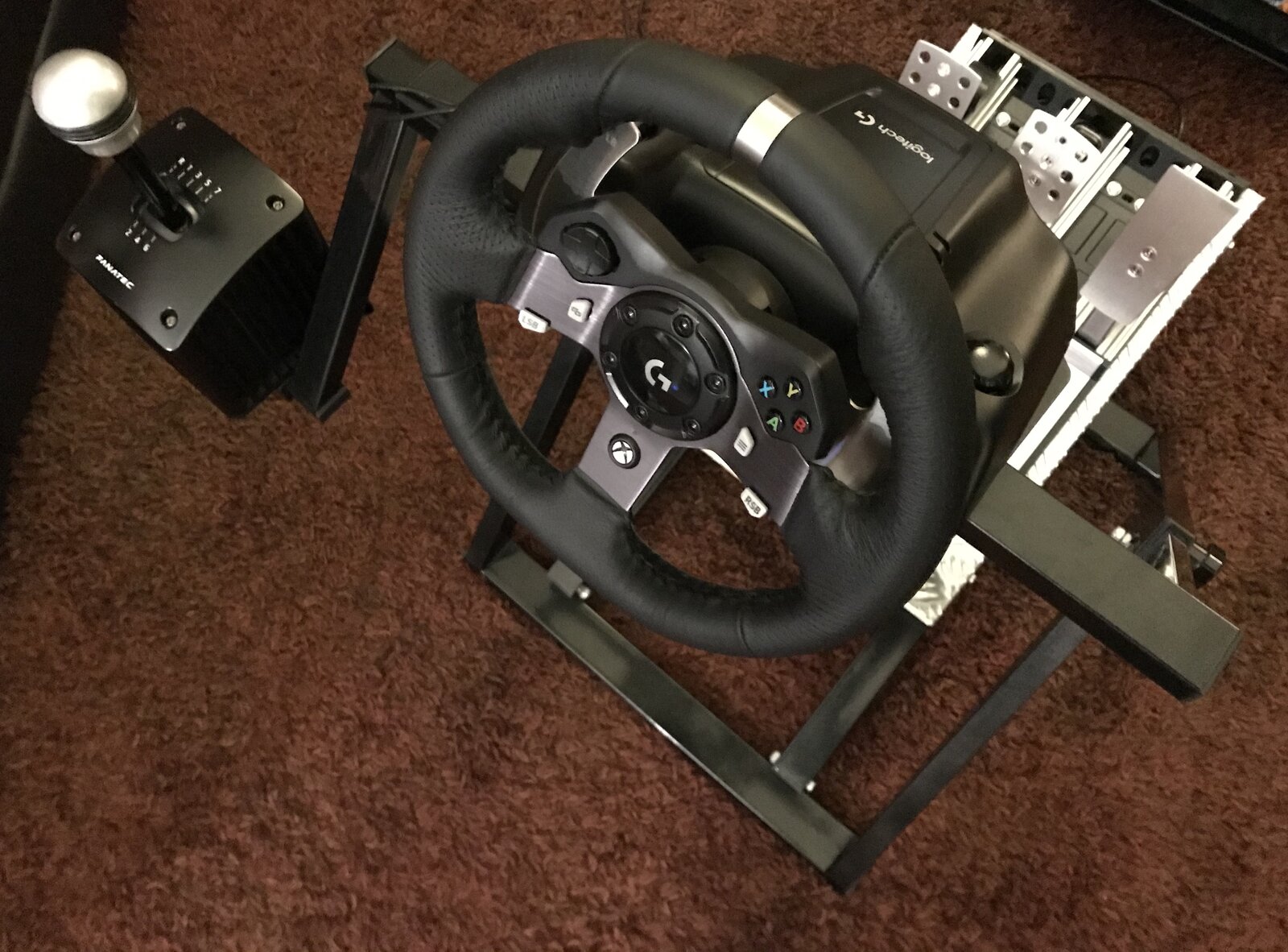

Finished the Logitech/Fanatec hybrid eventually. It's been a bit of a trial of patience, but got there in the end. The pedal base is now connected to the frame floor in no less than ten places - so that fecker isn't moving at all - even under my size 10s. The main reason for doing so was having drilled the frame for the top edge of the pedals base to fit, the rear of it had no support frame underneath to be bolted to. Luckily, there's a central section of the pedal base that would allow 40mm bolts to be passed through and to the aluminium base plate below. Obviously aluminium, even when its pretty thick, isn't the strongest of components - hence the shotgun approach to the centre bolts. I'd rather over-engineer it to begin with - especially if it doesn't have to be removed.
Tried it with both Assetto Corsa and Project Cars 2 last night and it works a treat. I'd be massively quicker using the paddle shifts for gears, but there's something more fun and tactile coming up to a corner, pressing the clutch and braking whilst downshifting from 4th to 3rd. Now there's just the small matter of cable management and cable-tying the frame...:)

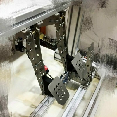

I think something like this might be my next project..
Darren S
Rich..
  Golf
Pedals aren't silly money by the looks of it?
  • This product includes pedals inverted modified parts, without the pedals
What you’re getting there is the black plastic part for modifying the pedals.

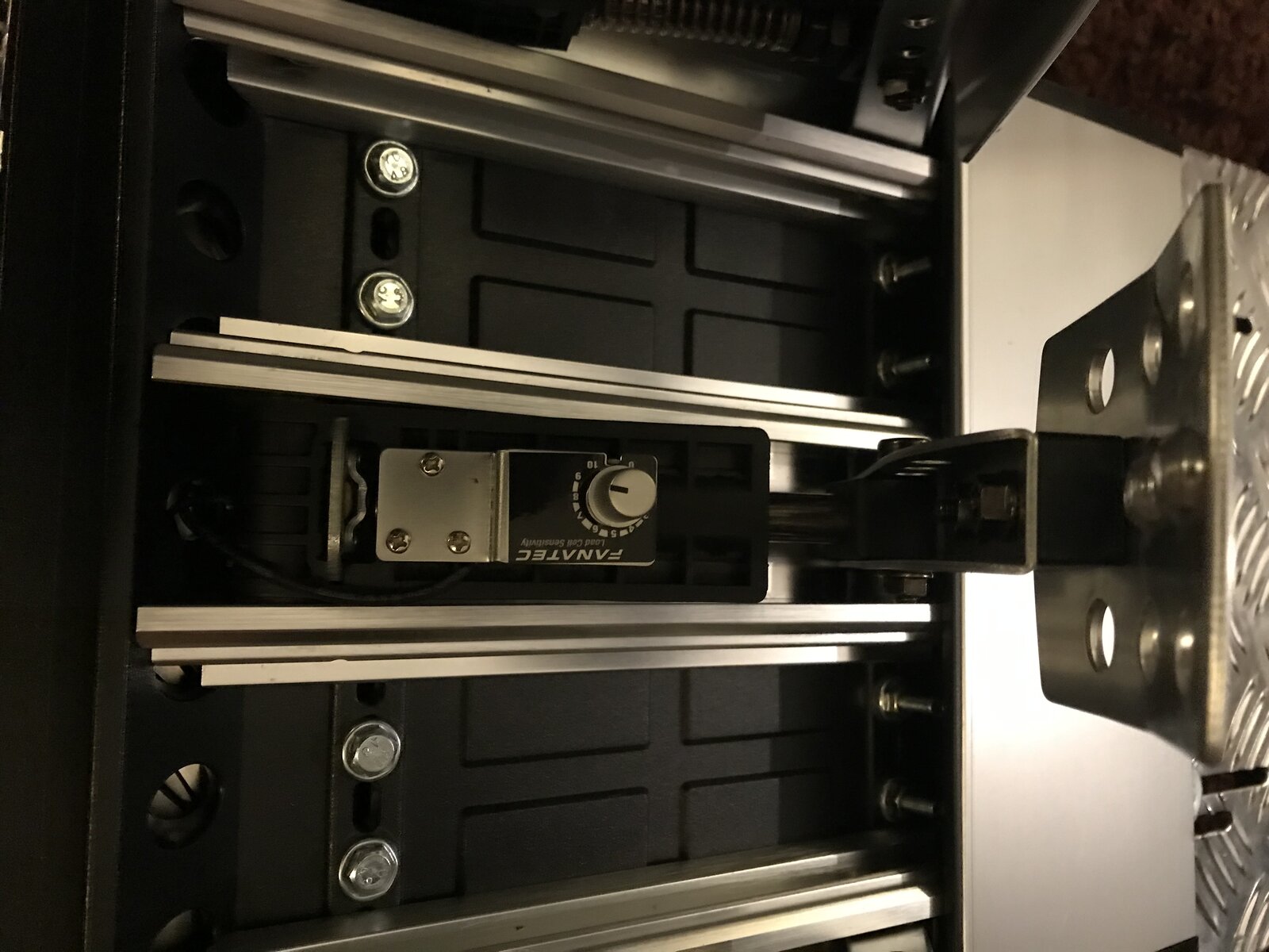

Looks like the brake pedal has gone back to being a lottery when you need it. Nothing, nothing, 40% - wham 100%. Or worse - downshifting to a corner and just nothing coming back from the middle pedal. Hello Mr. Barrier.

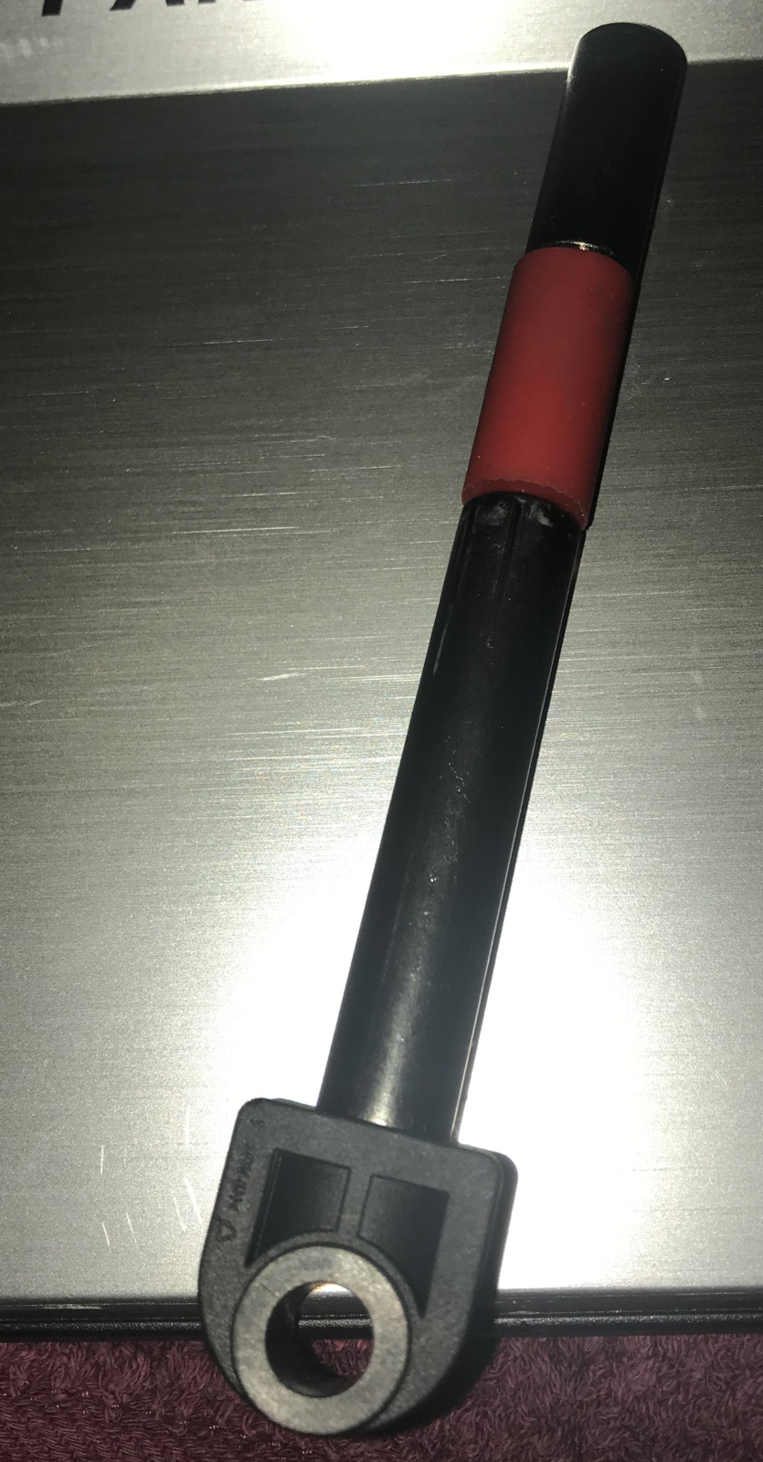

So.... took a punt on a replacement load cell through eBay (less than a tenner) and then needed to address the PU foam issue within the brake cylinder. Over time, the foam fails one of two ways. It goes rock solid with no give whatsoever. Or it goes that soft as to offer zero resistance and attempts to 'mushroom' out of the opening. Reading online, a number of people have replaced these with PU rods of Scope A50 spec - though some have gone as high as A70. That must be Olympian levels of thigh muscles that require that, as A90 PU is used within suspension components.
Managed to find a online seller in Sheffield that will do a 30cm PU rod cut down into 25mm lengths for a cheap price. Might keep a couple for myself and sell the others through eBay for the other poor Fanatec saps who are suffering a similar issue. Assuming it fixes the problem that is. ;)

Meh - my replacement A50 PU rod idea didn't exactly go according to plan. Stripped the brake pedal setup again last night to insert the new load cell. Typically, the cable on the new load cell itself was about an inch too short, we then required drilling a feeder hole through the base plate.
Ran that to where it should go, connecting to the PCB underneath and set about swapping the Fanatec foam block for one of the A50 rods delivered. Oh dear. The result had the same about of give as pressing a house-brick under foot. Completely too stiff - another lesson learnt not to believe everything you read on the internet and that A50 is a close replacement for the OEM item - clearly it's nothing of the sort.
However, swapping that for the standard Fanatec foam with the new load cell has made the brake pedal work perfectly. Through the calibration software, I've got gradual pressure and control over the brake pedal now. A bit of wasted money, but something else learnt!
