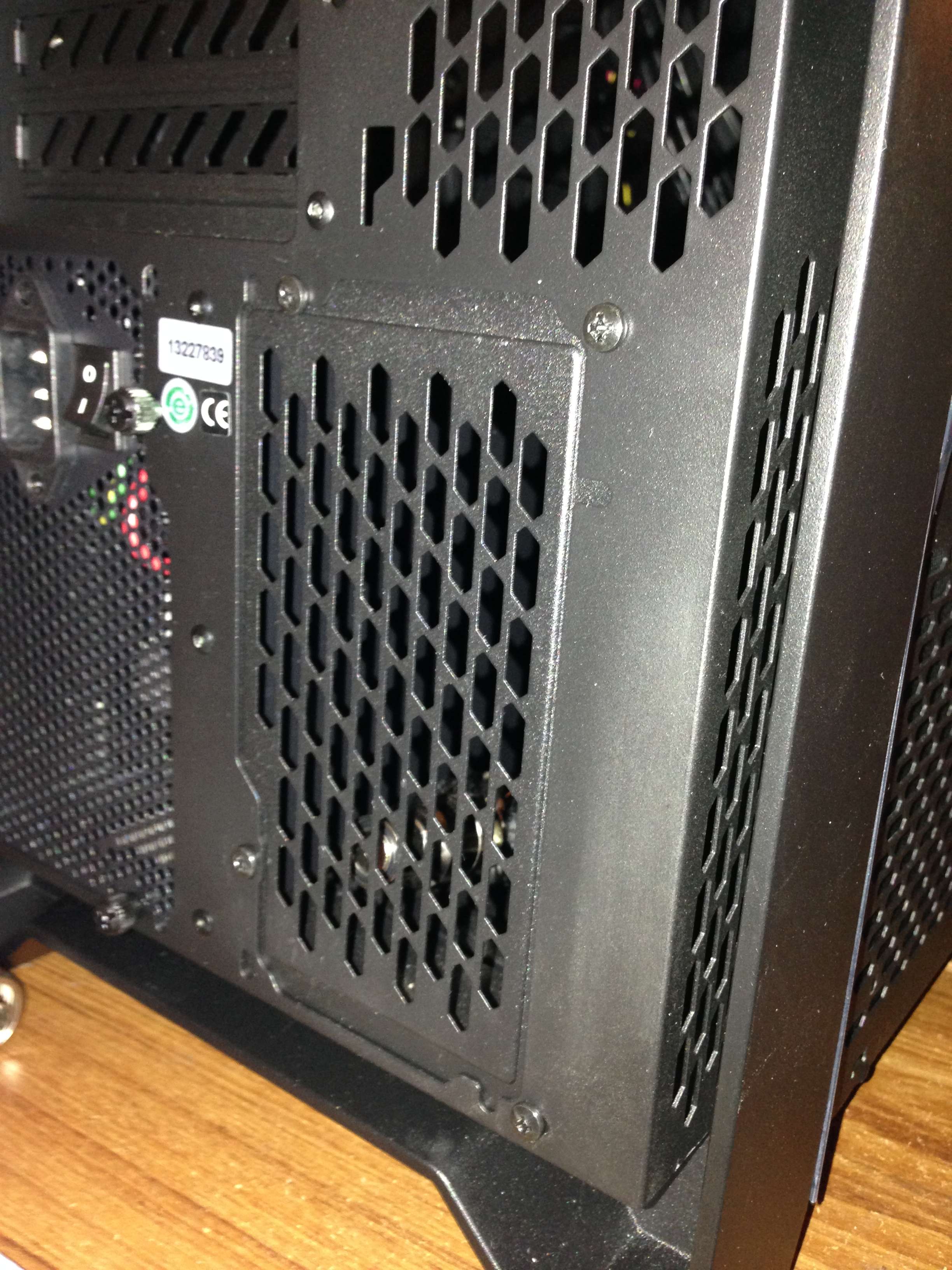

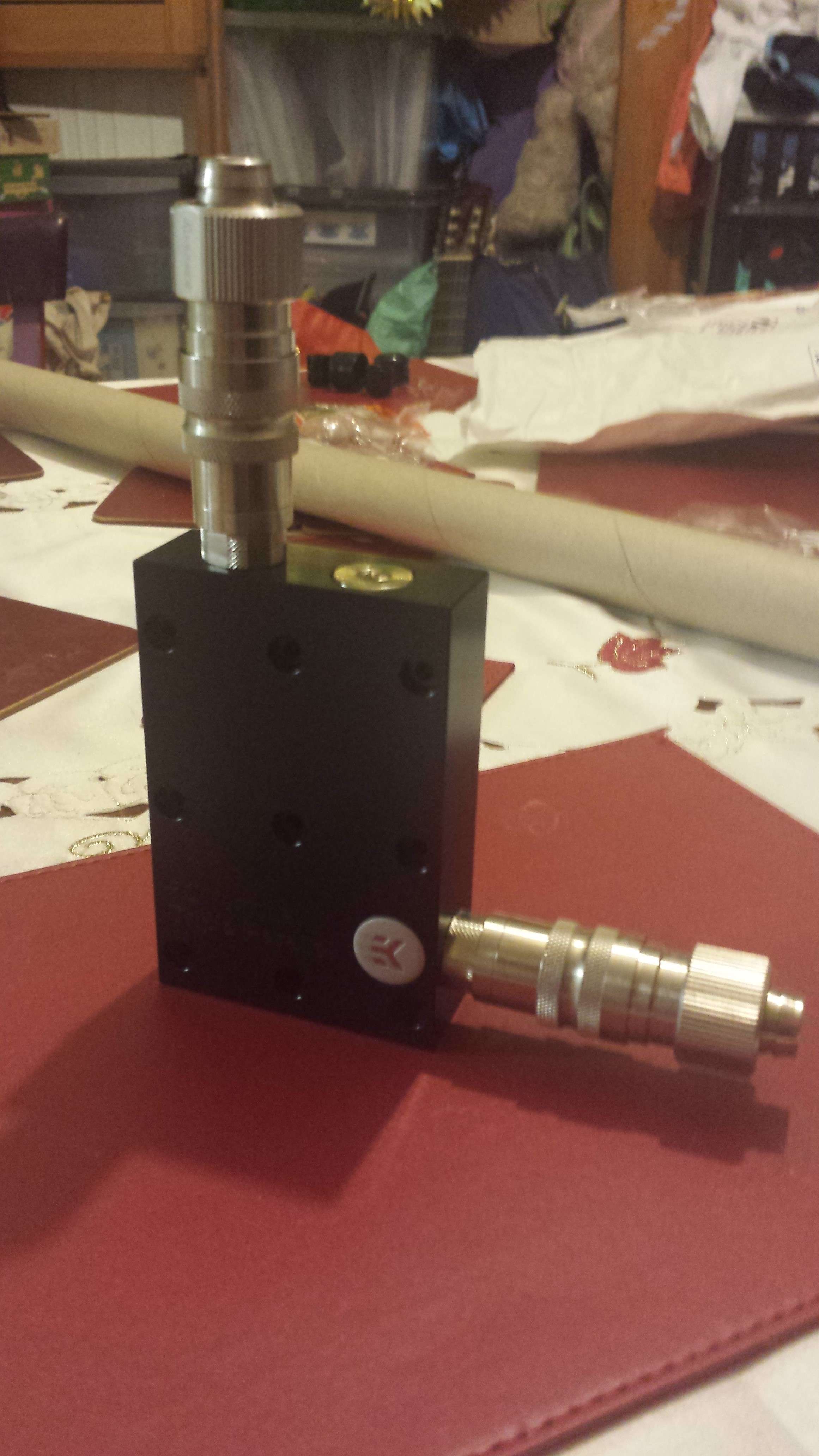

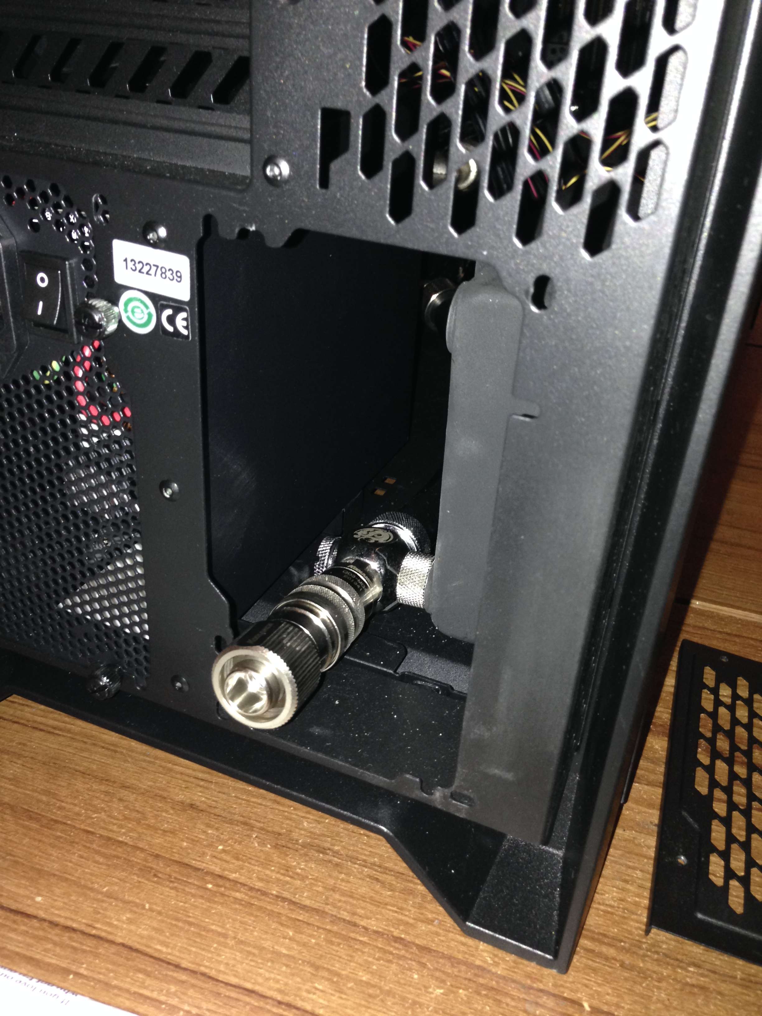

EK GPU triple GPU bridge with Koolance quick disconnects connected. Seeing as I go through GPUs more than hot dinners, makes sense to be able to replace them without having to drain the loop :)
Using them on the CPU and possibly the res too. They're a god send.
Oh, and one as a drain line :)

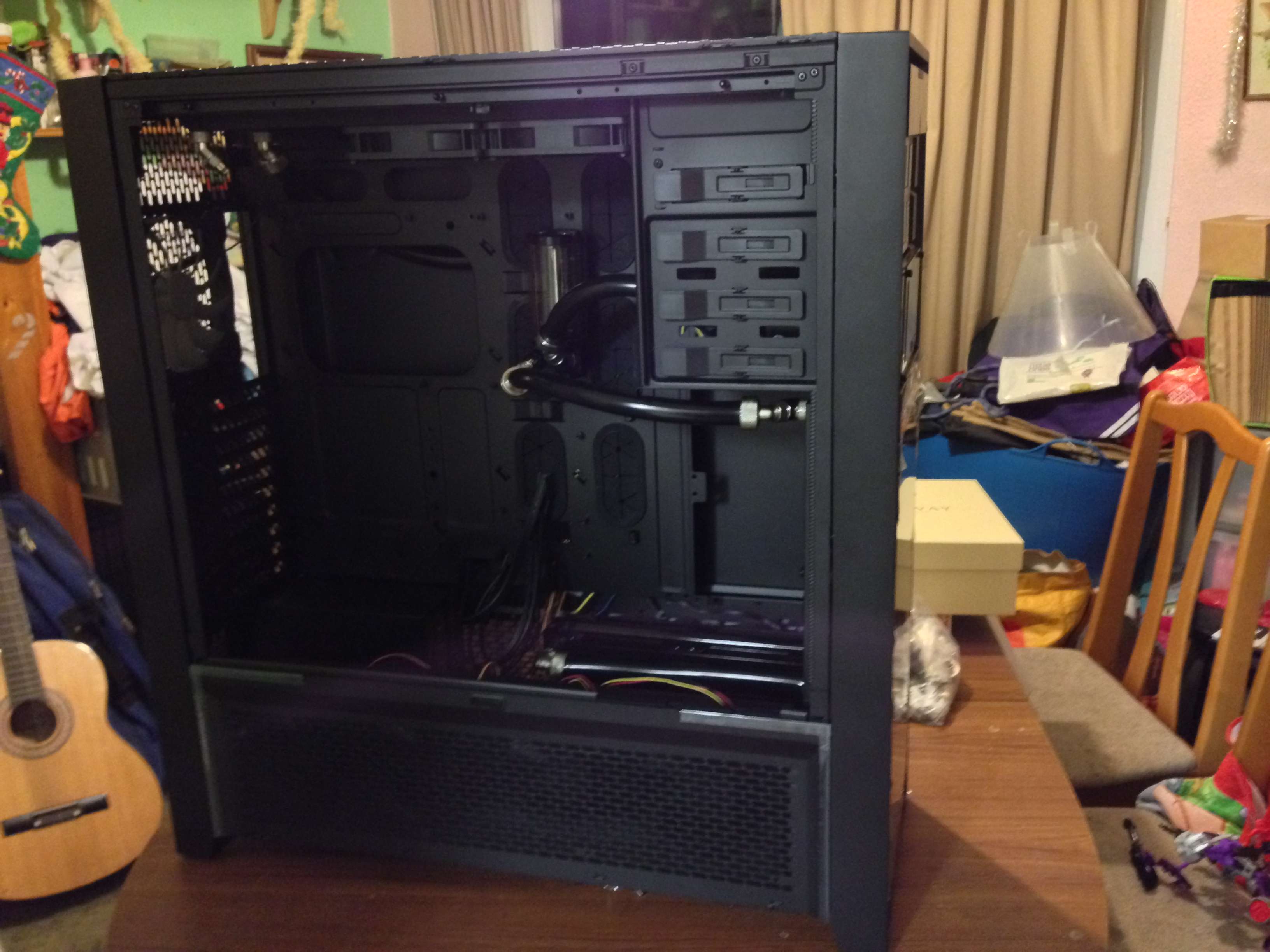

Loving the 900D Mike!!!
Such a mahoooosive case!!

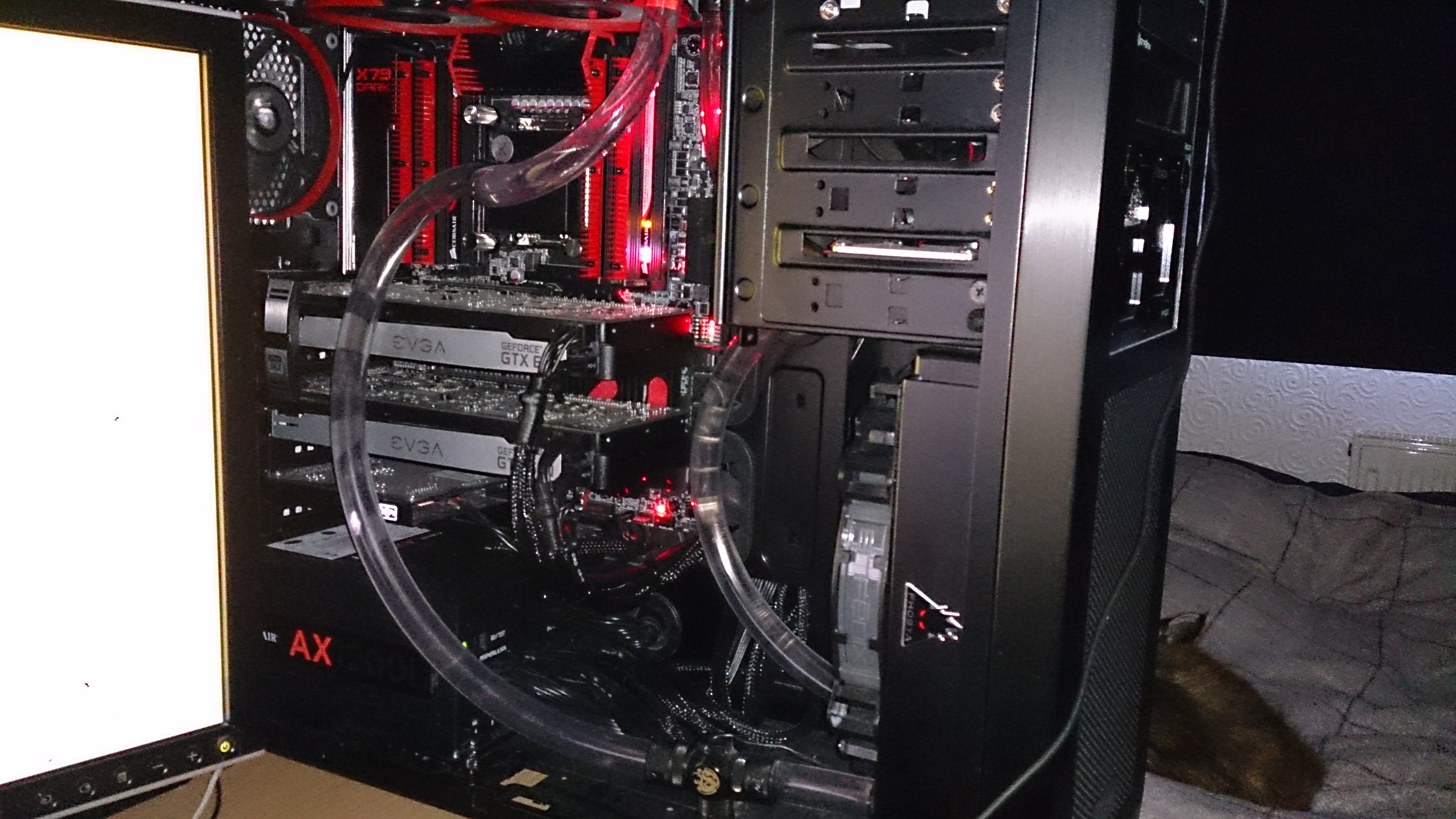

Had to remove my GPU's from the loop for now as one of them died, as I safeguard I kept them off of water for now, to save draining the loop which is a complete PITA.
Apologies for the poor picture!
Also.. The AX1200i is going, hopefully in the bin...
Bad PSU. Always used Corsair, but this one is non-stop buzzing. Especially under load, it is louder than the 2 x GTX680's at full chat.
This is the 3rd AX1200i I've had from Corsair, they've replaced it with a brand new one every time, each one has had the same problem.
Bought an EVGA 1000w P2 to test, not a single noise from it. Very impressed with the build quality too.
Might keep it and replace the AX1200i with it.
Motherboard is also being replaced due to instabilities @ XMP settings speeds, so another RMA there.
This build has been no-end of problems!
Have fun fitting that triple block.
I originally got a double for my 2x 290's (meant to get the 3 slot double rather than 2 slot), theyre such a b**ch t get the o-rings to sit properly when trying to screw them on xD
Once I realised I bought the wrong one after spending like 30min fitting one gpu, i decided to f**k it off altogether lol.

No there's a guitar in the bottom left of your last picture, I've already seen a case and waterblocks, I know what they are :p
But you're not familiar with an acoustic guitar? It's not mine it's the Mrs. I don't have the patience for it, she's good at strumming though

Yeah, don't. I've heard what c***s the O-rings are.
They aren't thaaaaaaat bad.
Although I've never used one of the CSQ bridges, used the older style.
If you're having a problem with it, try stretching them ever so slightly, like, a tiny amount so that they fit in the crevice, should stay there then.
I did, and didn't have any leaks until I managed to split my radiator... ;)

I had an AX1200i and yes I can concur it's s**t. Nothing like the AX1200 before it. Seasonic no longer make them so that's probably why. Heard people running 3 Titans with the 1200i and it falling over. Not good! Mine also buzzed. Sorry you've had s**t luck with GPUs! Hopefully I won't follow :D Rig looks ace btw
