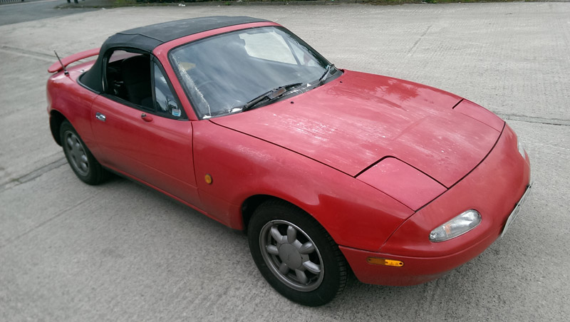

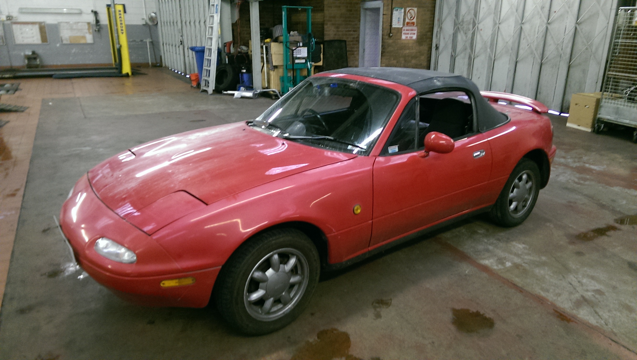

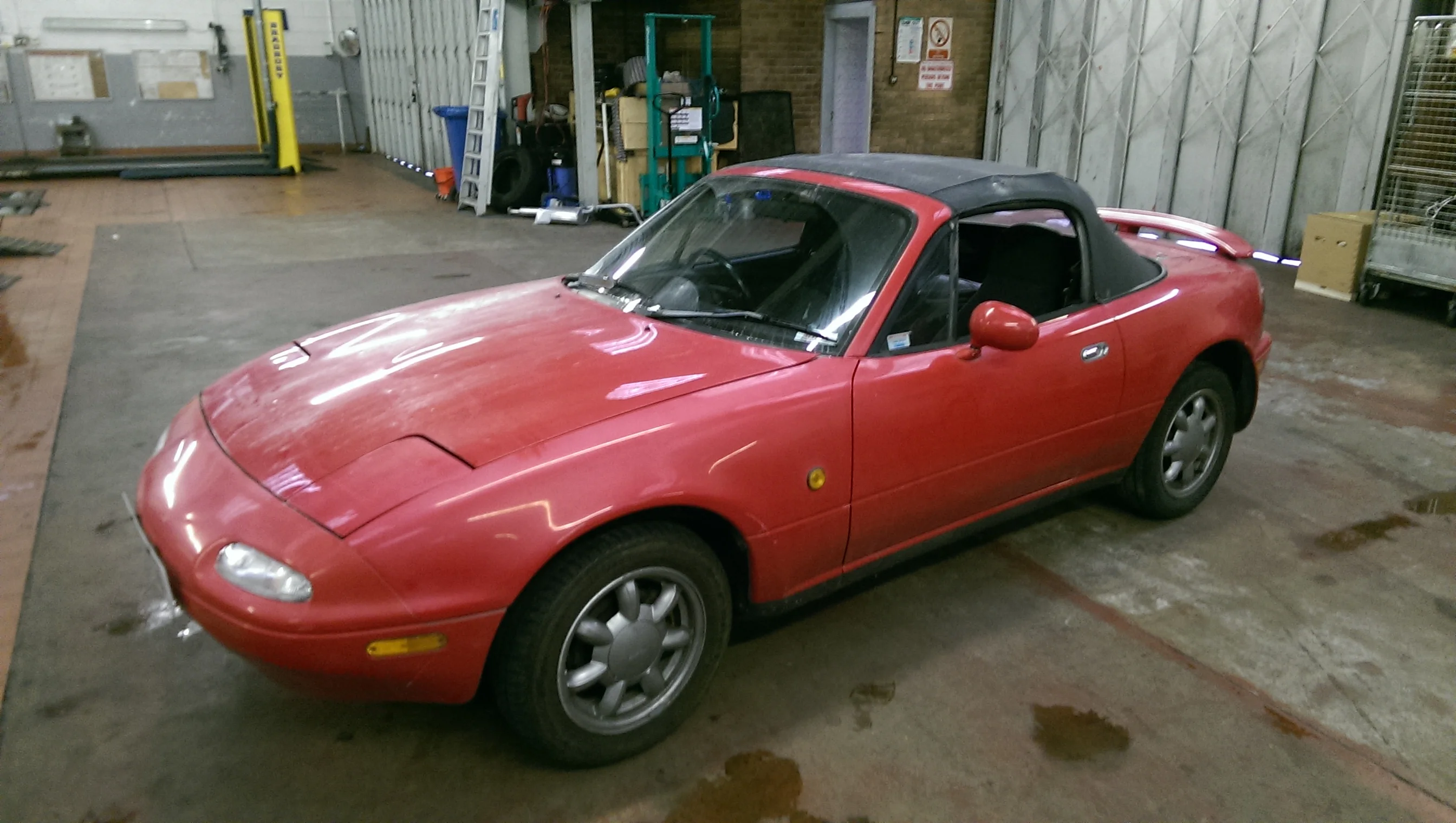

Picked this up today, just run out of MOT but would pass with very little work... Anyway that's not important, is getting ripped apart and turned into something that can be spanked on track and (hopefully!) cost very little in the process!
Car was £500, already sold the roof for £100, wheels will go on my daily as the tyres are getting low on it, so have given myself £600 to do all the rest of the work.
Anyone who gets precious or sentimental about cars shouldn't follow this thread, it may get fairly brutal!
Plans are... No engine / power mods at all, build myself a roll bar / cage and chassis bracing, find some 13" wheels so I can get cheap slicks, get it as light as possible (within reason - I won't be spending hours stripping looms for example!), GRP seats, probably some DIY aero (no big gay wings though!), and a fairly significant modification which won't be reversible...!
I'll bang more pics up as and when I've had chance to get stuck in :)

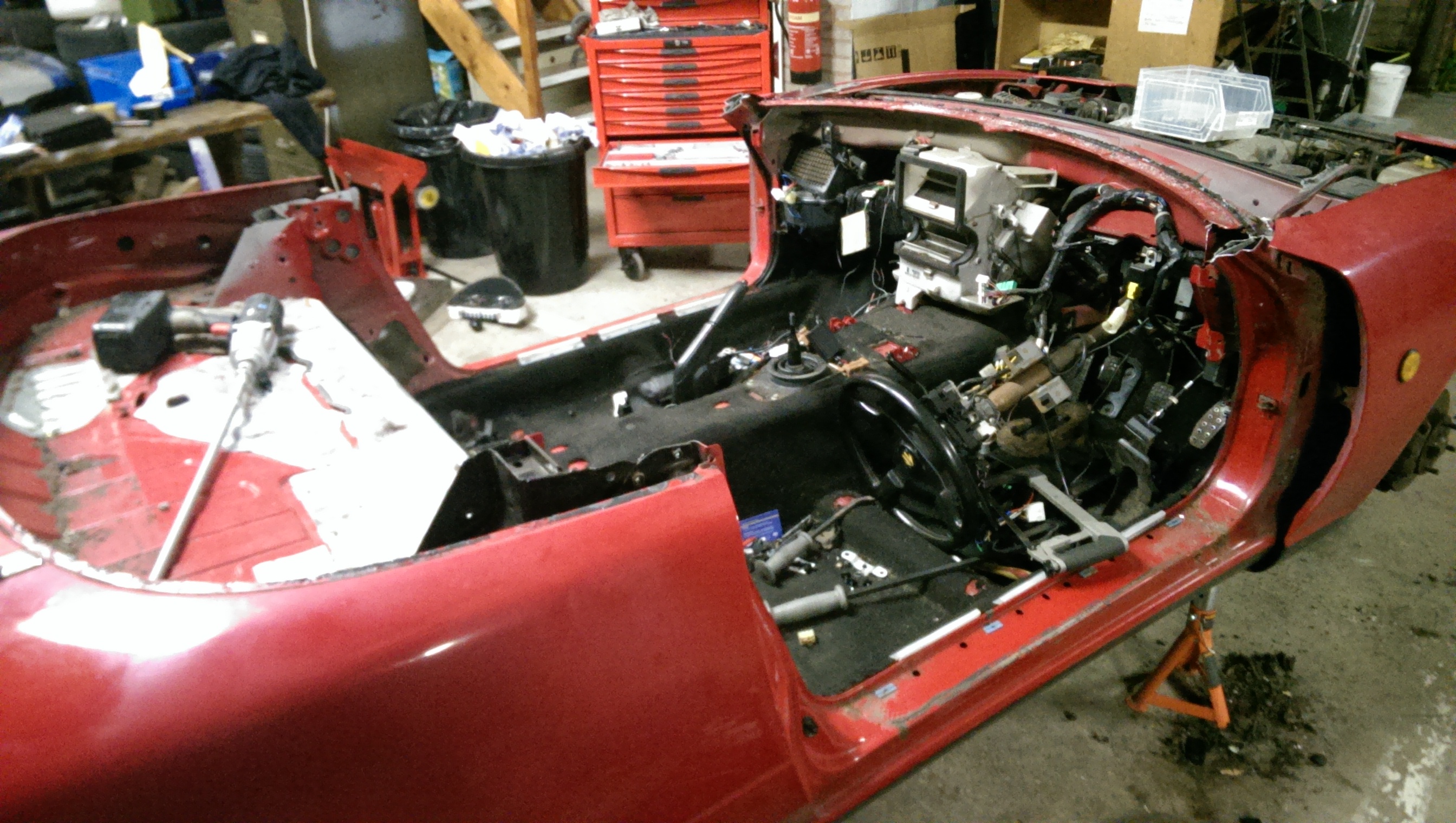

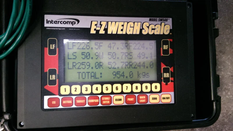

Got 3 hours in this evening. 2 knuckles skinned so far, and the start weight was 954kg (including a pile of 90s CDs and a floral cushion).

Sorry, where's the windscreen!! I presume this is the irreversible part.
I'm also not sure you can call it red! Look forward to reading more.
Hmmmm, interesting... I have been offered almost exactly the same project, even with a unit to work in. I should take notes!
Windscreen is on the floor of the workshop :) 14kg! That is the irreversible bit, yup...

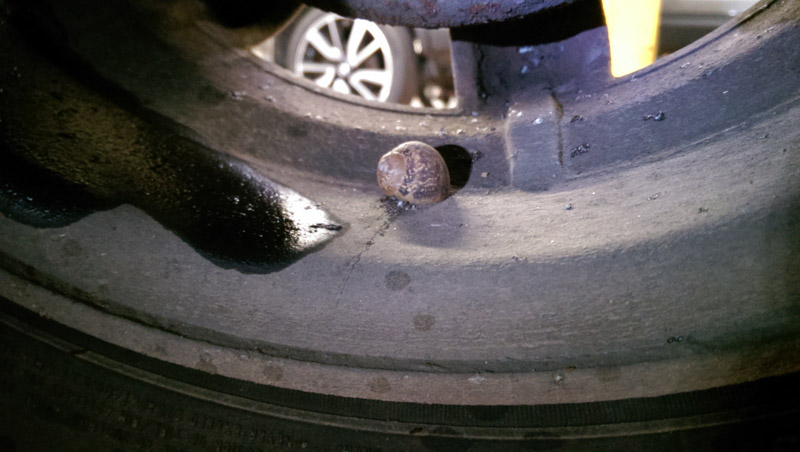

Snail wheel weight:

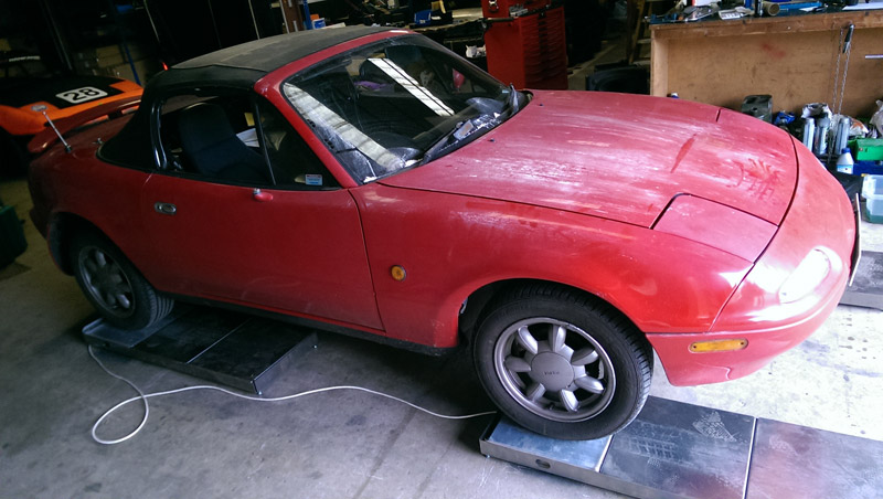

So, the first task was to weigh it - using scales that cost twice as much as the car, haha.
Ignore the corner weights, the platforms weren't levelled up and tyre pressures all over the place as I just wanted the weight of the bare car
Bare car? pfffft, loads left on that! :wink:

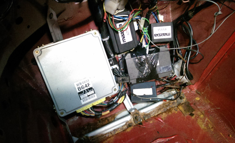

Bit more progress last night / this morning, although it was halted somewhat when I came across Satan lurking within the wiring somewhere...
So I did what every non-paedophile would do*, gaffer taped the s**t out of it and hid it under the panel for the ECU.
However, the car then wouldn't start. Fuel pump wasn't running, arse. Pulled the panel again and found a loose connection, fired up after that - phew! Very very glad I checked...
*Studies show that the level of patience and commitment required to meddle with automotive wiring is on par with that necessary to groom a small child, ergo you must be a paedo if you like wiring.
Hopefully if I do get any more issues there will be a wiring diagram somewhere as it seems to be a Mazda OE fitment...

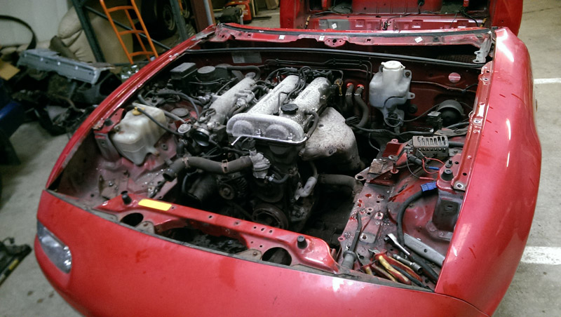

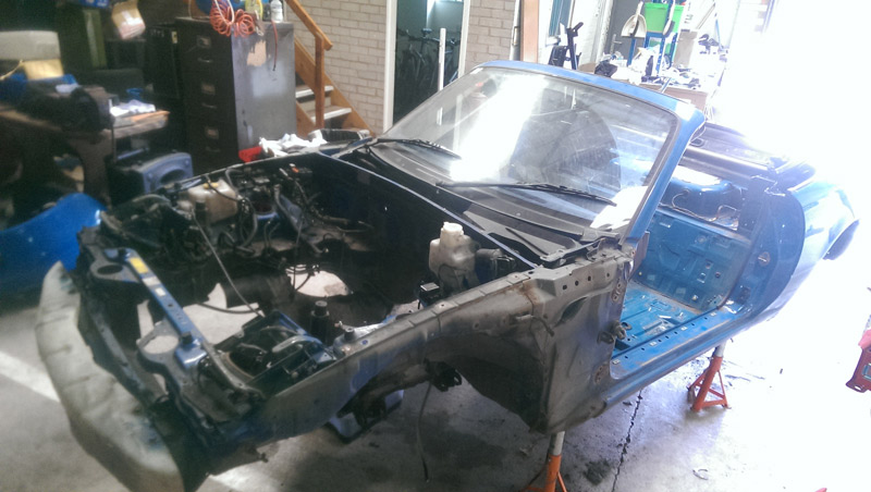

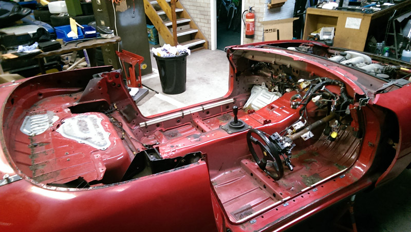

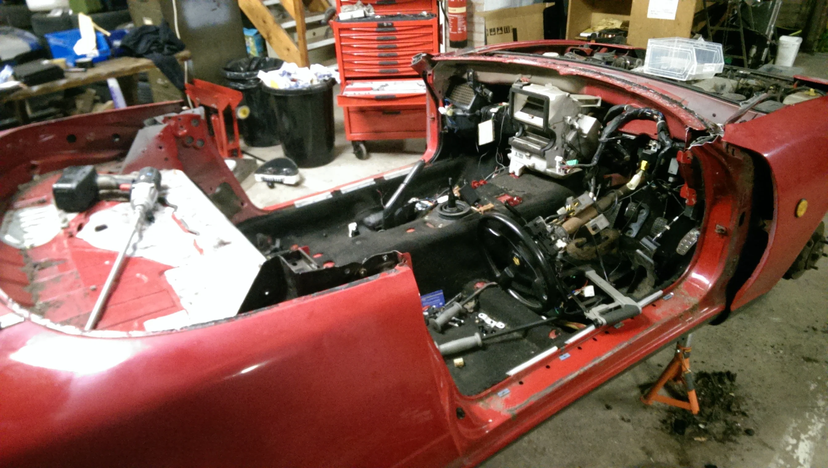

So once that was sorted and all the bits of glass vacuumed up, I tackled the engine bay:
3 more hours spent and two more knuckles skinned. I can also add a massive amount to the budget now, found 20p hidden under the carpet, result!

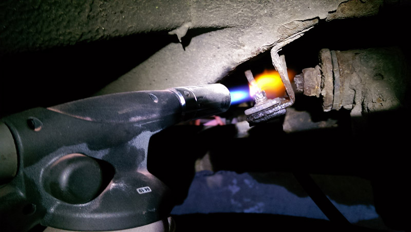

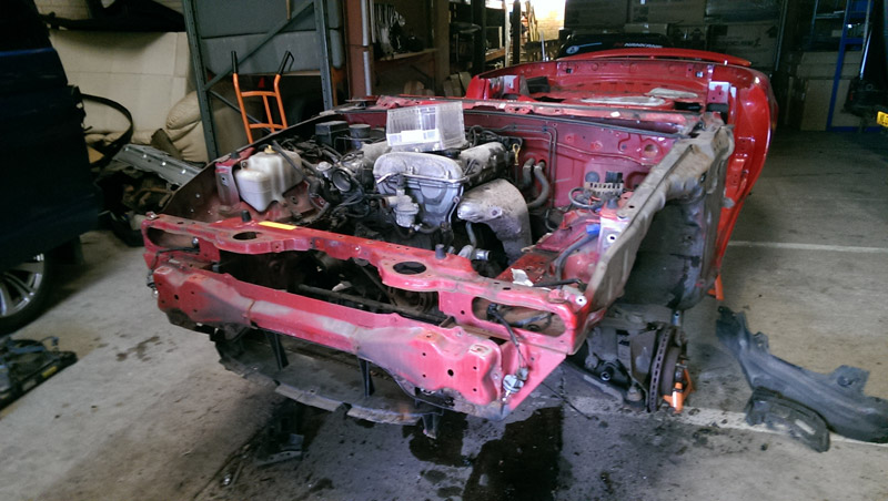

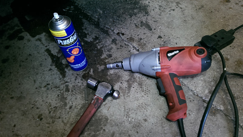

Started tackling the 'outside' of the car, complete with lots of rusty fastenings... My friends for the evening:
I forgot to include Mr Hacksaw and Mr Blowtorch in the picture, but you get the idea.
Front end all stripped down:

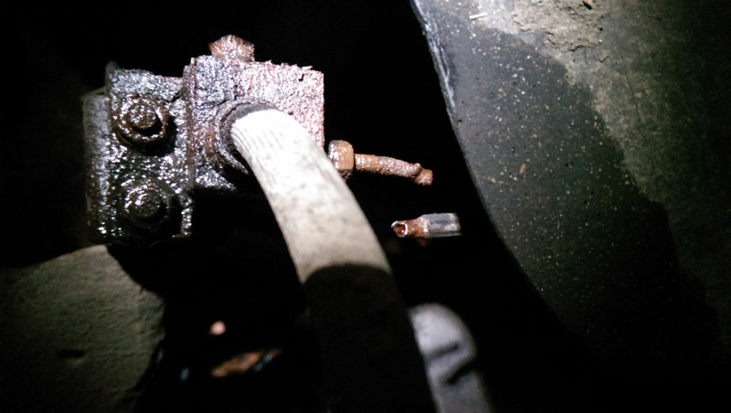

Then decided to swap the front brake calipers for some better ones I have. Pulling the brakes apart was always on the list as I also plan to use braided lines (which arrived today along with a full set of rubber radiator hoses), however there was a fair amount of corrosion...
And the same with the rear:
So much in fact that the fitting was completely stuck to the brake line. Arse. That adds a fair bit of work and some extra onto the budget :(

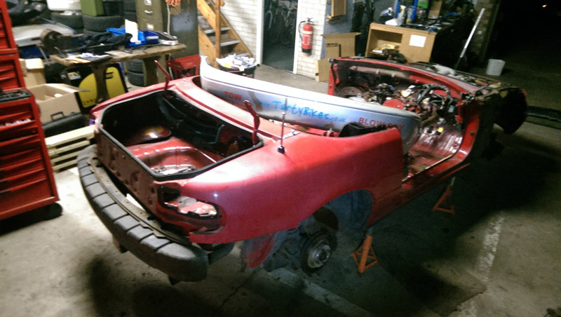

To drown my sorrows I ripped the back end of the car apart as well:

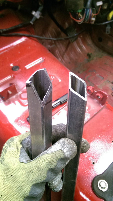

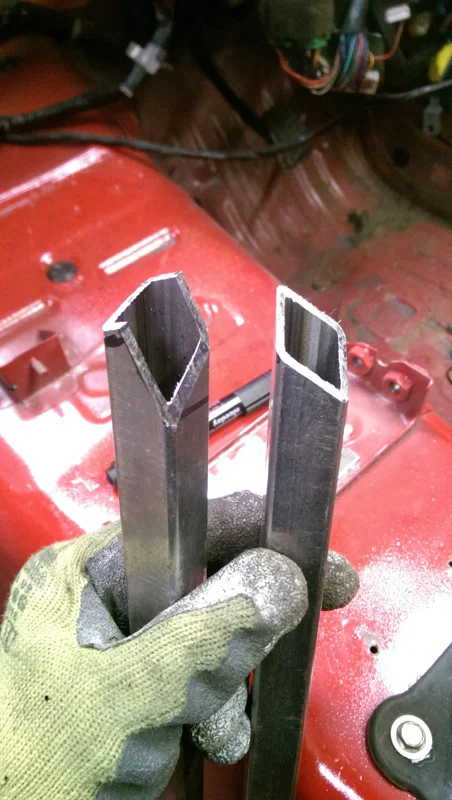

Also picked up the tubing for my cage this morning, including a load of ~100x120mm plates, £35 for the lot - bargain!
Pricing stuff up it looks like I might go about £50-60 over budget... if anyone has any fibreglass seats going cheap so I don't have to buy new that'd be awesome!
Nah, the original panels will be going back on mostly, but you have to remove everything to get rid of the slam panels - also means it'll be easier to work on in future though :)

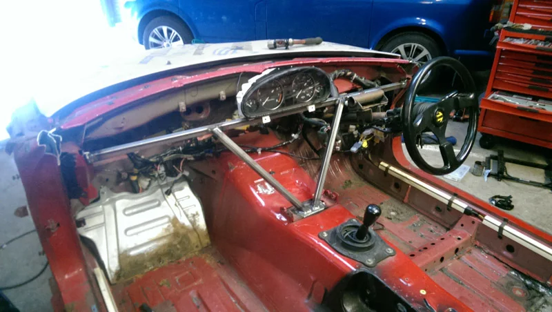

Bit more progress last night, but kinda slow going again, little bitty jobs and some tidying up / car swapping...

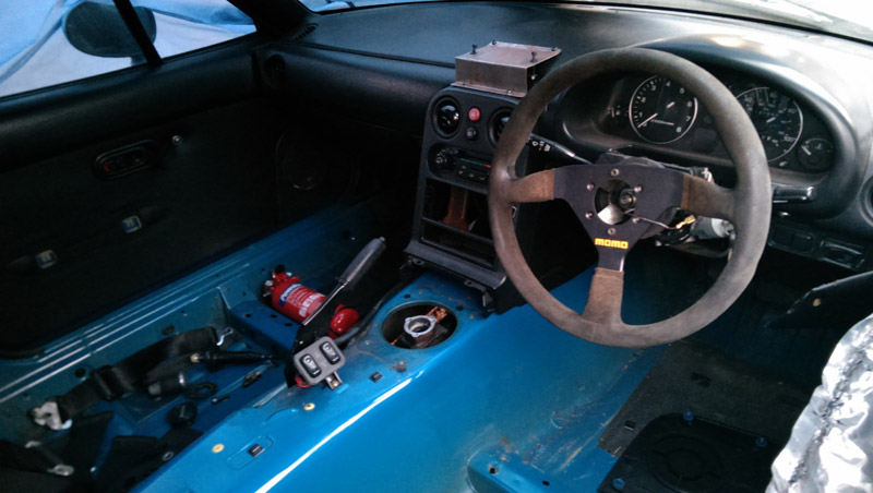

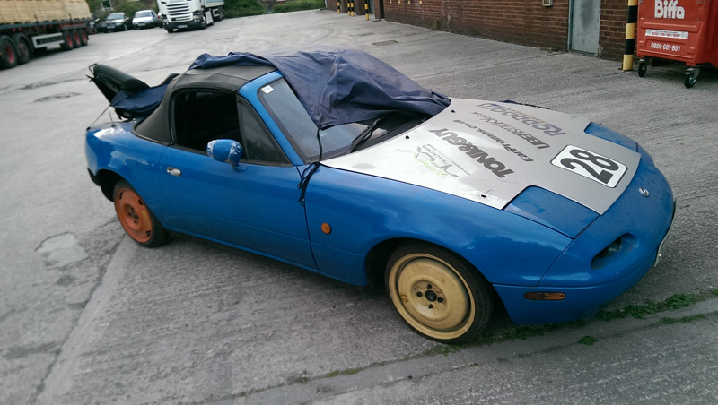

I hereby present my trump card / cheat code for this project - another MX-5. This used to be my track hack and I had so much fun in this thing, it's the main inspiration for this project I guess. Some of the bits from the blue car will be going into the red one, not the wheels though obviously :laughing:
And here's a video from over 2 years ago (time flies...) at Cadwell. Such good fun!

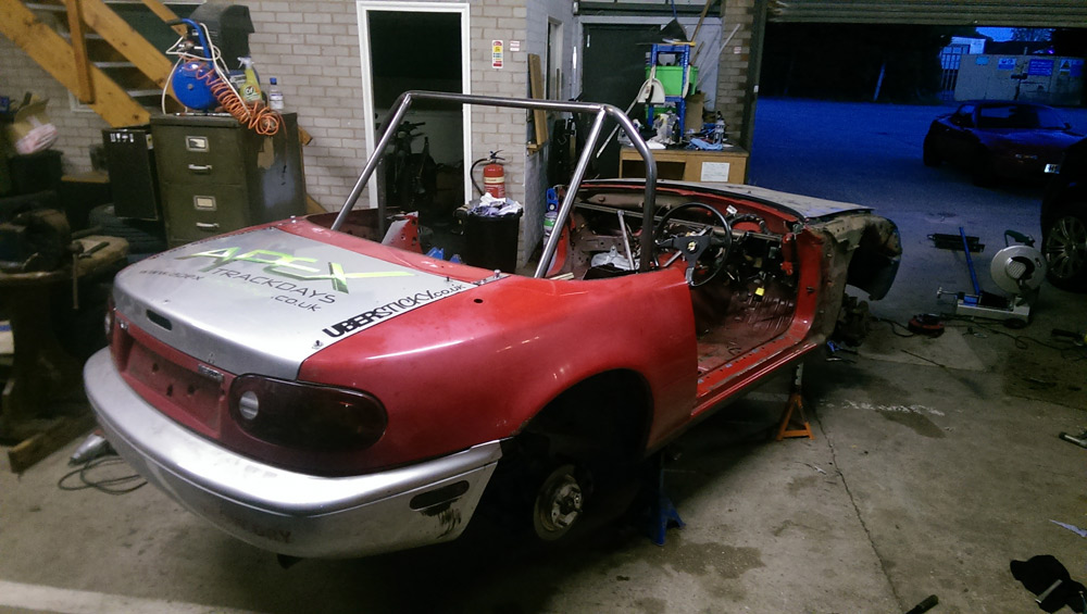

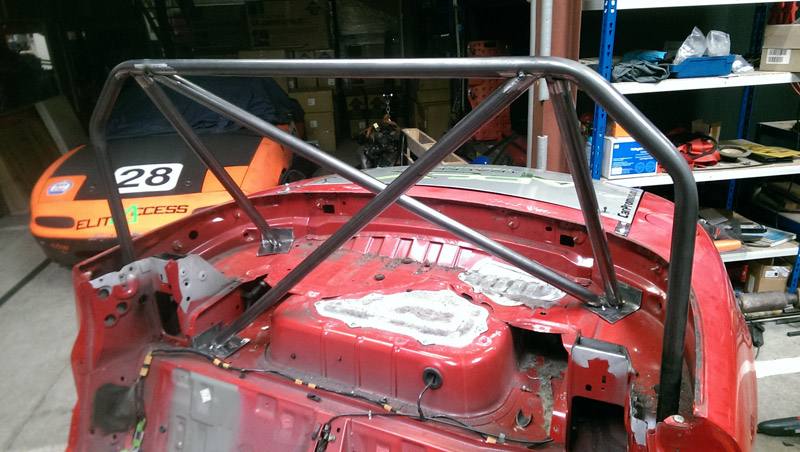

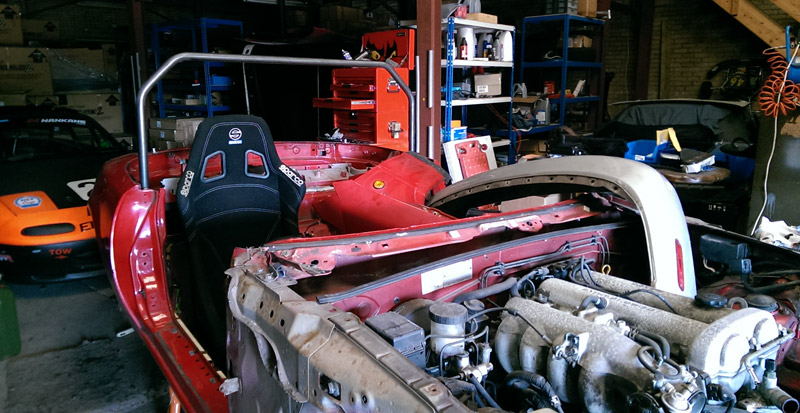

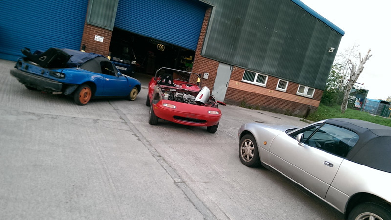

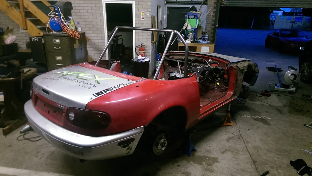

So the Red Munter now looks like this - I got excited to play with the roll cage tubing, pipe bender and chop saw:
And one last shot of three quarters of my MX-5s - gayness to the max.

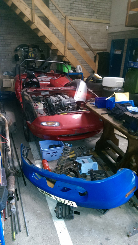

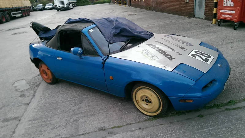

Managed to get a few more hours in before work, after work and yesterday, so there has been some reasonable progress.

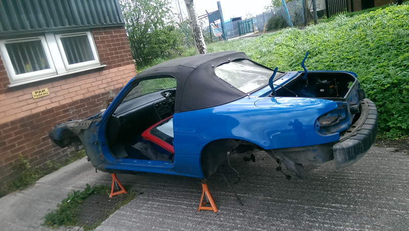

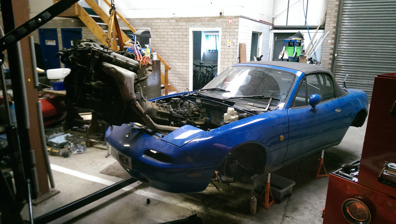

The Blue Beauty needed stripping down to the shell so I could 1) make space and 2) nick some bits off it, so that was attacked...
Hard to believe that lot comes out of such a small hole, haha.
Had a massive issue with one of the rear shocks, the captive nut in the lower wishbone broke free, so in the end I'll just swap the whole wishbone - bit of a pain having to free the upright though.
Anyway...
Neglected and relegated to outside!
It got revenge though:
This, however, left me with a pile of bits for the Red Munter...

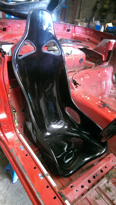

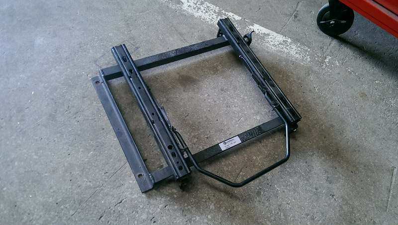

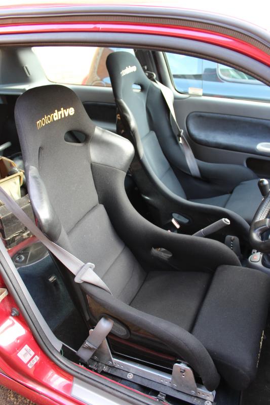

Picked up some seats Thursday night, 3 hour round trip to Stafford but it was worth it - they are much better than I expected, being a 3 piece affair so they are hollow and mega light, about 3.5kg each! Seats were something I thought would eat up the budget but I managed to claw a bit back on these at £140 a pair...

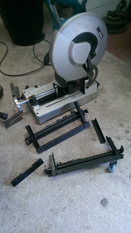

How to fit them though? Well, I wanted the drivers one on a runner to accommodate for lanky freaks, but the standard MX-5 runners were nowhere near. Then I found a left hand Corbeau mount for a Pug 205 (can't remember how I ended up with it, I've never owned a 205!)...
It met Mr Chop Saw and Mr Welder...
And the rest, as they say, is history. You'll have to take my word for it as I forgot to take a pic!

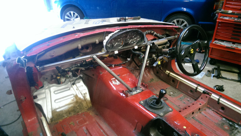

Next up I decided to get rid of the gash bendy dash hoop and put something in that would hopefully offer a bit of lateral stiffness too. I decided the cage tubing would be a bit overkill as all it effectively has to do is hold the steering column up, so went for some box - which made for some interesting chopping angles:
All went in nicely though, and the column mounting piece out of the old dash brace even ended up in the perfect place once it was welded to the new bar!
Did a few more bits and bobs like fitting the rear bumper, chopping out the inner skin from the boot lid and had some food, then started tackling the cage.

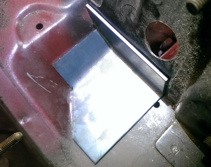

Spreader plates were bent / formed and then the roll hoop was held in place with gaffer tape while I measured up and cut the supports.

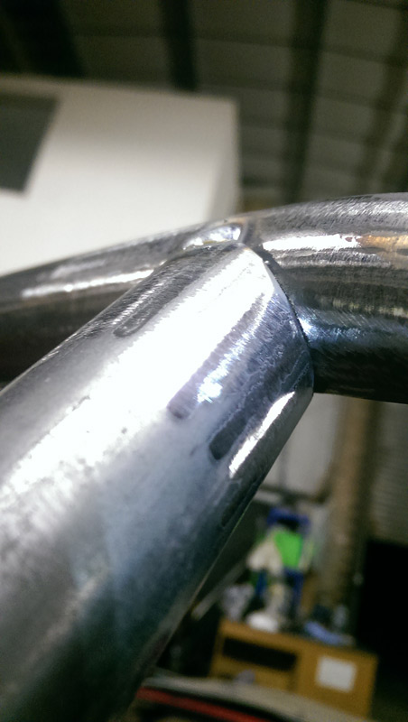

Don't have any posh tools to do this, so had to do the mitres with a grinder, came out pretty well though!
And here it is at the end of day 6, a bit different now to how it was!
Should get a few more hours in today, so plan to get the rear part of the cage finished and welded in, then I can crack on with... I'm not sure yet, there's plenty to do though!

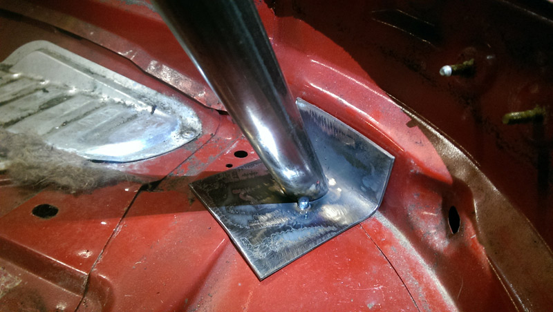

Braced up the cage (and finished welding it together, no pics of that cos we all know what a DIY weld looks like, lol):

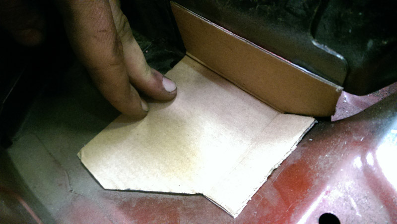

Cardboard templates for the more tricky spreader plates...
And in place. These are now welded in but it looks like Stevie Wonder did it, I'm hoping lashings of black Hammerite will help with that.
Fingers crossed it's stuck well enough!

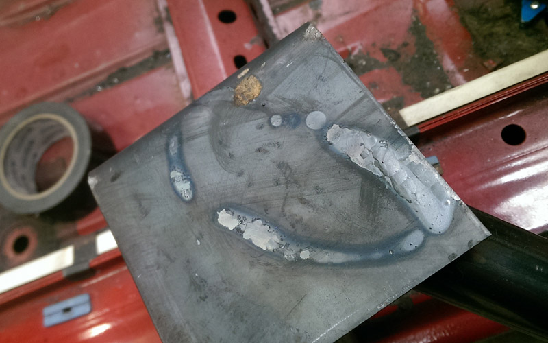

Note: stuff gets hot when you weld it. Putting one of these spreader plates on a piece of carpet immediately after attacking it with 150 amps for 20-30s makes a sticky mess!

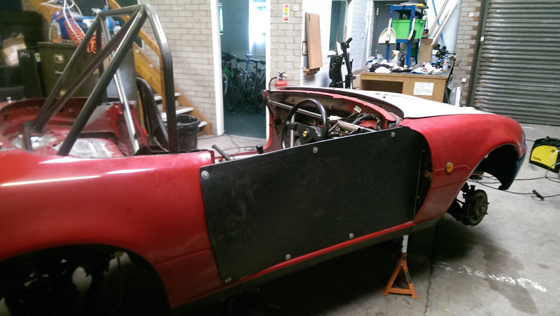

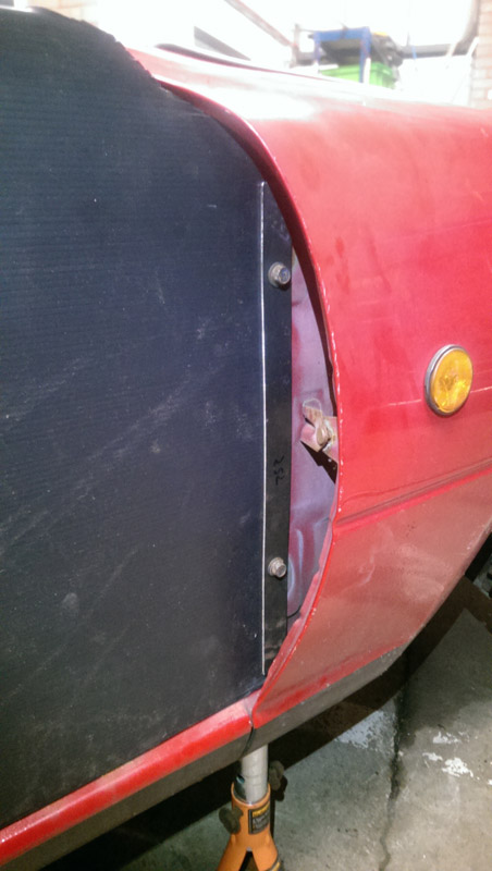

Then I moved onto the 'doors'. These are made from 4mm correx (think estate agent for sale boards) ended up stiffer than I thought. Held in place with a load of penny washers, bolts and rivinuts, doubled over at the top. Will be adding a brace between the front top of each one which will double as the support for the aeroscreen (which will be made of the same material).
And clamped to the chassis with a flat strip at the front where the doors would normally bolt on, so it seals the cockpit rather than channeling water from the front tyres straight onto your lap!
These can be removed in a few seconds if I want - doors will be braced over with additions to the roll cage.

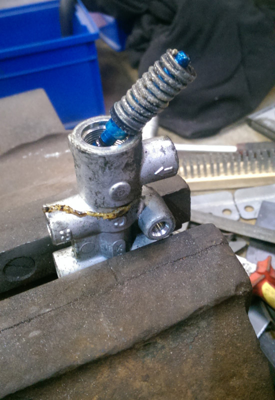

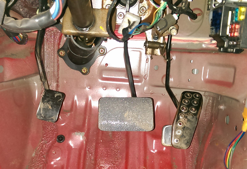

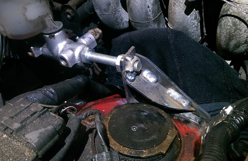

Then I moved onto brakes. The brake system was designed for a 323 (FWD) so the MX-5 is really underbraked at the rear: http://blackartdynamics.com/BrakeBasic/BrakeIndexMX5.php (also shown by how many sets of front pads you go through vs rear ones!). To help with this, you can take the plunger out of the compensator (see below) or do away with it altogether as I will be doing, running stainless lines through the car.
Another couple of mods I do to the pedals to help with left foot braking and heel & toe:
Dull video but got the same setup in my race car (skip to 2:10 for the best example of how it can be used):
And then made up a master cylinder brace in true pikey style - couldn't be arsed faffing with a posh one that bolts to the strut tops, so just welded it on. In the background you can see a pair of old boxers soaked in water covering up the fuel lines, just in case...
