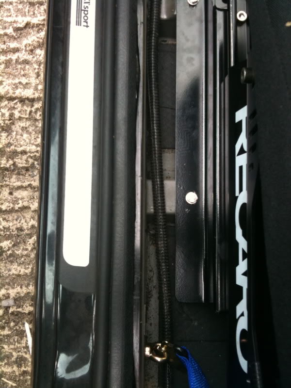

Spent a bit more time stripping out the interior. B pillar seatbelt mounts have been removed along with the door sill plastics. Managed to tidy up the wires that run down either door sill so that people don't get their feet caught on them. Just need to sort out the power cable, thinking about putting a small race battery under the passenger seat.
Also chopped off some unneeded brackets and clips and traced the rear washer jet line back to the washer bottle and chopped it off. Put a screw in the end just in case i press the button by accident!

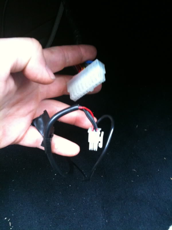

One other thing tho, i found these connectors hanging under the passenger footwell!!! Any ideas?
Lower one is possibly for the alarm that is no longer installed?
Greeny.
  440i + 182
Looks like a 24pin motherboard connection lol, used to be a PC in there in the past maybe?
Edit: warren owned me :)
  330i. E30 Touring.
Both, by the looks of things.
One will be power and earth, the other, signal?
Just a guess.
  BMW M135i
They're both from the alarm, if its not there anymore then no worries. Big one is signals from door switches and to the hazards etc, little one is for the siren iirc.

The seats look mint!!! I really like them.
Where did you get the M10 eyebolts from as i need some too for the same place on my car. On ebay they are either £9 each or like 90p.
  SchwepTek™
Southwestmotorsport dude.
Give them a call, Its a really helpful guy. Paid about £4 each.
  Qashcow
phreebone, are they the M10 ones or the ones that go in the back seats holes? the rear seatbelt ones are a different thread i believe
  SchwepTek™
Rear seatbelt threads are 7/16" imperial which is standard harness eye bolt thread.
Front seatbelt thread is M10 metric.

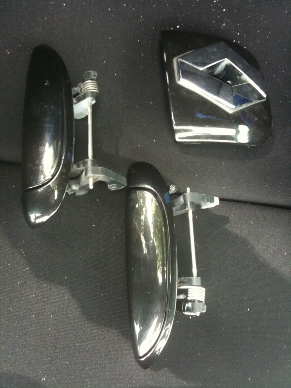

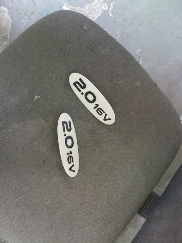

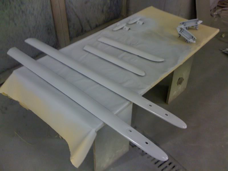

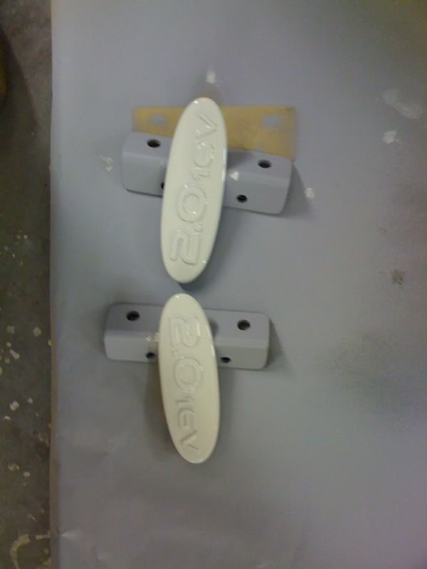

Side strips, badges and door handles are in the process of being colour-coded ready for Trax. Also bought a ph2 bootlid as i prefer the button! lol.
Also bought a black twatstrip, tow sticker and a "Si" Cup Racer Tow Eye, which are all waiting to go on.

Harness eye bolts are 7/16 UNF for future reference if needed to buy any nuts etc.
the normal ones are yep, but the bolt that the mk2 seatbelt comes out of on the sill is a M10, which is what you need to bring the harness back far enough really

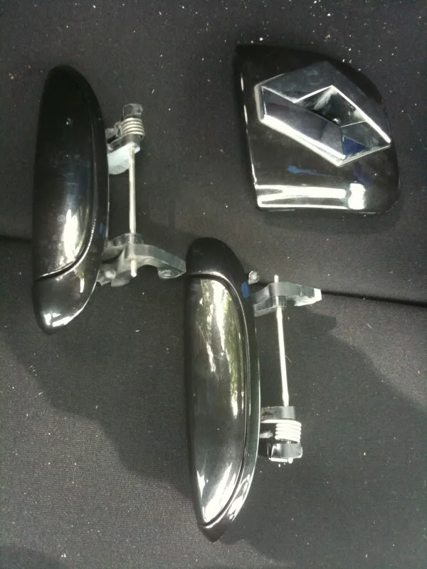

Update time again :)
Picked up my newly sprayed bits today, still got handles and ph2 tailgate to fit...
Also refitted the centre console as it doesn;t weigh much and i could do with the buttons being easily accessible.

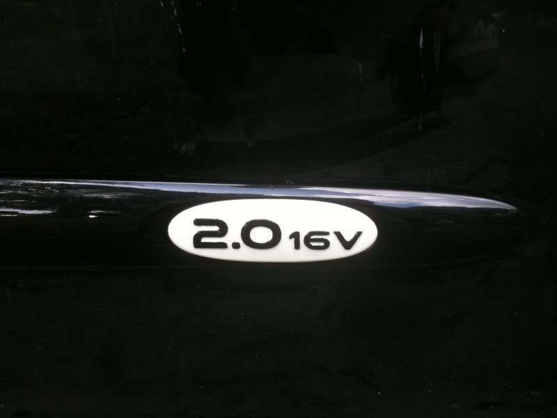

New badges and colourcoded strips -

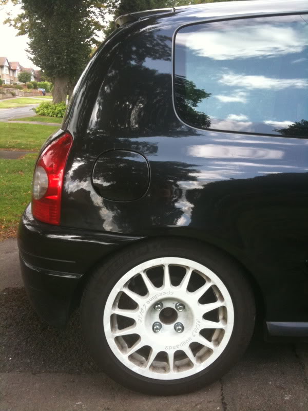

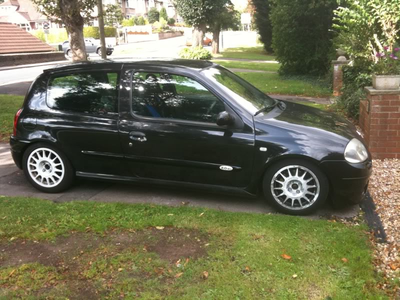

And finally some pictures of the car, even if they are rubbish iFail ones.
Also removed the rear spring platforms to get it lower on the back.
