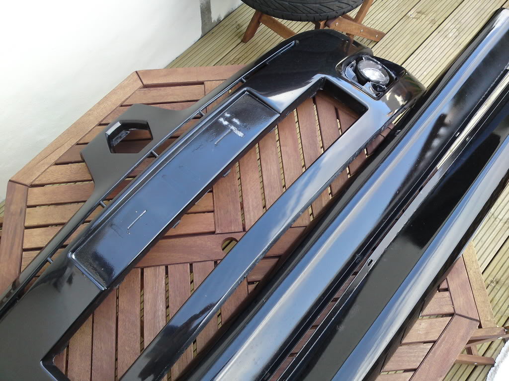

Okay, here's the pic of my bumper/skirts, gonna be picking the wheels up tomoz, along with the wings. Hopefully should have the lot onto the car by Sunday, ready to get the coileys fitted on Monday!
Wanna try and get the exterior sorted first, not to fussed about the interior atm, mine is exactly the same except it isn't leather, it has the funny folding headrests and the big bolsters on the side of the seats too, so not hugely bothered about that now, but will defo be looking into it in the future!
I have the fog surrounds, and the renault badge and the headlamp washer things. Still looking for the grilles (upper and lower) tho tbh, if I can't find anyone with some for sale to night, i'm just gonna get some from Renault tomorrow, cba looking anymore!!

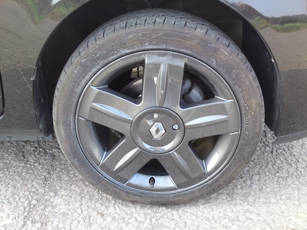

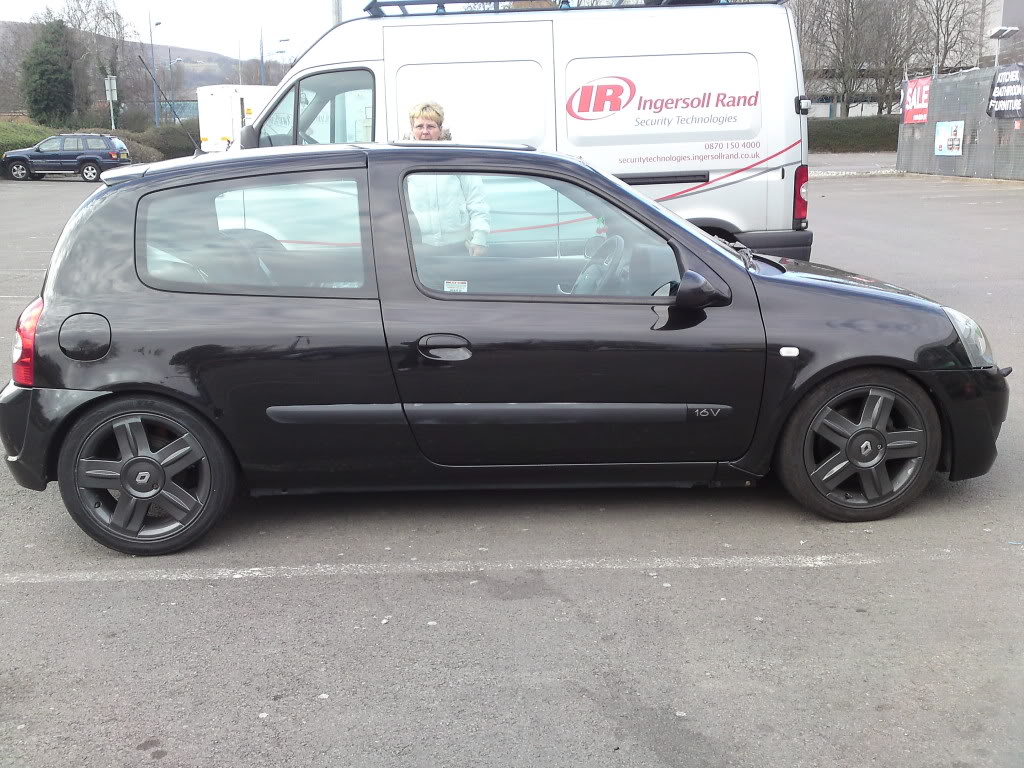

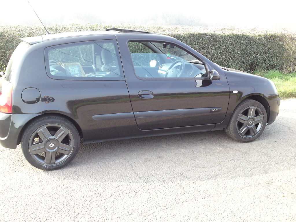

Ok, picked up my wheels today and put them on, very very happy with the quality of them, and how they look on the car!
Here's a couple of pics:
Hoping to have the front bumper, wings and skirts on by the weekend!!
P.S The white marks on the wheels are from where they fitted the tyres (that water stuff they use) not actual marks!
hi lad, glad to see the alloy wheel going to good use.
maybe it is the light, but just check that paint work and if needs be take some better photos and put them up on here . . . from what i can see it looks to be a very poor finish (very dull) and will annoy you when the parts are on the car as it will look out of place.
like i said, could well be just the light, but worth checking :)
jamie
You're talking about the bumper and skirts yer?
I know what you mean, the car is going back to the place that painted them once all the bits are on, to have it all flattened off and polished up, they don't look too bad tbh, I don't think the picture does it any justice as it was in the shade, with nothing really to make it stand out as shiny!! (if that makes sense!!)
The bloke who painted them is a mate of mine, if i'm not happy once their on, i'll get him to sort em out anyways, so not too worried atm. See what they look like once their on.

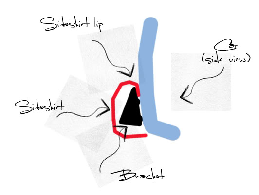

yeah mate you will definately need them, they rivett to the car then then lip of the skirt hangs over them, renault will sell them at a stupid price, i managed to get mine of here. i just had to get some from my replica skirts as previously i had just glued them but one had started to come away. they fit much better with the clips
they work like this
yep its not that difficult, you just need to make sure they are in the right place as if they are too high it will push the skirt up and then you wont be able to open the door without ripping it off

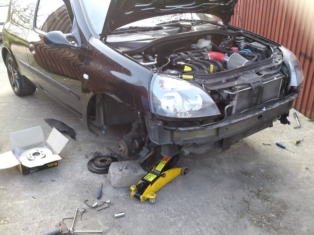

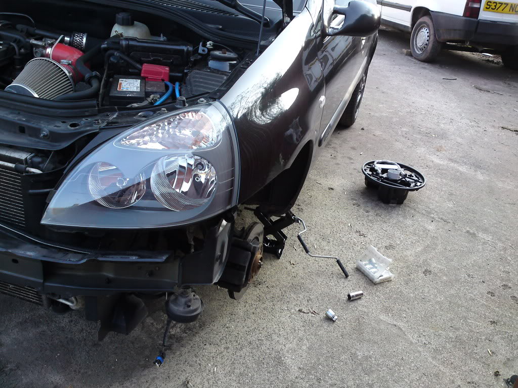

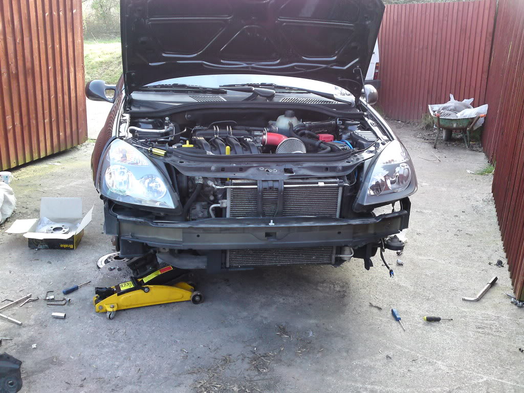

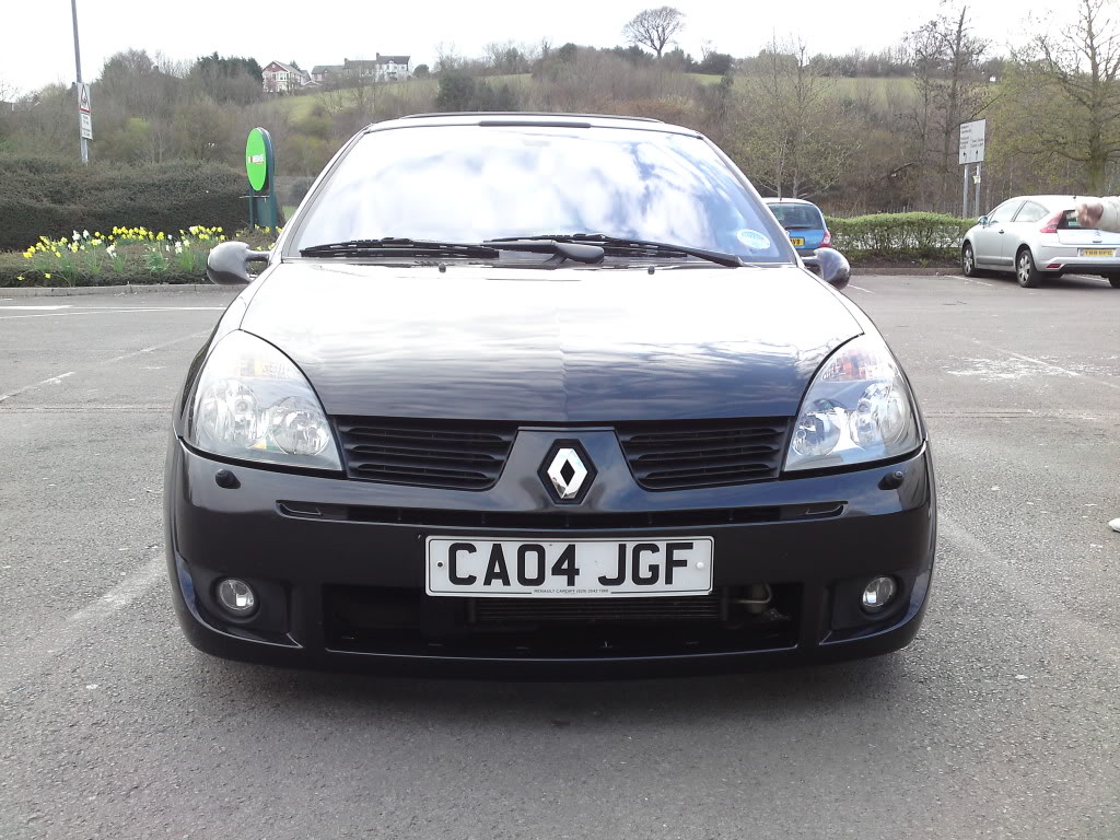

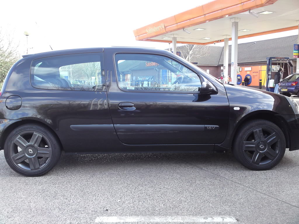

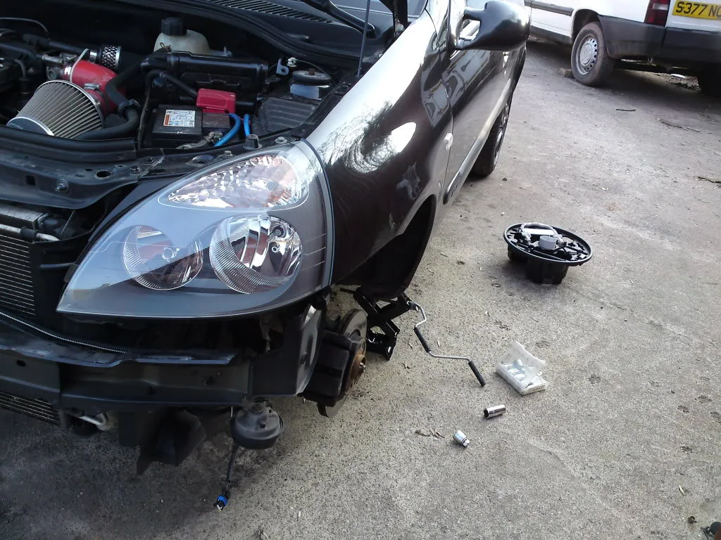

Bit of an update, fitted the wings and front bumper over the weekend. Wasn't as difficult as I thought, just a matter of finding all the bloody bolts!!
Pics:
And then with it all fitted:

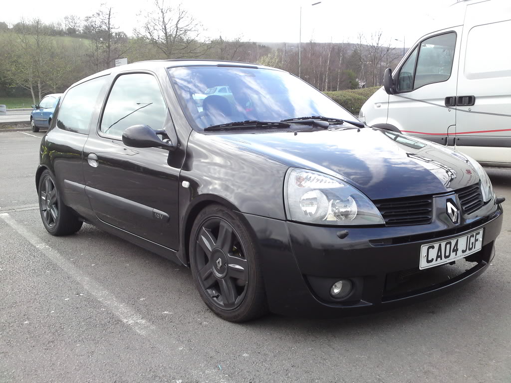

Then I had my coileys fitted today:
Before:
After:
Not sure how much it's been lowered by, the garage did it all for me. I know the backs are wound right down, but not sure about how much the fronts are?!

Let me know what you think.
Yer, there's bloody tonnes of bolts on em isn't there!! everytime I thought I had the last one, there was more!! lol.
Lol, that was how it was on the instructions, does it make a difference?
it'll b gettin all the radiator heat.
get urself a cold air feed from the bottom left of the engine up to it
stand as if ur lookin at the engine from the front right down at the left side near where the fog lamp shood be or is ull find a plastic flap the cuts out with the use of the old Stanley blade, run it up to ur induction kit and cable tie it to the old mount for the original engine cover/air filter
i used to have that very induction kit on my old 1.2, gave it a nice wee bit of torque, nothing dramatic but compared to the standard setup it was noticeable.

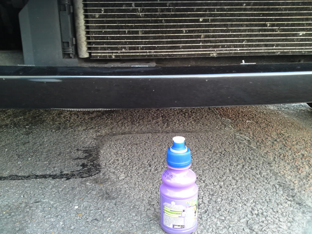

what's with the gap between the front bumper and the headlights? (just underneath the headlights)
they work like this
I was going to post this picture to show you my car when I was fitting the skirts the other week... I see I was beat to it! lol... Anyway, I was dreading fitting the skirts but actually it was the easiest part of the RS Rep conversion.. You really do need the proper brackets as its quite incredible that they hold the skirts so well.. I didnt use any glue so they have a self tapping screw at the front then are bolted underneath which I had to drill 5 holes for to match the holes at the bottom of the side skirt. I luckly got a full set of 16 brackets with the skirts I bought, but I know Renault sell them individually as some silly price. Some people have got away with only putting 4 down each side... but as I had them I put 8. Just take your time measuring and like I did you can use a marker to mark the back of the skirt where each bracket sits then transfer those marks onto the car by measuring the distance between each before then drilling and riveting etc.. Dont know if it was necessary but when I drilled the hole I also put some black silicone in it which I hope will make a seal between the hole and rivet and stop any water getting in..
Get intouch if you have a question that I havent covered!
Good Luck!

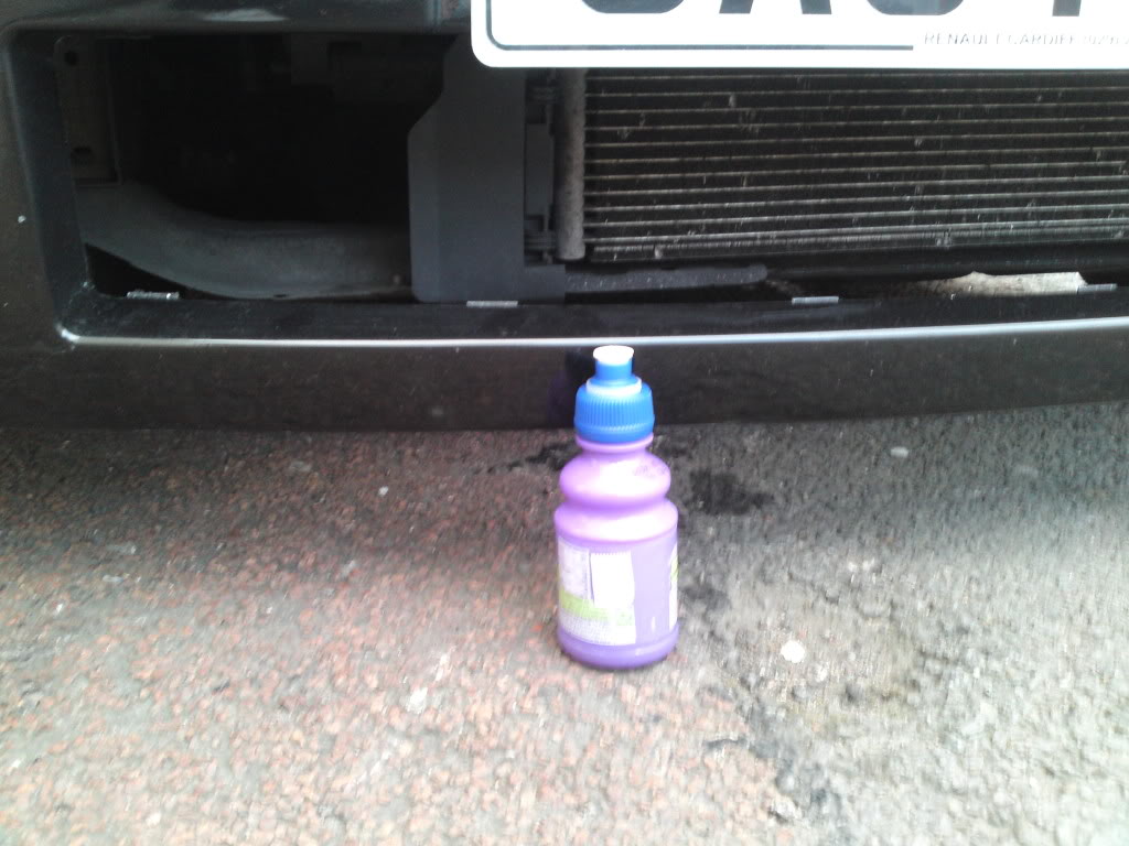

I've just noticed that, I think it might be because I haven't yet put the plastic cover back on that sits on the bumper and bolts in somewhere underneath the car, think it might be making it sag a bit. It's all secure i've checked it, and all the bolts are in that I took out, it must just be because of that plastic cover that's not back on yet.
Didn't put it back on because I'm waiting for the lower grill to come and I'd have to take it off to put that on anyway, I thought it would be here today!
Does your bumper have the re-inforce bits behind it?
The bits of polystyrene ???
Yes, They are your crash pads, they clip into the back bits and if you go into the back of someone, it wont just smash your front bumper to pieces.
They are designed to withstand the impact to a certain extent!
That maybe why your front bumper is sagging.
looks good buddy, i think and dont quote me on this as it was a while since i did mine but you should have a plastic tray that connects to the bumper and is held on to the bottom of the car by two bolts, i think its to stop stones flicking up and hitting the radiator. also im not sure you will be able to fit the lower sport grill with the bumper on the car
