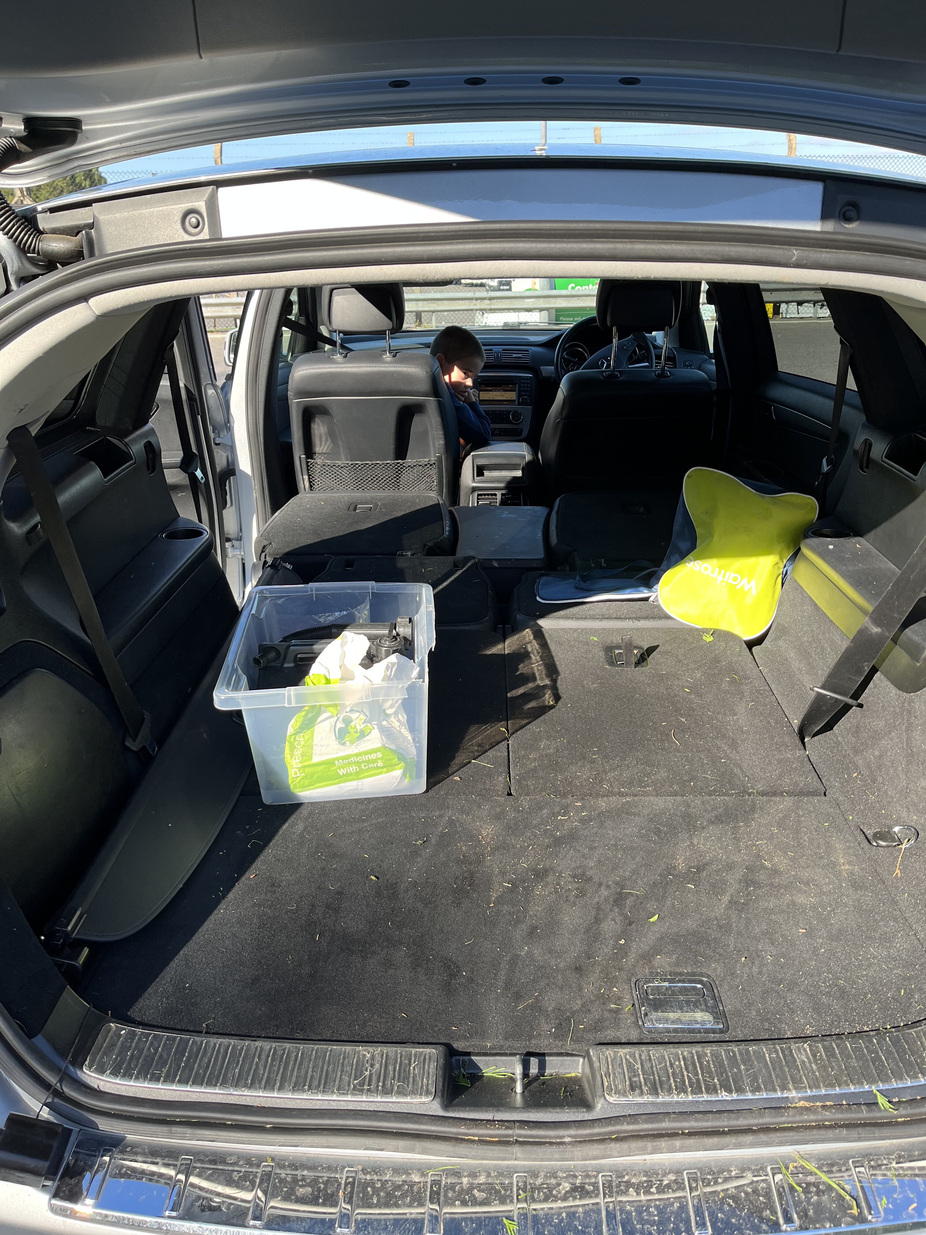

Just done 500 miles to a tank at a cost of £140 😂
7 seats are really useful, well for the wife as I’m not driving someone else’s little s***s around.
