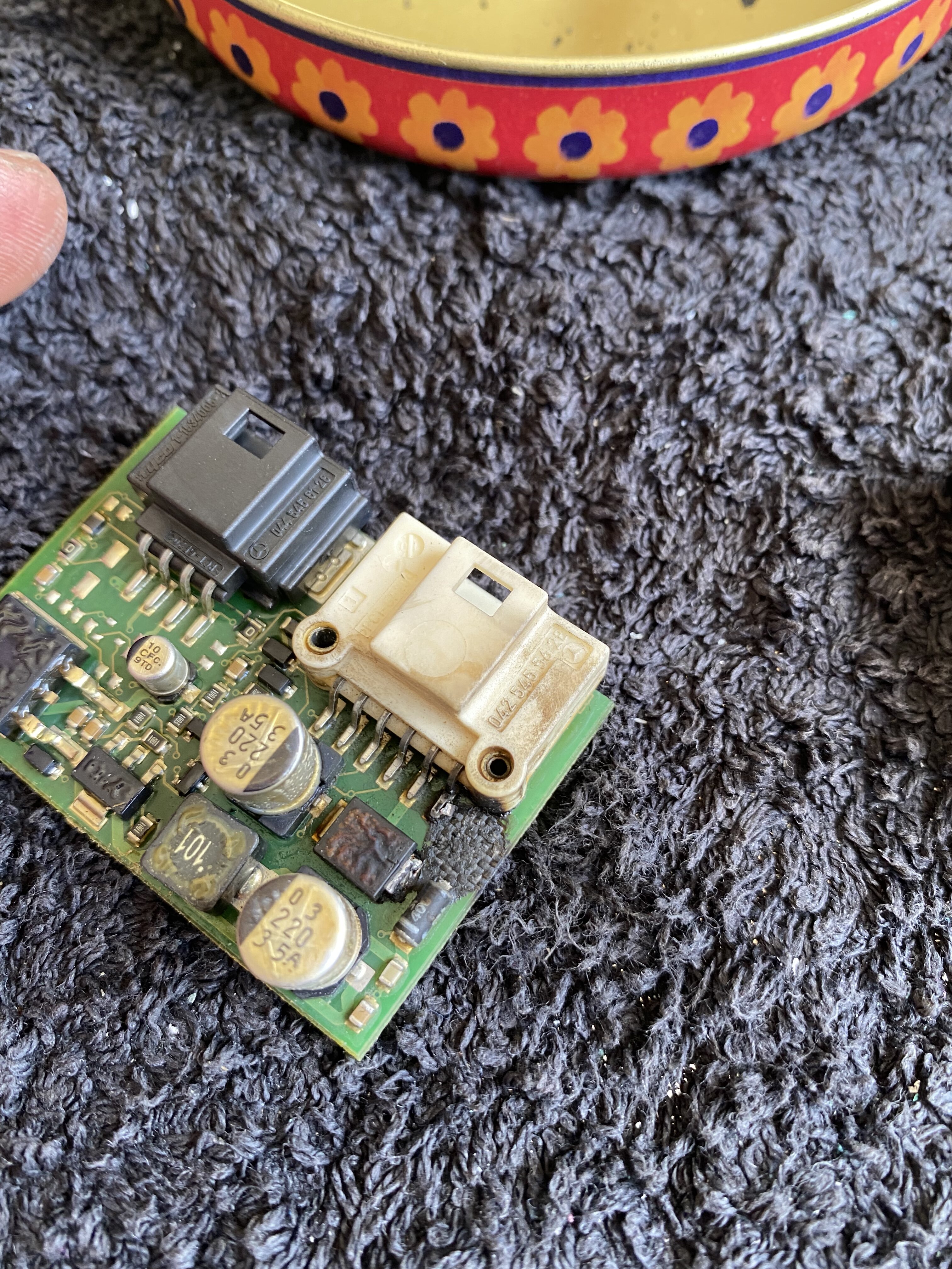

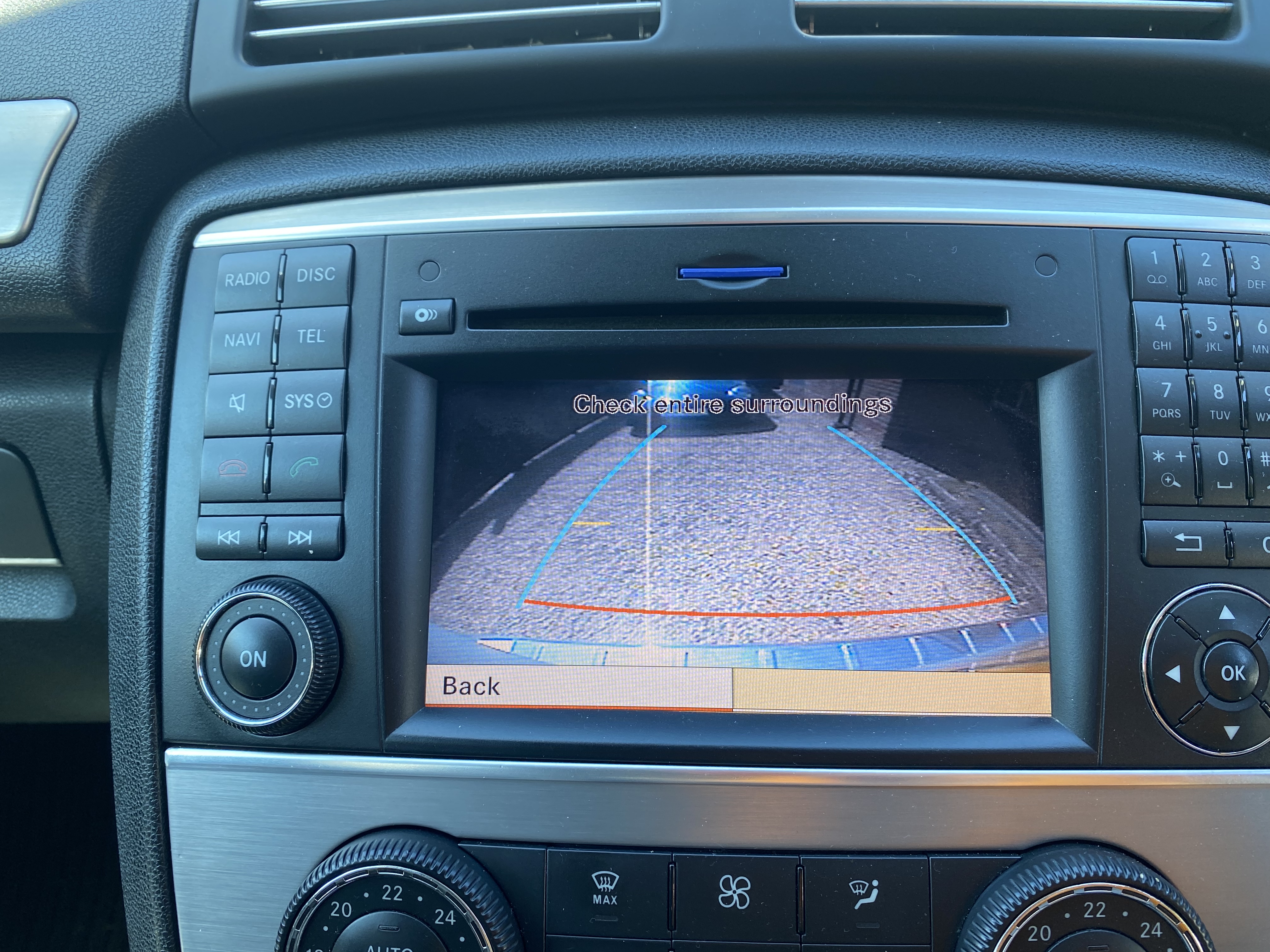

Spent the morning chasing a fault with my reverse camera as to why it wasn’t working.
I was told originally this was due to one of the communication modules under the passenger front seat throwing a communication fault which meant it wouldn’t communicate with the camera.
Removed the module and cleaned a small amount of corrosion off ports as board is clean. Put back together, cleared fault code and it’s working perfectly.
I than spent the next few hrs removing the front and rear Sam units as I was advised that the front needed to replaced. Both clean as a whistle with zero corrosion anywhere so that’s not the cause and again, they both work perfectly with zero faults.
At this stage I was a bit stumped however I decided to keep going so I removed the boot inner trim so I could access loom for camera, checked voltage and there’s no power. So I traced the camera loom checking for breaks in cable when I eventually arrived to the camera module.
Think I found the problem…..
So pretty sure this will be the cure, now just need to sort out why my DRLs won’t switch on. Saved myself £550 on a front Sam and another £150 on the control module this morning.

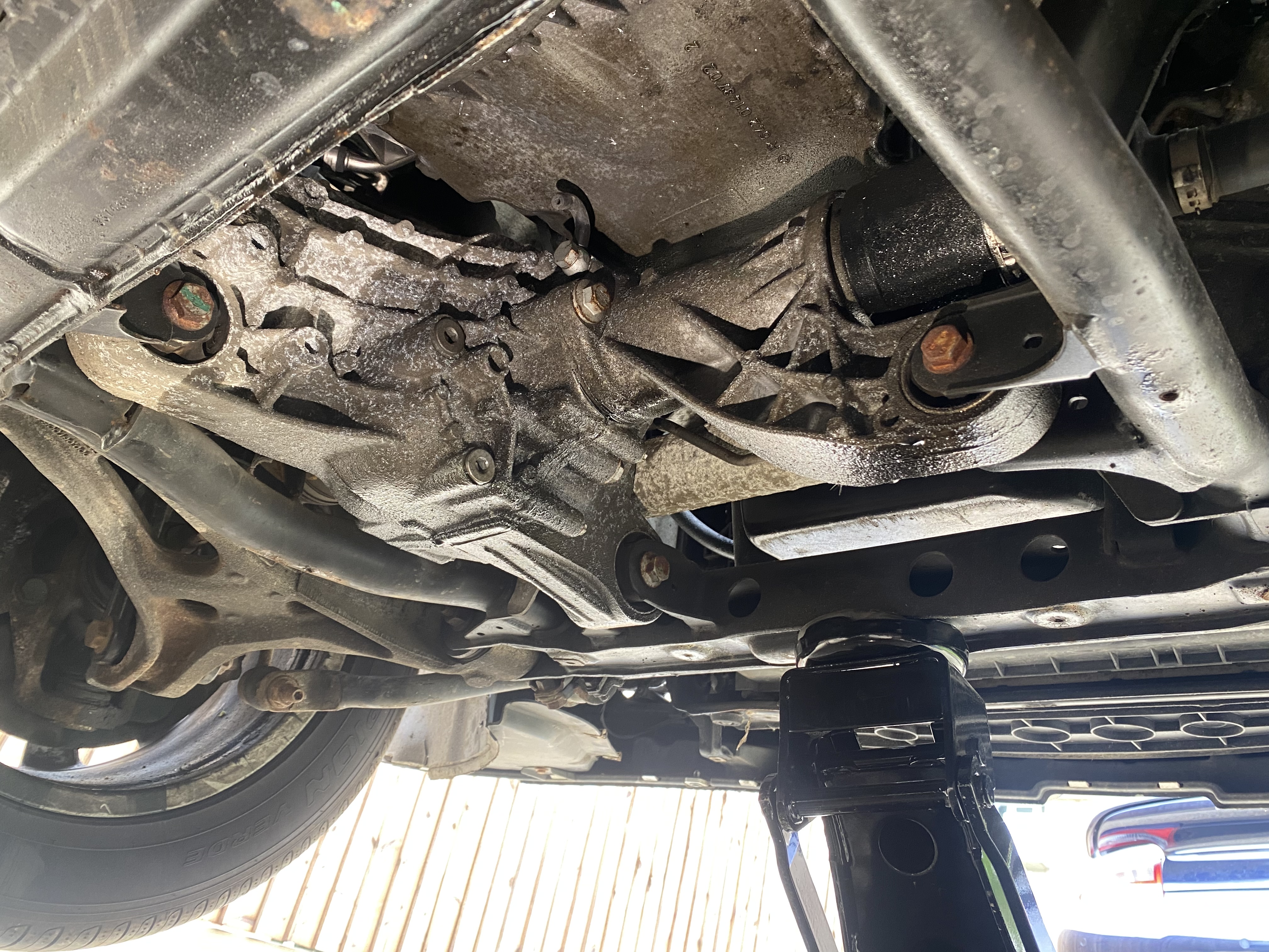

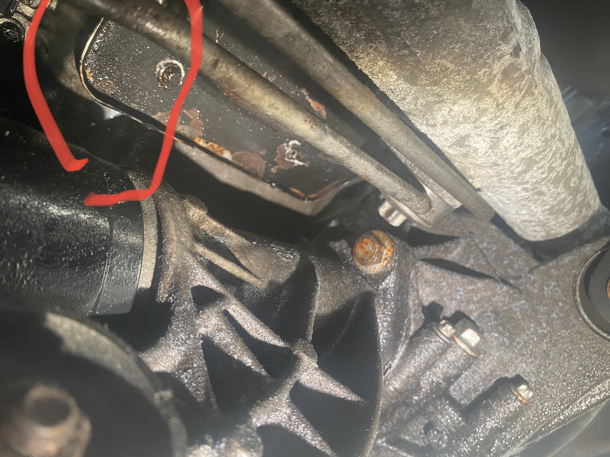

The sump gasket / sealant (seen 3 of these leaks now) all NSR corner, so I would suspect that as you have had the cooler seals done.
IIRC you have to remove the gearbox box to drop the engine sump on the 642 engine.
EDIT - I assume this is the interface between the upper sump and engine, not the lower sump to upper?
drivers side rear corner it’s running down from above.
So it’s coming down from higher up and dropping down onto this corner.

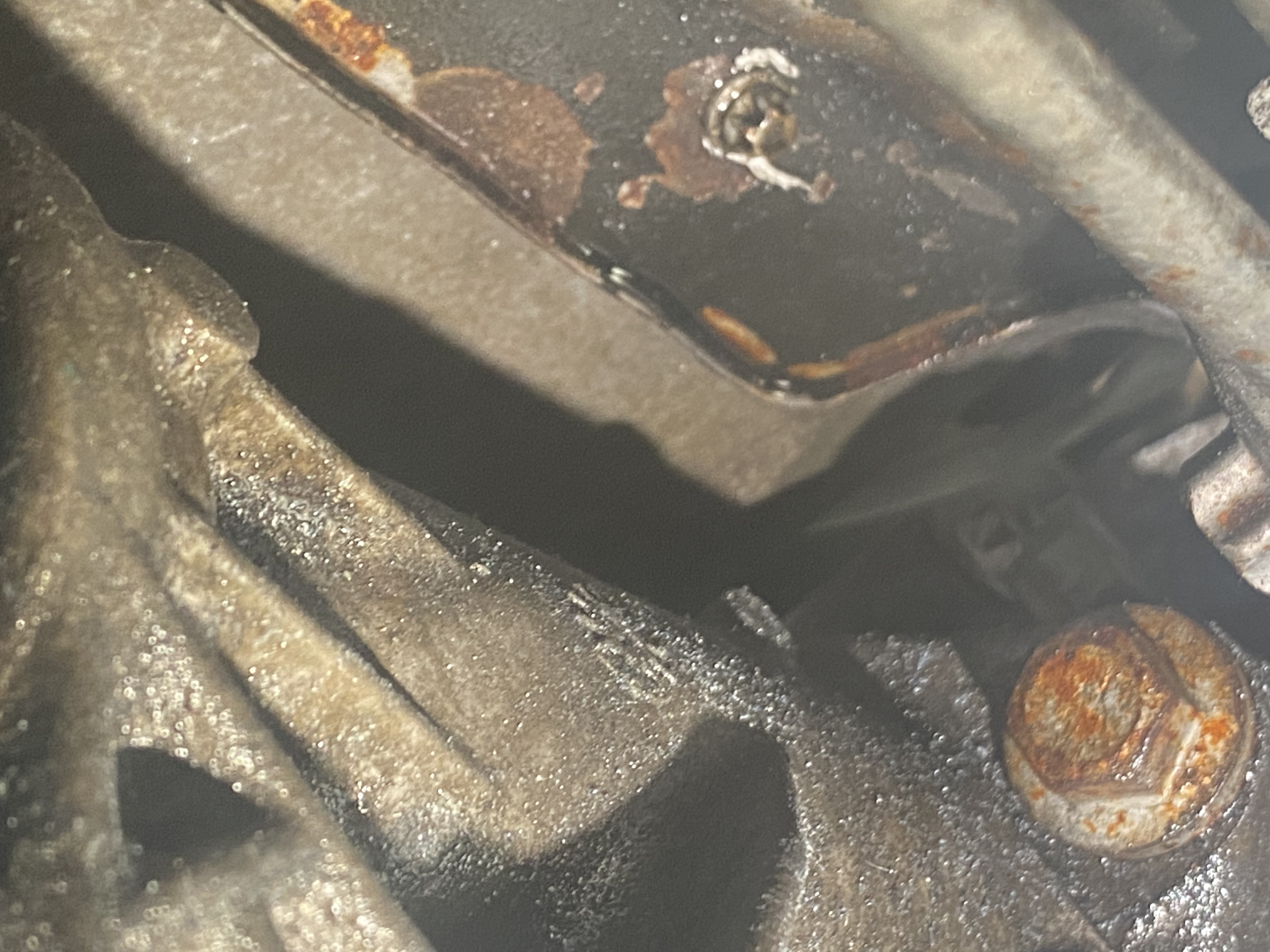

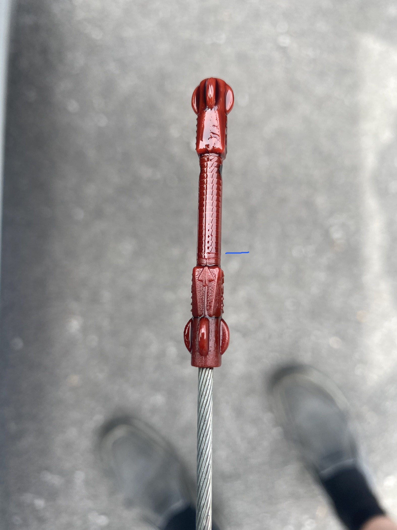

You got a borescope camera? Can you check to make sure the cooler isn't leaking and this is the run off.
Im just gonna hand the car back as it’s easier then me trying to guess. There aren’t many places for it to leak like that and the cooler and seals are new.
Lost 2 notches of oil over 700 miles so I’m just going to keep and eye on it whilst we wait to it to go in.

Well the three we had in with the sump gaskets weeping / leaking. They lost FA really, 1 we noticed on a service and the undertray caught it all. The other 2 were new customers and they were getting a second opinion from their local but none of them had spots on the drive etc.
I wonder if the new cooler seals are leaking as thats a fair bit of oil to have lost IMO.
Yep it can only be the cooler/seals or the crankshaft seal?
If it’s headgasket or or rocker covers that’s another ball game but I’m sure it’s not.
Turbo oil hose leaking maybe?
Head gaskets and rocker coversare not something I've seen before to be leaking, but always a possibility I suppose.
Doubt it'll be the turbo feed or return hose.
I would be with you but that’s what the issue was the first time it went back, drivers side headgasket was seeping oil….
Yeah but that was because they decided to change it. Never seen one with a head gasket failure as not an known issue that I've seen or heard of.
I worked in parts before here and I never sold any either. I reckon it leaked as they either fit a duff cheap gasket or didn't do it right.
I thought it was weird when you said they changed it before shipping as I've never had that either and I must of bought or been the recipient of 10-12 secondhand engines.
Feel gutted for you as you shouldn't be having this many issues..
Is what it is. I found it strange also especially as it wasn’t pointed out to me before engine was fitted.
Apparently they do it to all their engines now, I reckon it’s been refurbed but I can’t prove it.
Frustrating as the old engine was bone dry. All I know is I want photographic evidence during the strip down so I know who’s at fault, if I see someone is to blame and they try and charge me for it or it was the engine suppliers fault I’ll be taking them to a small claims court. It’s that simple now as I fell in being given the run around.
I could take it to someone completely independent but people will argue that I’m not giving one of these garages to correct first.
