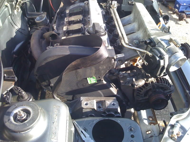

Had a bit of spare time today, the job I had booked in didnt turn up:mad:
So said to Dave what you going to do, well with that he had my clio on the ramp whipped the engine and box out of it in record time:eek:
So finnished the jobs I had to finnish off and sat at work now is my clio with a TT engine in the engine bay.
Still needs loads of work, spent tonight cutting the subframe so engine would sit in enought for me to shut the bonnet.
ECU has been sent off for upgrading to emeralds latest firmware.
Taking the camera in tommorow to get some pics, and as promised Ile do a TT conversion guide.
All being well I hope to have the car up and running by january, plenty of time IMO.

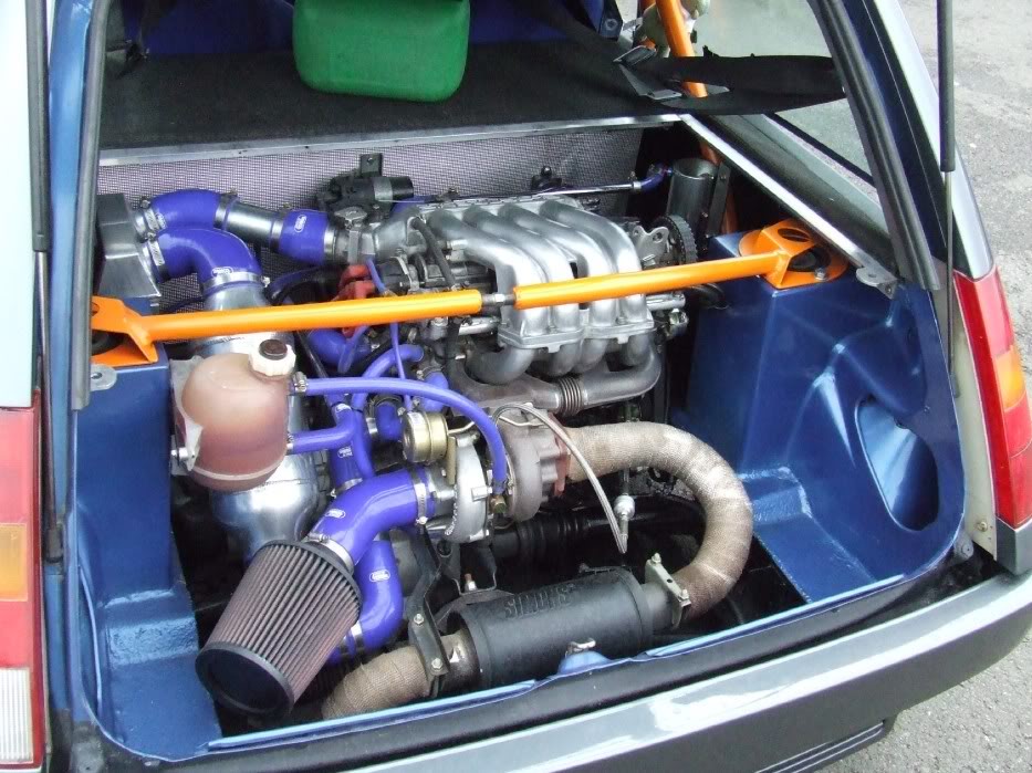

Having fallen in love with a Volvo Turbo powered R5 (rear engined) @ Donnington, I'm all for quality conversions
Just leave it 'stock' outside please!
you mean my old RWD 5;)
