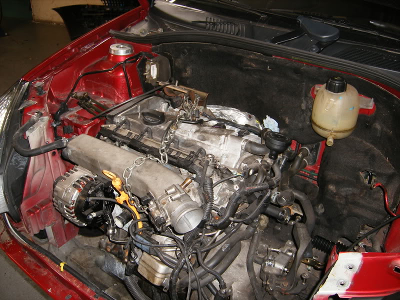

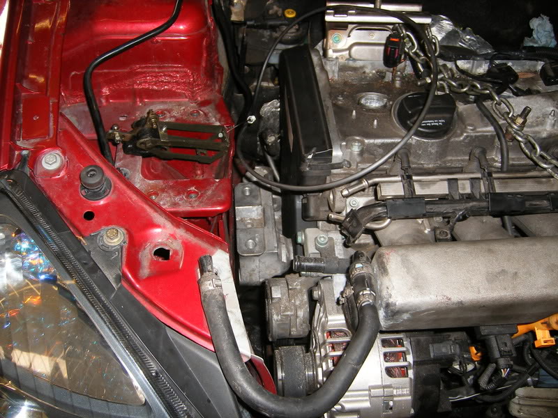

Pictures of work so far.....

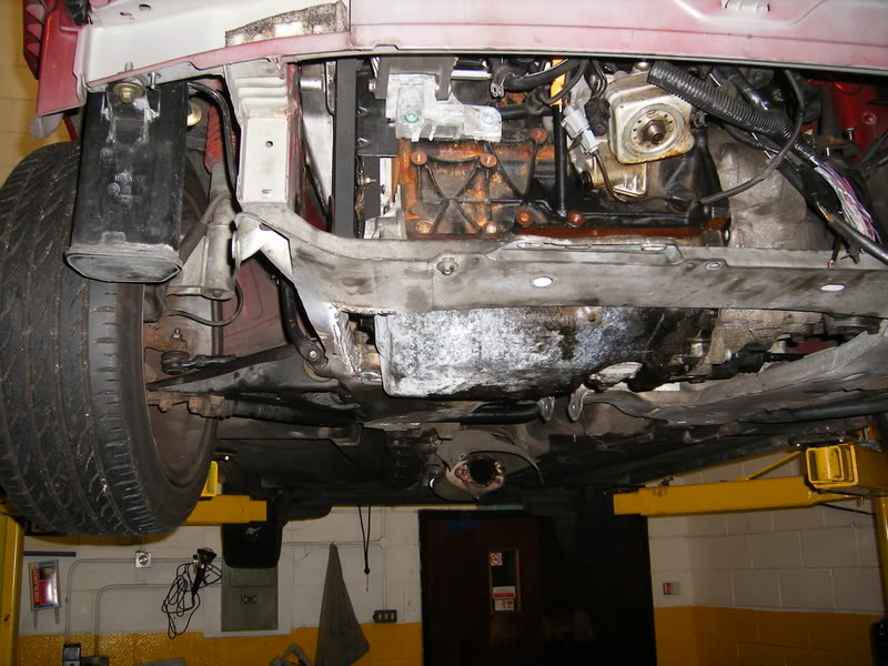

In the process of making mounts up.
Slight modifications to subframe....

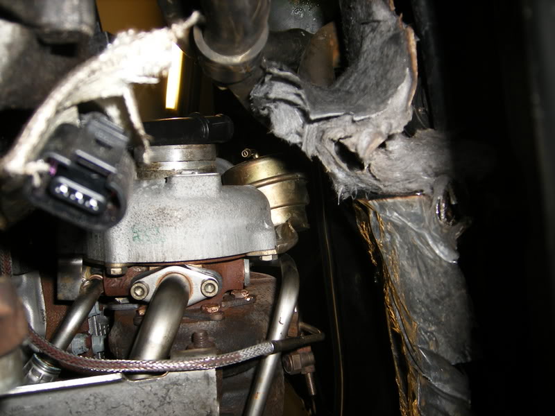

KO4 Turbo in clio engine bay:)

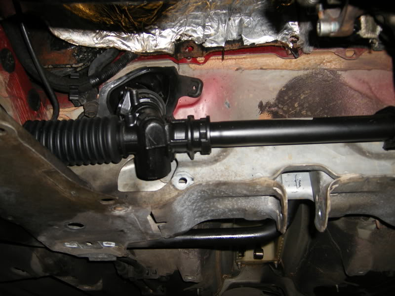

Standard clio rack with no power steering.
How coem your binnign the PAS rack or least not using an electric one?
