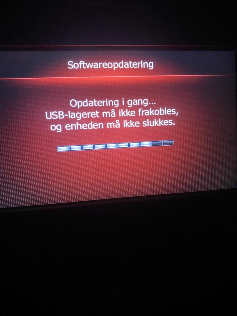

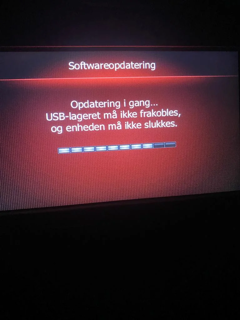

Help please ,I have a Renault clio from 2013 ,the navigation in my Media Nav was not updated for many years and only yesterday I decided to update it , I followed the procedures of one of many videos in YouTube which was easy and straight foreword. I had an empty USB with 15 GB (I didn't format it cause non of the videos I watched said to format it ) I insert the USB stick in the Media Nav to create a finger print of my navigation system and then to my pc toolbox program to get the latest updates then back to the Media Nav to load it with the updates,every thing went smoothly with no issues but after few minutes of loading updates and when it reached the end it stopped ,until writing this thread it passed one hole day without any changes.
Anybody has been to a similar situation or anybody has any idea what to do ? Thank you in advance

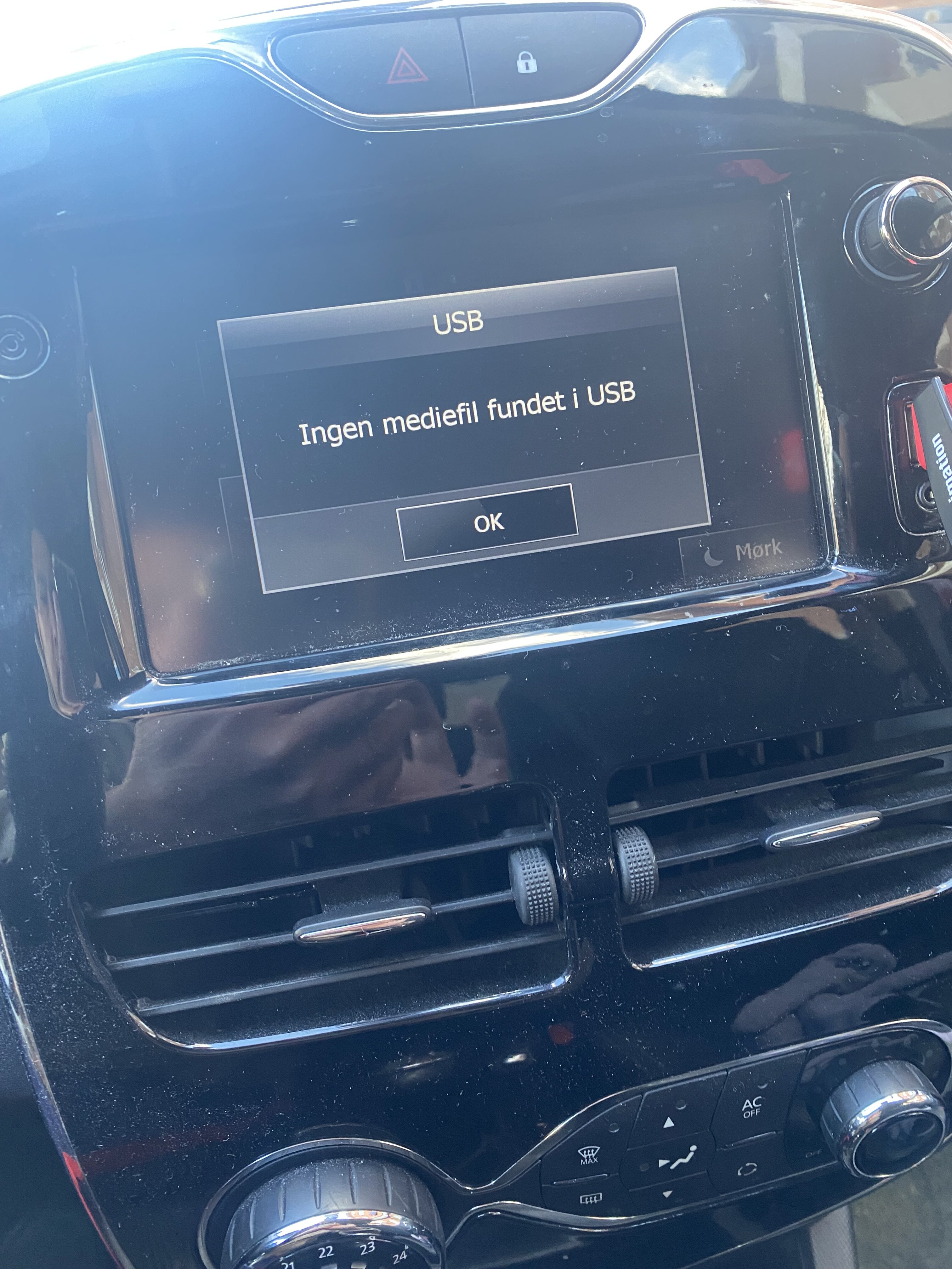

It's not going well try a brand new USB of 32 (GB) which is the minimum one can find in my city and downloaded the file zip and extract it as mentioned to the USB with no success and tried all other formats NTFS and exFAT all with this rub :
No media file was found in the USB
