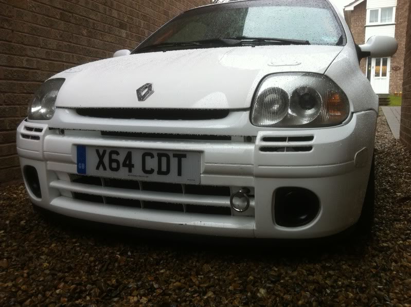

So sun was shining this morning so thought i'd tackle some of my small jobs left to do on the car!

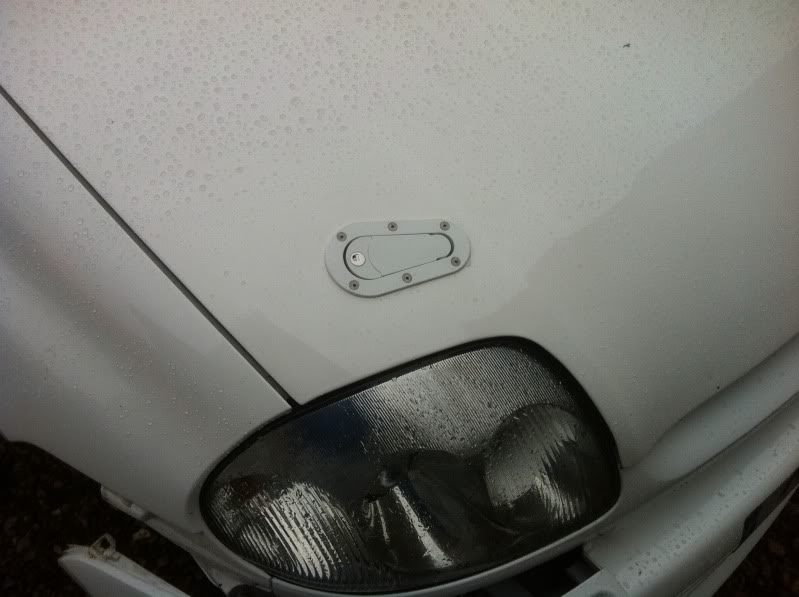

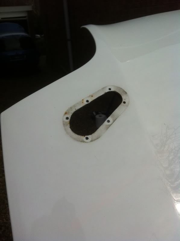

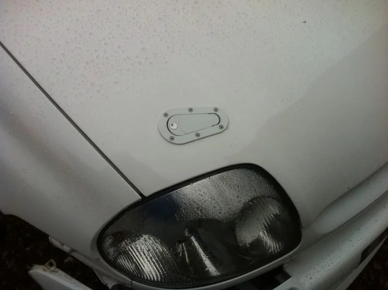

First up, change the bonnet aerocatch's for locking ones, just a case of unbolt olds, fit new ones!
Before:
During:
After:

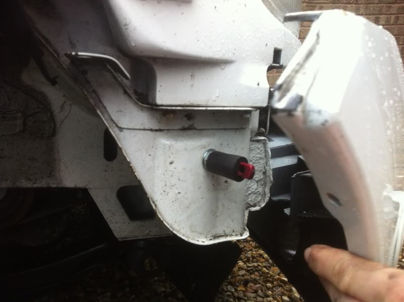

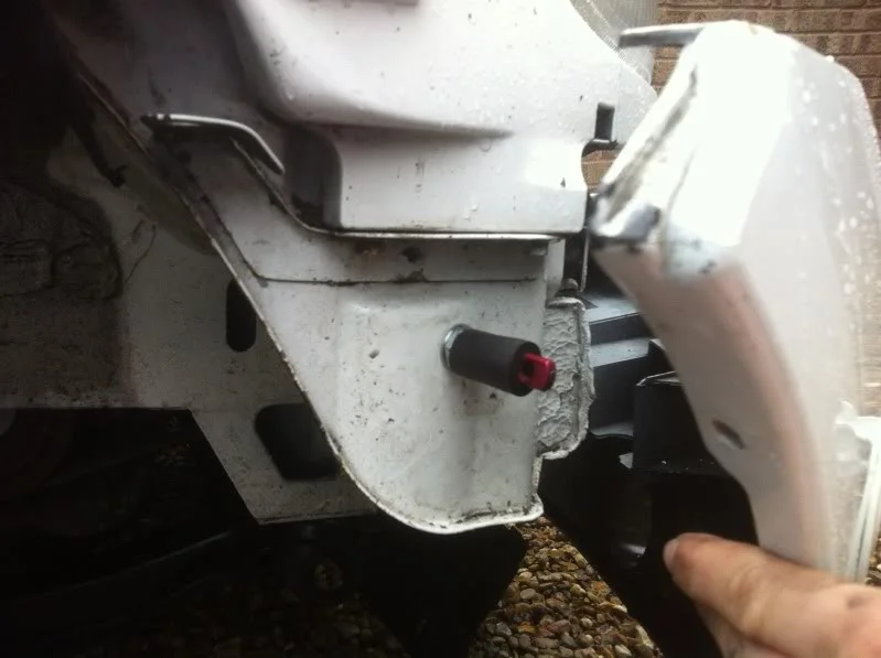

And then it started to rain, but i really wanted to get my aerocatch's fitted to my front bumper, so i pressed on!
First i fitted my pin, got that where it needed to go then i knew i could put my aerocatch on to suit the position of that.

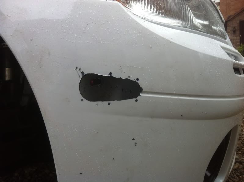

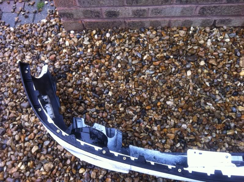

I then drilled a hole through the bumper so i could see the pin, and could position the aerocatch around it, marked up, cut it out and ready for the aerocatch! Not very neat i know, but was p*ssing down, just wanted it done!

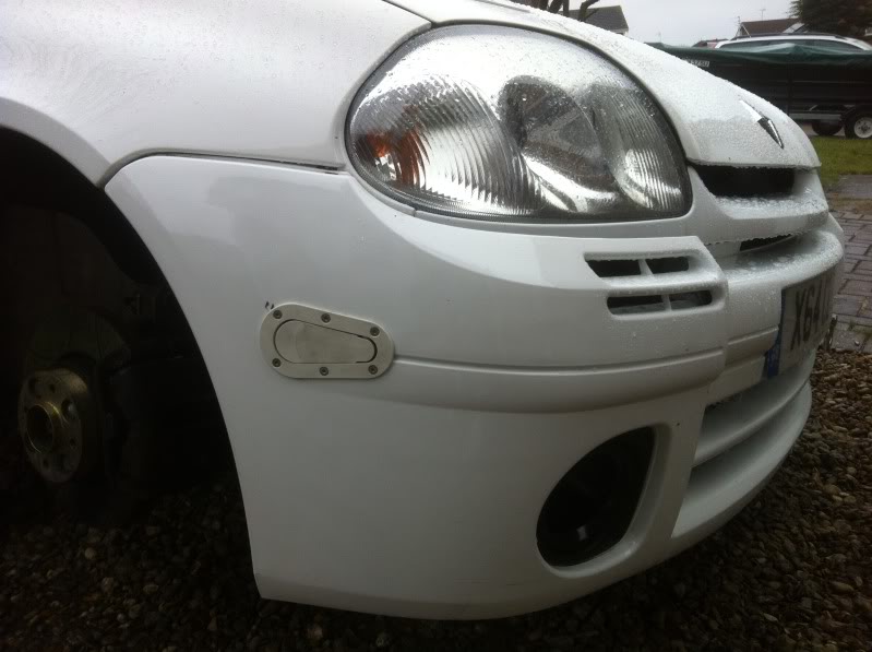

Then fitted my aerocatch:

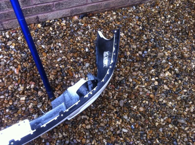

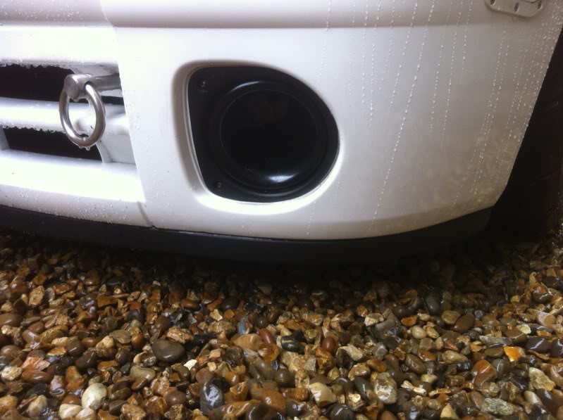

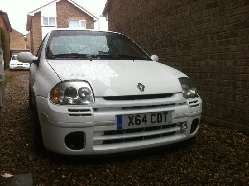

After a bit of adjustment (hitting pin with hammer mainly) it lined up 10x better than before! Bomber really is onto something with this idea! so i repeated and done the other side. Once done i quickly released my bonnet ;) Took it off and fitted a Skoda splitter.

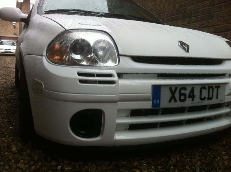

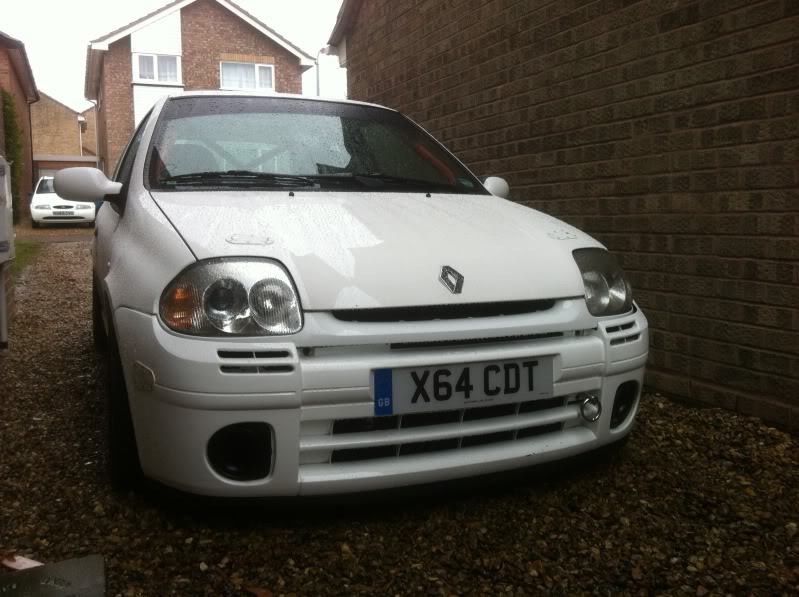

Once that was done, i popped the front bumper on (oh its easy now :p) and got some pictures.
It's hard to see the splitter in them pictures, but the pictures were taken on my iphone as i was getting wet so was in a hurry :eek: Passenger side still needs a bit of adjustment, pin needs to come out a bit too, but that can wait it's close enough for now :)
Thank you Bomber for a good idea :)

That holds the bumper so well! Come fit some for me :)
It does indeed, very impressed. I'm free next sunday if you want to pop over and i'll help you? I know how to do it and have everything needed, just wouldn't want to cut someone else's bumper as if i f*cked up i'd feel so guilty :eek:
i will be stealing tht one me thinks love the idea looks realy neat mate
Go for it, i think it's a brilliant idea, although all credit goes to Bomber and tbh i'm surprised there isn't anyone else who has done it.

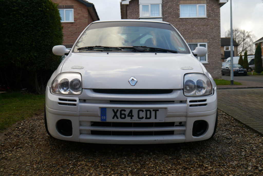

Looks great mate, can't believe no one had done it before and so glad I did. Bumper was off for rolling roads/recovery/trailering so much it just made sense. And as you now know, even more solid than the original fixings. Still love this shot of mine with it all off...
  Trafic 140dci
good work mate, wondering if i need to approach this now......hmmm
Completely missed your reply lol! Thanks mate, might be beneficial for you for more than the fact its quick release, it does hold the bumper alot better than the standard fixings, ph1's aren't to good for that :( Mine broke on my passenger side wing, which is why i have done this.
Thanks mate, i know, i'm more surprised no one has done it since you done it! I done it mainly because one of my fixings in the wing had snapped off, but glad i done it now.
Your car looks bad ass in that picture! Saw some really good pictures of it in your project thread whilst trying to find the Aerocatch pictures. Shame it's not still about, looked a beautiful machine, can't wait to see DannyR's once it's done :)
