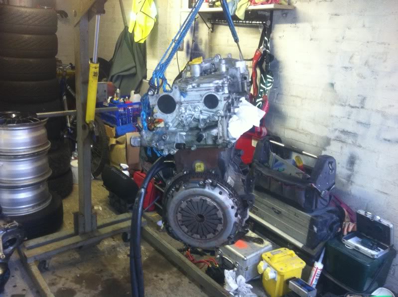

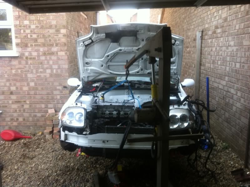

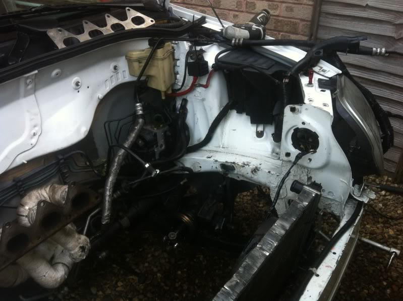

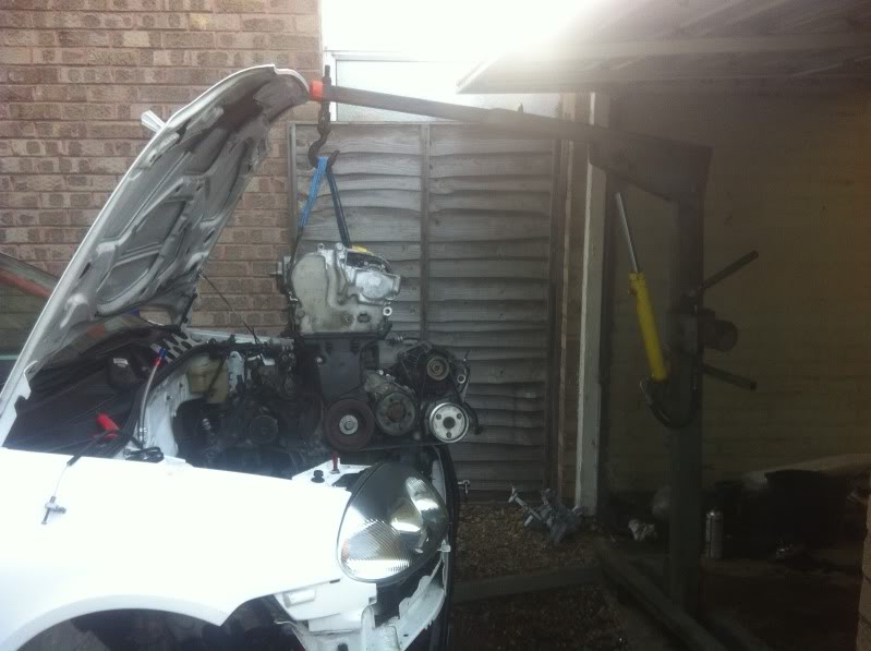

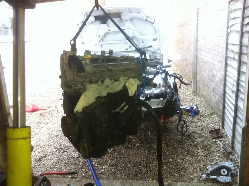

Thanks Dom, your more than welcome to come out in it any time, likewise to anyone :) As you said i really do have it all in hand, gearbox has been sourced, contacted West's for a new clutch and most importantly today after a lovely weatherspoons sunday dinner i stripped the engine bay down and got the engine out! I'm really not doing things by half's on this car, after speaking to a few experienced people i've found it would be just as easy to change the gearbox and fit a new clutch by taking the engine right out. This would also mean i could really tart the engine bay up :)

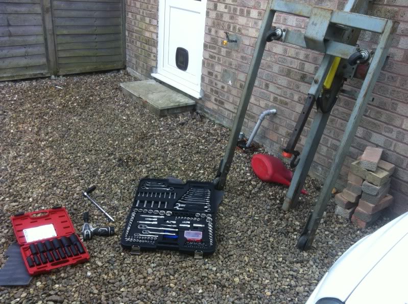

Got pictures on the iphone as i done everything. Started by getting my tools at the ready, borrowed the neighboors beast of an engine crane once again!

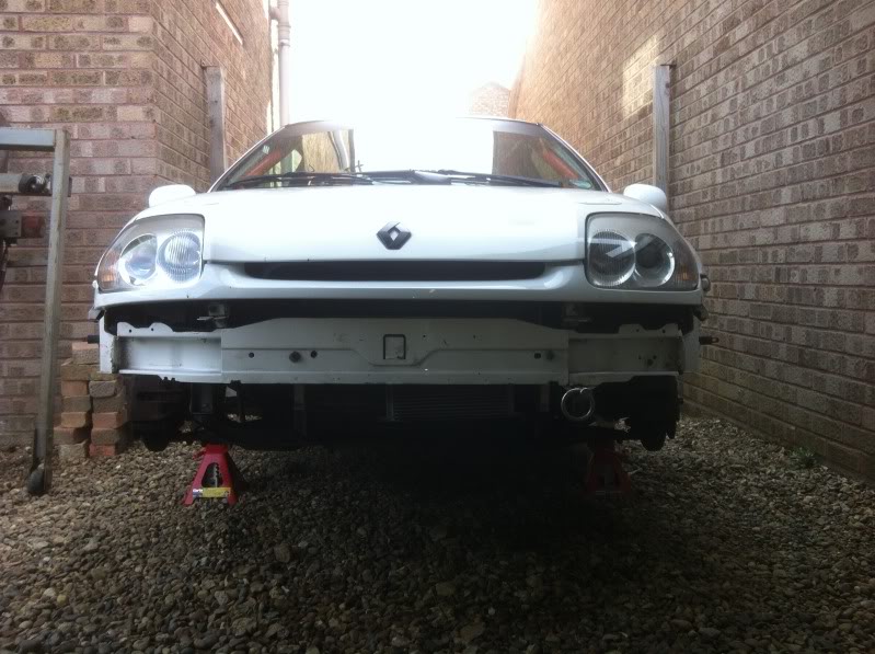

Then bumper off, jacked up onto axle stands and wheels off.

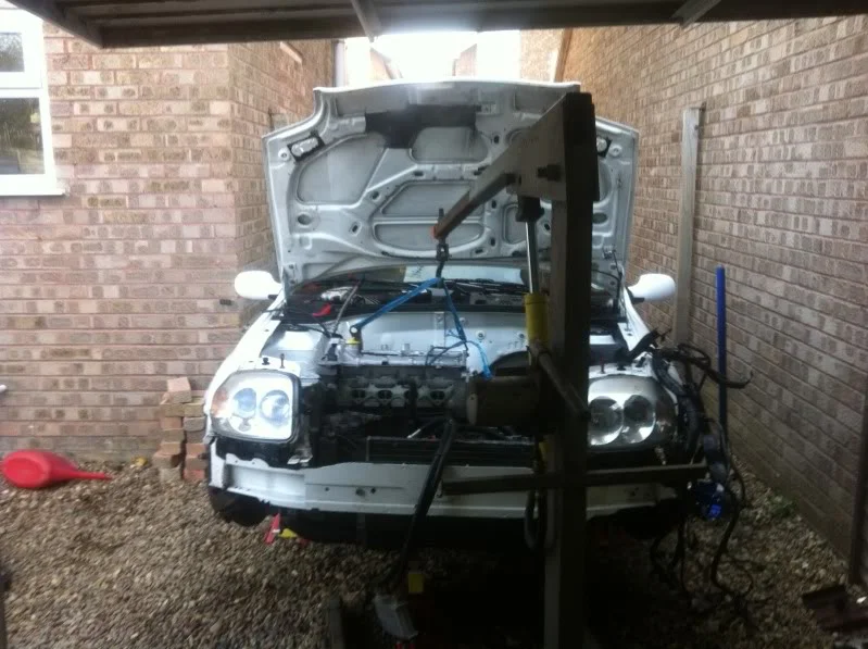

Then started unplugging all the loom, removed my ITB's and everything else holding the engine in!

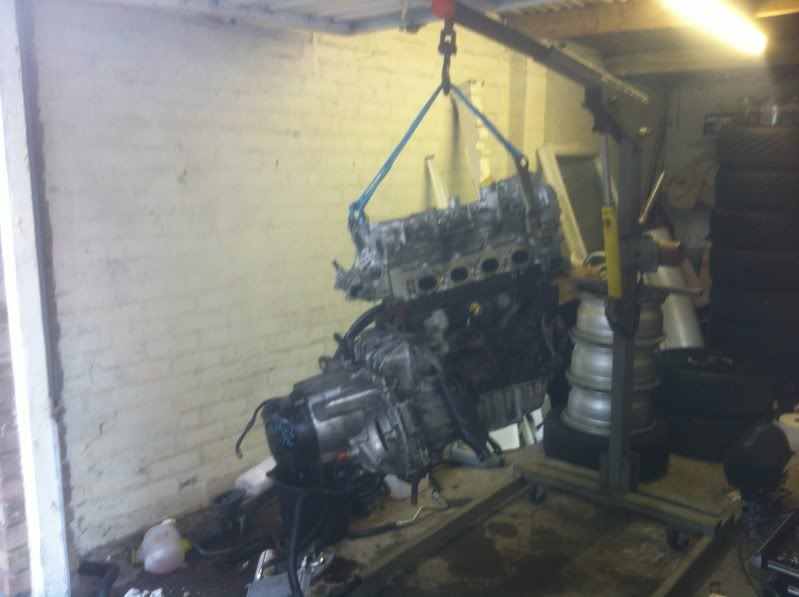

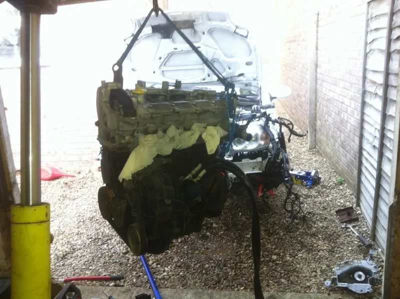

Finally after 2 and a half hours the 212.5bhp lump was out :)
Whilst up on the crane i got the old box off and i was done.

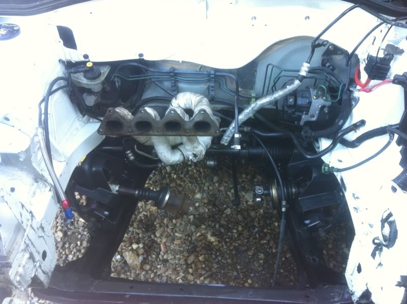

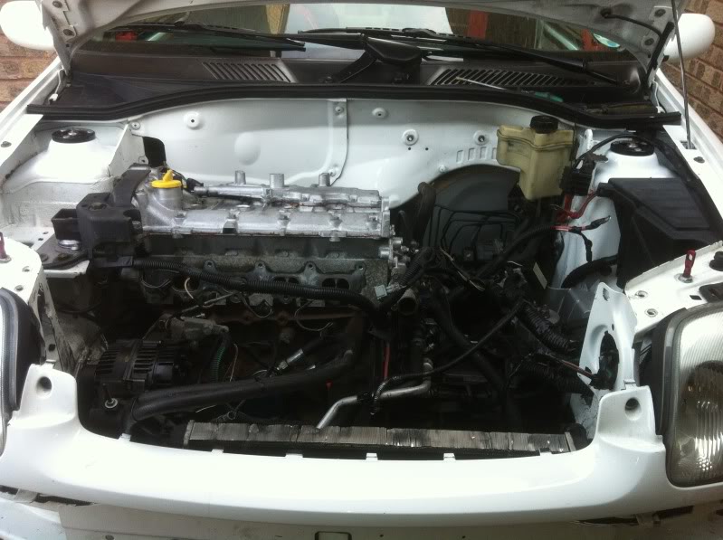

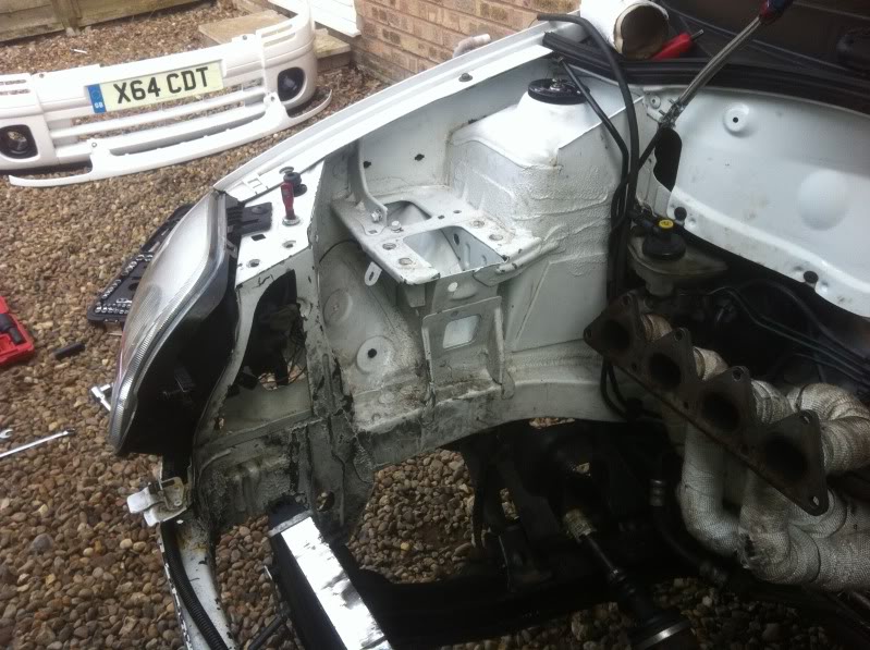

My engine bay looking fairly sorry for it's self now the engine is out.
So all in all 3 hours work, my first time taking the engine out my self, big thanks to DannyR for being at the end of the phone when i got stuck :eek:

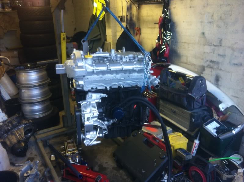

Nice early day from work today, was home at 3:30, so cracked on with the car.

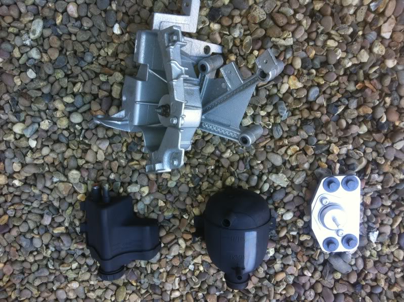

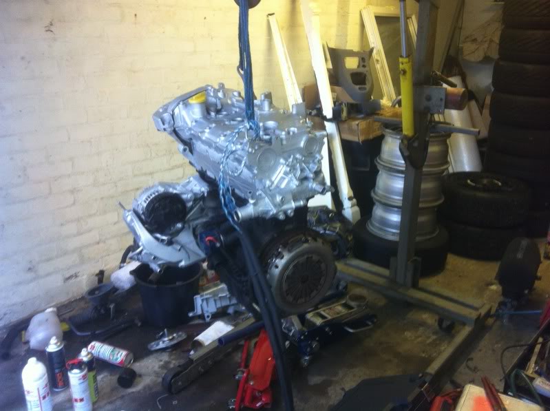

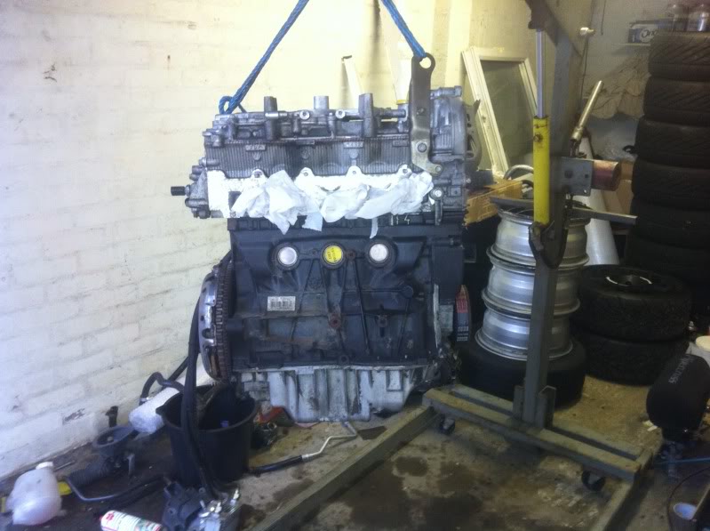

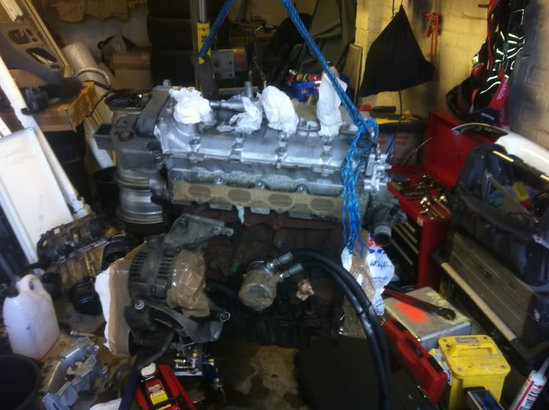

First up was too mask the engine up and give a good clean ready for paint. The plan was alternator setup siver, head upwards silver, sump and bottom end black. So sprayed all the silver bits silver, masked over them, and sprayed the remainder black :)
To say i'm happy with the results is an understatement, engine looks brand new. Also sprayed up a few other goodies, the battery tray and gearbox bracket are powder coated, had them a while, you just can't see them.

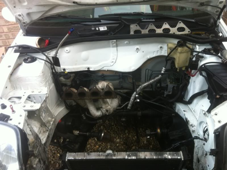

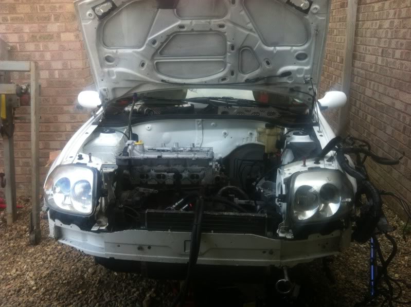

Gave the engine bay a clean, not a great deal i could do with it, but alot better than it was.
Need to clean under the arch's and under the bonnet it's self, but i came in as i was hungry :)

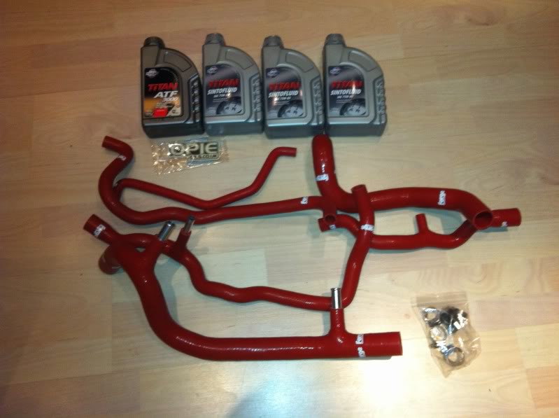

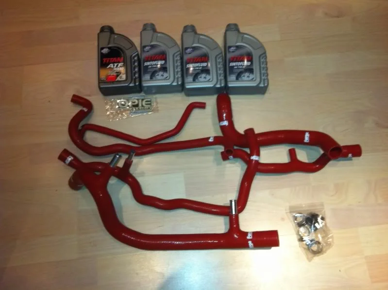

Oh btw... Hello Mr Postman bringing me goodies ;)
The hoses i wasn't going to do for a while, but the engine is out now, so would be silly not to.
