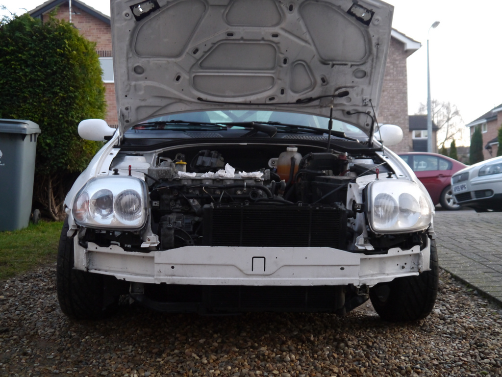

Well I've said enough now, here are the pictures, looking forward to cleaning the car as it really needs it right now!

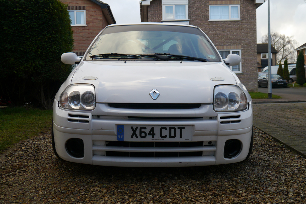

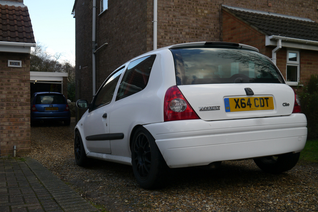

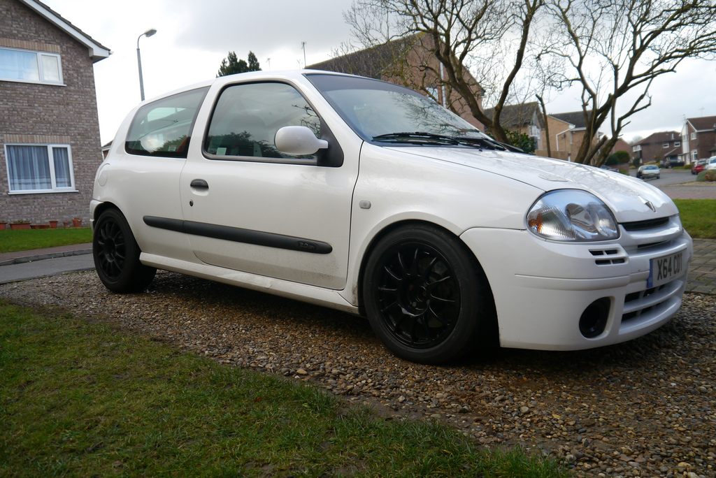

So here's the car upon arriving home.

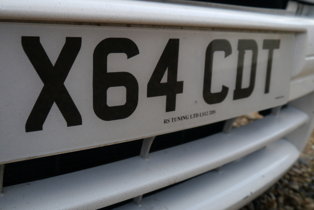

Bit of it's history with RS Tuning on the plates :)

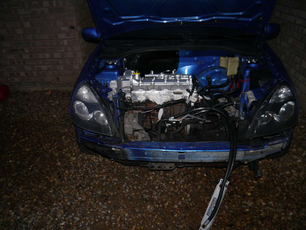

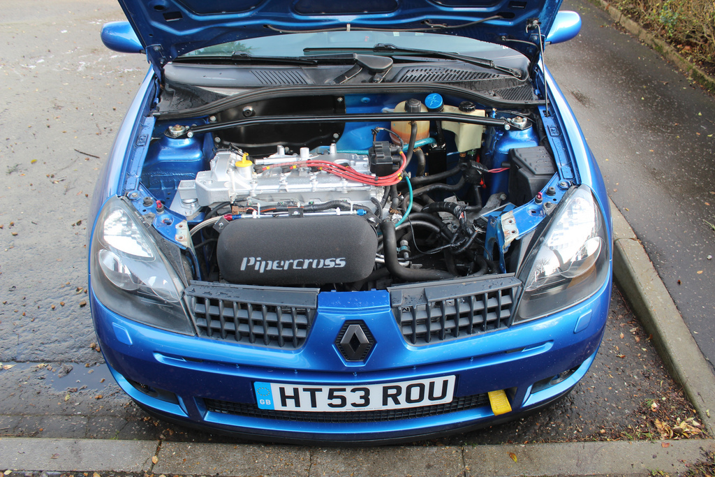

How my 172 Cup used to look
What's left of my cup :(

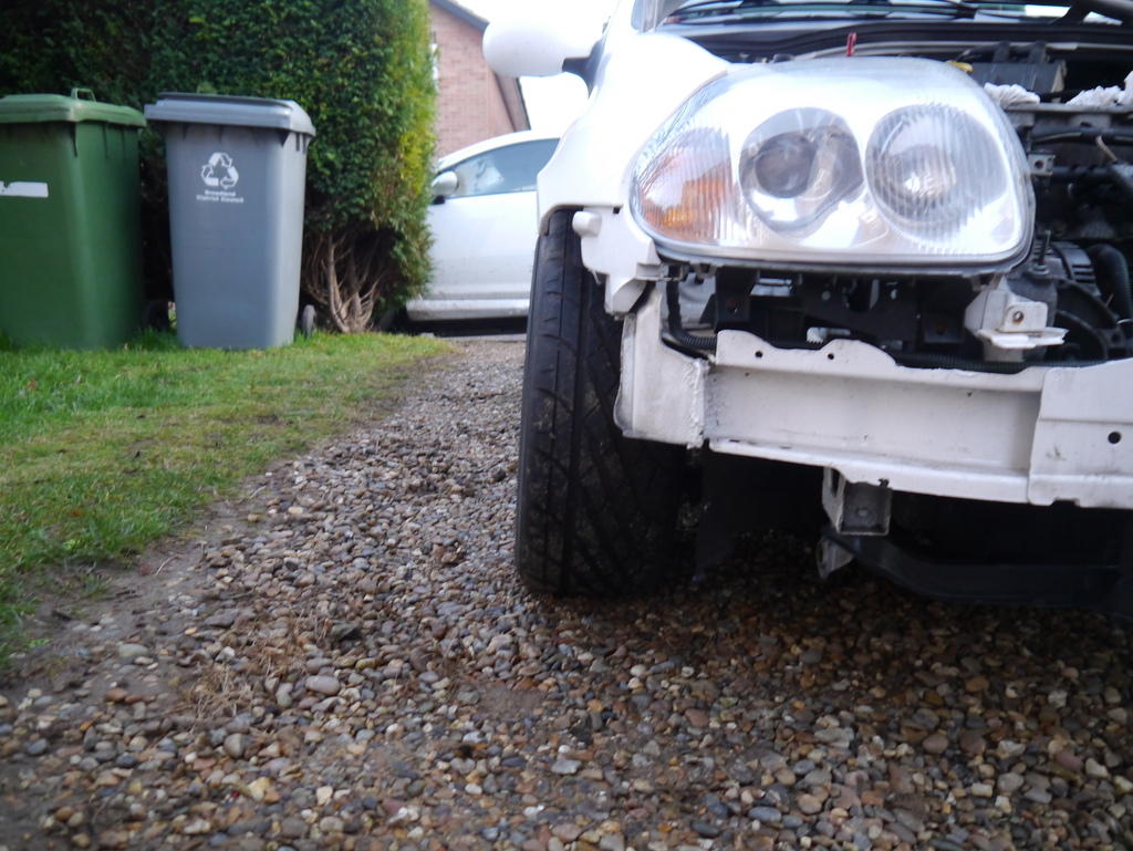

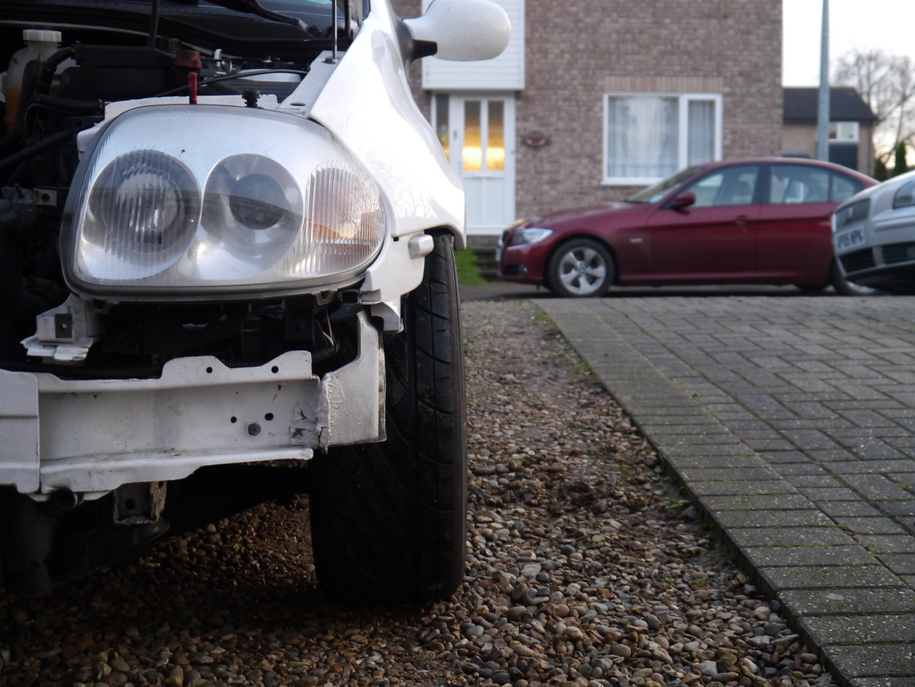

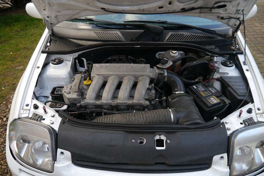

Bumper off, inlet plenum off, slam panel removed ready for ITB's

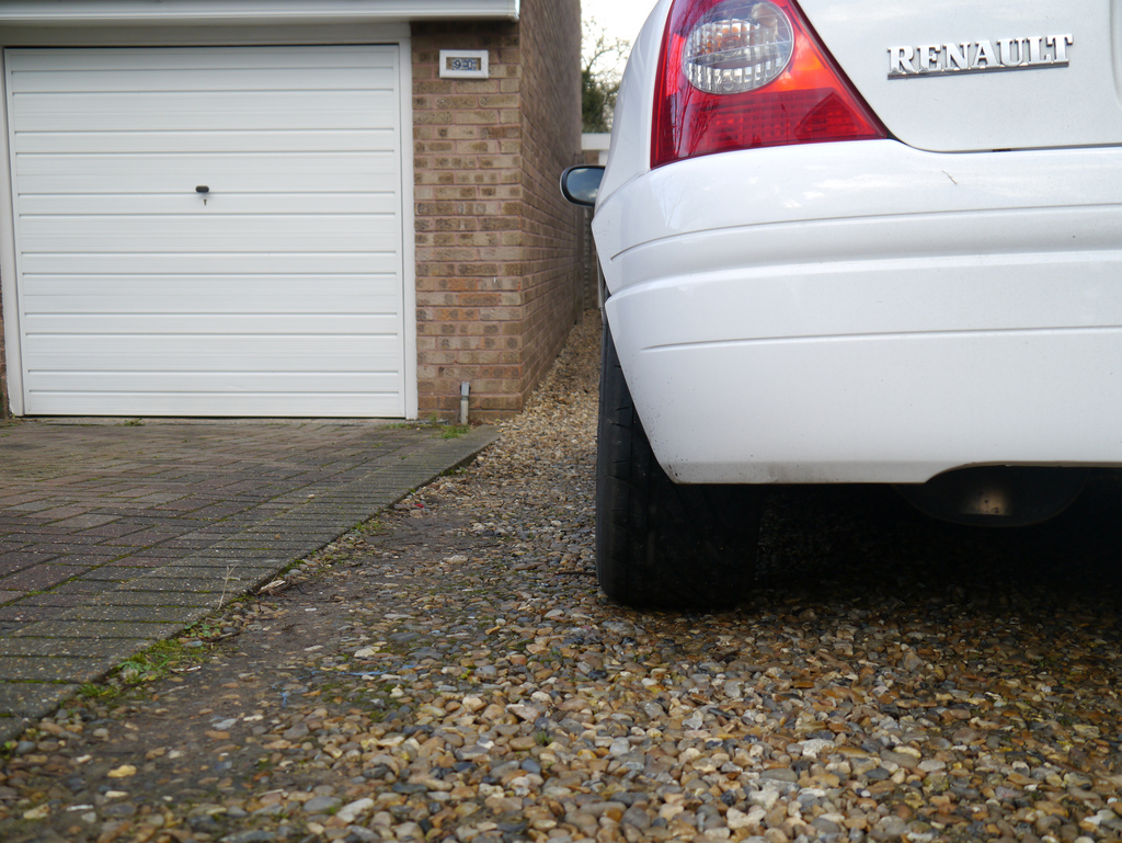

Camber....

Love the negative camber in the pics......

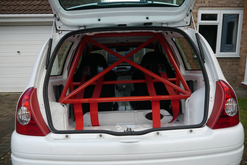

I do rather like that makes me want to get mine wrapped white,the red cage looks really cool as well:)
Thanks mate, think your's would look epic with a white wrap as it would be black/white on insides of doors/engine bay good contrast. Not to mention all the carbon!

Had a major busy day today with the help of DannyR, stripped most of the cup down now, engine and gearbox is now out, exhaust off, wheels and suspension. Got bits everywhere! ITB's & rad now fitted to the ph1, not quite running yet loom is spliced in now, although one of the omex wires has come out of the plug so need to look at that! It's also overfuelling really badly, i'm thinking this may be to do with the ph1 fuel pump as it has an in and out, so gonna swap it for the one off the cup. Also need to check my TPS too. Didn't get many pictures had to much to do and not enough time.
After the wash, ready to work on
Not alot left on it now...
Hopefully have Oreca, 182 manifold, Whiteline arb, 15mm rear spacers, studs, 2118's oh and have it running properly by next weekend :)

Good work mate! The cup doesn't look like it did in that last pic, I've got your bumper :eek:
