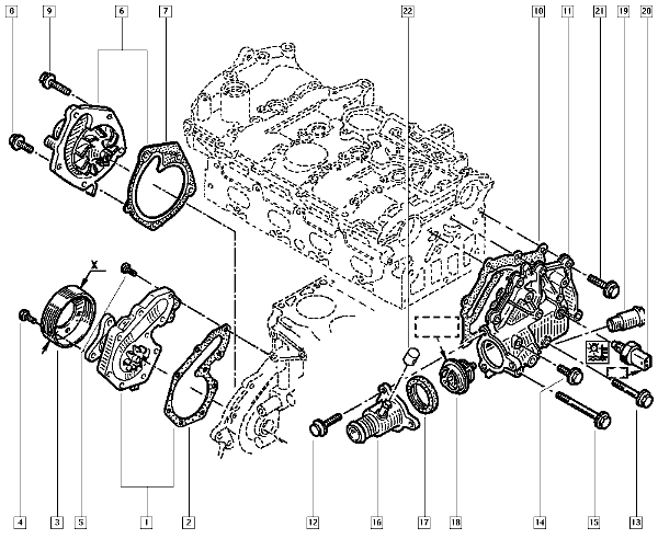

temp sensor is located in the thermostat housing, screws into the side.
i think you'll have to remove the airbox to gain access to it.
black plug with 2 or 3 pins, can't remember which now.
It's number 20 in here:
