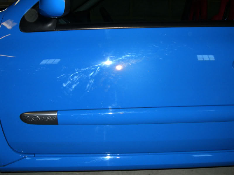

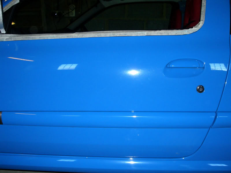

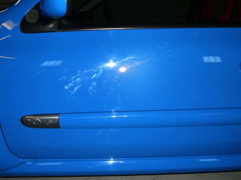

Here's the Merc after shampooing, claying, shampooing, then waxing:
http://www.irfan.co.uk/Misc/Door.JPG
http://www.irfan.co.uk/Misc/Side.JPG

Dave 172 after the application of the above products wipe the panel down with a 50/50 mix of Alcohol and Water, take a pic with the flash on camera and see what swirls remain and how much was just covered and filled.
