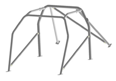

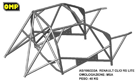

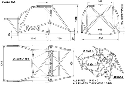

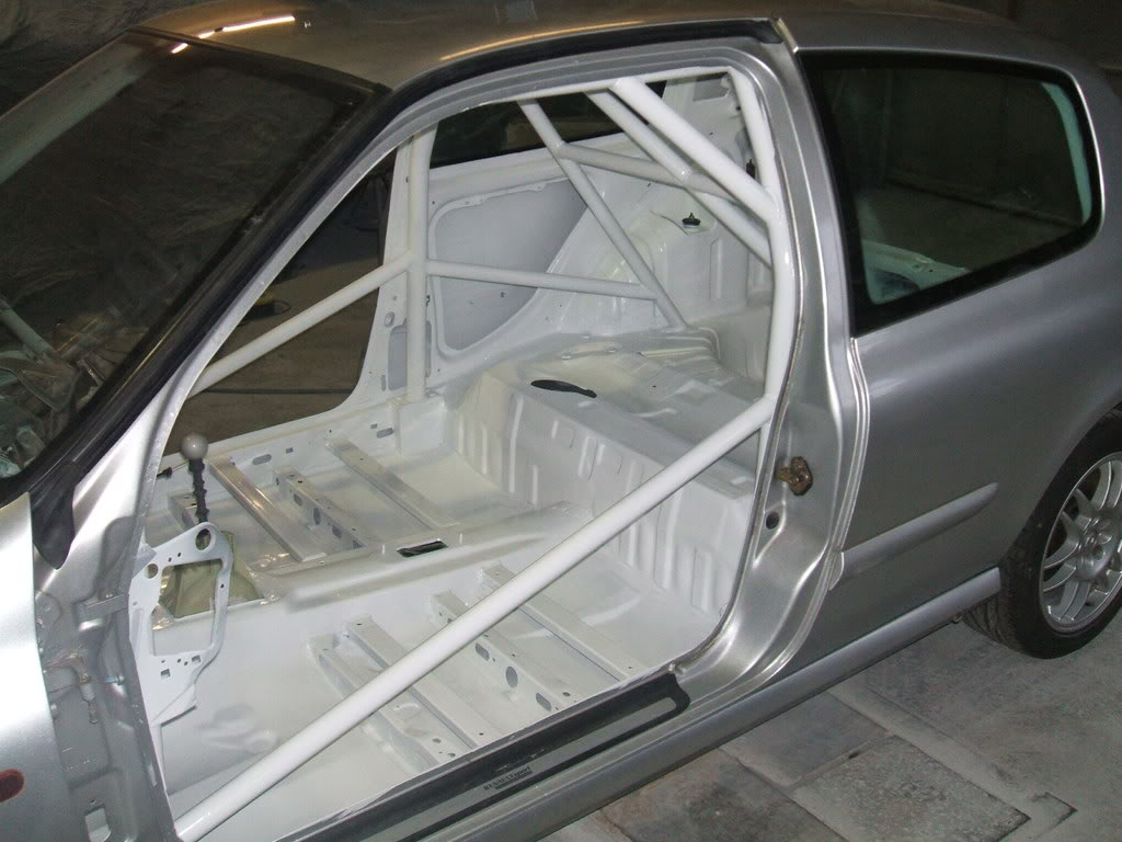

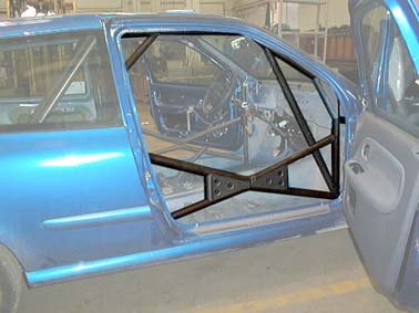

Im looking to get a roll cage for the clio, I either go balls out (making me skint) or just get the 10 point weld in (more than half the price)
here is the bawls out cage..i would need to mash the dash up to fit it and it will cost more too fit... but look at it!
Drawings
Pics

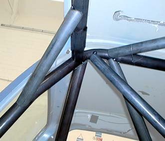

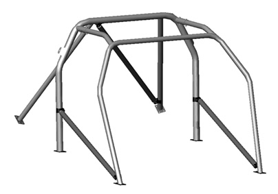

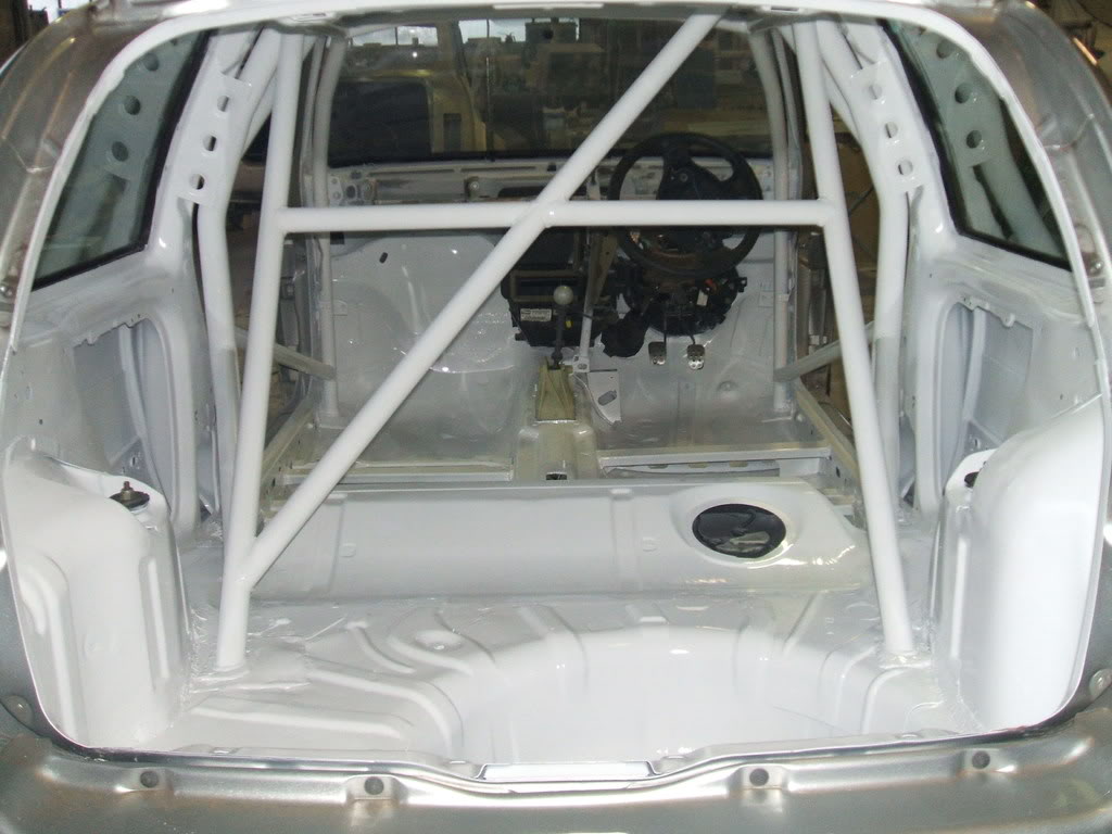

The second cage is easy to fit and does not require the dash to be mashed up it is also more tha half the price..
Sorry for nicking the pics of a members car
Second one with welded in harness bars. Imagine the weight of the first one, overkill unless you plan on doing 120 through Delamere.....
thats what im thinking, but then im wondering if i would be driving round in it thinking "i should of just spunked the extra grand"

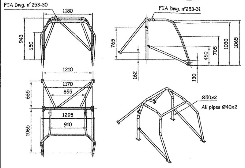

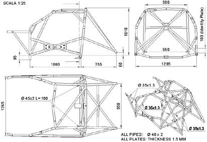

Ben could you find me this style photo of the 10 point one?
I need one to give to my fabricator.

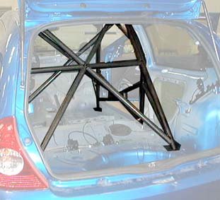

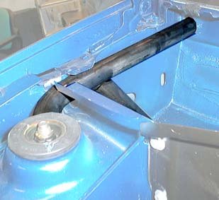

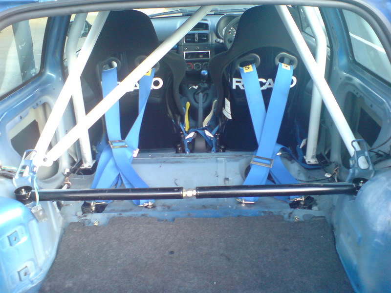

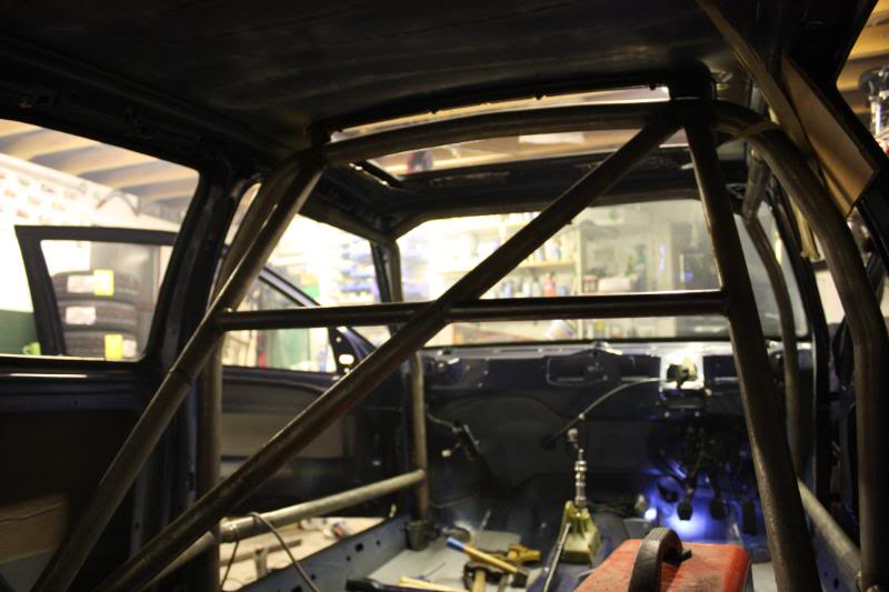

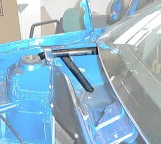

2nd looks similar to what I've just put in my Mk1. I added a harness bar too across the rear diagonal.
Bang on 7 weeks from YB.
thats what i want to do, where did you get the extra bar from?
A fabby mate of mine, it's pretty ordinary 36mm steel tube, not the seamless stuff that the cage is made from. It's not going anywhere though.
Then I profiled the ends to suit and sit level.
