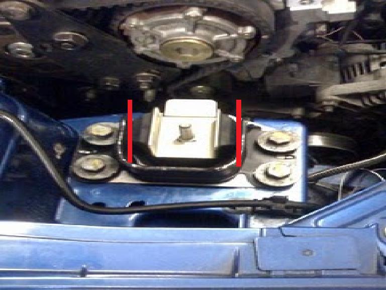

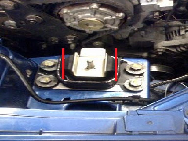

Not sure how to check the dog bone mount bushes. But the upper engine mount above the cambelt does show some signs of movement.
The rubber wedges around the middle part appear to have been rubbing against the solid black square surround part (sorry for lack of technical names)
Red areas
Cause for concern or normal? How do i check the other mounts? (not my car, just for illustravtive purpose)

Thats how i checked the mount above the cambelt, it moved a bit, just over half a centimetre. Wheres the other top mount?

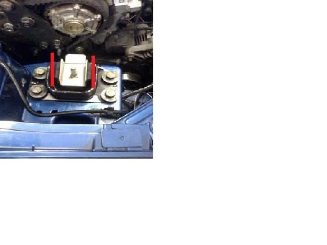

Red areas

The mount is supposed two allow this movement. (little gaps) Sucks, but it's normal do'nt worry
So i can rule out this mount as the cause...Just got to check the other one under battery and dogbone bushes.
