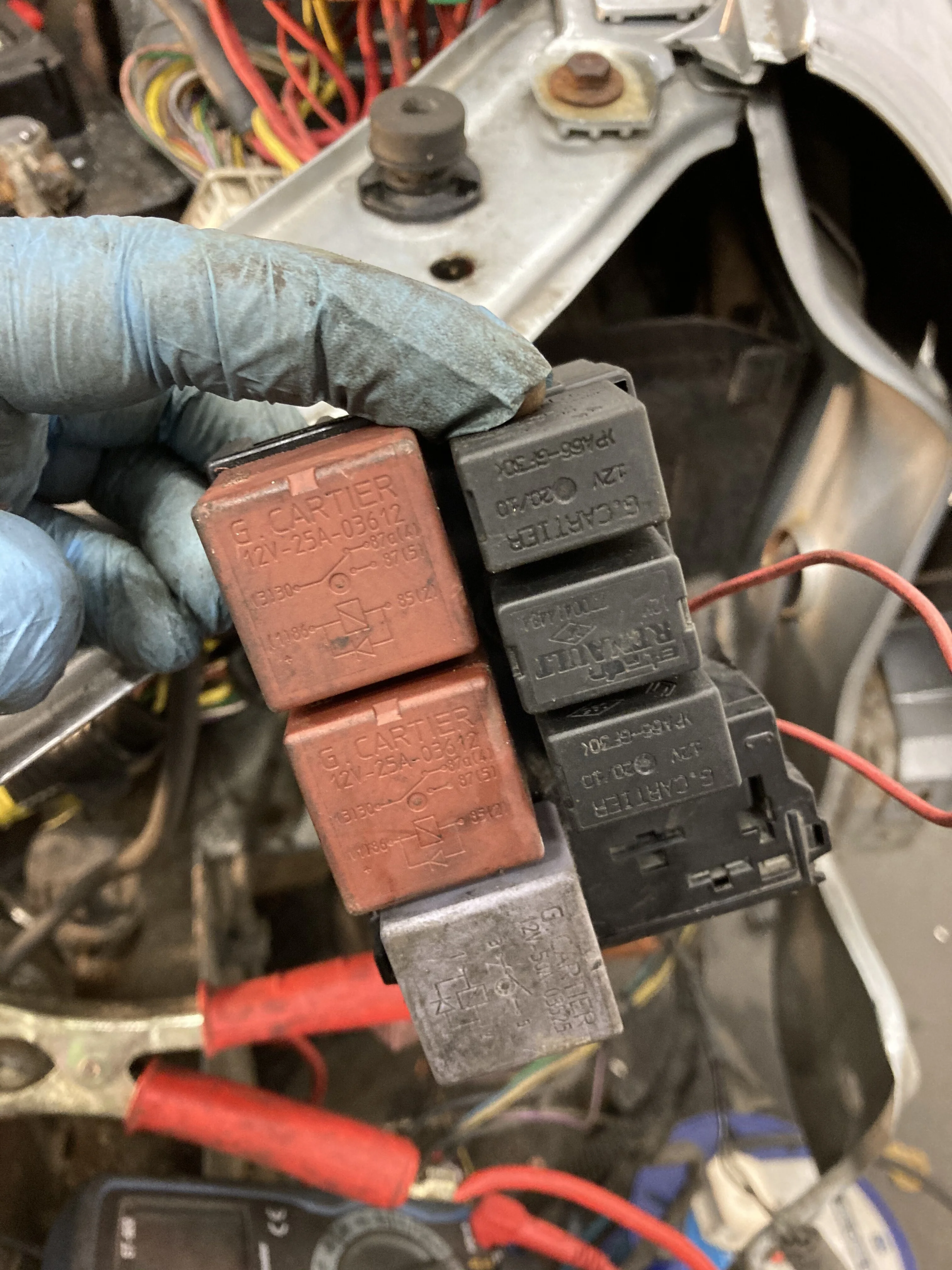

This is relay pissing me off now. (Clicking mega fast)
Djw John
Scotland - South
This one, injection relay I believe.
Earths are good, checked in several different ways.
It's a new loom but seems to be about the same as the old one. Kinda doing my head in diagnosing it now as I keep chasing one problem away and getting 2 in return!
What should I be checking? The green wire seems to be the switched one and is giving out 5V. I've checked with several relays and they all do the same.

Checked the relay earth and also tapped into it which has stopped the clicking.

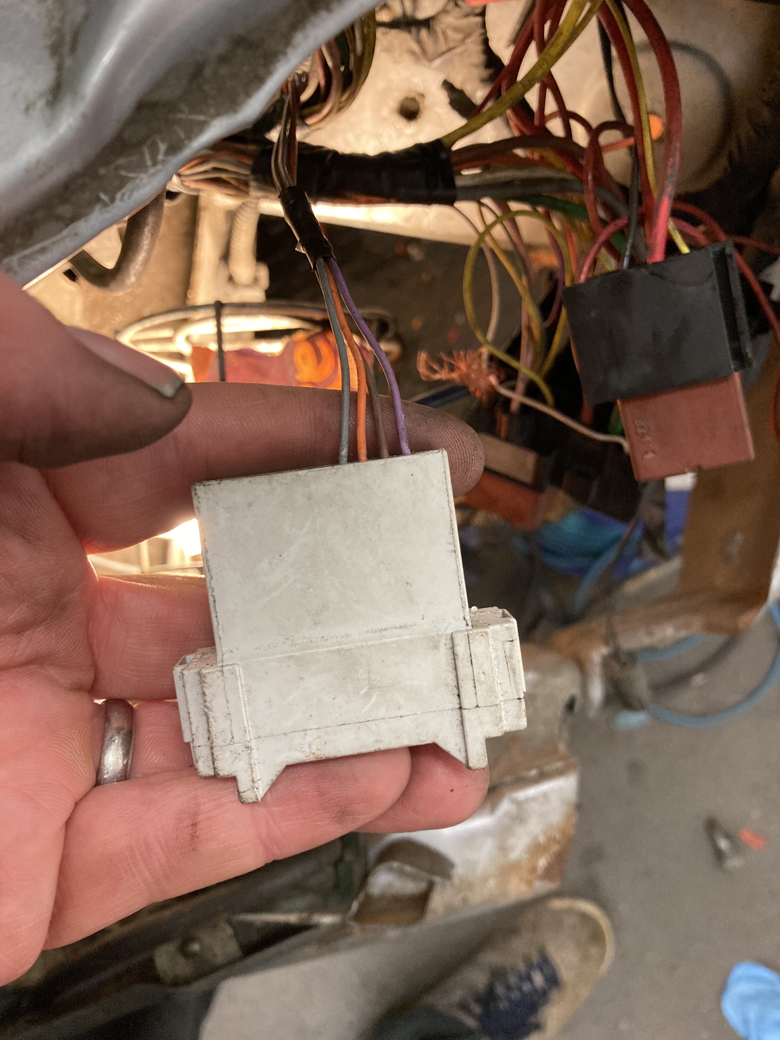

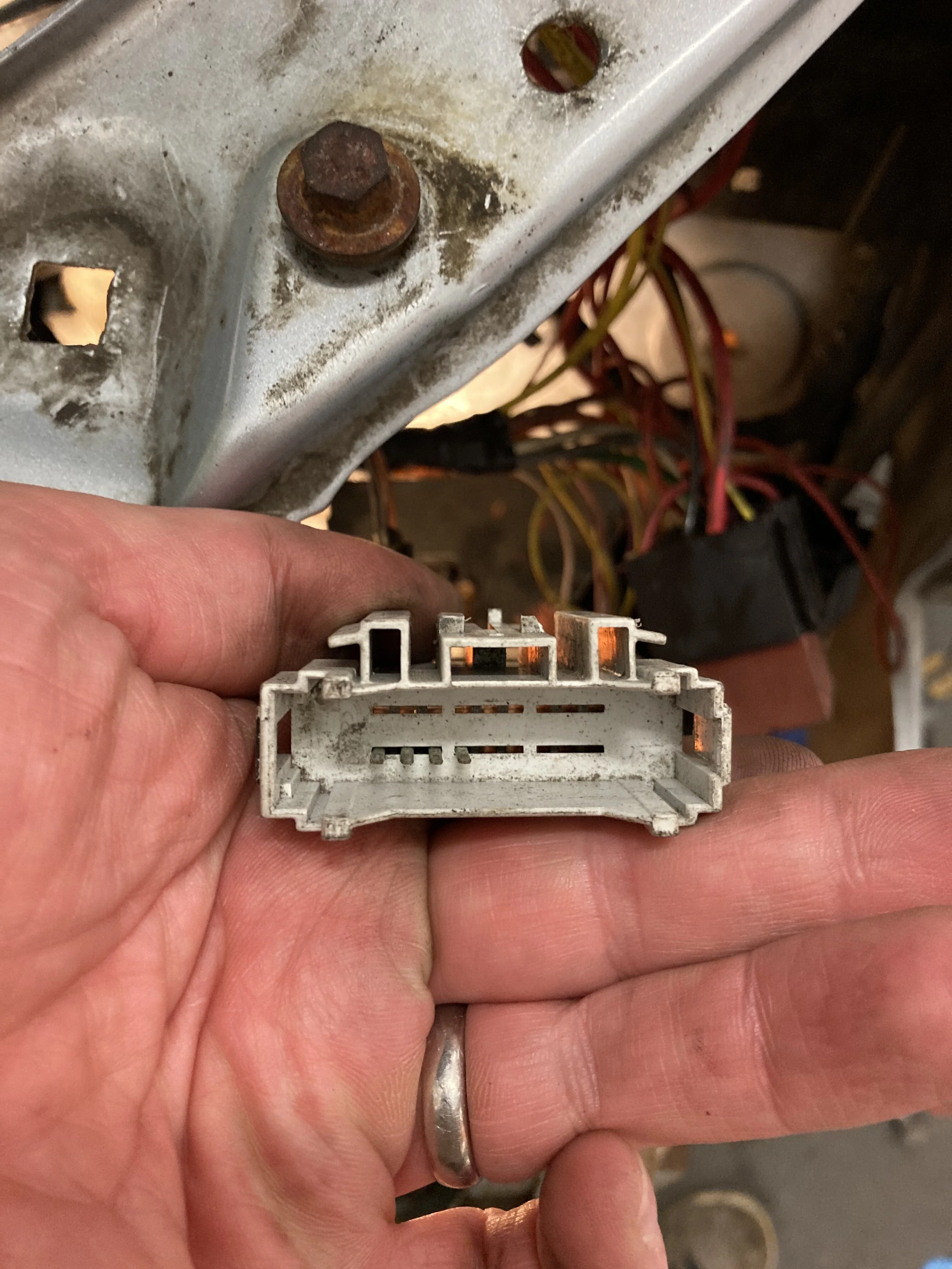

Jesus I must have been tired last night, thats not the white plug I was on about. That plug comes on an earlier loom so you'll have a later 03 onwards engine loom. Not entirely sure what it does but a CAN test with CLIP might bring something up

Aye that is a weird one haha, I can't remember what that grey plug energises now. Its defintely something to do with starting the car though so that will likely be your issue

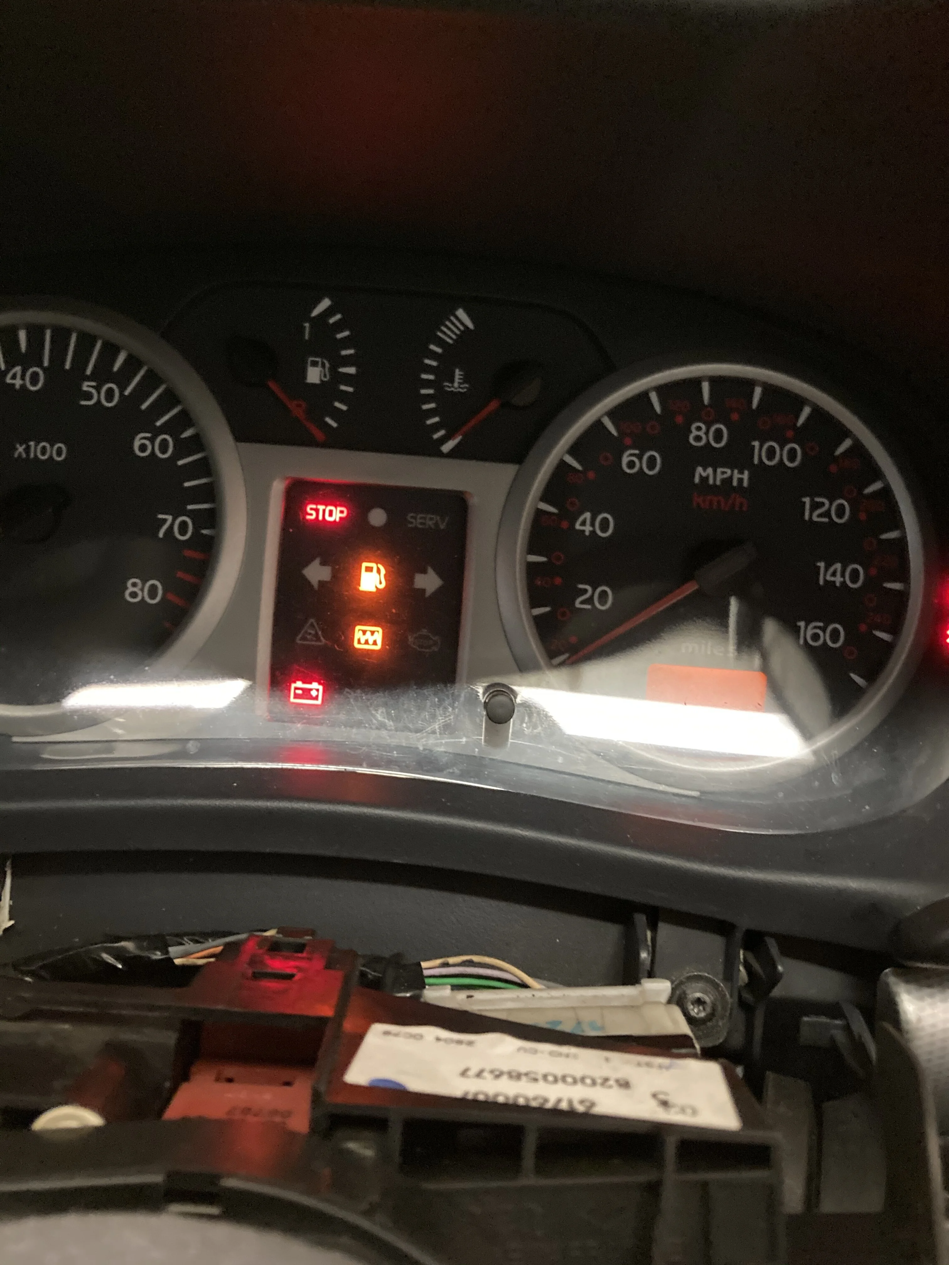

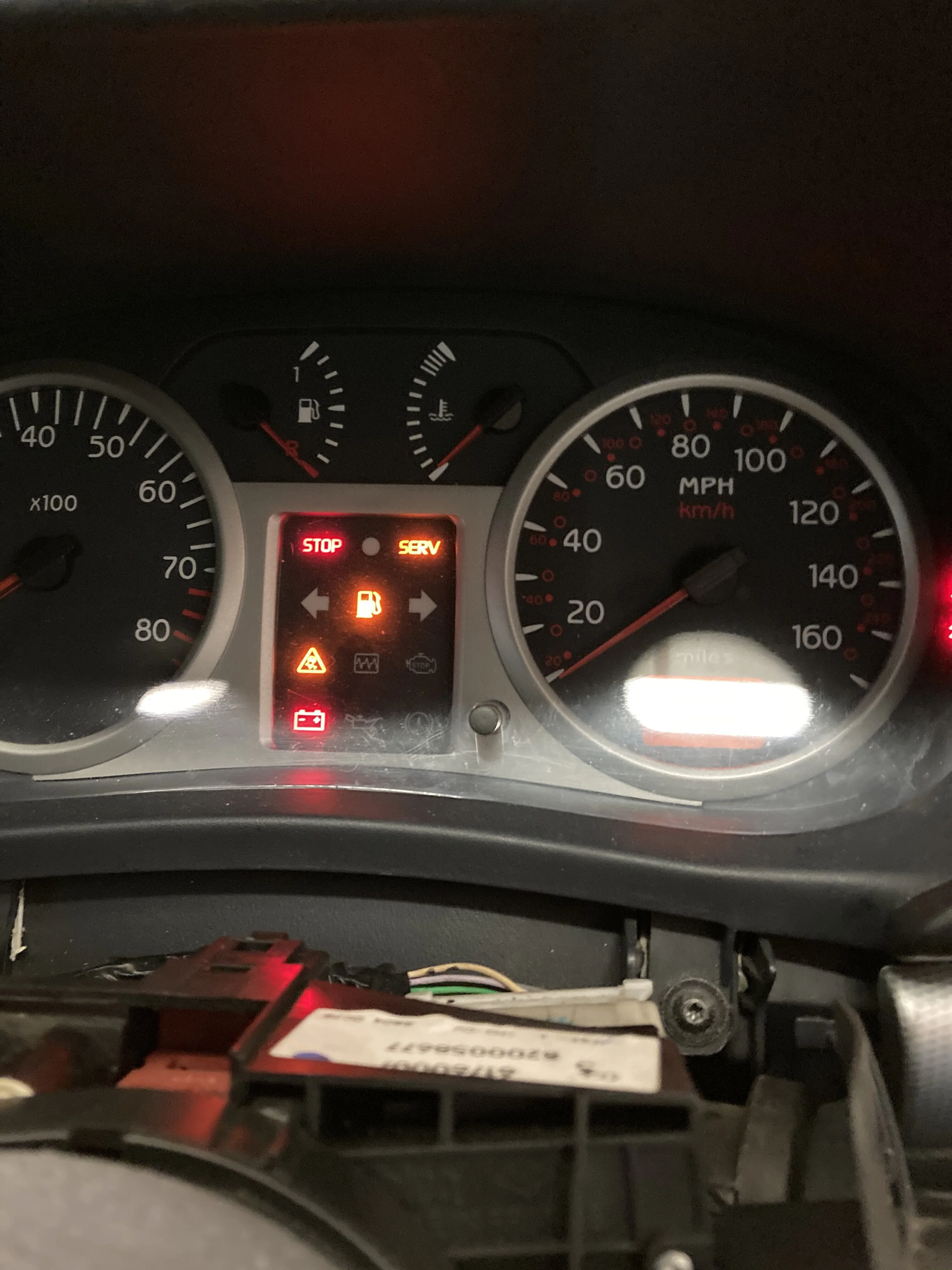

Changed the ecu, uch and key today after not having a chance to look at this for months. Relay no longer going bonkers so that's good
Immob light was flashing like mad so wouldn't start. Went out for a few hours and when we came home I thought I'd try again. Solid red light.

So it fired up after changing the ECU, but just had a loud relay?
All of the ecu, uch and key are a matching set?
The decoder ring usually gives the flashing inmob light, but i think it's often just a bad key battery rather than a faulty ring. Try changing this first then unlock and lock the car with the key in the ignition before cycling it again for a minute through the ignition sequence (without actually starting the car). Did you only get the one with the new uch?
Next up check you're getting 5v at the ring and then I'd be going over all the earths again, including hunting for damaged/worn wires between ecu and big white plug.
