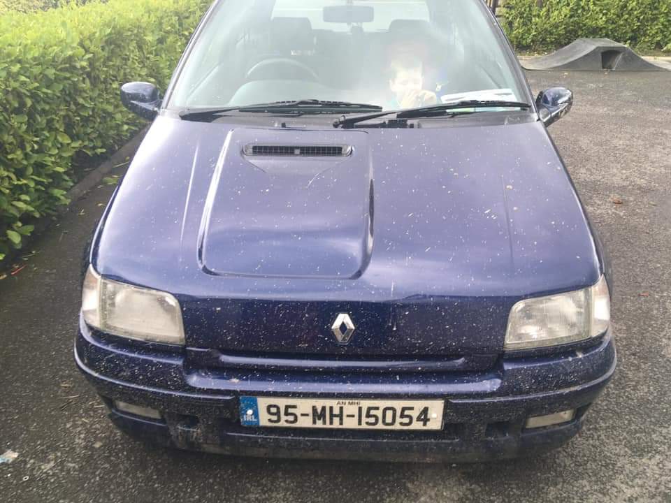

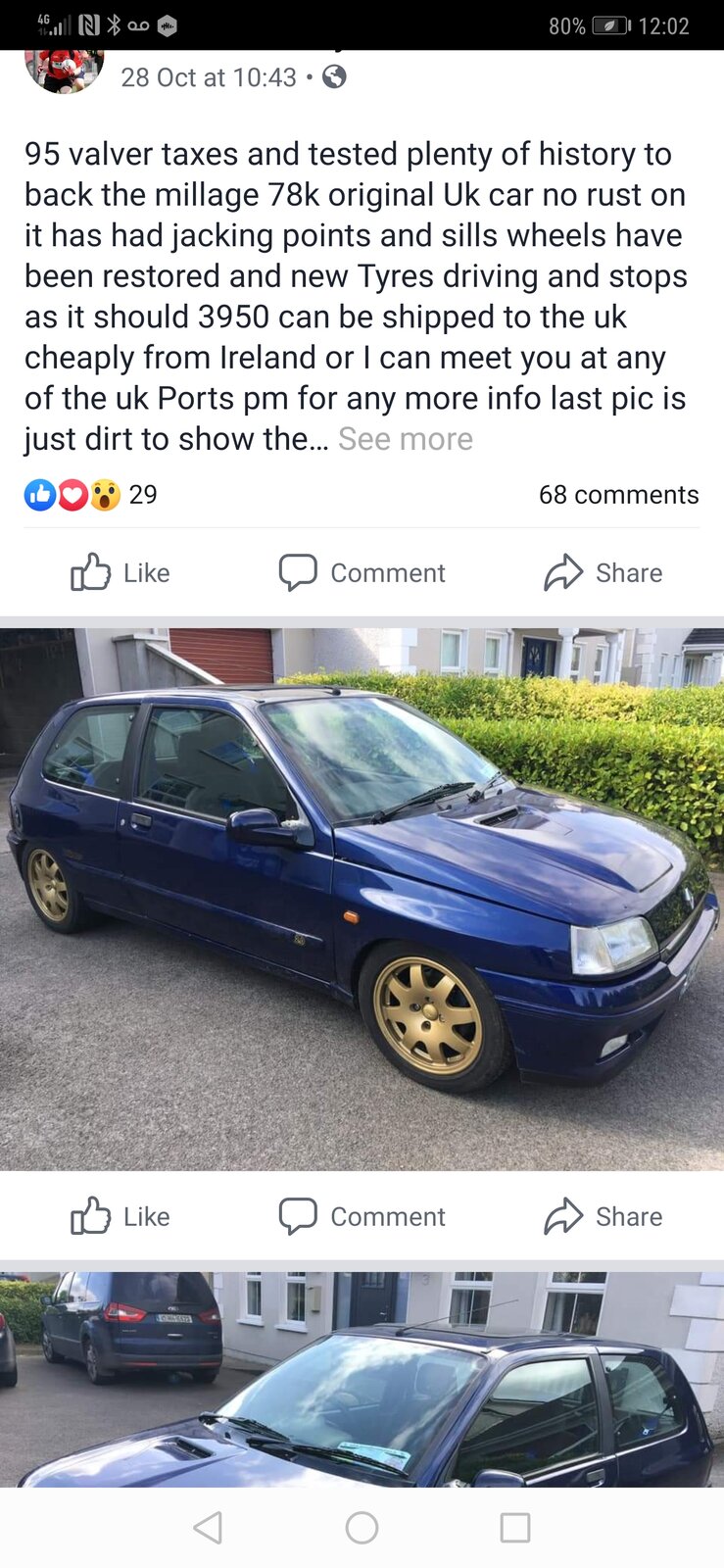

Saw this on fb....other than not physically seeing this seems to good to be true, I know it's a bit of a bgamble but surely this if as good as it seems I a solid investment with instant returns to any buyer, what am I missing?

It's a copy. But not a very good one.

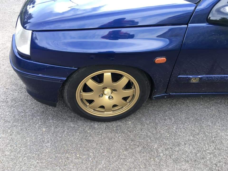

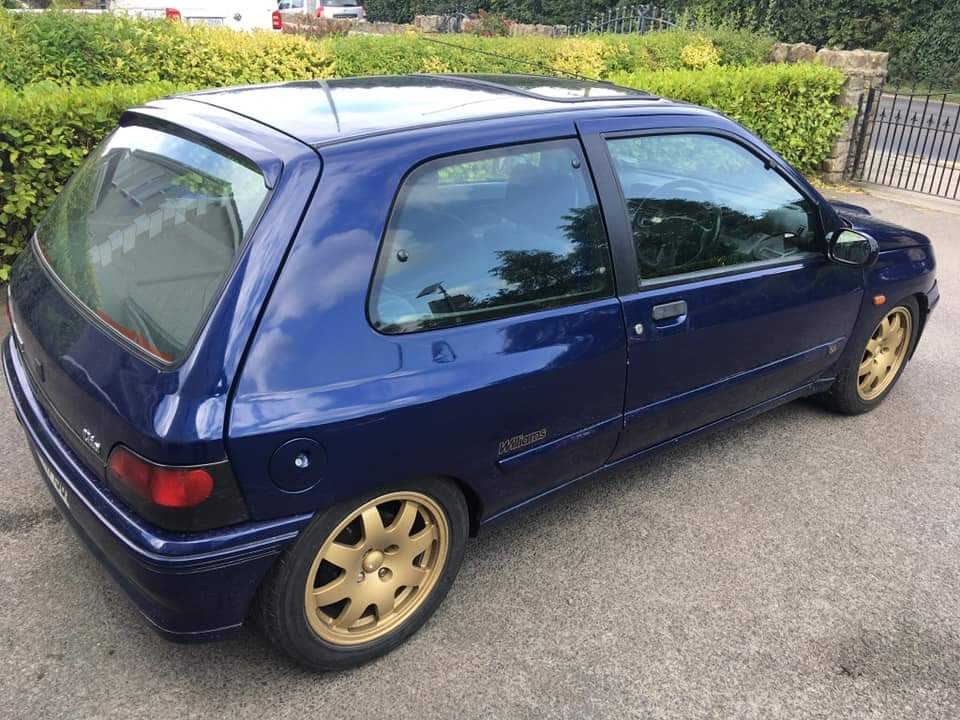

The plaque shouldn't be there. The carpet should be blue. The centre of the steering wheel is wrong as it's from an older car, the car should have an air bag being a 1995 one. It's badged as a Williams but a 1995 / phase 2 car would be a Williams 2. The boot spoiler is colour coded, but I'm not sure if it's a Williams one.
The wheels should have a sliver lip on them iirc. The bumper strips etc should be black.
For £4k I'd find a better one.

It's registered as a 1.8 16v
Is proof reading too much to ask? Seat belts are Ebay blue rather than the darker Williams too.
