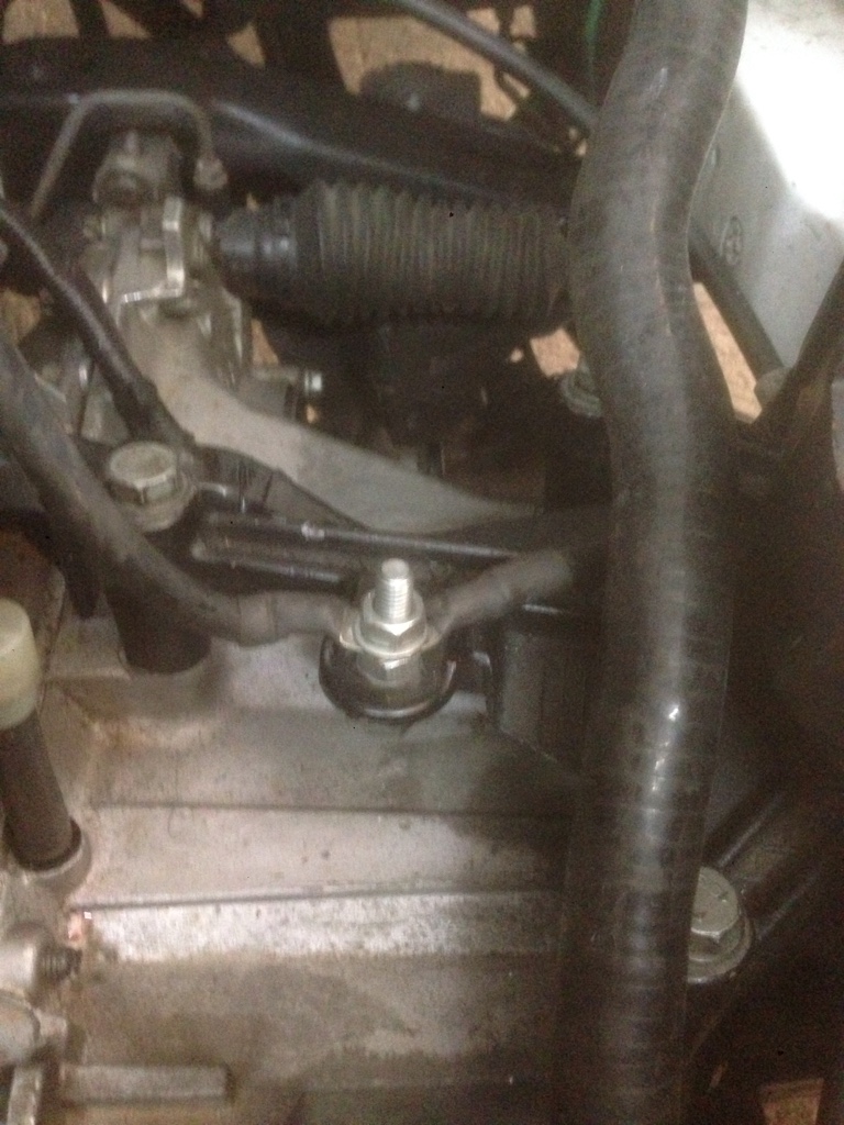

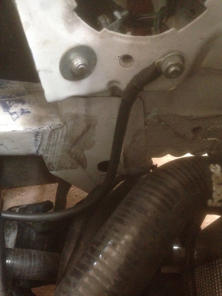

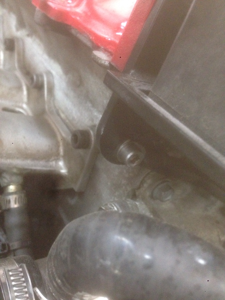

So, we checked all the earths, and wiring for the things we had changed. It all seemed good, but has a small current when tested between the engine and body earth. When I say small, it was 0.4 volts(?) or whatever the thing reads. This lead us to think that it must be/could be an earthing issue. A couple of the TARC guys had also said the same.
Another thing we checked, was the Cam sensor. It didn't seem to be faulty, as it didn't show anything up on the dyno, but we got a new one anyway and changed it.
Only other thing we can think of, is to add another earth from Engine to Body, and check everything else is intact. So tomorrow, we are going to check every single earth and electrical connection, add a couple more earths, and double, double check the wiring on the electric cut off button. It's so hard to find the fault when you can't replicate it!

Russ Rallye
That's why I always over 'bond' everything. Easy way to check that though. Couple of jump leads clipped on the engine/gearbox to a known good earth or even battery terminal to eliminate that. Are the factory earth cables still present, main one being the one on the front of the subframe passenger side.

We did that, and that's how we found the residence. But it was intermittent. And only showed up when the engine was off. As soon as we started it, ip the reader went to 0.00. And is it amps, or volts?
Russ Rallye
No need. Only thing you need to measure is resistance (ohms) between the engine casing and a known good earth if it's not very close to 0 then you've got issues. It's irrelevant if engines running or not. Only other thing to check is there's no issues with your battery cut off if it breaks the connection from battery neg to chassis when switched off, mine does but can't remember what type you have.

So, as we are reading 0.4 to 6.8, you'd say there was an issue? Even though that goes when the engine is started? We took the reading off the top of the suspension, and the head, so I'd have thought they were good places to check? And I'll get the cut off checked.
Russ Rallye
The reason the high resistance might disapear once running is it maybe picking up a ground through the ecu once switched on or something. If the fault went away when the jump leads were clipped all over the place then just replicate that in a neater more permanent fashion. I can do it at Silverstone if you haven't sorted it by then but obviously it would be nice to be 100% sure that's the problem tbh.

Russ Rallye
Standard bottom earth strap is still on mine + some 16mm2 cable from the oe earth point next to the passenger headlight to the gearbox mount cradle on to the engine block above the thermostat housing.

We got all the earths checked, and found a couple of suspect ones, so have sorted them and added a couple more from the engine to the body.

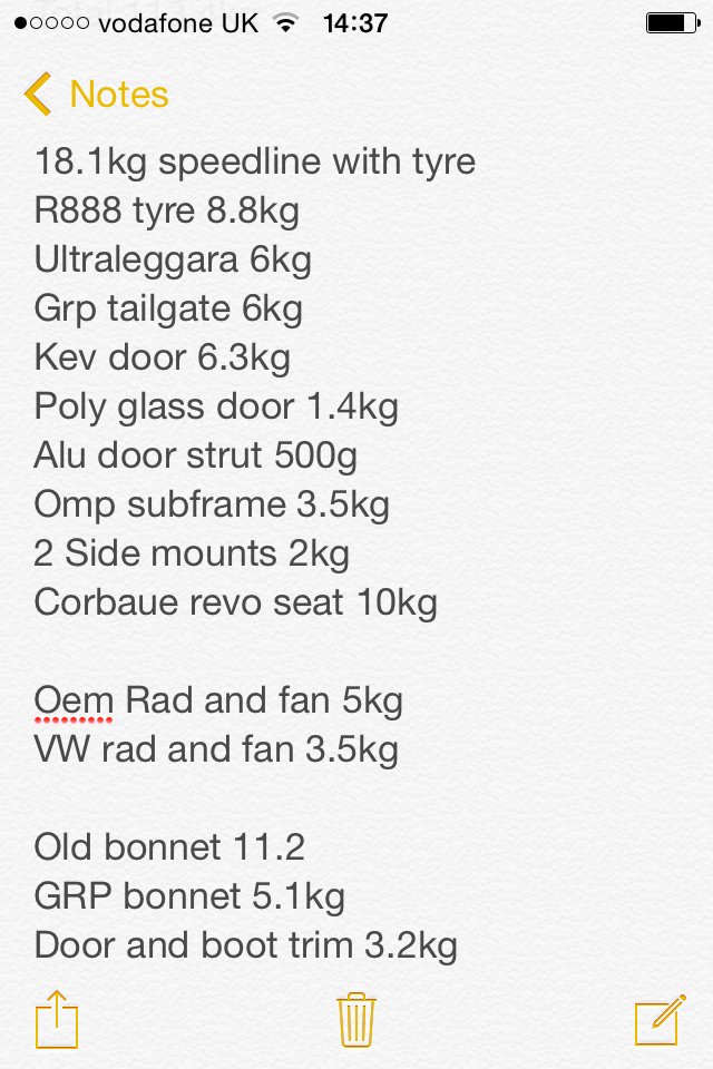

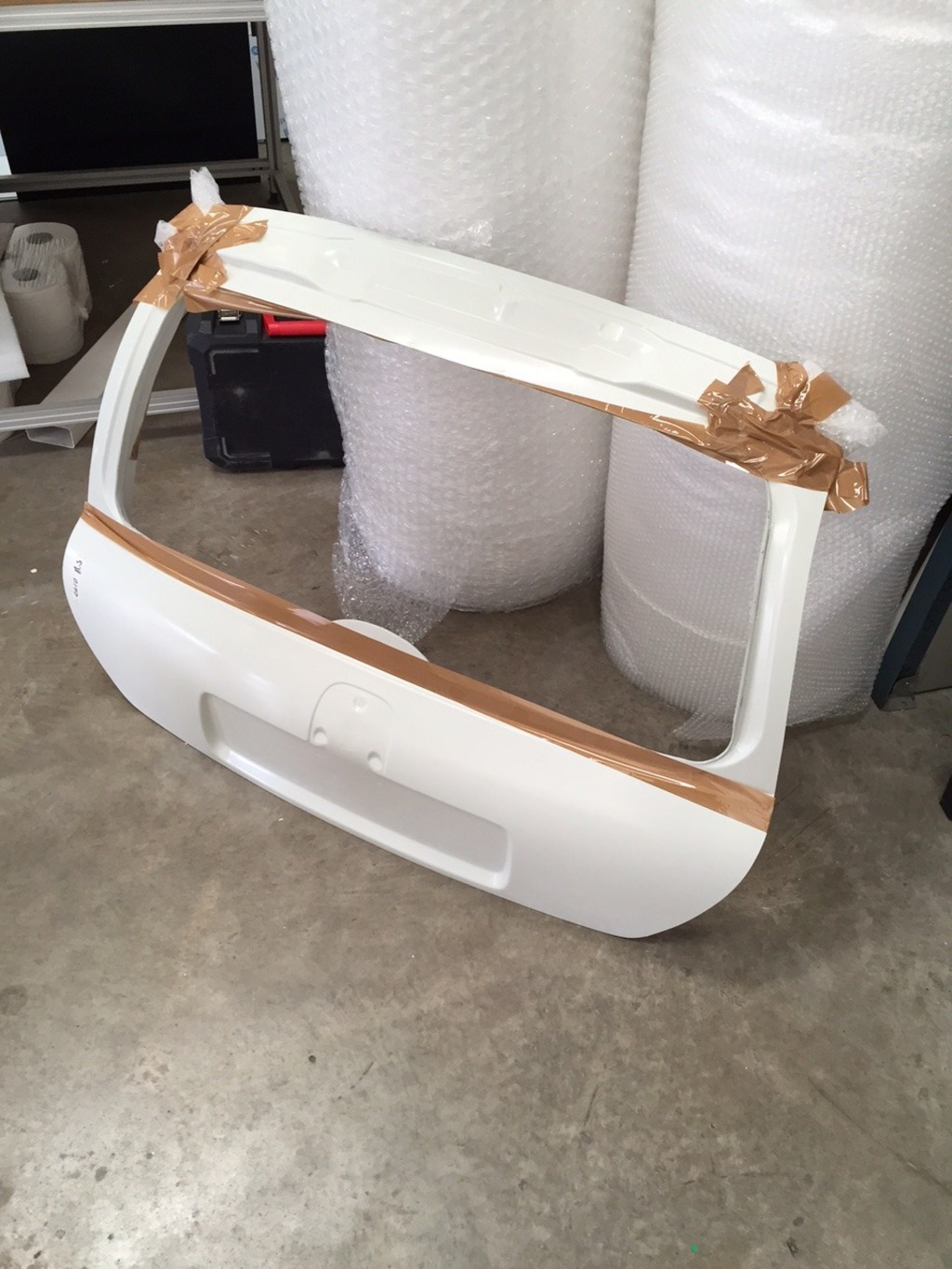

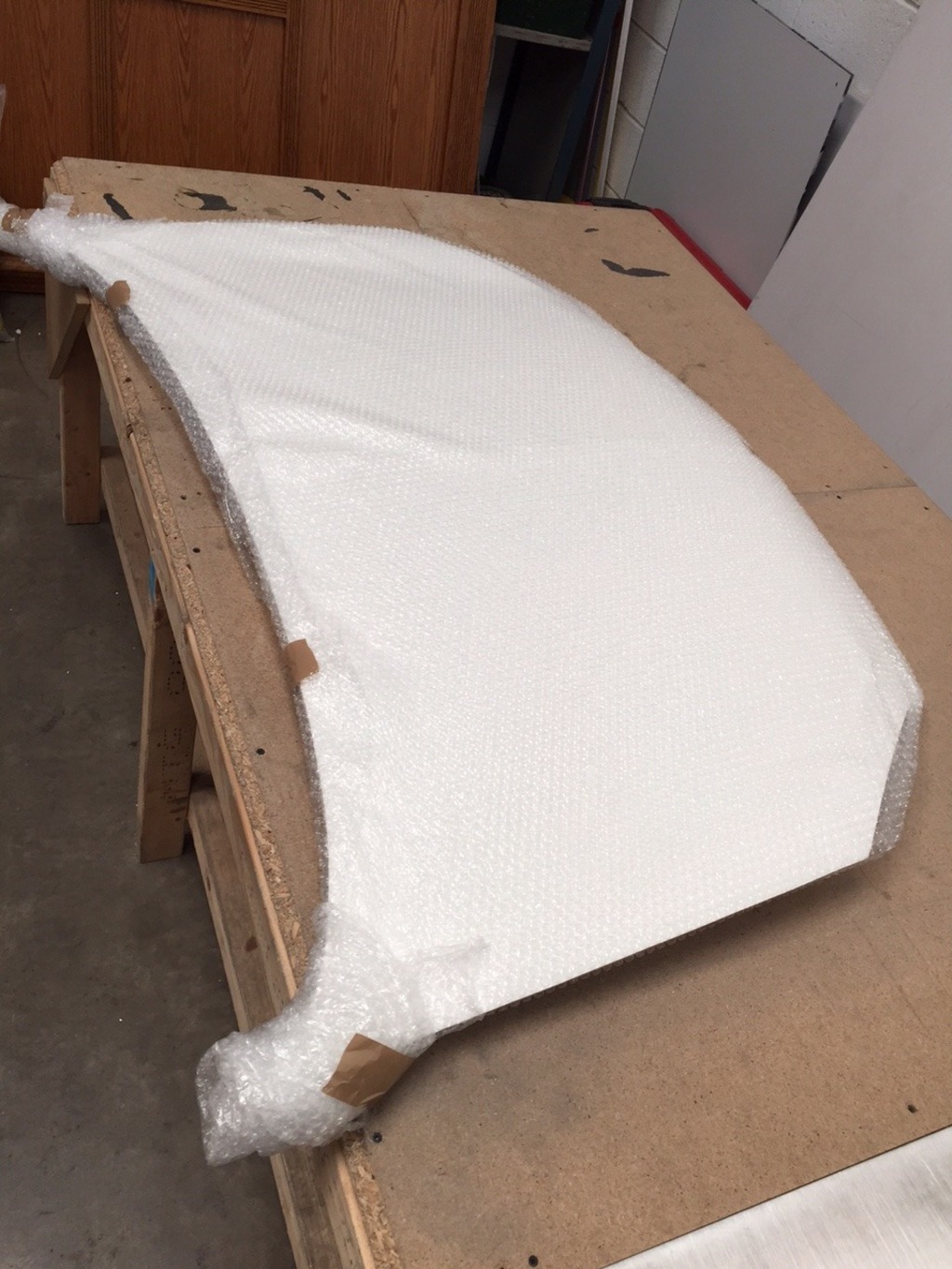

A couple of bits bought for after after Castle Combe. They are off at the wrappers at the moment.
Thanks Chris from CM Composites for the Bonnet and the Spoiler (which I forgot to photo), and PMS for the boot lid. Both look good bits of kit.
I'll stick them on the scales before I fit them, to see the difference. I already have my bonnet and boot lid trimmed, so not sure on the gain ill get.
Tomotek
Good purchases!...Id be interested to see what they weigh compared to what they quote.. I worked out savings the other week based on quotes weights and then weighing the steel standard parts:

  Renault Clio 172

I'm sure my door weighed more than that. I still had all the electrics in, etc. I'll stick them on the scales, before I fit them.
the spoiler is a big weight saving too! I think they quote it at about 3kg, but it felt light as a feather!
Once they are all fitted, with the wrap and hinges, etc, i'll weigh the whole car, and see the difference.
That will def help mate all that weight saving, I did a comprehensive list in my build thread with everything listed, also keep a secondary list on my phone. My doors are Kevlar, slight different internal design as they use alloy reinforcement brackets for the door handles but theres not that much in it.
  Renault Clio 172
Do you know what your's weighs Sonny? I think I got mine wrong when i did it, as I weighed mine and Russ's at Silverstone, and it came in a touch over 900kg. It did have 3/4 tank of petrol, so probably 15kg over starting race weight. Can't remember what Russ's was, but it was a lot lighter!
10ltrs of fuel weighs 9kg iirc )1ltr = 900gr
Mine weighs 872 dry (no fuel) 888kg with fuel (set for mid race)
