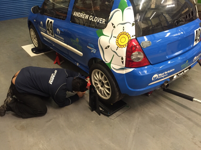

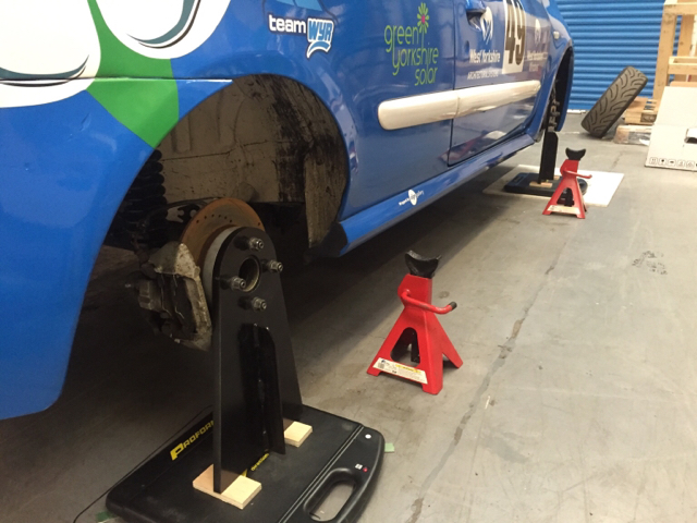

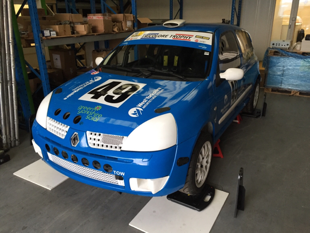

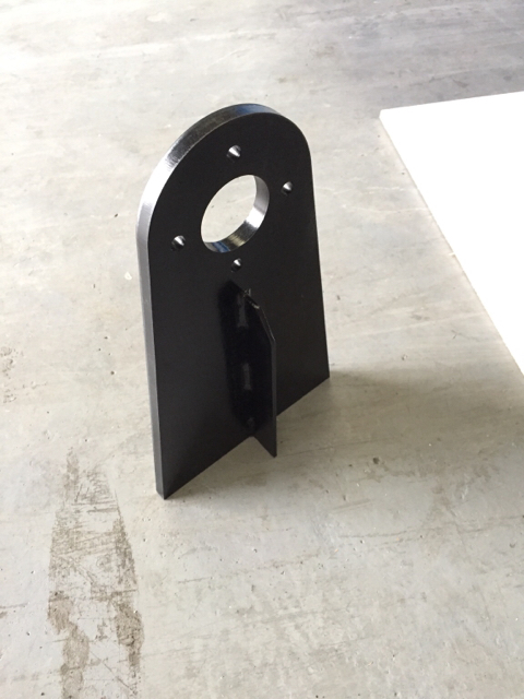

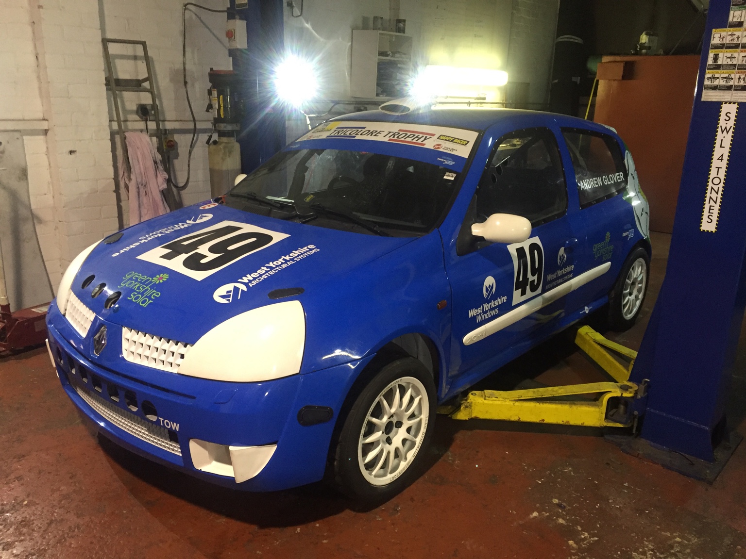

Finally got the car wheel aligned and corner set up.
I've had a set of hub stands made, to save us having to take the wheels on and off all the time to change the Geo.
It worked really well, although once we put the wheels on, it changed it slightly. To be fair though, most of the change was within the tyre pressure.
I actually found it quite easy, as all I had to do was sit in the car, while @ant_smeggy did all the hard work :)
It weighed in at 965kg, with me in it, which I'm really happy with.

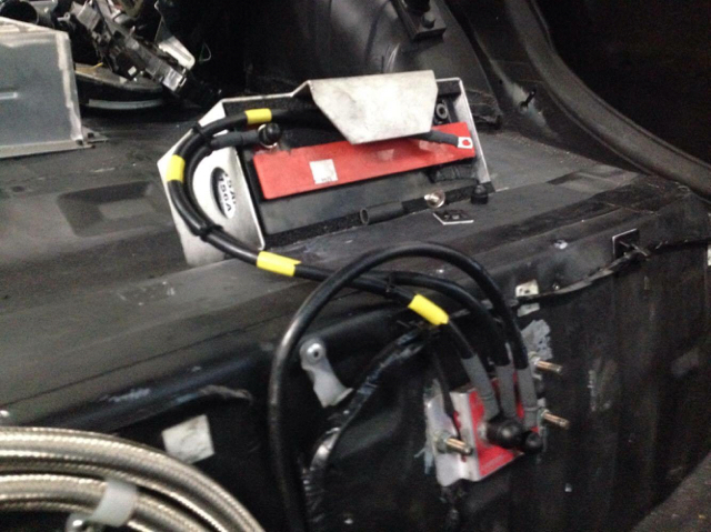

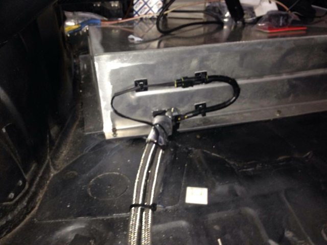

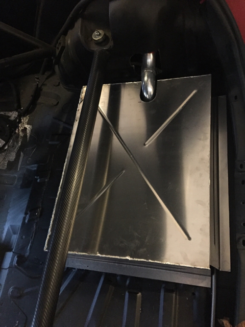

Other jobs I've done, is change the tank and fuel system completely.
Not the best pictures.

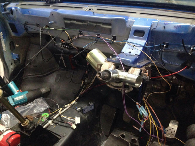

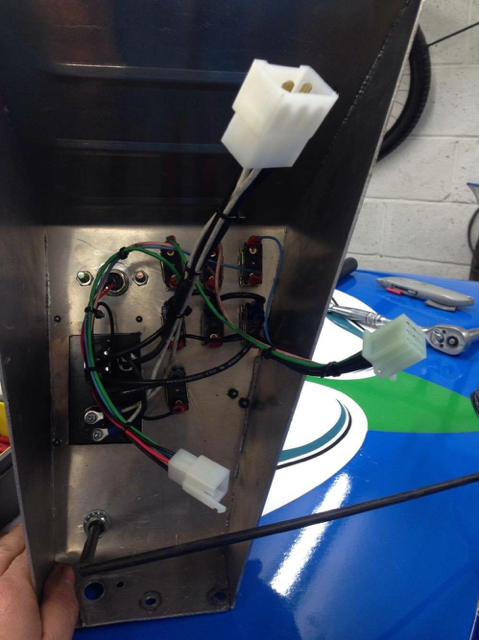

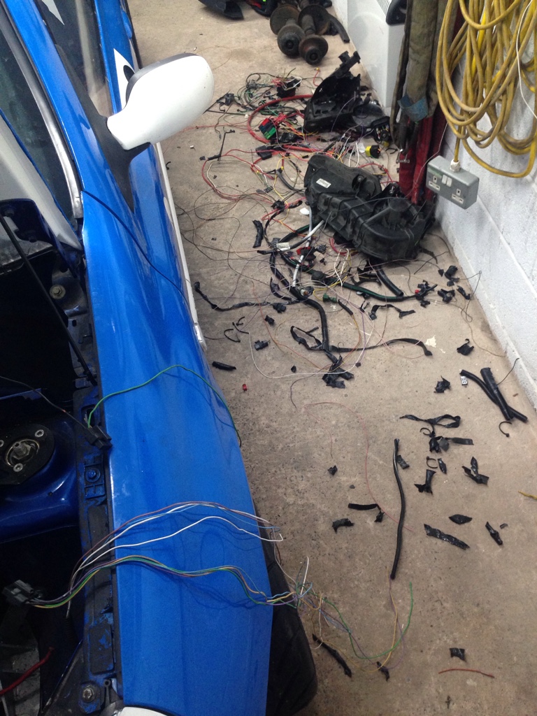

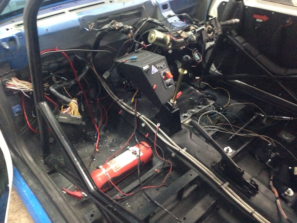

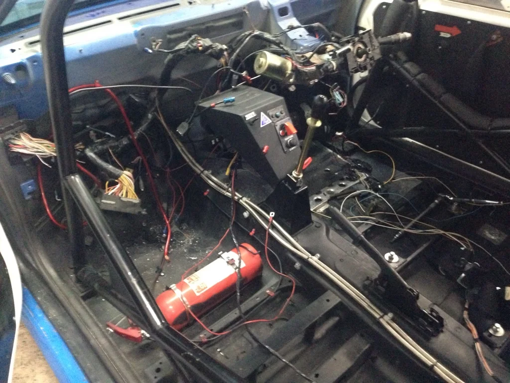

I've also had the car fully re wired by Russ, which has really tidied it up.

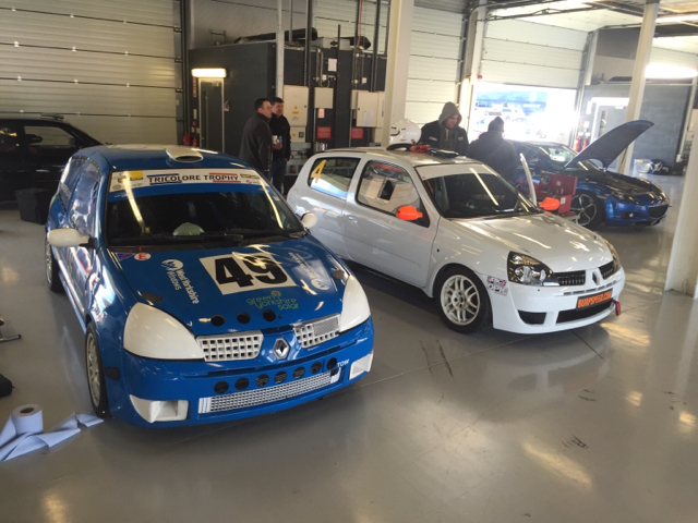

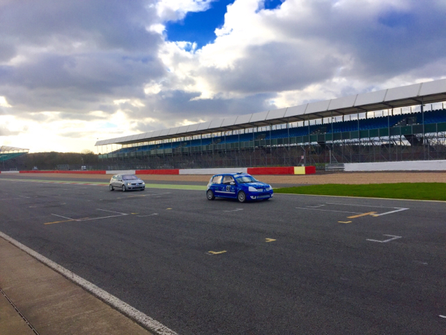

A great day at Silvestone today. Few little issues, but nothing we can't sort before next track day.
Firstly, a learning issue. I've replaced the gear box with a newly reconditioned one, as my third gear was causing a problem. But what I neglected to do, was swop the Diff over! It never entered my head!
We also had a warped front disk, which was giving us dreadful vibration.
Anyway, it'll all get sorted.
The car sounds amazing though :)
Looks good too, next to Tony new Burp.

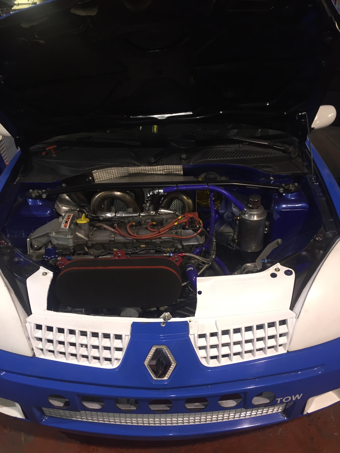

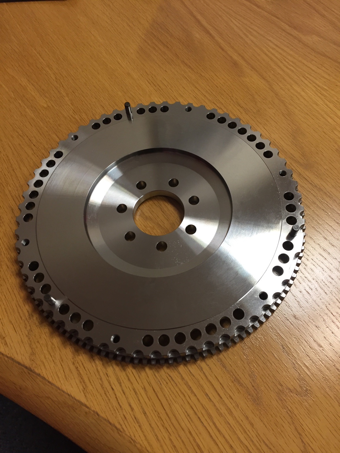

Looking forward to today. First time around Oulton since I passed my test here. Think we have got everything sorted for today. We got the correct gearbox re conditioned now and remembered the LSD this time! Changed the disk, to get rid of the warp and fitted a lightened flywheel :)
We also fitted a new front grill, as the old one wasn't really holding everything together, with the amount that had been chopped out of it!

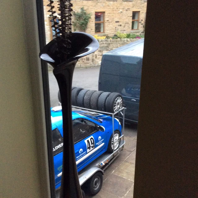

page 3 bottom picture... what trailer is that looks compact and perfect size im after?
