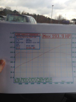

Rolling road print from -J- on here when we was at the cliosport rolling road day on saturday.
Very similar peak power to throttle bodies on a standard engine, better spread of torque (although less peak torque in midrange, so slightly worse from that respect on track) and you dont need to go aftermarket management which is a bit of a pain on the 182 as to go bodies you have to swap out the throttle pedal etc too which puts all the management lights on.

oh right i see so better off you think just getting a decat exhaust and a remap and then you get around 200 which in real terms is only 20 less than a throttle bodied one which isnt really a great difference but i am used to vauxhall turbos which with just a remap and exhaust and no other mods you will see like 240 instead of the 190 standard. after thinking i want a car thats a little slower on track so that it will show me what lines to take to carry most speed out of the corner etc. i think if i just got an astra with 300bhp its to easy to just stick ya foot down once you are out of the corner. also with cams on a 182 what sort of gains will you see? is it worth it for the money? and would you need after market management for that also?
No, that one I posted is with an RS2 inlet manifold too:
http://www.stone-automotive.com/index.php/clio-rs-products/clio-rs2-inlet
For getting near to 200 you need either different inlet, or different cams.
Most of these cars make under 170bhp standard, so the starting point isnt as good as the "clio 182" label would have you think!
