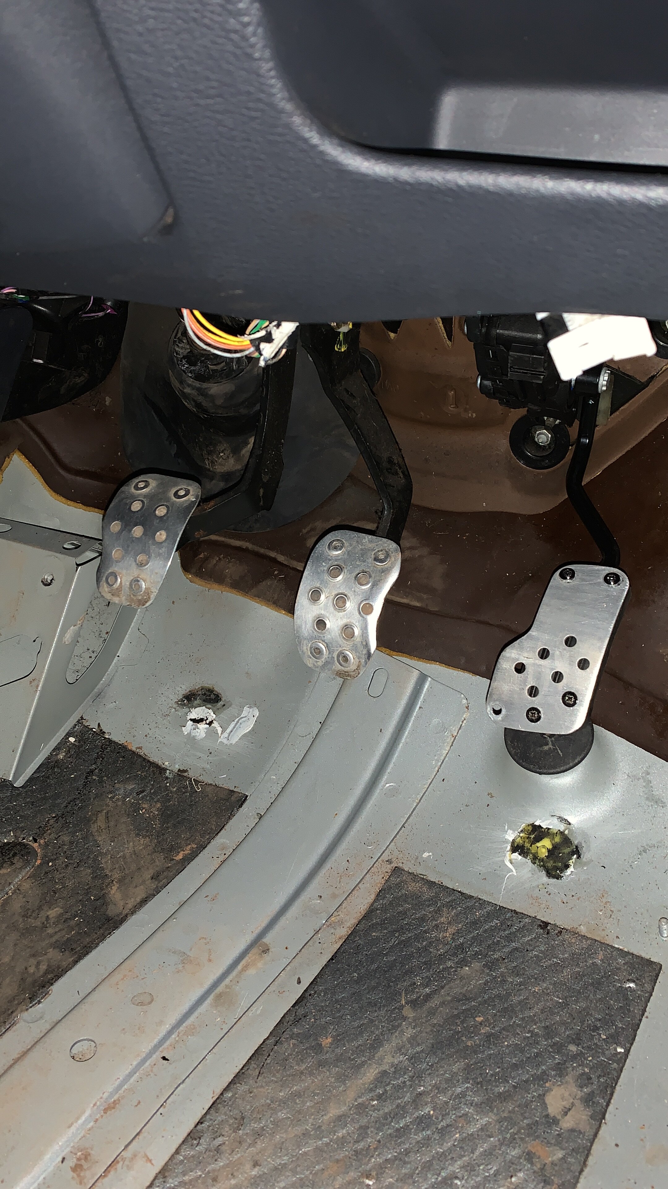

I’ve got a plastic throttle pedal fitted in the track car… unsure as to why but never mind.

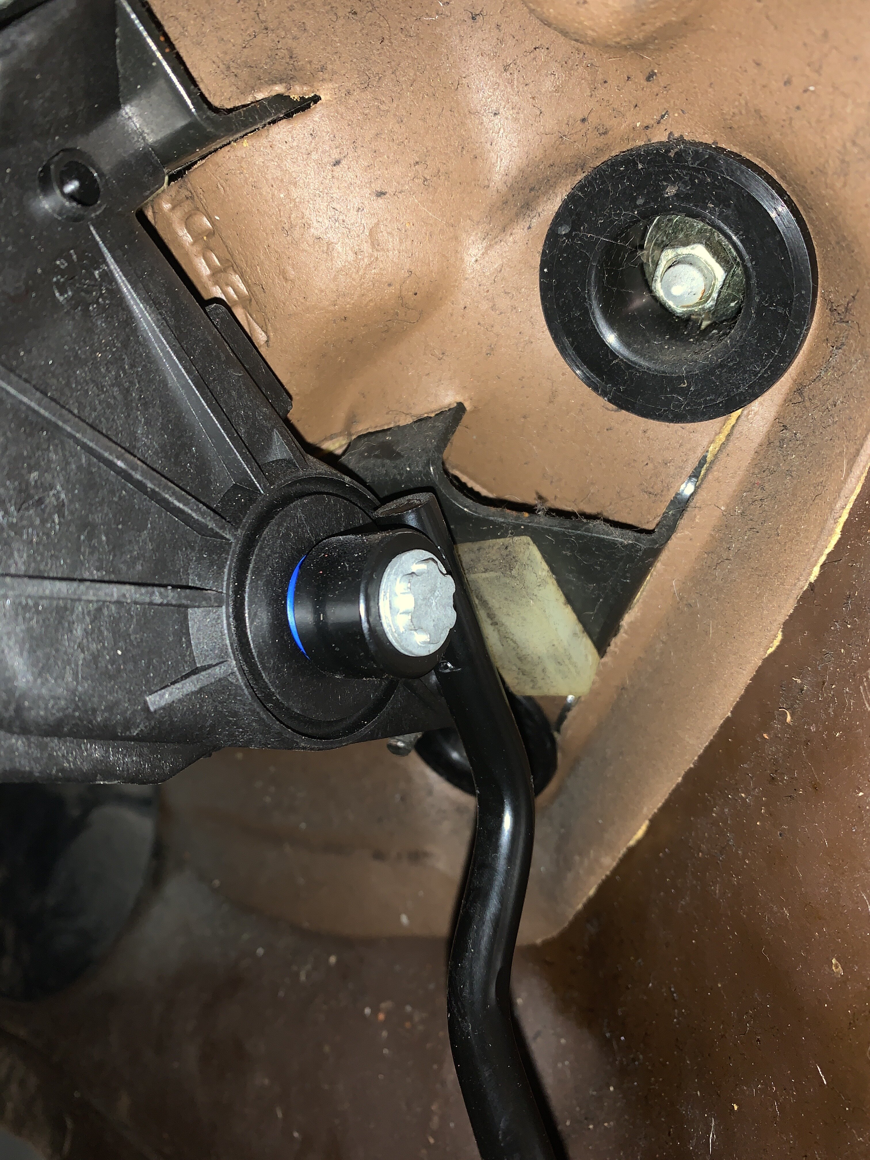

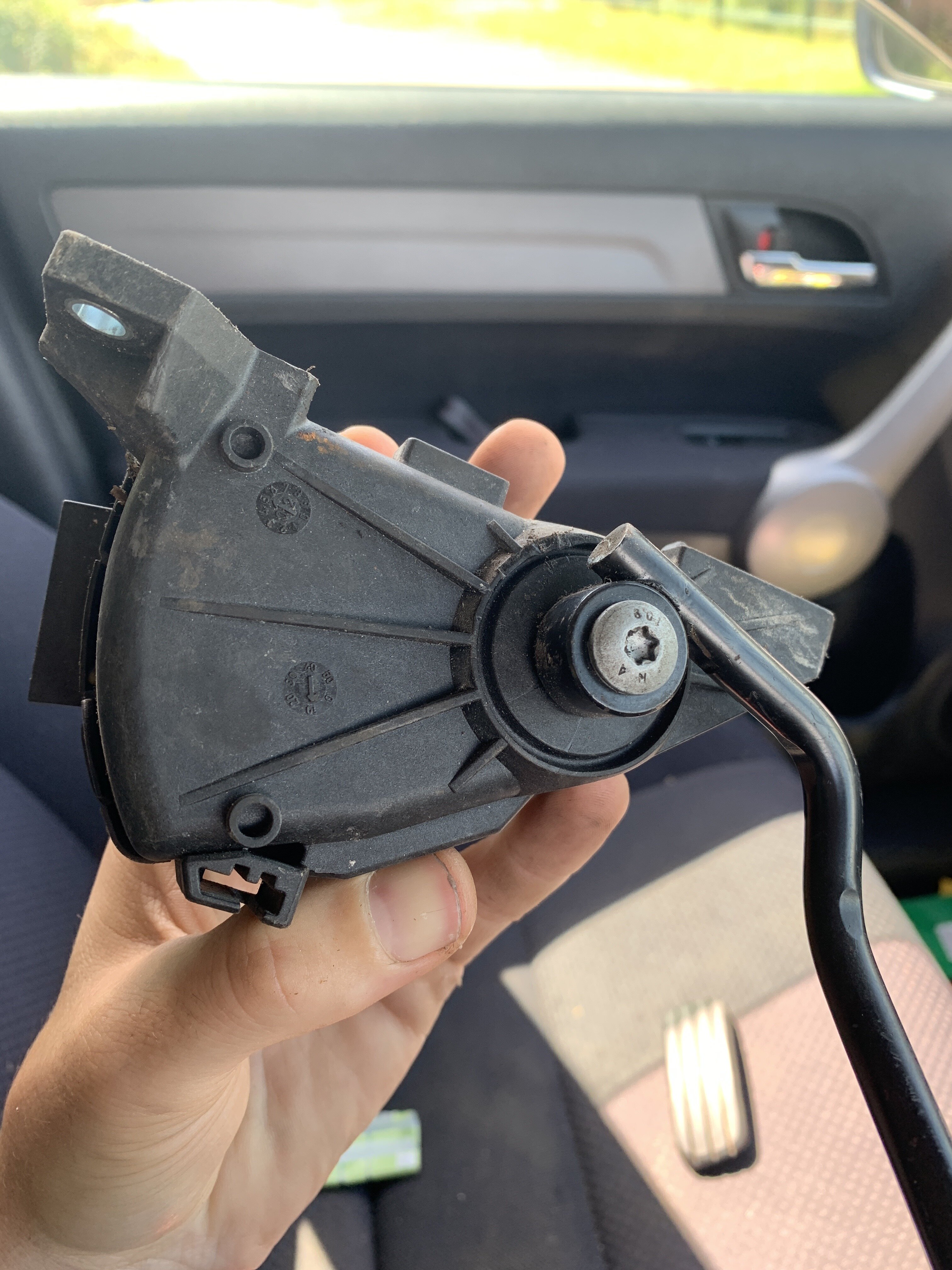

I have 2 spare original metal pedals and wondered if it was a case that I could just remove the entire pedal shaft which connects to the assembly and replace it with an original?
Only difference I can see is the fixing that connects it to the housing. (See images below)
Original:
My other idea was just to remove the pedal from the shaft on the original and re- weld onto the new shaft.

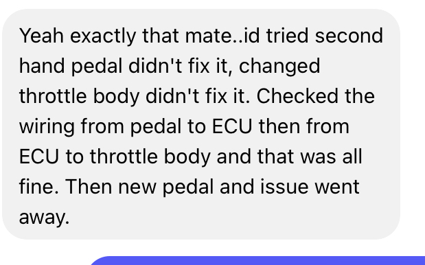

The guy who had the car before said there was an intermittent fault with the entire oedal housing. He swapped it to another second hand pedal and the problem remained.
Checked throttle body, wiring, EXU etc and the only thing that cured it was a cheaper pedal. Only issue that gives me now is the crap plastic pedal.

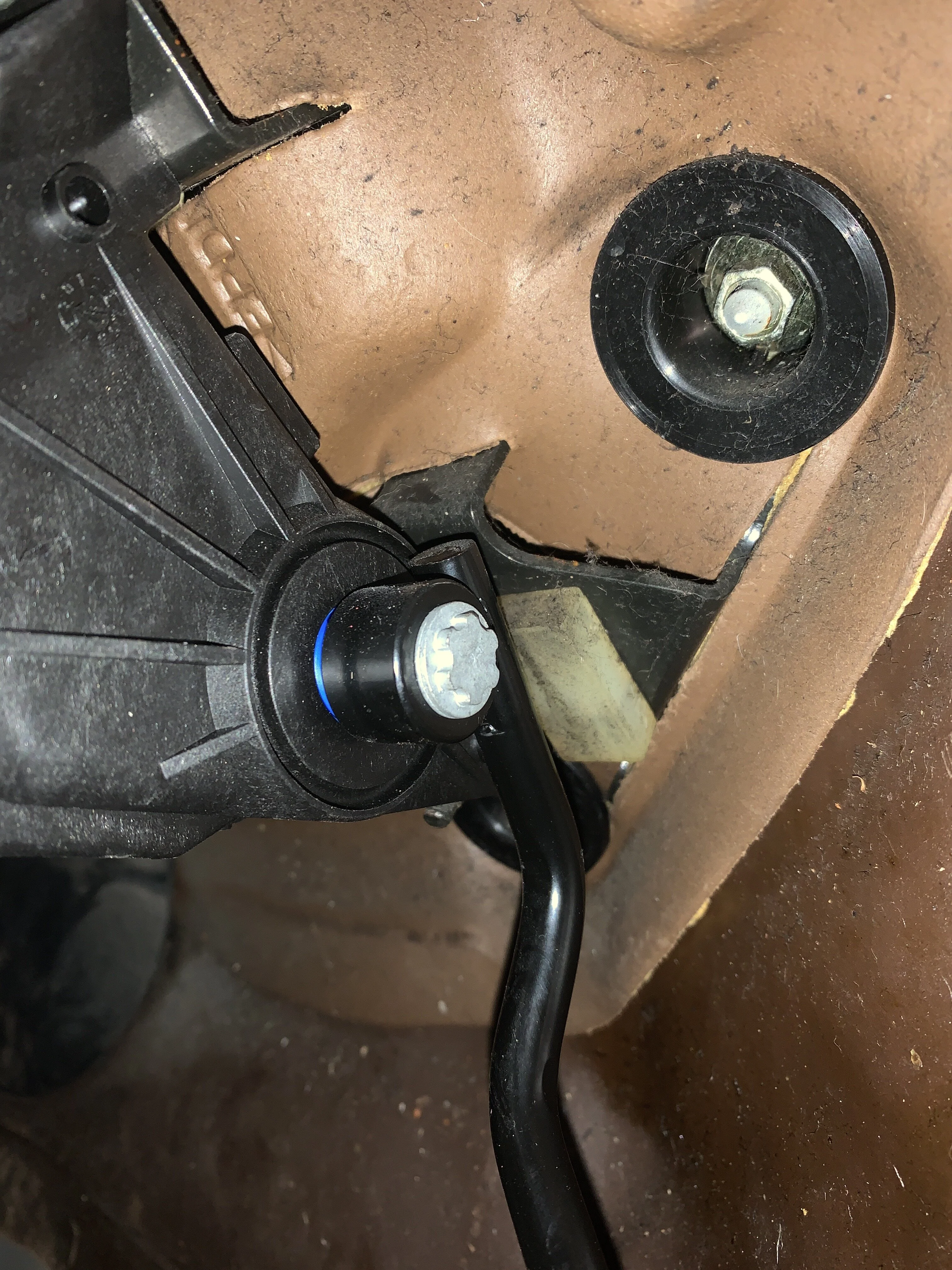

So I didn’t opt to remove the entire pedal arm however removed the plate from and old assembly and refixed.
Worked out pretty well to be fair.
Now just got to remove sound deadening and bits of glue 😬
