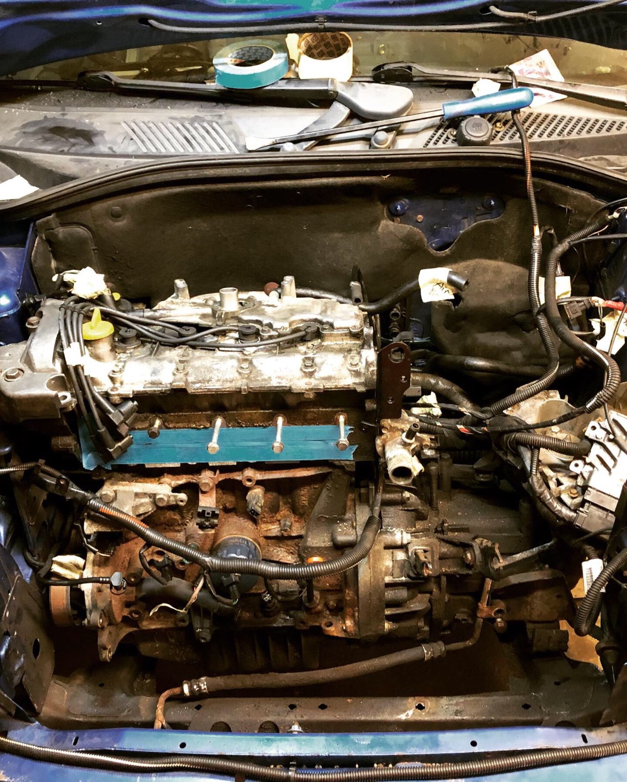

I need to do a timing belt & clutch so decided to take the engine and box out to make life easier, plus i want to tidy the bay,paint the block and just a general clean of parts.
Plan on doing timing belt, water pump, dephaser, cam end seals
New clutch, got talked into potentially fitting a lightened fly while the box is off.
My question is, what other jobs/parts to replace while i have it out ?
Rear main oil seal???
Flywheel bolts ???
Gearbox rebuild maybe?
