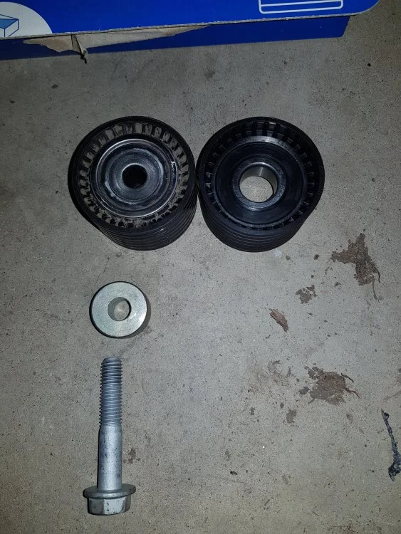

Hi Im in the middle of replacing the timing belt on a 2005 182 and the lower idler pulley I have in the kit is different. It has a larger inner bearing hole and the bearing is narrower. The idler on the head has a spigot to centre that bearing. The one I removed has a hole suited to the bolt. Its an skf kit. Have I been given the wrong idler pulley or is there a version that uses a spigot for both idlers.

The one with the larger centre is the upper roller
Have you been given 2 large diameter rollers or have you got 1 of each? Because you should have 1 smaller and 1 larger lol

The photo shows both of the ribbed ones. The left one is the one I took off and is marked renault. The right one is the skf part. 17mm inner hole instead of 10mm and slso wont sit out enough to be inline.
