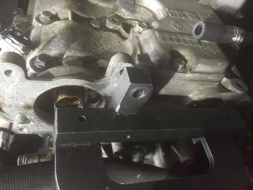

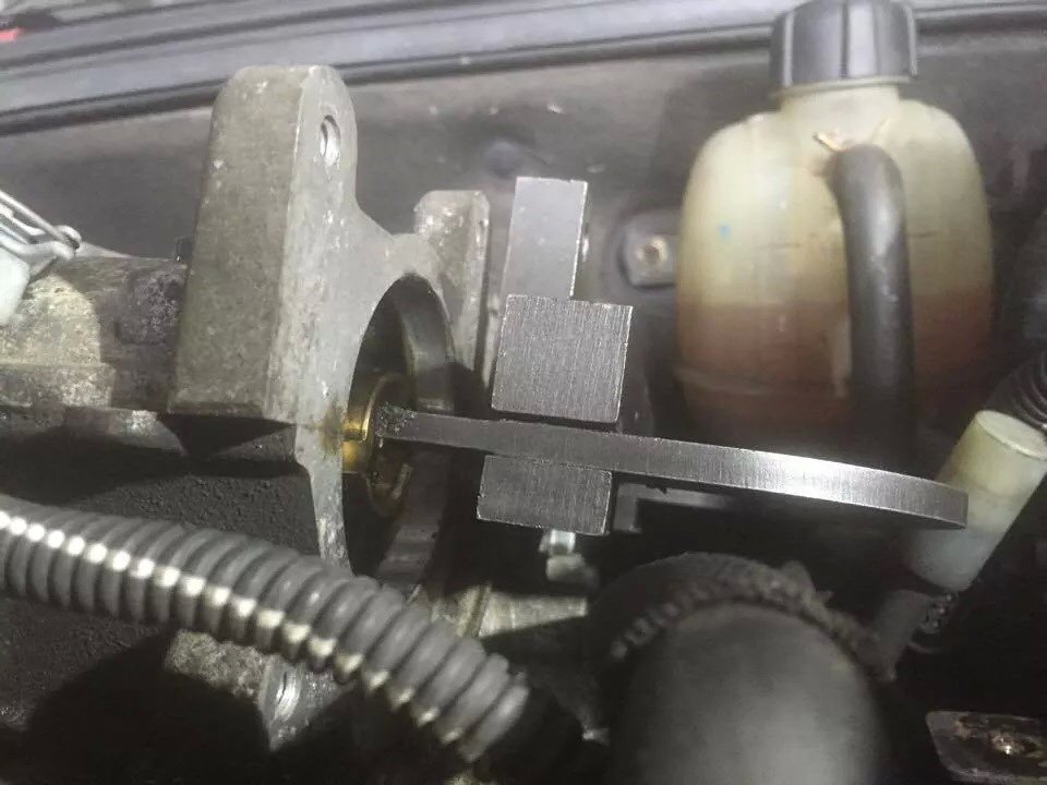

really why is there so many done wrong ? checking it is easy just remove the caps and put the crank pin it hand crank the engine to the stop and put the tool in the end

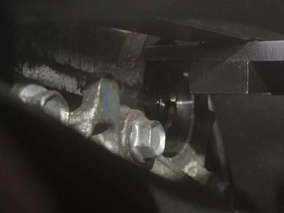

If you're turning the crank to get it to stop that's wrong already.
I don't know how so many people get it wrong, but they do. If the tool doesn't slide, side to side in the cams, it's wrong.
If the crank has been locked in the balance hole instead of the locking slot, it's wrong.

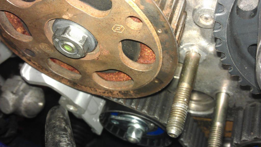

If the tensioner is past 12 Oclock, it's wrong.
Like so.
Timing has gone from this:
To this:
