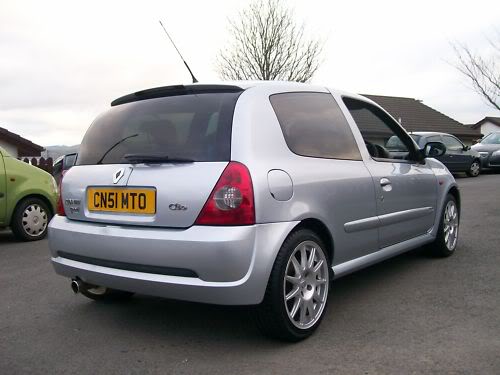

hi guys im new on hear and just got my self a 172 with cup alloys and cat back exhaust system .as i just sold my 106 gti after 2 and a half year i did have a 182 about 3 years ago and wished i never got ride of it and after driving my 172 i can see i made a big misstake .....​
anyway does any 1 now the best place to get the timming belt changed in south wales thats not to pricey i pay £1800 for the car its got service history up to 65 k but does not say about the belts being done .the guy i got it of said he had it done at 72k but no prof as he payed cash :S its on 96k now and runs very well with no faults do u think its been done? as it on this milage or do i need it done asap
thanks for ur help little pic of the 172
